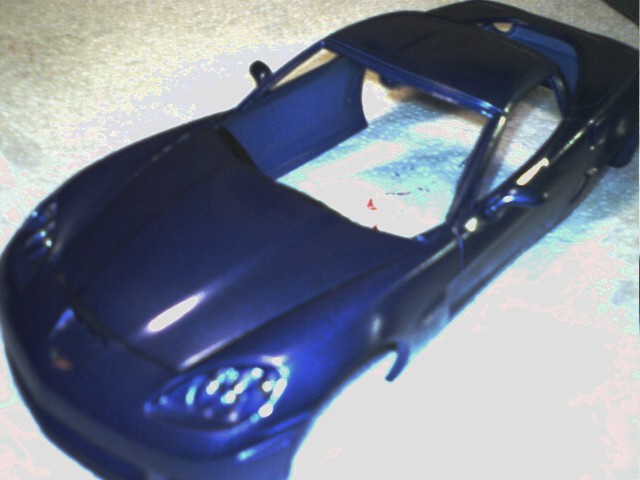

wdcav Posted January 5, 2008 Author Posted January 5, 2008 I typically favor Testors/Model Masters for my projects, and never have had a problem with them. I can't say that I've always been thrilled with the results from Tamiya though. I usually do ships, even built the Tamiya 1/350 styrene offerings, but never had luck with their brand paints. I no longer consider them. But the Model Master Lacquers work great for me. Used the Silver to do my Concept Camaro last year, and it turned out to have almost a mirror finish after spraying it.. Excellent stuff, looks just like the GM concept. Still though, I typically favor MM Acrylics just for ease of thinning and cleanup. In fact, here's a pic of my C6 Z06 I completed last year, and got brilliant results with MM. Trusted brand with me.
