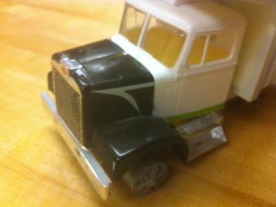

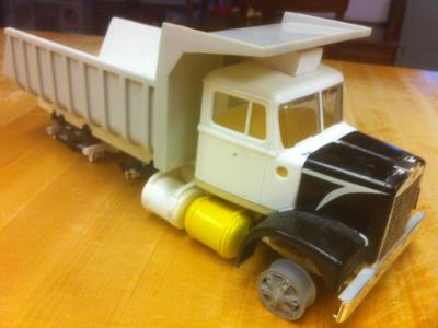

Arnd Posted June 1, 2014 Posted June 1, 2014 Hallo guys I picked up an older project that I never finished like I want to. It is based on the AMT Diamond Reo kit.I tried to find information with the help of the internet, what is the right type for the truck is but I am not sure. So I hope that you guys can give me some help on that problem. It will be a tandem axel, day cab truck, with a short nose and 90inch BBC. Now the questions: When came the hood in use, which is in the AMT kit? What about the different front grills like in the picture optional or depending on year it was build? What about the model with single round heat lights optional? So long Arnd

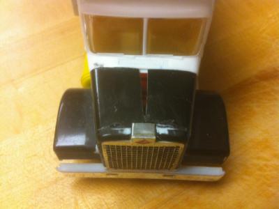

Arnd Posted June 7, 2014 Author Posted June 7, 2014 Hallo Terry Here an impression of my one By the way does your book give any information on the different BBCs of this trucks and about the different engines which were used? So long Arnd

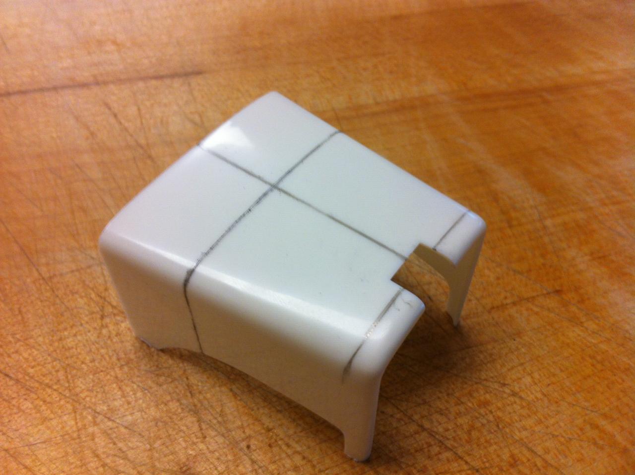

Superpeterbilt Posted June 7, 2014 Posted June 7, 2014 Sorry it took me so long to get back to you, but I cut off .8" from the hood. Here is the lines that I cut to spread the hood properly. Yours is lookin mean man! That a great looking truck already. I will check my book later and give you the info.
