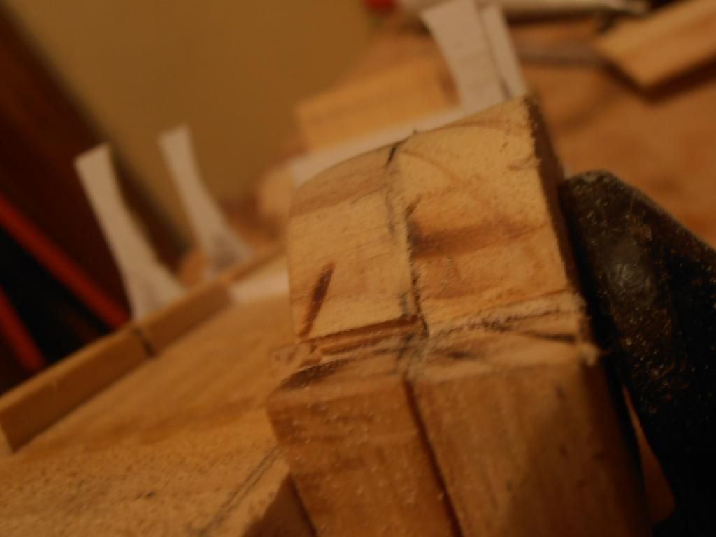

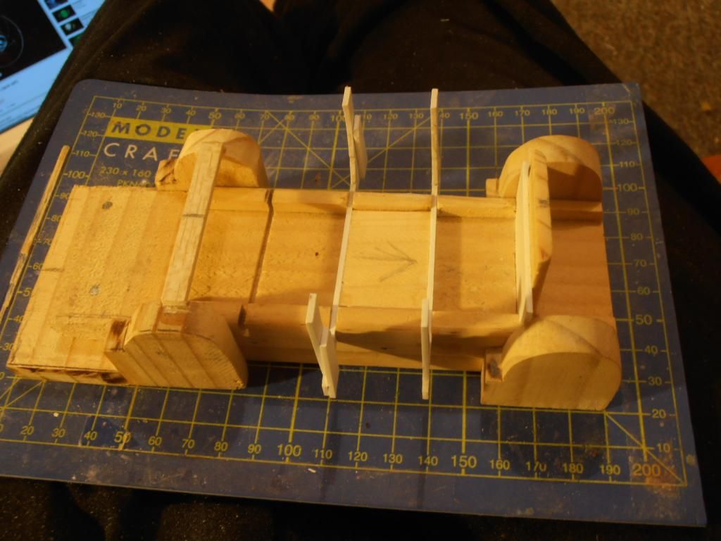

P1010490_zps89db5660.jpgBecause I am putting the body together from the rear and not the roof i will need to have everything perfectly aligned. I pulled out the jig I made months ago to make some additions. I will complete the rear wheel arch columns, these will lock the body in place. This is the first one done. With these complete I will add to the section at the back. I have already marked out the centre point on the raised piece at the front. With the back section complete I can run a spine from one end to the other. At this stage I am thinking of using string but I will construct the rest of the jig first before I determine the spine. That will be thee next task.

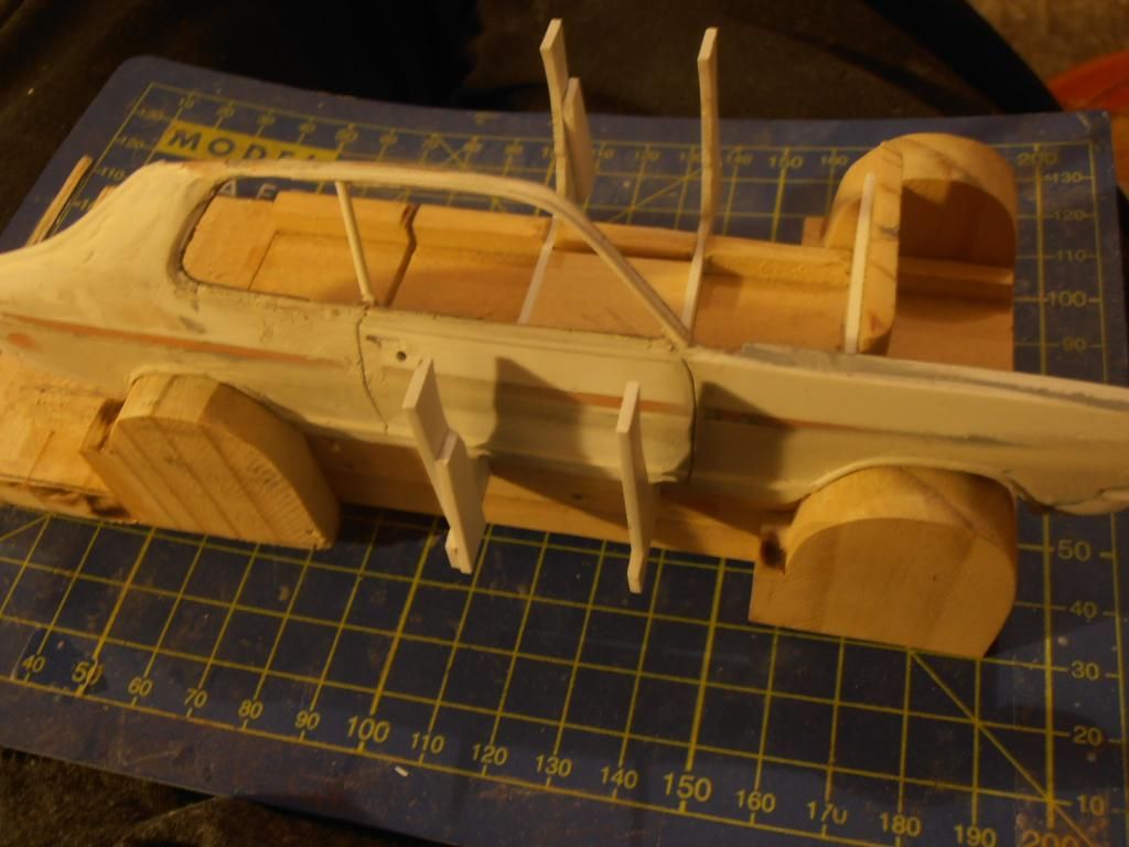

Its been a very slow evening. I have had to stop working on the body to get the jig in order. After adding the third wheel arch column, i cut out the fourth one and clamped it next to the third one to make sure the shape was the same.

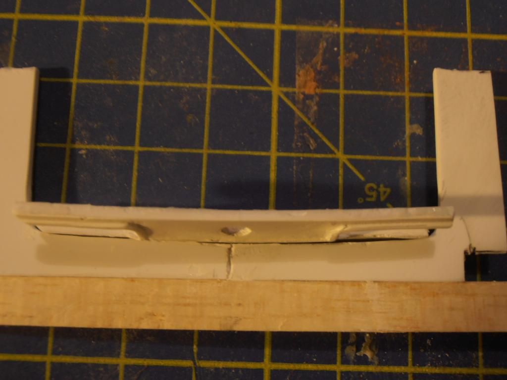

With the final wheel arch column in place I ran a piece of balsa wood between the two columns. The purpose of this beam is to keep the two body halves apart. The body halves will need to be locked firmly in place when I begin assembling the body. As I mentioned last time I need to find the centre point in the jig because this where the rear part of the body will need to positioned for the sides to be attached. I anticipate at a least a couple of days more to finish the jig. Once I have the jig finished then i can finally start putting the body together.
