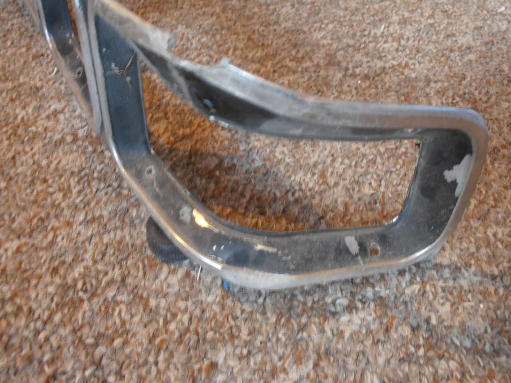

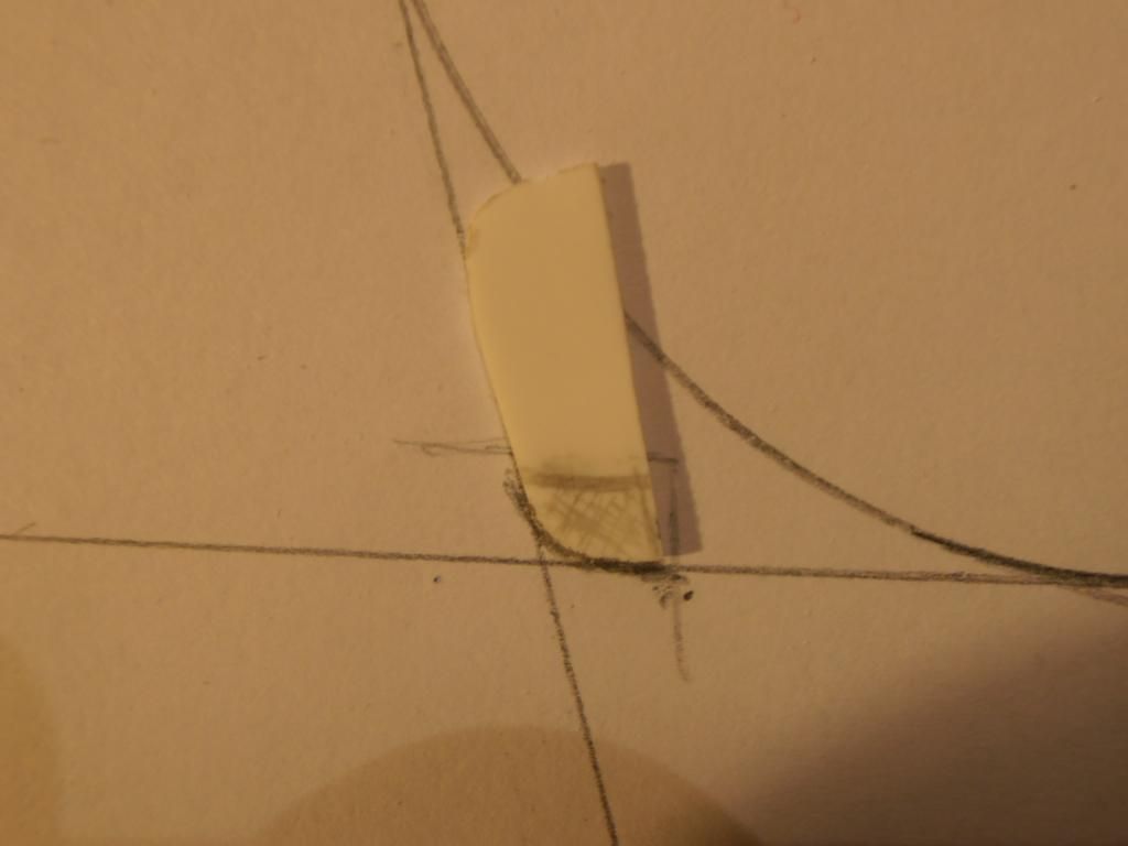

fractalign Posted December 12, 2014 Author Share Posted December 12, 2014 Hey Guys. Did not grey much down tonight due to a hectic day. Next thing i want to reproduce is this. Quote Link to comment Share on other sites More sharing options...

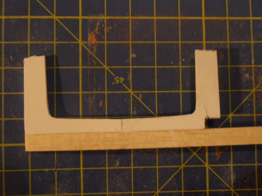

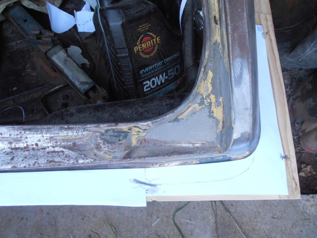

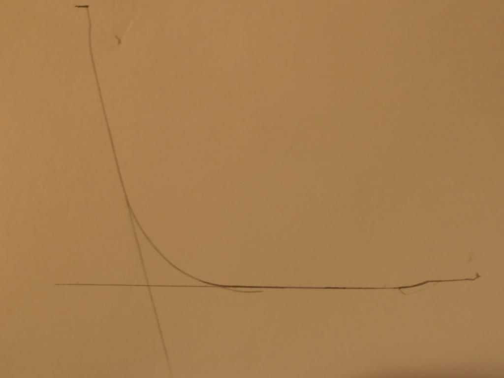

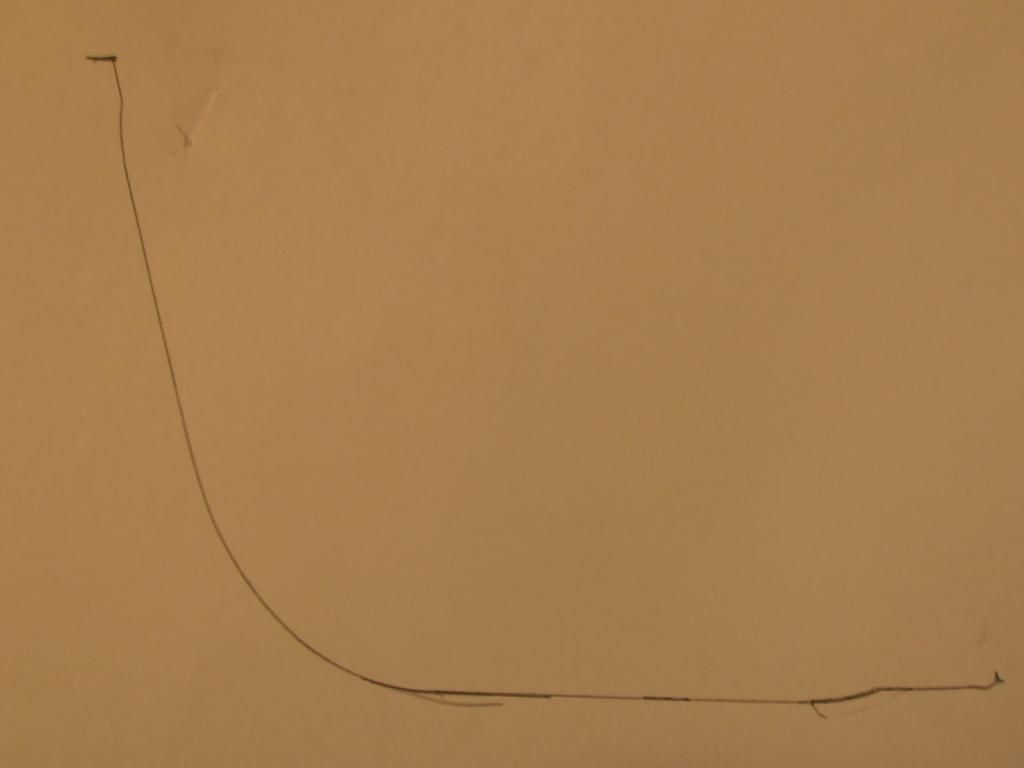

fractalign Posted December 12, 2014 Author Share Posted December 12, 2014 (edited) The corner tail light is a bit more complex, so I needed a different approach. The first thing i did was trace a template of the 1:1 to get the angles right. Edited December 12, 2014 by fractalign Quote Link to comment Share on other sites More sharing options...
fractalign Posted December 12, 2014 Author Share Posted December 12, 2014 With that done I recreated the shape in 1:25. This piece will act as a template for the other three. The next will be to create all four curvets and start assembling them onto the corner pods. Quote Link to comment Share on other sites More sharing options...

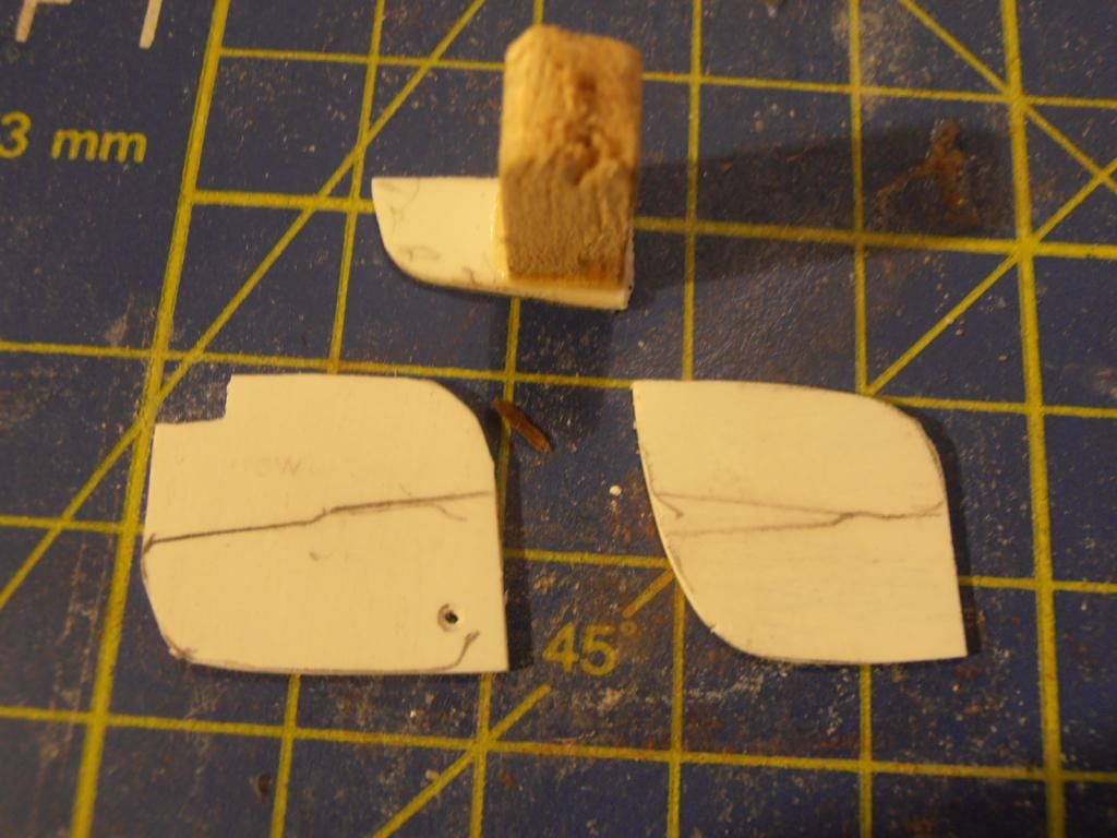

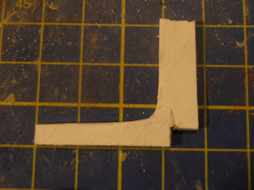

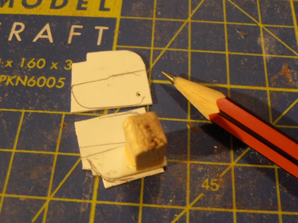

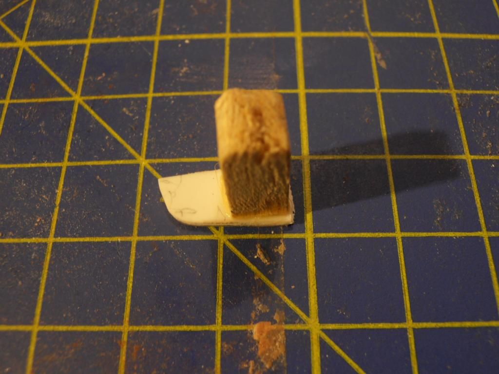

fractalign Posted December 14, 2014 Author Share Posted December 14, 2014 Hey Guys. I made up the template for the corner tail lights so that I could trace the shapes for the four corners. The piece of balsa acts as a handle. Quote Link to comment Share on other sites More sharing options...

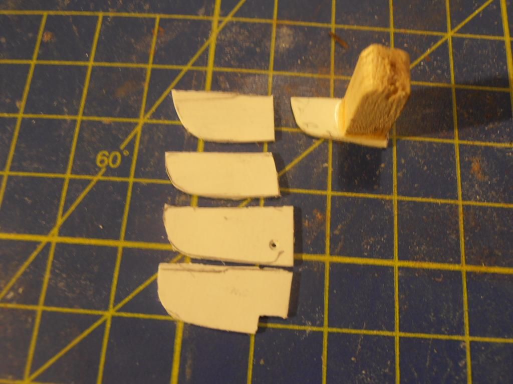

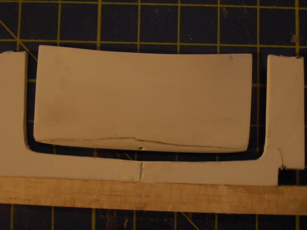

fractalign Posted December 14, 2014 Author Share Posted December 14, 2014 Here are the pieces traced and cut. Quote Link to comment Share on other sites More sharing options...
fractalign Posted December 14, 2014 Author Share Posted December 14, 2014 Next task will be to take the four pieces and start assembling them into the corner pods. Quote Link to comment Share on other sites More sharing options...

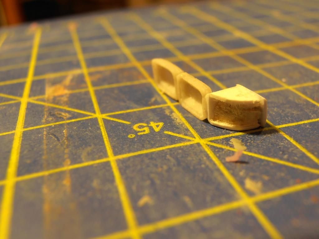

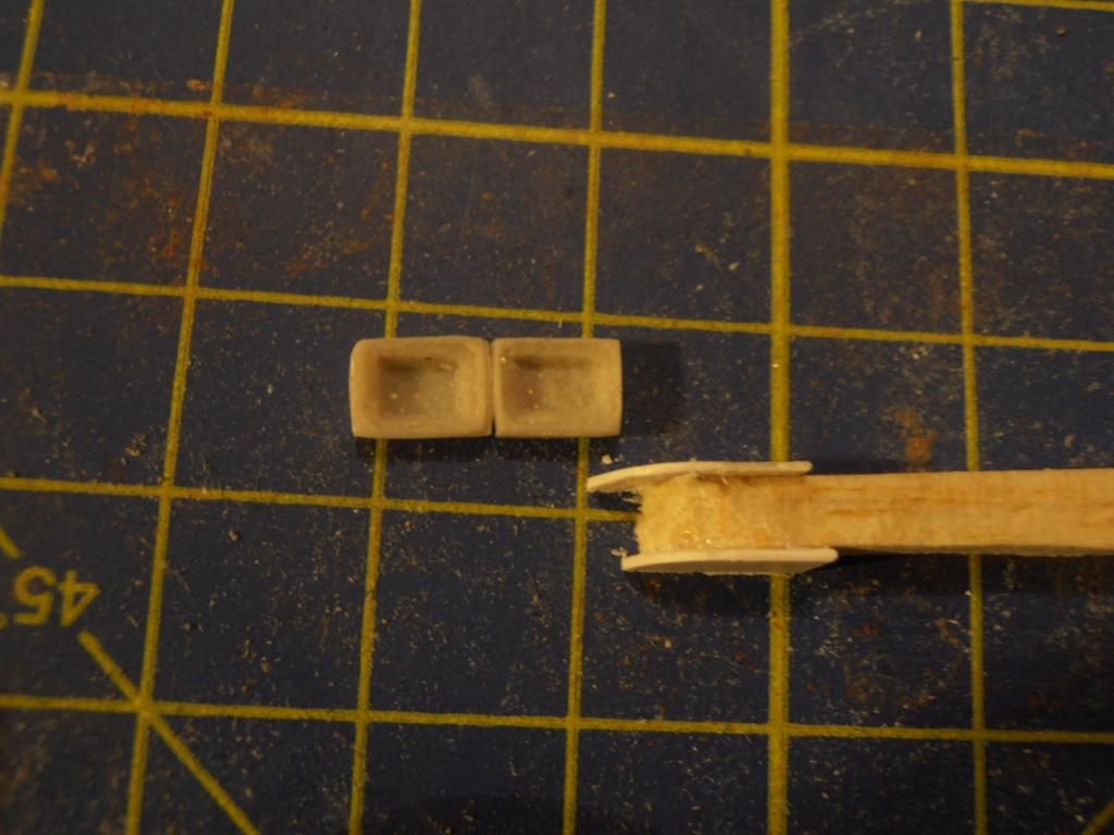

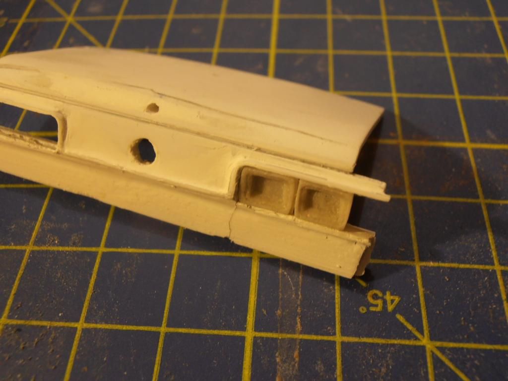

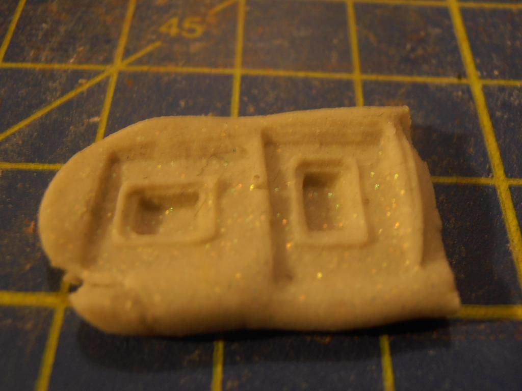

fractalign Posted December 15, 2014 Author Share Posted December 15, 2014 Hey Guys. The tail light assembly is nearing completion. I used the press to make up four of the rectangular units using the the Fimo Baking clay. This is what they looked like out of the oven. Quote Link to comment Share on other sites More sharing options...
fractalign Posted December 15, 2014 Author Share Posted December 15, 2014 After clean up this is what they look like. The corner tail light is taking shape as well but it will take more effort to get to the stage of the rear units. Quote Link to comment Share on other sites More sharing options...
fractalign Posted December 15, 2014 Author Share Posted December 15, 2014 The final image show how the rear tail light sit inside the housing. The next task will be to finish the other side tail lights and both corner tail lights. Quote Link to comment Share on other sites More sharing options...

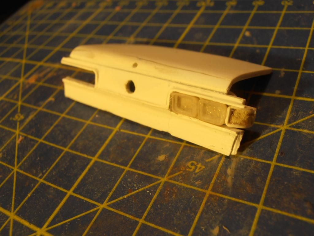

fractalign Posted December 16, 2014 Author Share Posted December 16, 2014 Hey Guys. I assembled the basic tail light. Quote Link to comment Share on other sites More sharing options...
fractalign Posted December 16, 2014 Author Share Posted December 16, 2014 Here it is sitting inside the housing. The next task will be to duplicate the other side and then start working out how to attach the rear section to the body halves. Quote Link to comment Share on other sites More sharing options...

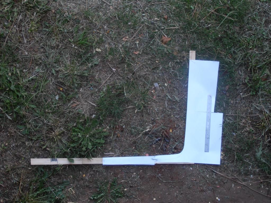

fractalign Posted December 20, 2014 Author Share Posted December 20, 2014 Hey Guys. Having sorted out the taillights I have started work on the rear part of the body. The first thing I needed to do was a construct a contour gauge and due to the size I decided to only do one side, measured from the petrol cap in the centre. Quote Link to comment Share on other sites More sharing options...
fractalign Posted December 20, 2014 Author Share Posted December 20, 2014 (edited) I decided I needed a better perspective with the contour guage so I photographed it from the roof of the shed. Edited December 20, 2014 by fractalign Quote Link to comment Share on other sites More sharing options...

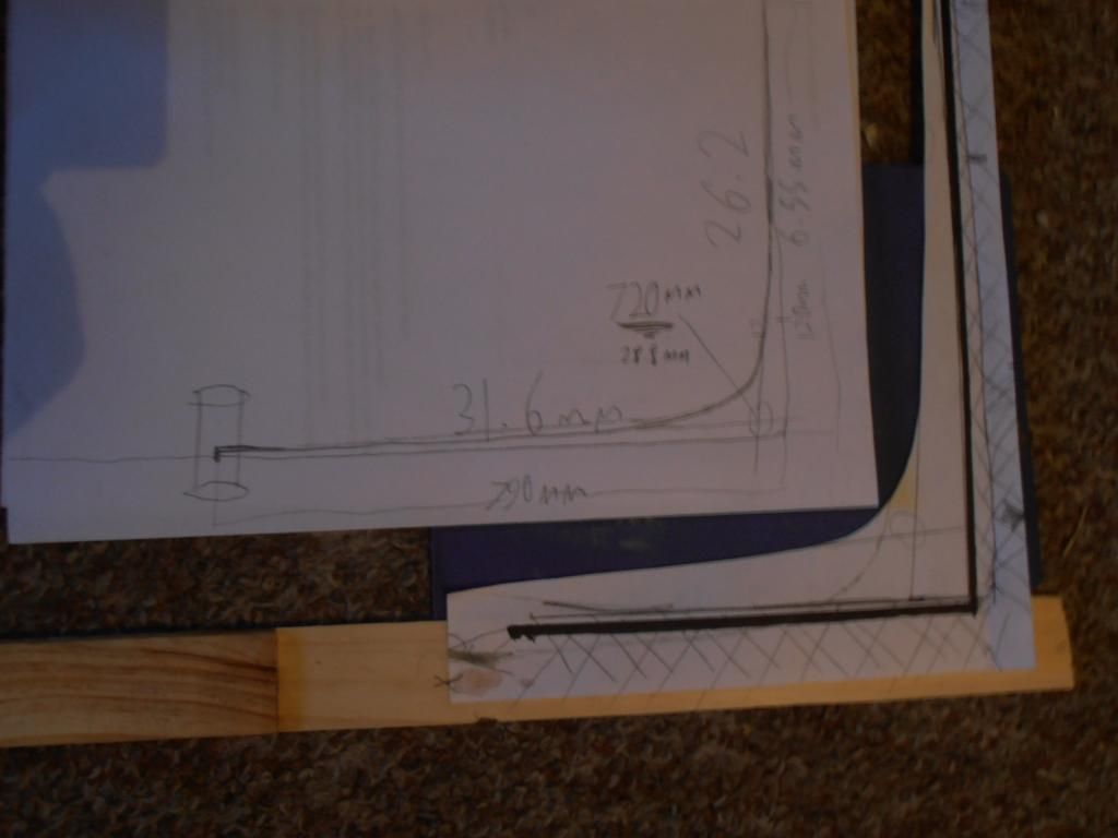

fractalign Posted December 20, 2014 Author Share Posted December 20, 2014 After getting the outside measurement of the gauge I used my set square to get the inside measurement. One thing that surprised me when putting the contour gauge together was the fact the the rear of the body is not flat. This would would not have been apparent had I not decided to put the gauge together. The curve is very gentle so it would be very easy to miss. Quote Link to comment Share on other sites More sharing options...
fractalign Posted December 20, 2014 Author Share Posted December 20, 2014 (edited) Here is the first half of the gauge completed. I will be using the images of the 1:1 to cross reference the shape of this one. Once I am happy with the shape of this one I will use it as a template to create the other half, join the two halves together and then I will have a contour gauge for the rear of the body. This is necessary because once I have completed this gauge I can begin to start putting the body together. I was originally going to join it from the roof but I have decided that this will be a more logical way to do it. That will be the next task once the gauge is a complete. Edited December 20, 2014 by fractalign Quote Link to comment Share on other sites More sharing options...

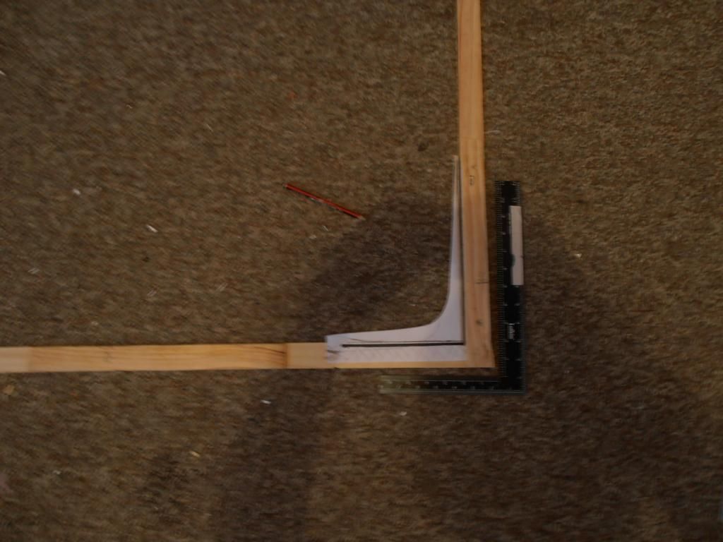

fractalign Posted December 21, 2014 Author Share Posted December 21, 2014 Hey Guys. Today I was able finish off the contour gauge but in order to do so I need to find the centre point in the 1:1 gauge. This was a straight forward task. Quote Link to comment Share on other sites More sharing options...
fractalign Posted December 21, 2014 Author Share Posted December 21, 2014 Here is the completed contour gauge. The two pieces are attached to a length of balsa wood for rigidity. Quote Link to comment Share on other sites More sharing options...
