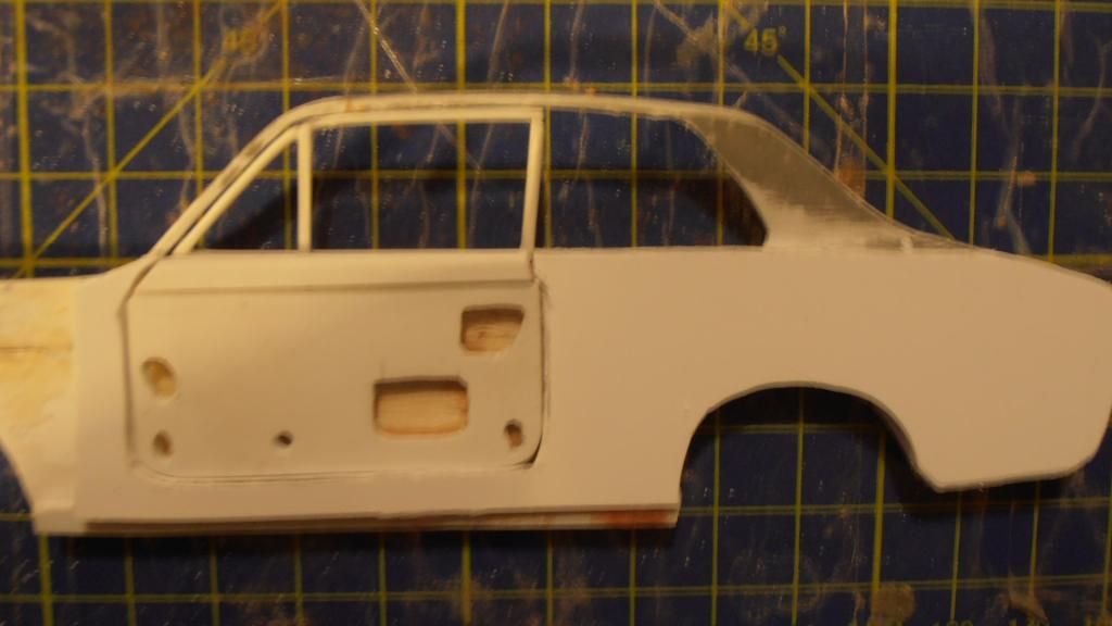

fractalign Posted July 17, 2014 Author Share Posted July 17, 2014 Here is the inside view. Next task will be to make up the door skins. Quote Link to comment Share on other sites More sharing options...

fractalign Posted July 22, 2014 Author Share Posted July 22, 2014 Hey guys. The internet is back on so I have a whole pile of stuff to upload. Over the last few days I have worked on the door skins. The first thing I did was stick the two pieces together. You will notice the holes drawn in. Quote Link to comment Share on other sites More sharing options...
fractalign Posted July 22, 2014 Author Share Posted July 22, 2014 With the two sides stuck together, I was able to get the right shape on the other side. The trick is to keep the two sides together for the duration, especially for when the holes need to be made. Quote Link to comment Share on other sites More sharing options...

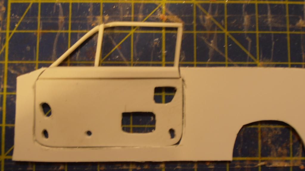

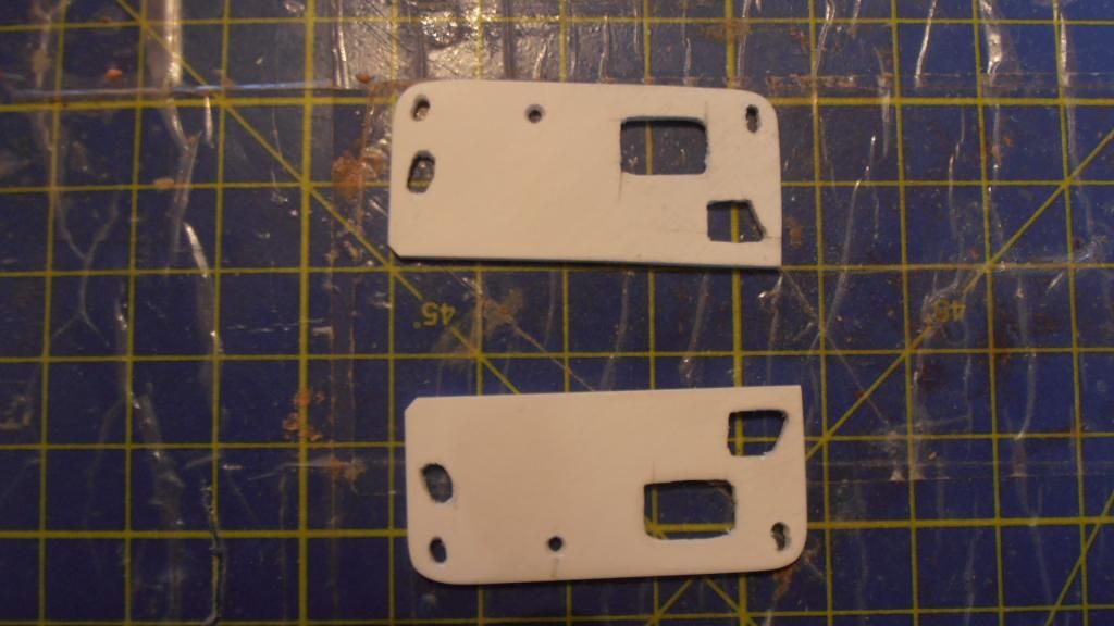

fractalign Posted July 22, 2014 Author Share Posted July 22, 2014 The trick with getting the rectangular holes cut is to make the pilot holes at just the right size. For these ones I used the tip a modellers knife. Once this side was done I turned it over and did the same on the other side to keep the both sides in balance. Quote Link to comment Share on other sites More sharing options...
fractalign Posted July 22, 2014 Author Share Posted July 22, 2014 One the pilot holes were done I used a modellers drill to widen the hole. These drills are the same size as micro screw drivers and being unpowered means there is very little heat generated and less chance of mistakes. Quote Link to comment Share on other sites More sharing options...
fractalign Posted July 22, 2014 Author Share Posted July 22, 2014 With the comers done I used a woodworking tool and mallet to punch out the squares. Quote Link to comment Share on other sites More sharing options...
fractalign Posted July 22, 2014 Author Share Posted July 22, 2014 With the squares punched out I used the modellers drill on the other holes. Here is how the two sides look. Quote Link to comment Share on other sites More sharing options...
fractalign Posted July 22, 2014 Author Share Posted July 22, 2014 Test fitting the door skin, you notice the gap between the door skin and the bottom of the door frame. Quote Link to comment Share on other sites More sharing options...
