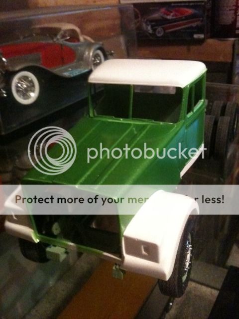

I'll be starting this kit pretty soon. I'll do it exactly as shown in the box art. My question is how to do the red stripes between the white and black colors. I was hoping the red stripes were decals but they are not. I'm stuck here. Thanks for the tips.

nothing to it really. paint the white first, paint the whole body. let that dry/cure. after it's cured, mask off the white parts you want to keep, and clear coat the whole thing, let that dry, but not completely cure, then paint the dark color, let that dry for a day or so, then un mask it. after that is fully dry/cured, mask off the area you want stripes, clear it again, let that dry a day or so, then paint the red, let it dry a bit, then un mask. when fully dry, clear it again, and you're done. I do my two tones this way. I also use lacquer paint, dry times will be longer for enamel.
if nothing else, try it out on something else, worst case, it goes into the pond to strip the paint.
the clear coats help keep the colors from bleeding thru into one another. here are a few examples,
give it a try, you'll be glad you did.
Good tutorial Tom. Do you sand between coats? And how do I keep the masking tape from peeling the paint when removing it? Thanks!
Edited by angelo7
I don't sand between coats,unless I get a bunch of dust/junk in the paint. I usually let the actual base color dry/cure pretty good, otherwise you get tape residue [then ya gotta wet sand] when you un mask. I usually get in a hurry and just let the first coat of clear tack up for 20 minutes, then shoot my second color, if it covers well, i'll unmask it in 20-30 minutes and let it cure from there. I should wait longer though, as sometimes when I peel the tape off, the top coat and clear are a bit 'stringy' and will sometimes cause some of the paint line to not be crisp. best bet is to experiment on a body and get the 'feel' for it. took me a few tries to get where I can repeat the process without catastrophic failure, lol.

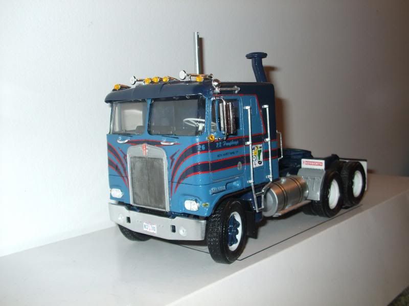

I'm a fan of using the stripe color as the base coat (in this case red), then masking off the thin stripes, spraying some clear, then spraying the other colors with a coat of clear between each color. This is how I got the thin red stripes separating the shades of blue on this KW:

KJ, good thinking on the stripe color first, that does sound like it would be a lot easier, and way less masking :)
Anthony, love that truck!
