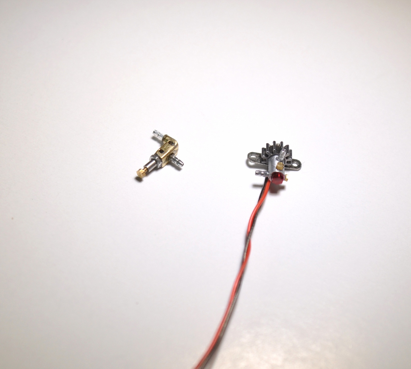

Codi Posted October 26, 2015 Author Posted October 26, 2015 Began the brake system components. Today I got the line-lock done. Master cylinder and proportioning valve are next. Cheers, tim
futurattraction Posted October 26, 2015 Posted October 26, 2015 That is beyond mind-blowing, Tim... I keep thinking you can't take it any smaller/finer, then the next day I see you've already outdone yourself. Amazing...!
John Teresi Posted October 26, 2015 Posted October 26, 2015 Codi......Un-real dude.....that is a tiny tiny piece......."WOW"!!!!!
gasser59 Posted October 26, 2015 Posted October 26, 2015 Complete mind boggle Tim. That must be a big pencil.
GTJUNIOR Posted October 27, 2015 Posted October 27, 2015 " !" No words. Jaw on the floor. Amazing craftsmanship!
Nytrozilla Posted October 27, 2015 Posted October 27, 2015 So let me see if I've got this right. Approximately 10 pieces and, when assembled is still smaller than the tip of a pencil. Did I get that right? If I wasn't familiar with your style, I'd be on the floor. Fortunately, I've learned to be sitting down when I check your progress.
Codi Posted October 27, 2015 Author Posted October 27, 2015 Thanks gentlemen....and I really liked the pic that Joe put in there for laughs. Which it got. Oh, Joe, 11 pieces...you were oh so close though. Today I got the proportioning valve done and managed to do a nice job slicing my thumb while at it. This was an interesting piece to make and the body is made up of brass square tube and 1mm tube. I drilled all the necessary holes in the square body before beginning the next step. Then I cut the tube at 45" angles and positioned them in the altered square tube....sweat soldered the whole thing and and made the other parts and assembled. I haven't decided what to paint/plate or dychem just yet so what you see isn't final. Master cylinder next which should take a few days as I'll machine parts of it as well as fumble with my fat thumb while making it. Cheers, Tim
