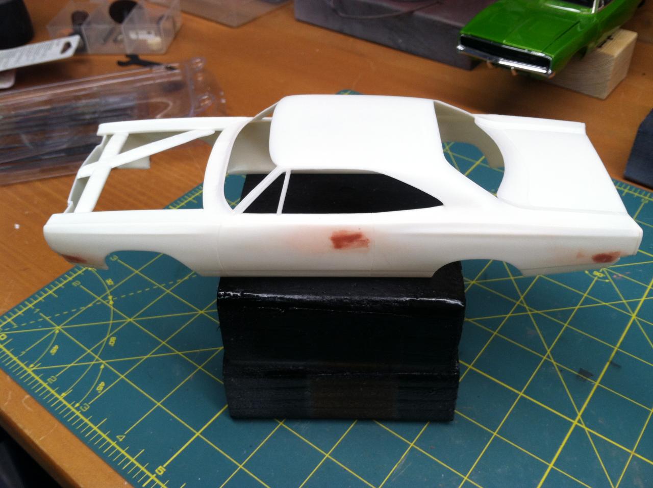

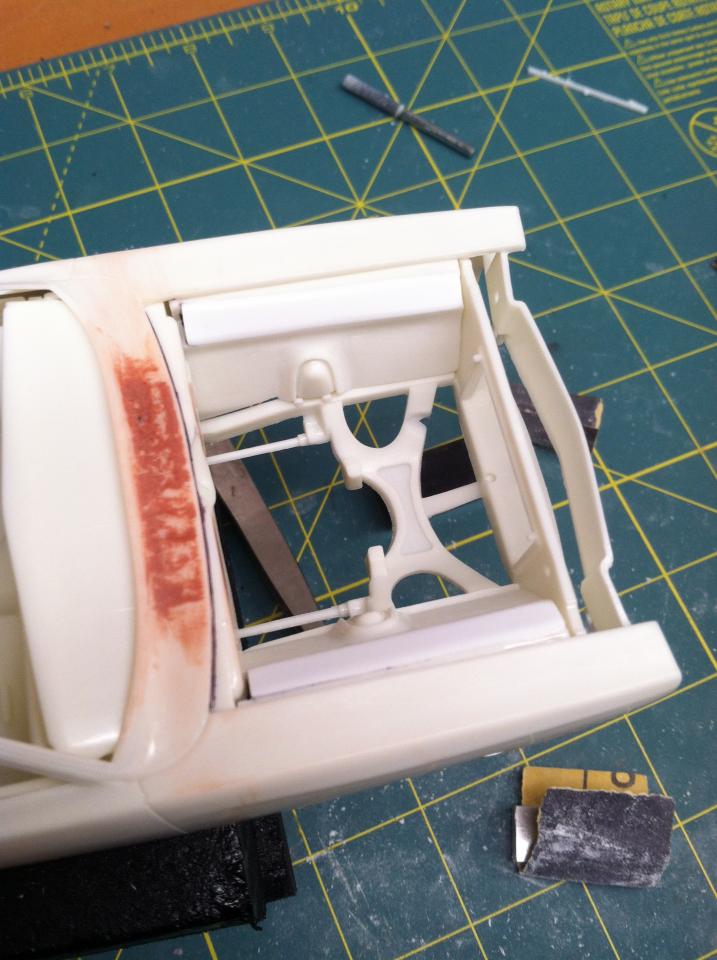

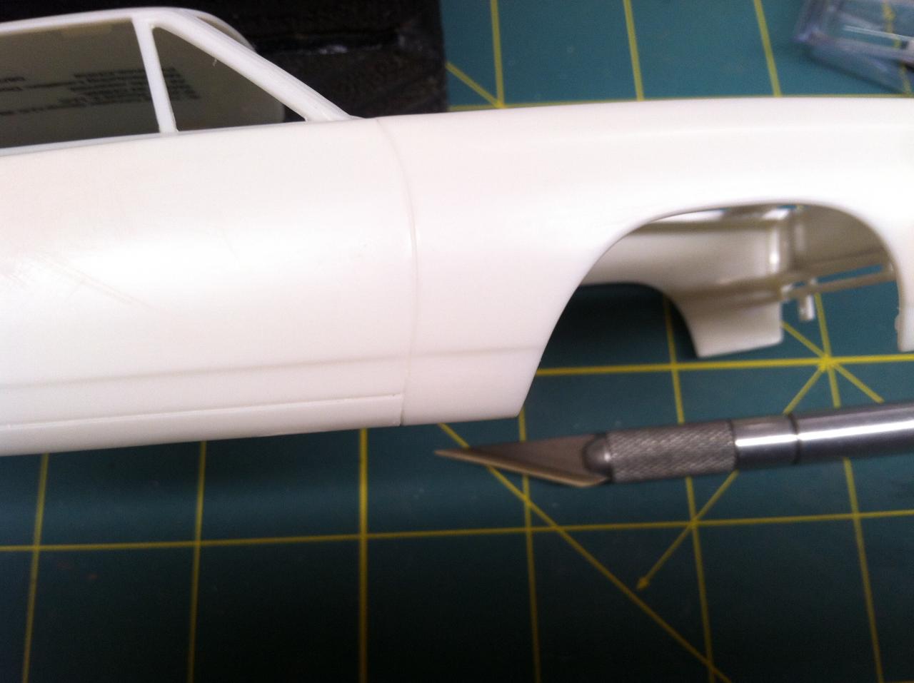

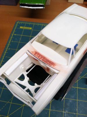

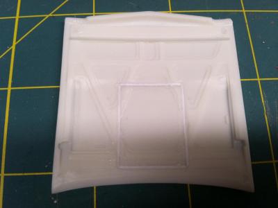

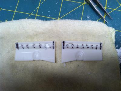

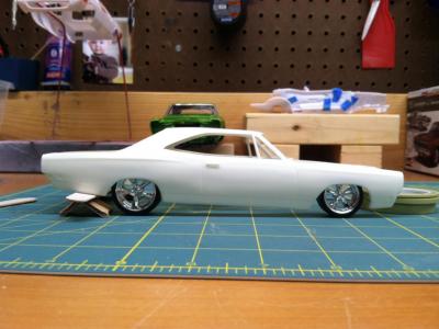

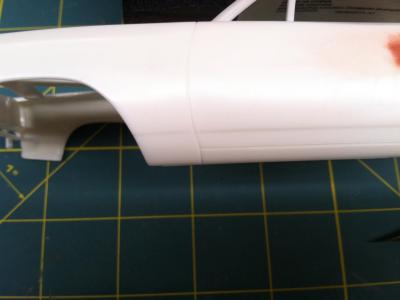

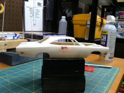

Small update. I've made a little progress but I only get about 3 or 4 hours a week of build time so I thought I would show some pics. I finished sanding the body work smoothed the vents on the cowl panel and filled in the thin gap under the hood with some styrene. Also I scribed out the partition between the front fenders and the rocker panels and decided to lower the rear end a little bit more so I now have the stance I want, I started to scribe out the window moldings but man is that a PITA. I think I'm just going to do the moldings a little at a time. Even though there isn't a lot done thought I would give an update any way.

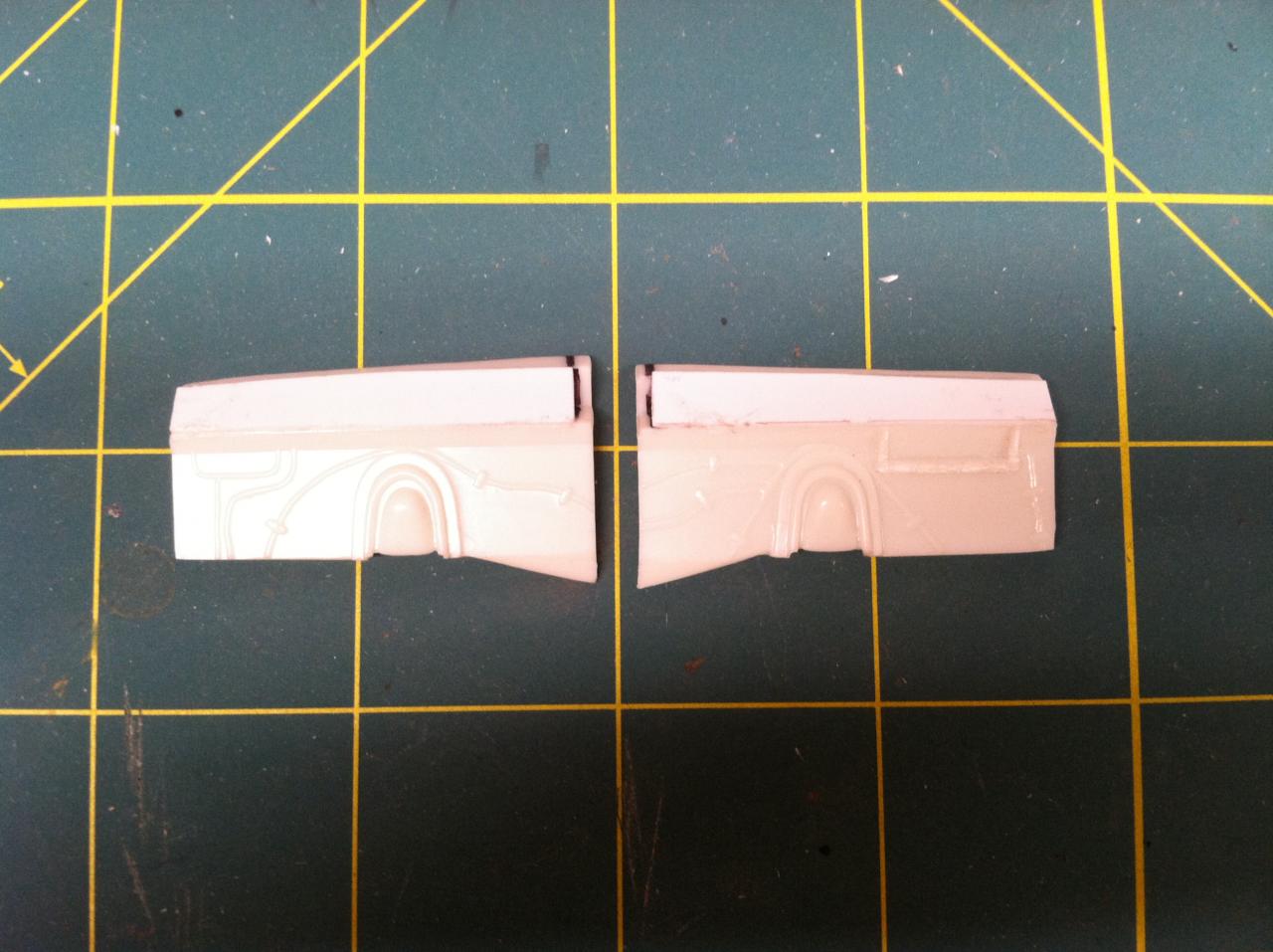

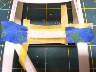

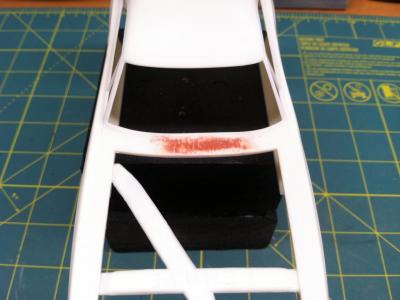

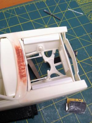

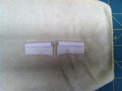

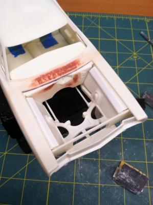

Here are some more pics of the modifications that I did. I smoothed out the inner fender wells so that the engine compartment had a cleaner look. i also cut about an 1/8th inch off the bottom of the firewall, radiator support,and inner fender wells so that I could get it to sit low. Next step will be the suspension mods. Here are some pics of the progress.... Well I wanted to down load more pics of my progress but for some reason it wouldn't work but at least you can see how the engine compartment turned out. Feel free to ask any questions.

Sorry about the poor quality pics. I hope you can make out what I did. I'll try to take better pics next time.
