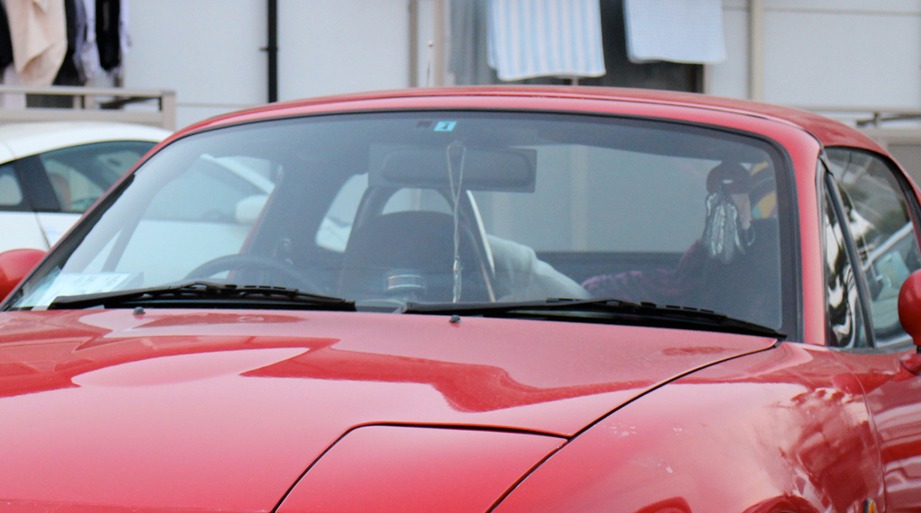

sjordan2 Posted August 28, 2014 Posted August 28, 2014 It appears this is a Mazda Miata, which seems to have both a black seal on the outside of the glass and a black-painted surround on the inside of the glass. There are some good suggestions on this page, and here's another tutorial: http://www.italianhorses.net/Tutorials/Window%20Masks/masks.htm
