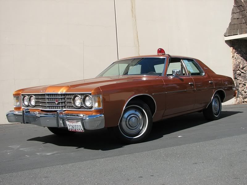

However I imagine just about ever factory color has been used on an unmarked Police Car at one time or another. I can't say I've personally seen a Yellow one but the Green 70 Catalina Traffic unit I mentioned before was replace by a Burnt Orange 74 Ford Galaxie very similar to the one shown in the photo below.
As I recall that one was very effective at blending in, I saw in use on great many number of traffic stops.
now i like that!
Yeah i read a lot about him, the budget and the cars etc. pretty interesting. Would that burnt orange work before 74? i know lots of US cars were given new colours esp for the car and year, im sure.
