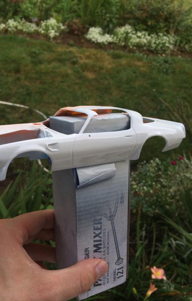

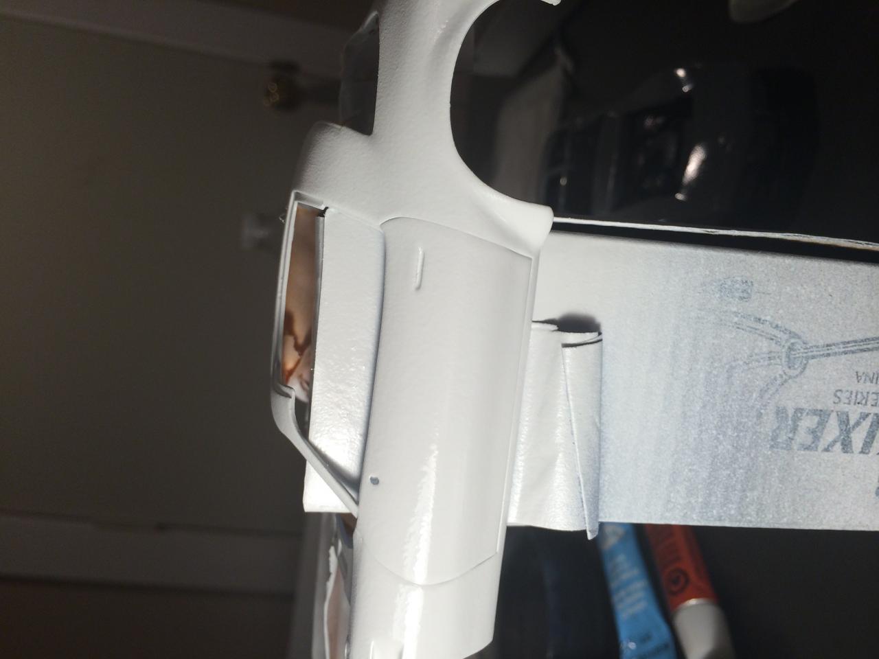

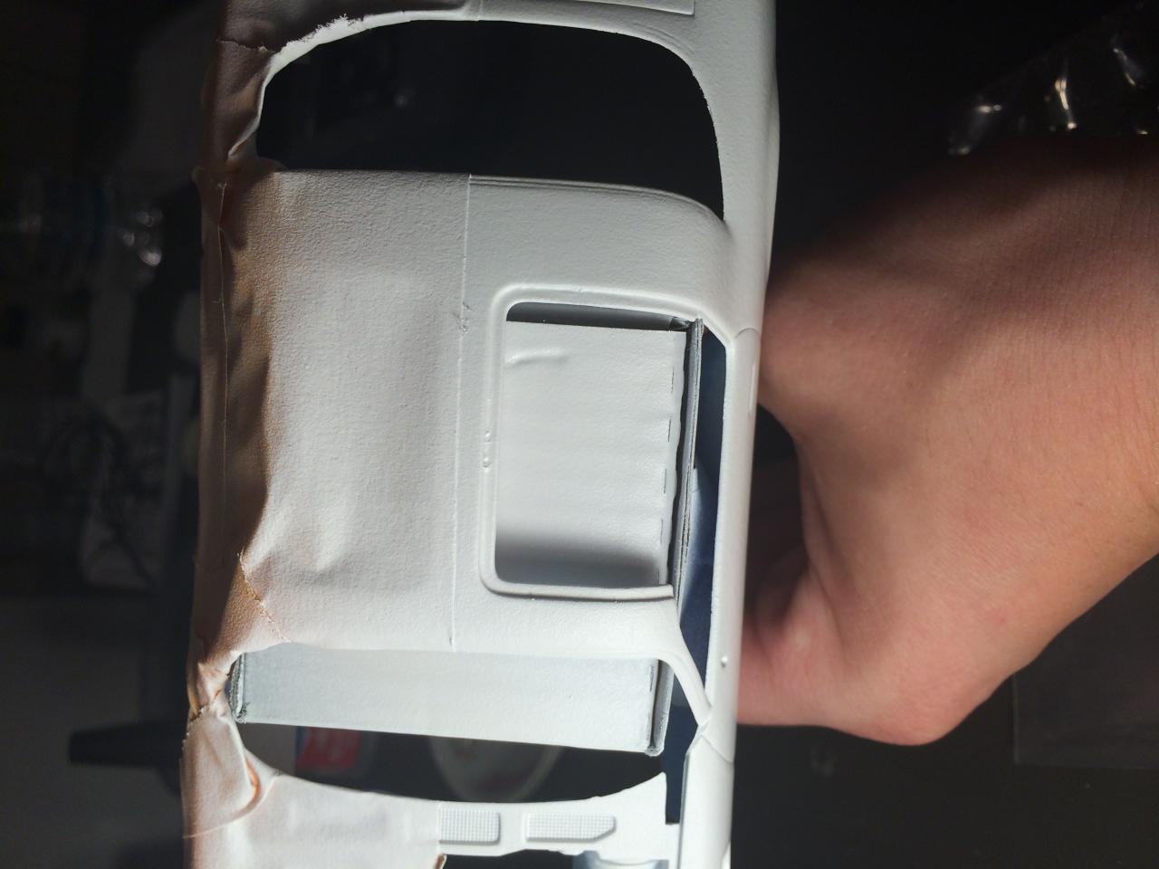

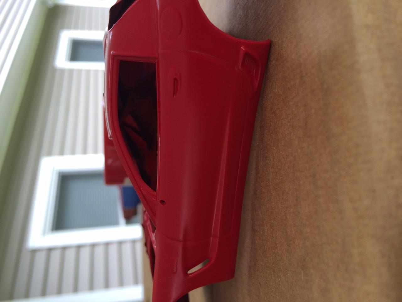

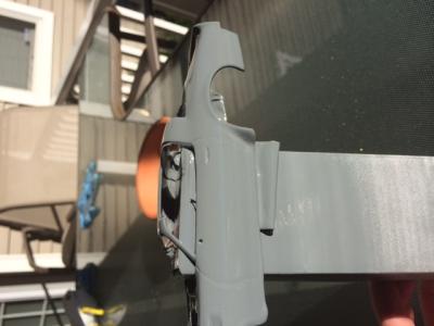

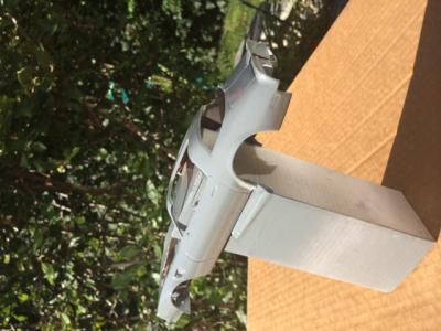

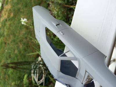

1hobby1 Posted September 3, 2014 Author Posted September 3, 2014 (edited) I have about 5 bodies to practice on. If I tape off half the car that gives me 10 practice sides to practice. I'm going to go with that for now, and its more fun painting a body than a spoon . But I have read that plastic spoons make great practice and I will try that out as well. This was sprayed with Rustoleum Plastic Primer. So today I washed and sanded down a practice body after paint stripping it with purple power. Here are my pictures of 1st, 2nd, and 3rd coat of primer. 1st. I sprayed about 6in away from body and it covered very smooth with a glossy finish. Second coat went on 15min after first coat. It was also a wet coat and was smooth and glossy Third coat went on 15min after the 2nd and I began to see some orange peel with this coat. I will let it dry and air out for a couple days. From what I have read and been told I should sand this to smooth out the orange peel correct before applying paint? Once again feel free to chime in with advice, this is becoming a very very helpful thread! Thank you! Edited September 3, 2014 by 1hobby1
Ace-Garageguy Posted September 4, 2014 Posted September 4, 2014 Yes, that much peel will make your color coats look like hell. What kind of primer are you shooting? Coats one and 2 look really good. If there's no bodywork on your model that you need to fill with primer and re-sand to get rid of coarse scratches, you can probably get by with ONE primer coat if it's as lick as your first one. Do the toothbrush-Comet scuff (be sure to look for areas that may need blocking however) and paint. You're getting a little heavy primer buildup at this point...starting to fill the rear door line,,,so you might want to strip her again.
1hobby1 Posted September 4, 2014 Author Posted September 4, 2014 I have 1/2 the car taped off so I can always try the other half with 2 coats and see the difference instead of constantly stripping the whole body. I am shooting with rustoleum plastic primer. Next time I am only going to do 2 coats though. the third was a little much for body lines. should I switch to the dupli color? I believe its called dupli color scratch filler primer now? Also of now, Should I try sanding from 1800 threw 3200? to smooth it out for paint? and see the results? thanks again Ace, Been a huge help!

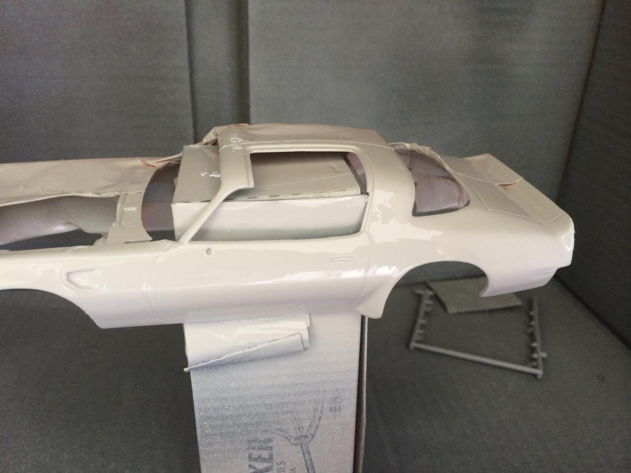

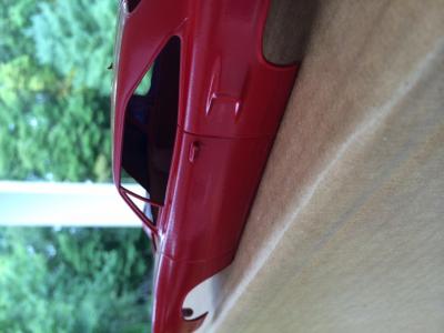

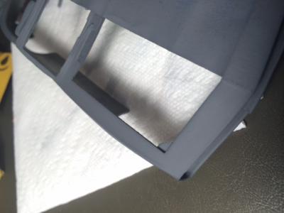

1hobby1 Posted September 8, 2014 Author Posted September 8, 2014 So today I had sometime to do some practice on some spare body's. The first is a Revell kit Trans Am. the body was not perfect whats so ever so I just wanted to practice good coverage. I sprayed closer than before and It covered the first coat great I almost didn't think I needed a seconded coat. Should I have sanded in between? I ask that because on my second coat It seemed to be to thick. I know spray cans spray more than model paint but like I said earlier in the thread I would like to get good with a spray can. This is still the rustoleum paint, but I will be purchasing dupli-color tomorrow for some more practice. Here are my practice results. coat 1: minimal orange peel compared to my first paint job. coat 2 : Very heavy coverage. I definitely sprayed to much. Live and learn! Now This is another body I stripped and is a practice body. I do not know who made this kit but the Plastic on this was different from the Revell Plastic. On this I used Rustoleum Sandable primer. The coverage was GREAT! smooth, and very forgiving and easy to work with. plus it dried very fast! Then this happened. that good primer, not so good. Im still going to try it on a revell kit because this plastic was different. But the primer may be to "hot" for plastic. Hopefully this helps other new model builders on the site! feel free to chime in!
Ace-Garageguy Posted September 8, 2014 Posted September 8, 2014 (edited) Ah yes, the reason for always testing on a hidden part of the particular model you're working on rather than just assuming it will be OK and going ahead and painting. Well done, grasshopper. Edited September 8, 2014 by Ace-Garageguy

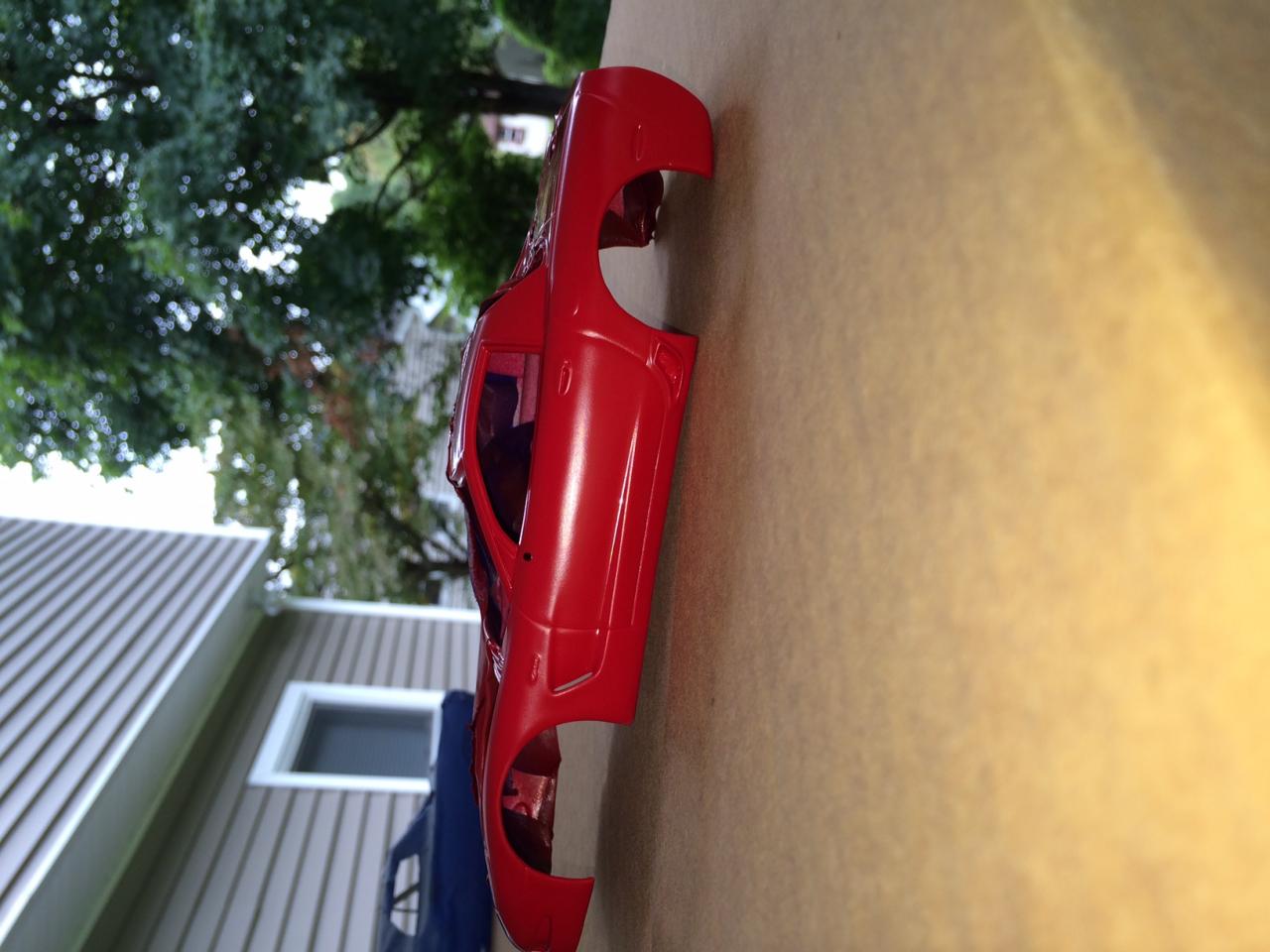

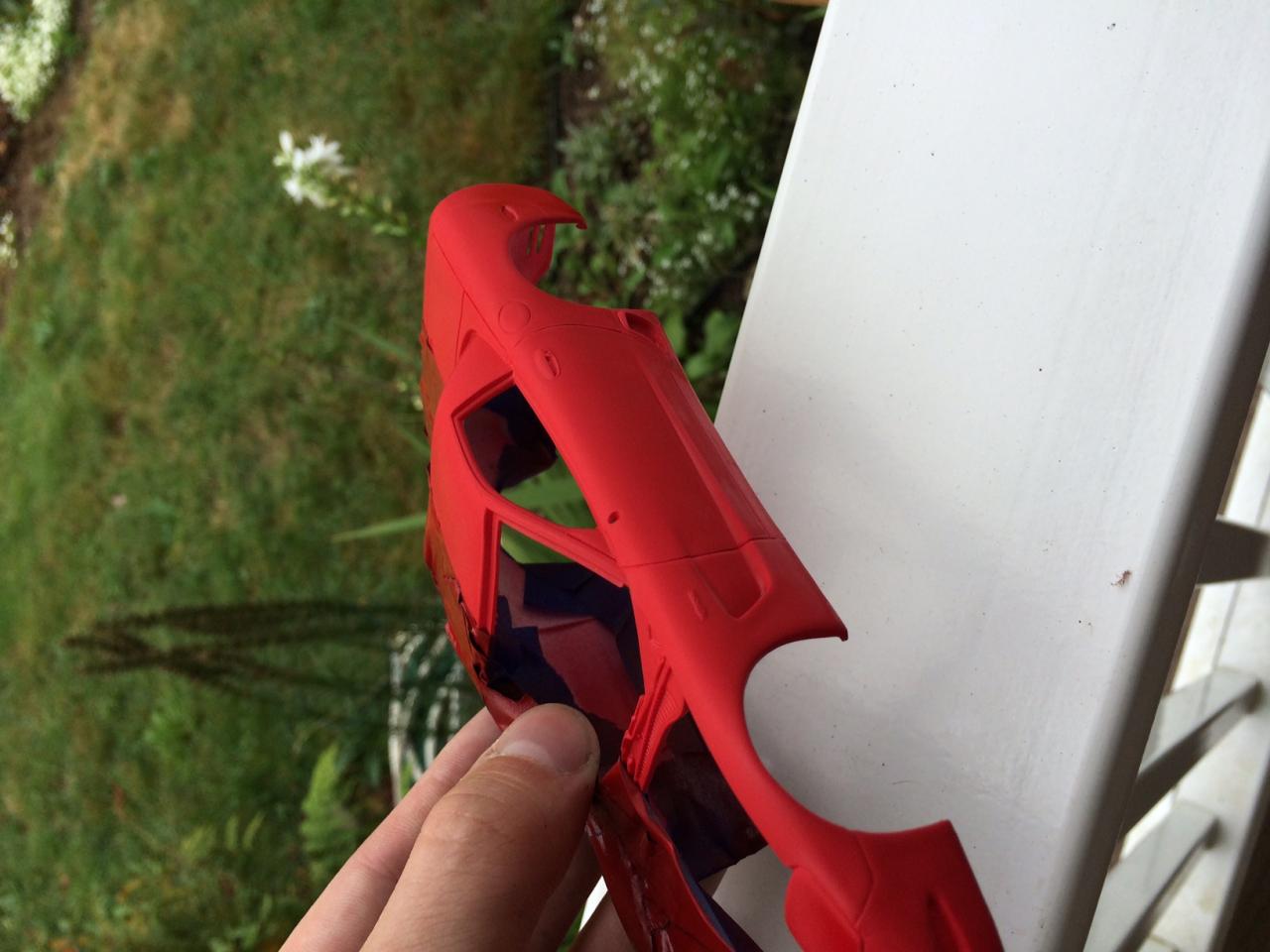

1hobby1 Posted September 9, 2014 Author Posted September 9, 2014 Got some dupli-color primer and color today and sprayed two separate bodies. One with no clear and one with testors clear. I must say the results are much much better than the rustoleum products!
1hobby1 Posted September 10, 2014 Author Posted September 10, 2014 On 9/9/2014 at 10:44 PM, Ace-Garageguy said: Yes, I thought you'd like it. Sprays very very nice. Easy to control, I am sold on it. I am going to post some pictures tomorrow of the outcome. I also used Tamiya clear over it. came out great! (well for me atleast hahaha). Im going to try the polishing process on it as well.

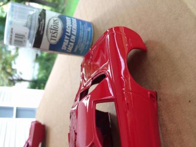

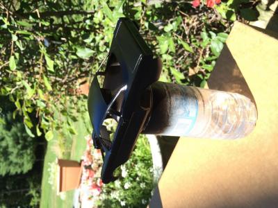

1hobby1 Posted September 10, 2014 Author Posted September 10, 2014 Here is the duplicolor Primer after 2 coats: 3 coats of paint, no clear: Here is duplicolor paint with no primer under: 1st coat: 2nd: 3rd: 3 coats of clear:

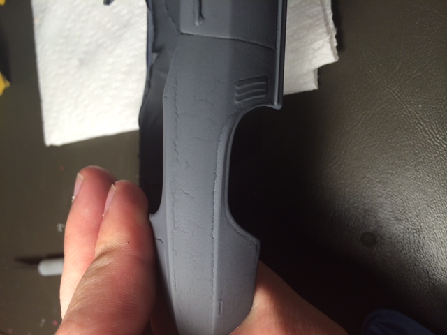

1hobby1 Posted September 14, 2014 Author Posted September 14, 2014 On 9/14/2014 at 4:13 AM, sliferkiller said: So what was the verdict on the Rustoleum primer? I want to use it on a Revell body, but only if it works! Also will the Tamiya clear be glossy after wax and polish or will i have to get the glossy clear for it to shine? The Rustoleum plastic primer is ok. its thick though. The Rustoleum sandable primer is too 'hot' for plastics. It begins to craze. From what I've been guided towards, as well as used is the Duplicolor Primer and Paint. I'm a very big fan, in fact, I just sprayed another model with it today and once again good results. For the clear, I used the Testors and it was pretty good. came out glossy and smooth. All depends how glossy you want the paint to be I guess. For me it was a good amount of shine without any wax. I was impressed. I let one of the body's I had with duplicolor paint (no clear) gas out for a week and used the Rustoleum clear on it today and it had a much glossier look. I did one pretty wet coat and it was enough. The Model I am on now is a 66 Shelby GT350 and I want to have the stripe decals. I'm probably going to use the testors clear because it doesn't spray out as thick as the rustoleum so it will be easier to control. But if I do a body with no decals on it I think the Rustoleum clear may be my first choice. If there is one thing I learned is trial and error. This is what has worked for me with practice models. I just painted the GT350 (which is not a practice car) and it came out way better than my first car. I'll post some pictures of it later or tomorrow.

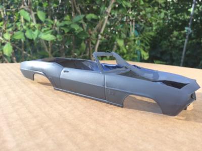

1hobby1 Posted September 14, 2014 Author Posted September 14, 2014 (edited) Here is duplicolor primer and duplicolor universal black with no clear coat. Edited September 15, 2014 by 1hobby1

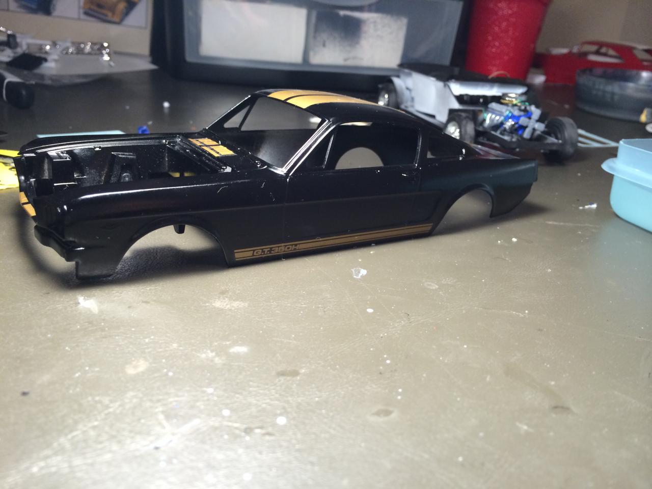

1hobby1 Posted September 21, 2014 Author Posted September 21, 2014 Been a while but I'm back with another question! So I've been working on this 66' shelby gt350 and I never applied decals on a body before. So today I went for it. Did it come out perfect? No, but much better than expected for my first time. Anyways, the decals are drying on the body and I was wondering if I NEED to clear coat the body with the decals OR can it stay as is with no clear coat? The clear would be Testors spray lacquer. Any words of advice would help greatly! Thanks!
