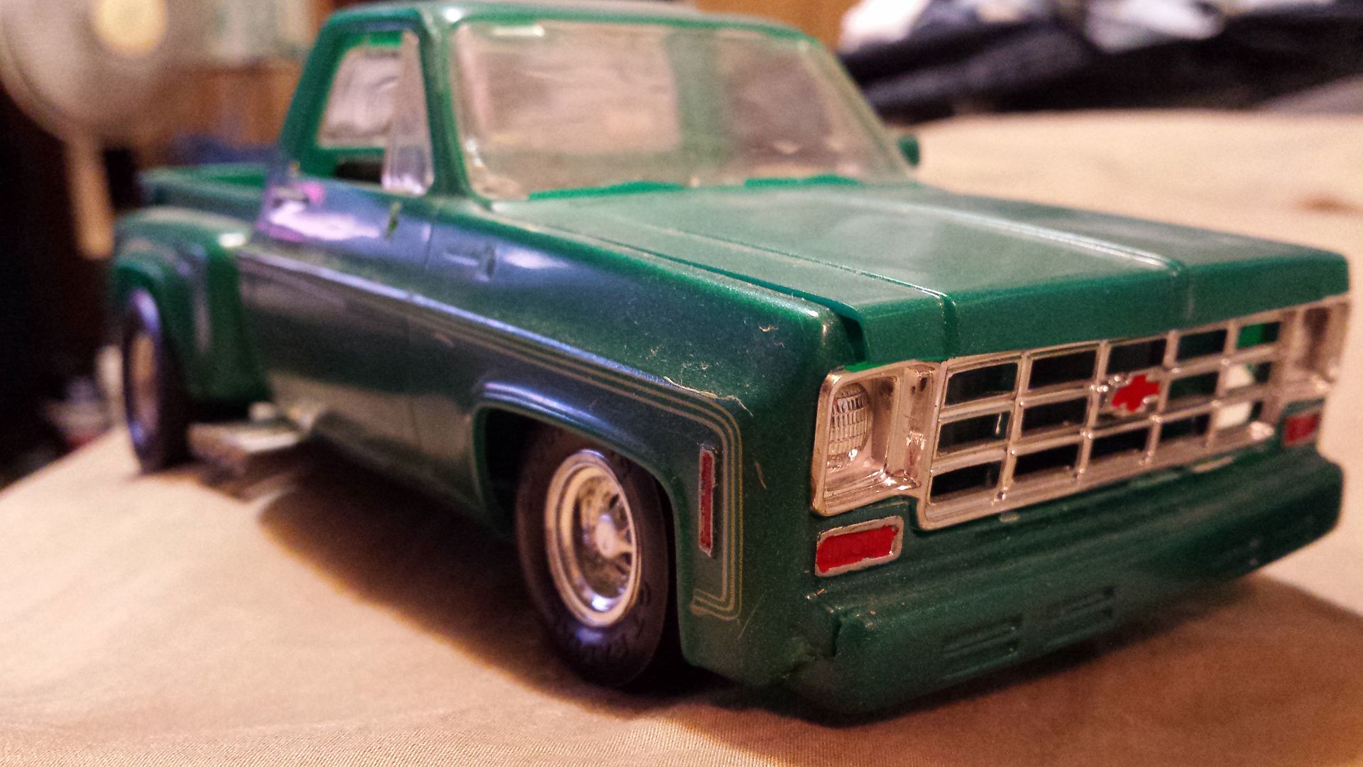

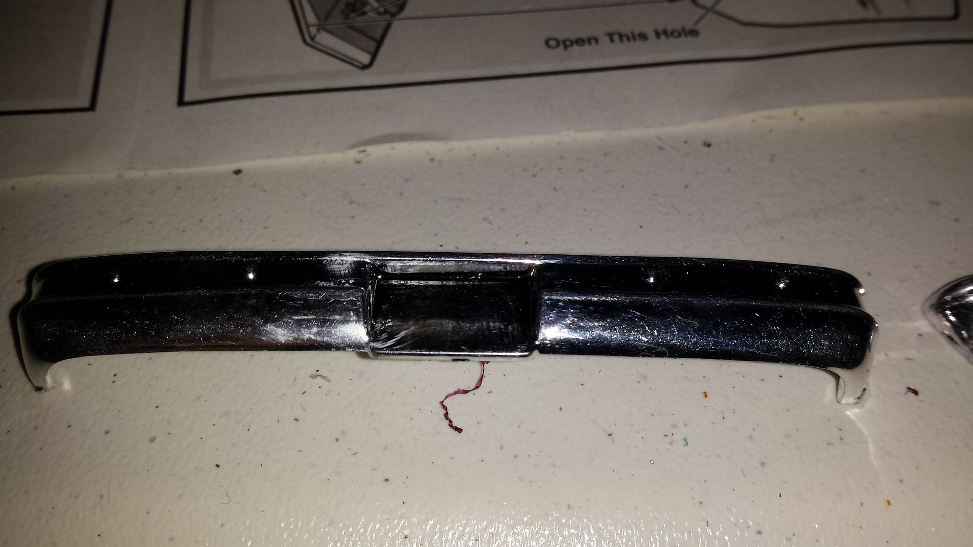

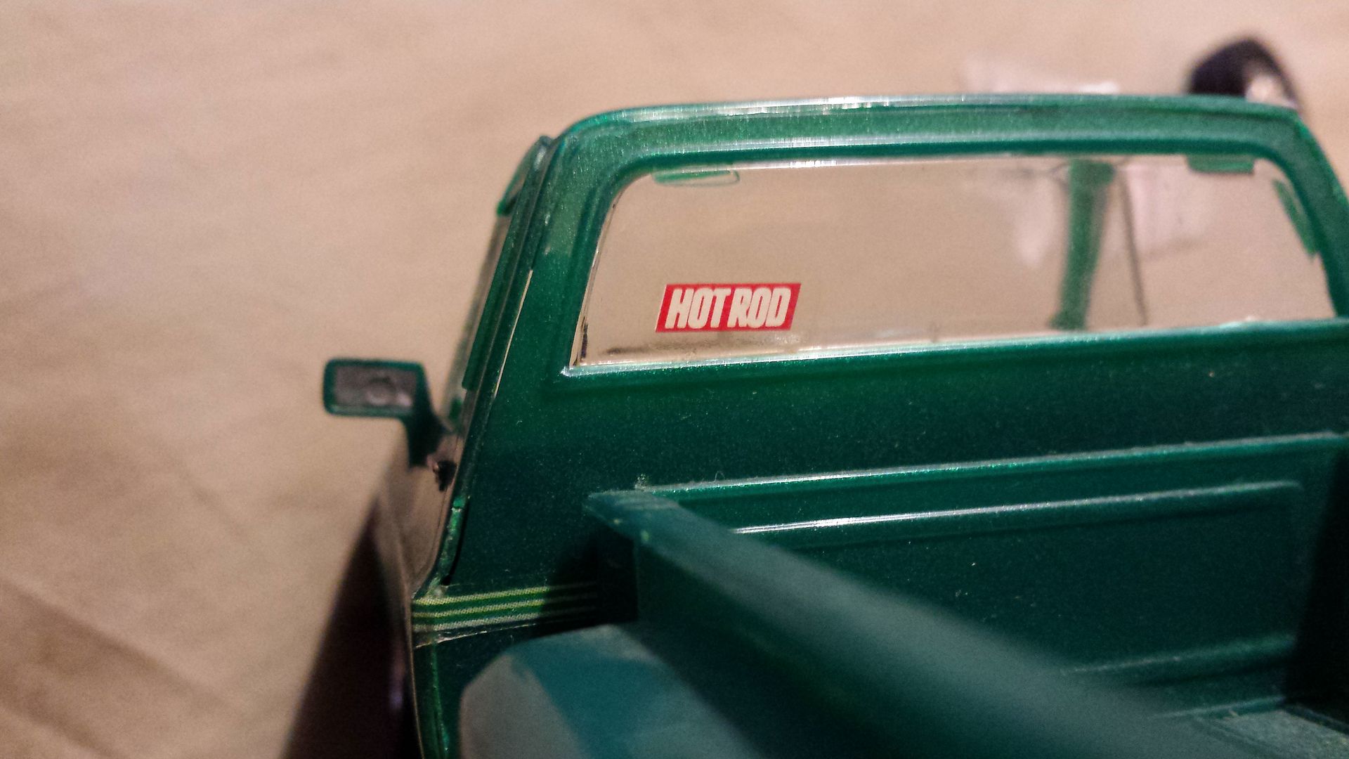

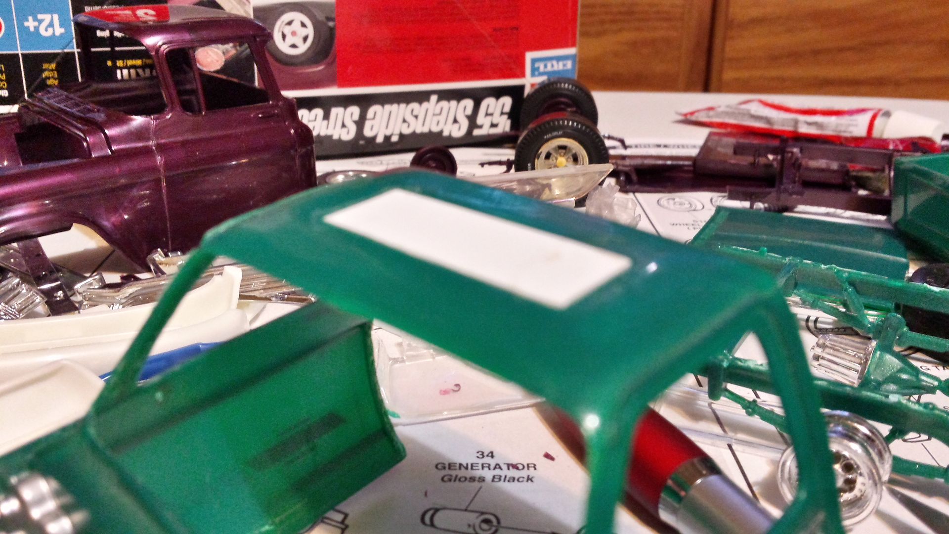

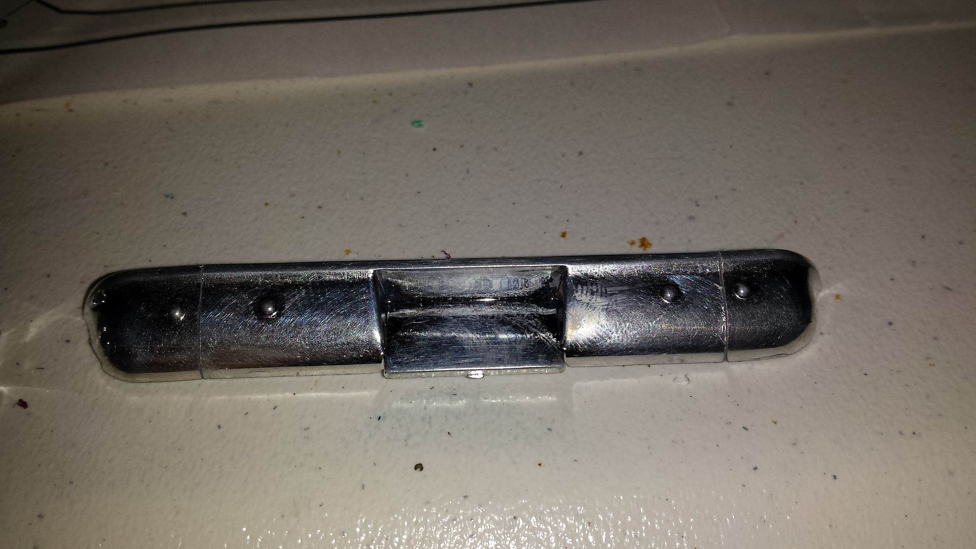

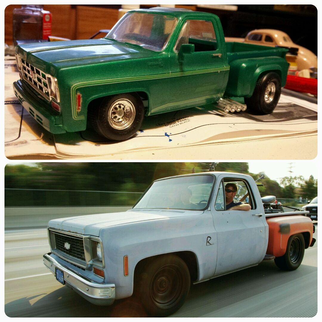

JTalmage Posted September 12, 2014 Posted September 12, 2014 (edited) So as if I dont have enough going in my small build space I just couldnt keep my hands off this truck. It's the '74 Chevy C10 as seen on the YouTube hit series "Roadkill" from Hot Rod Magazine! I was just randomly browsing Ebay when I came across this truck and instantly knew it had to be the Muscle Truck! So I let it sit on the shelf for a little while before it finally ate at me enough to tear it apart I already have a '55 Chevy truck I started working on... but I couldnt help myself! I also filled in the roof to get rid of the sunroof that this kit came with. I won a lot of bumpers on Ebay because it had C10 bumpers. They're the larger 1:24th scale bumpers but with a little bending and convincing, the front looks great, and I sectioned the rear bumper to get the right width. Sorry for the dark pictures. I couldnt get my phone to take great pics. I was sent some taillights for it by a generous member here, which is much appreciated! I'm on the hunt for an LSx engine, and I'll have to be ordering the correct resin automatic trans, and a Ford 9" axle probably from B-N-L resins. I will have to scratch build the frame because its not correct for what the Muscle Truck has under it, and also do some other small scratch and modified things to get it just right. So thats it for now! Edited January 14, 2015 by JTalmage

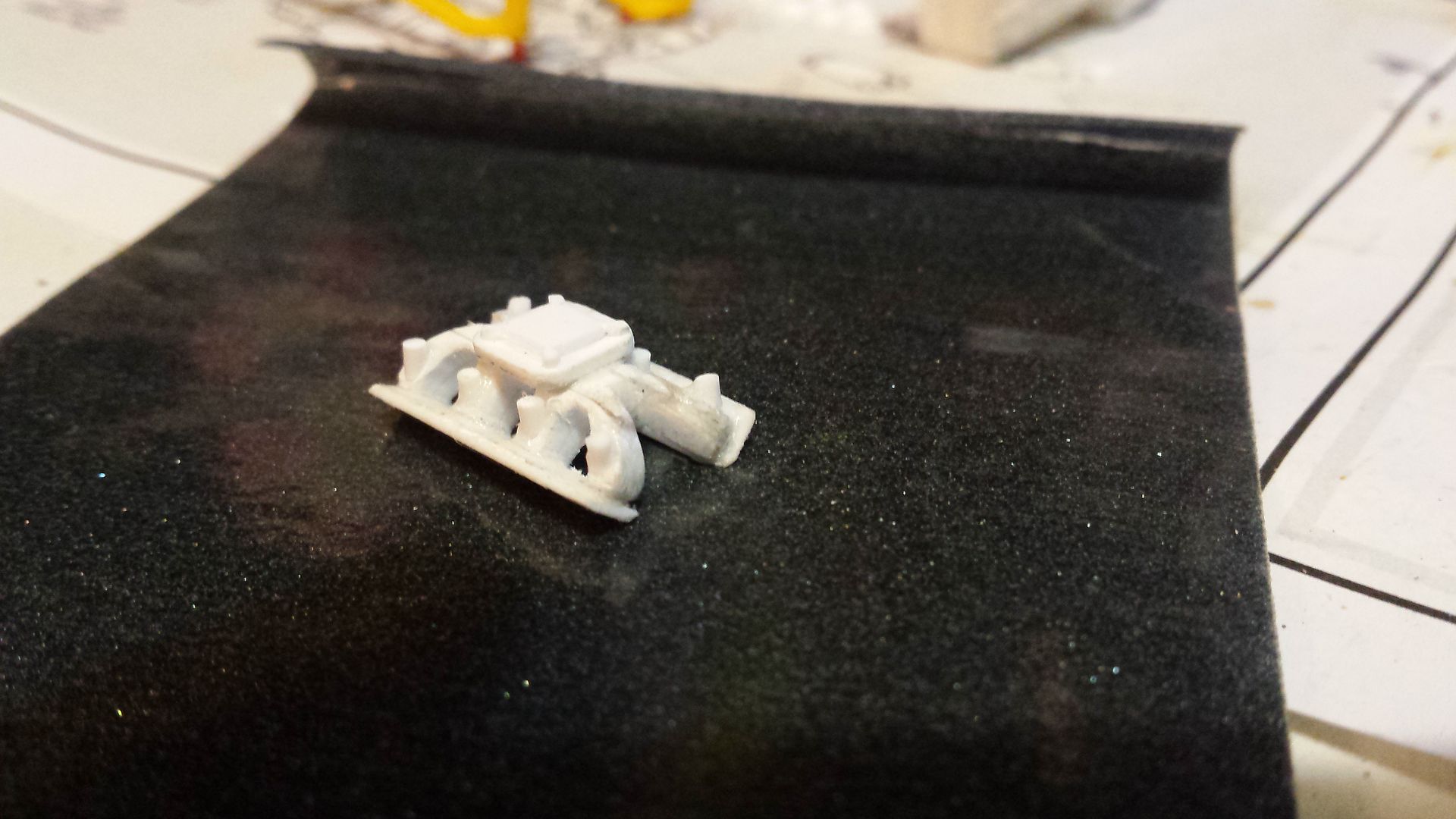

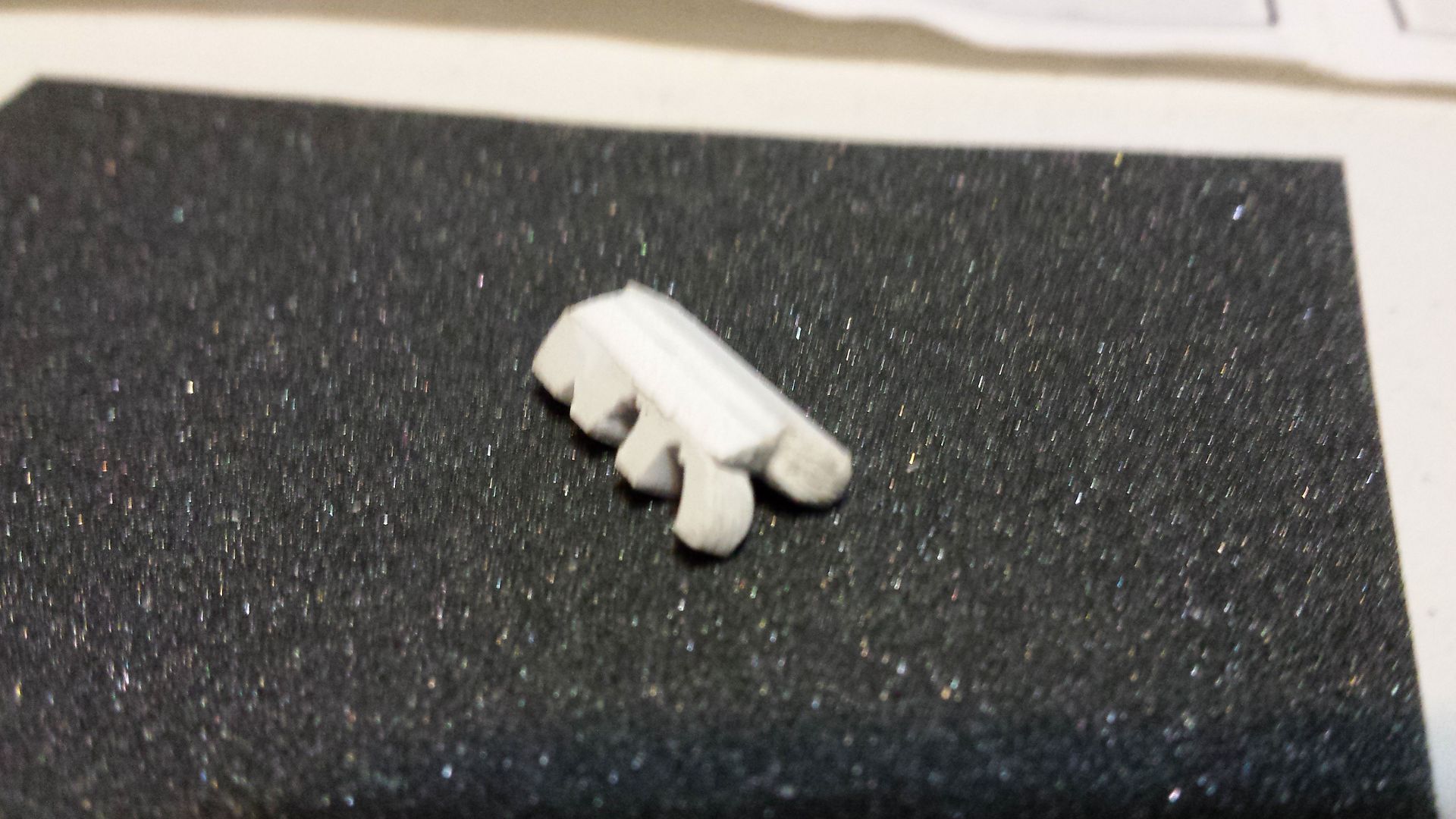

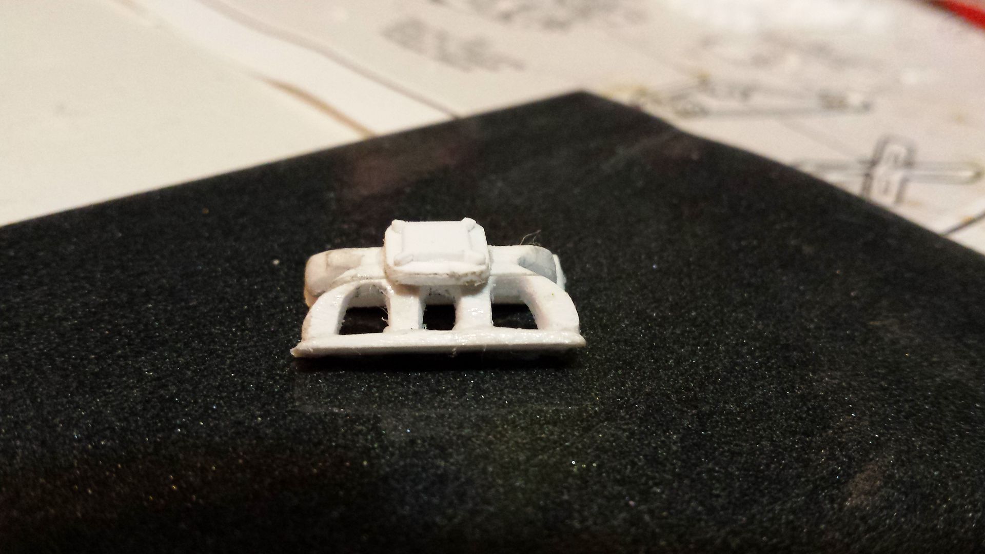

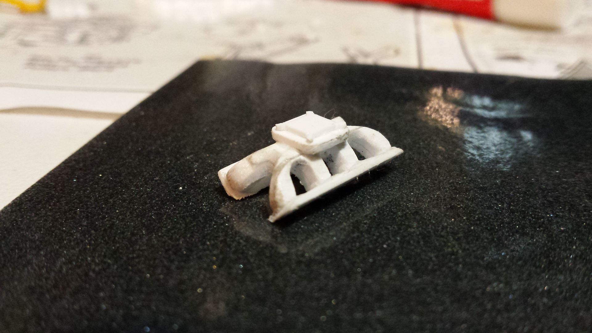

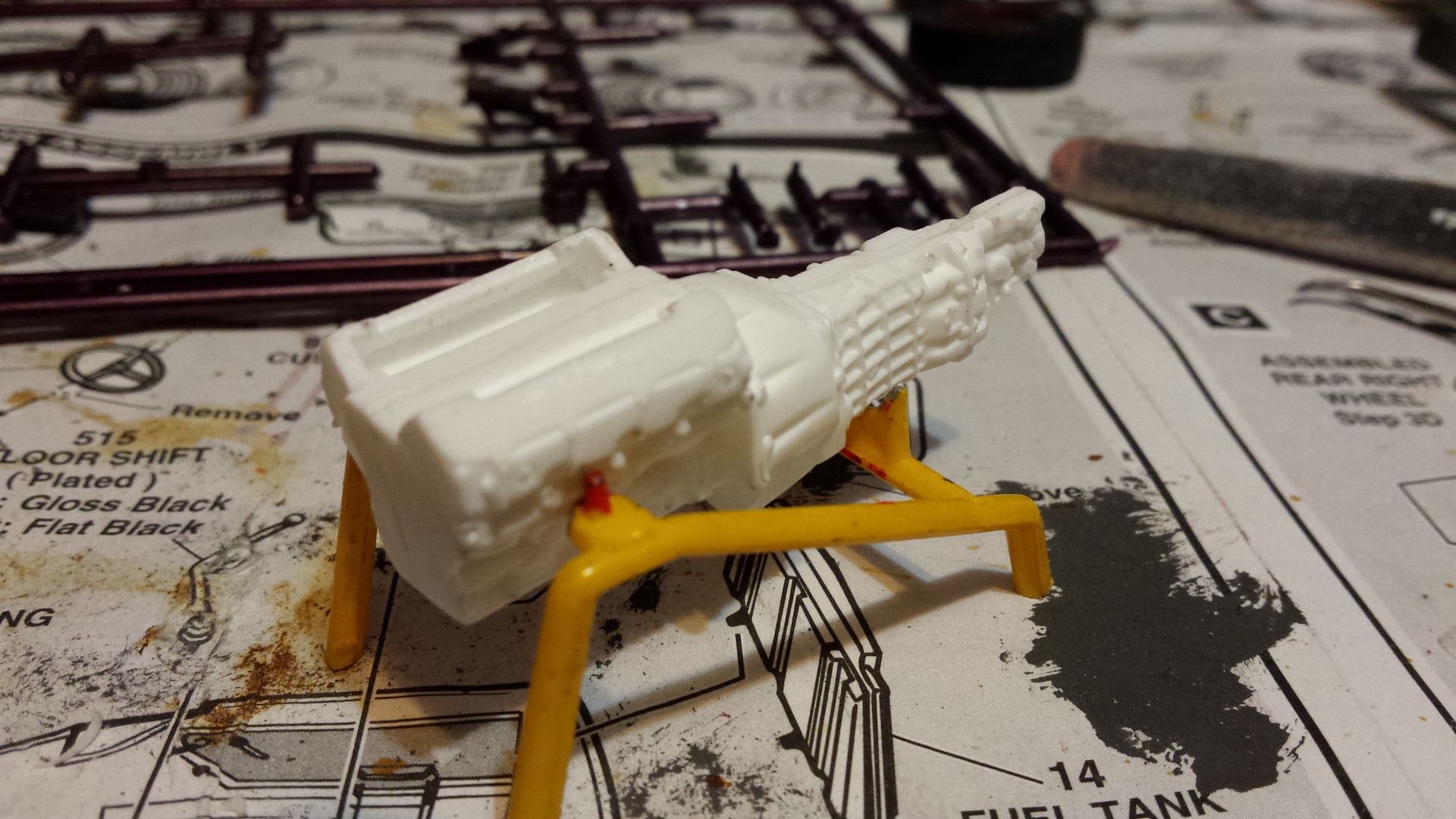

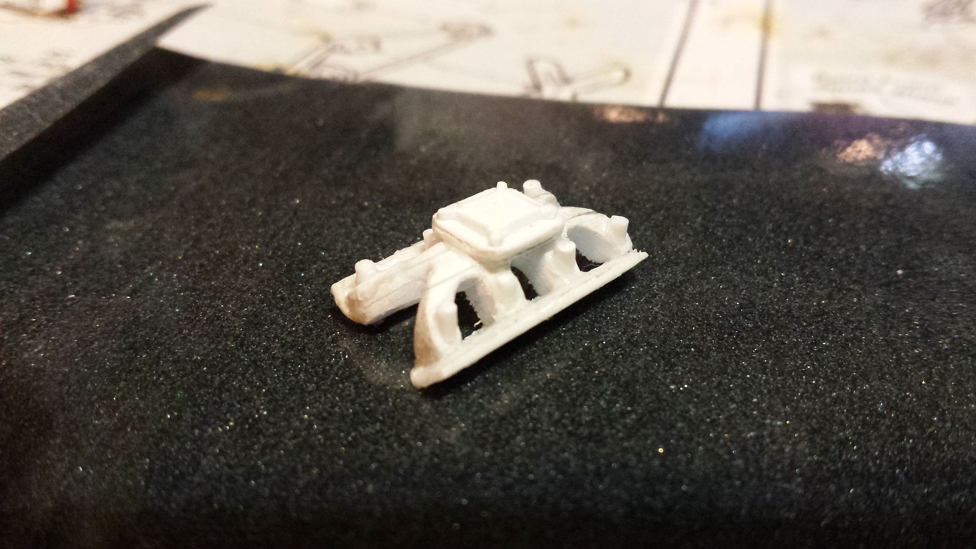

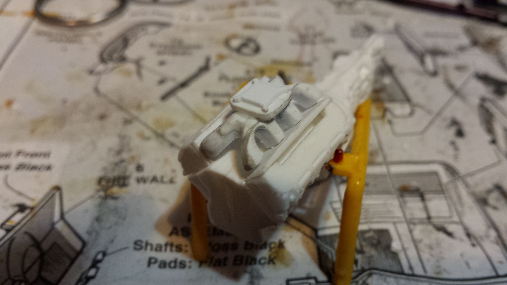

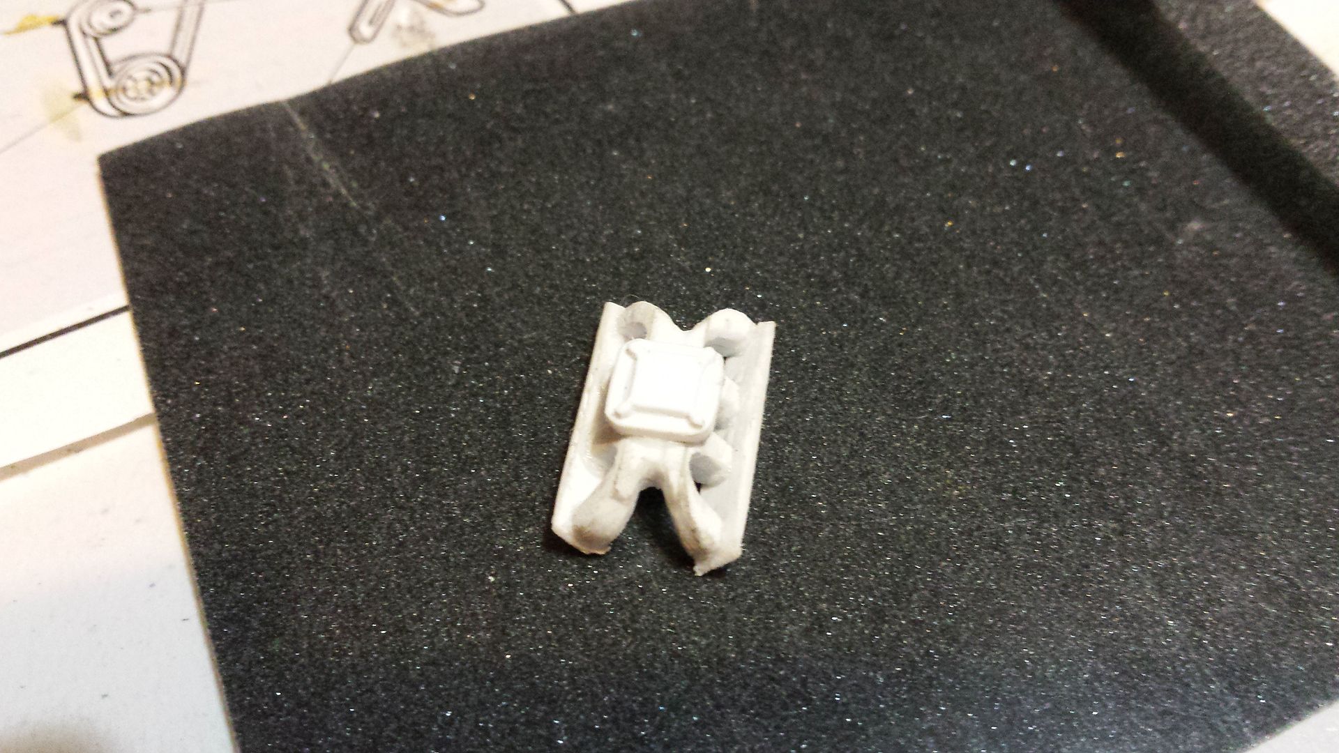

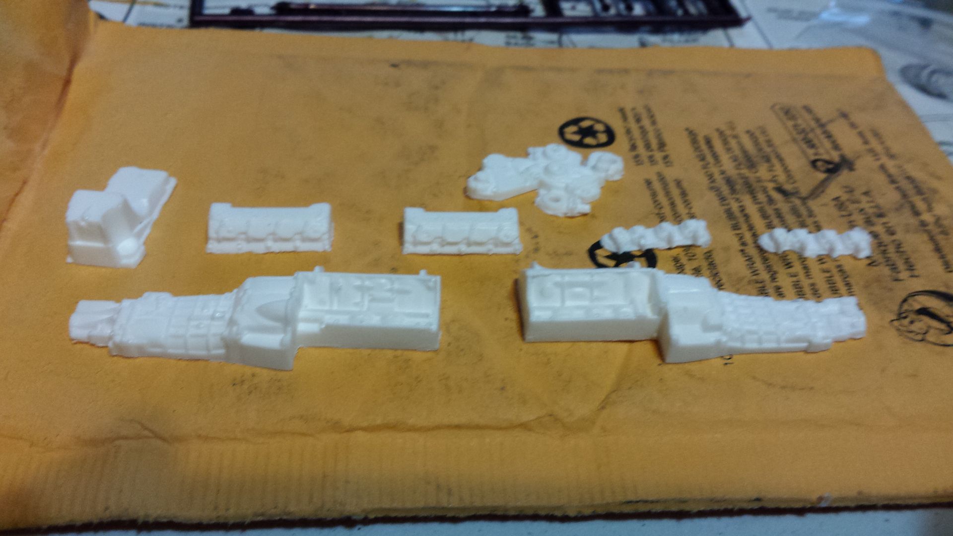

JTalmage Posted September 26, 2014 Author Posted September 26, 2014 (edited) I got an LS engine for this build from Manny @ VCG Resins. So I started to build my LsX intake for it so I can build the Muscle Truck in it's carb'd format. Pretty sweet engine. Looks like it has a 6 speed on the back of it. I'll be sawing that off for an automatic to go on the back though. So I started building an intake out of some styrene strips. I bought some Evergreen 157 a while back to make hot rod frames, and it looked like I could cut some lengths of it and bend it for intake runners. Well that idea didnt pan out so well. So I cut more strips of it and stacked them on themselves and glued them together with some zap. Sat them into the intake valley and glued them together at an angle. I had cut and temporarily glued some strips to the insides of the heads since the actual kit intake is a supercharger. This will simulate the intake side of the head and the beginning of the runners. I am not very good at doing detailed scratch building so I did the best I could. Since my first attempt failed at shaping it I decided to carve it. And that worked out pretty well. I did lots of sanding and carving. This was the first stop I took to take a picture. Lots more sanding and carving later... As you can see I added a carb riser and a carb plate to it. I'll sand the top down just a little so its not as intrusive. Still have to do some more sanding and filling/filing. I also put some injector bosses on the intake as the real lsX intake does. Edited January 14, 2015 by JTalmage

1930fordpickup Posted September 29, 2014 Posted September 29, 2014 Jesse the intake looks so far. The more scratch building you do the better off you will be. Just remember it is only plastic and go for it.
JTalmage Posted September 29, 2014 Author Posted September 29, 2014 (edited) Thanks! I need better tools to do it though. I'm using basic xacto knives, some sanding sticks, zap-a-gap, and sandpaper. no microscope or magnifying glass lol I'm having a hard time progressing on this truck because I keep forgetting I have to send the intake away to the resin caster first instead of painting it and gluing it on my engine. lol Edited September 29, 2014 by JTalmage
