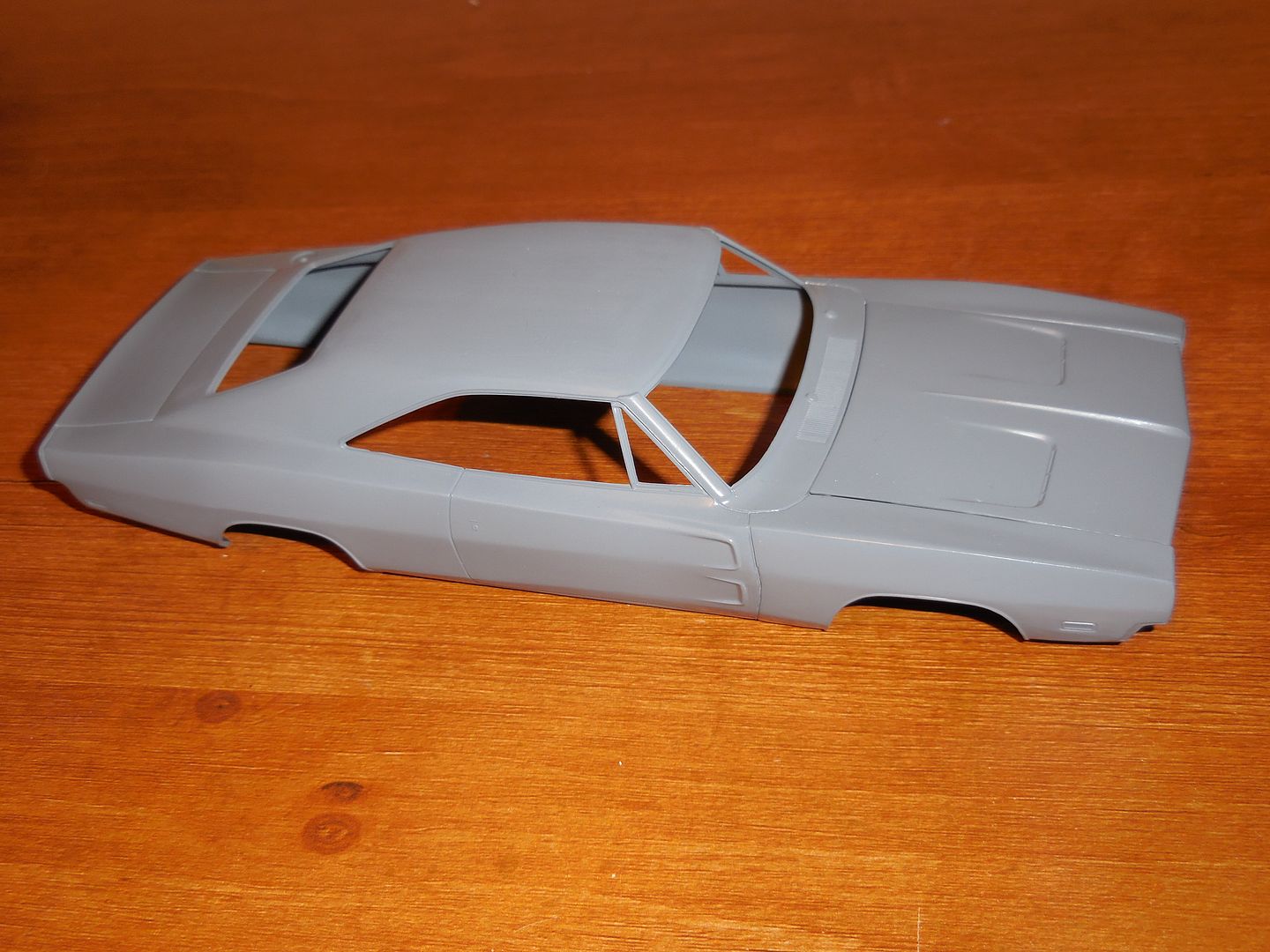

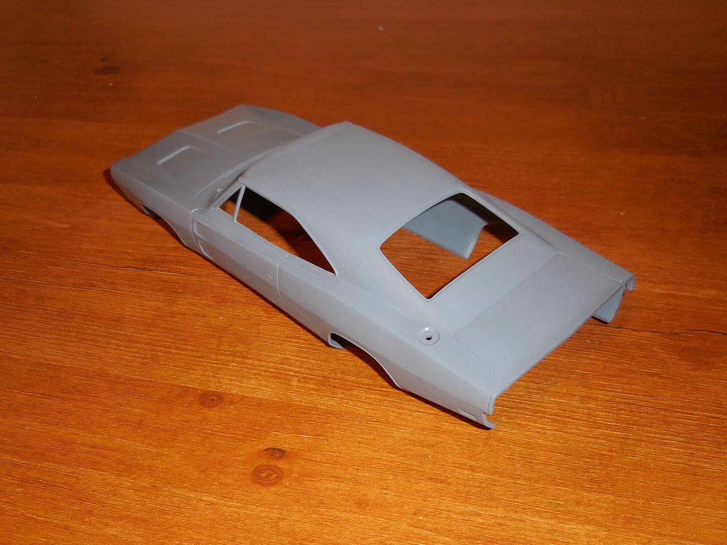

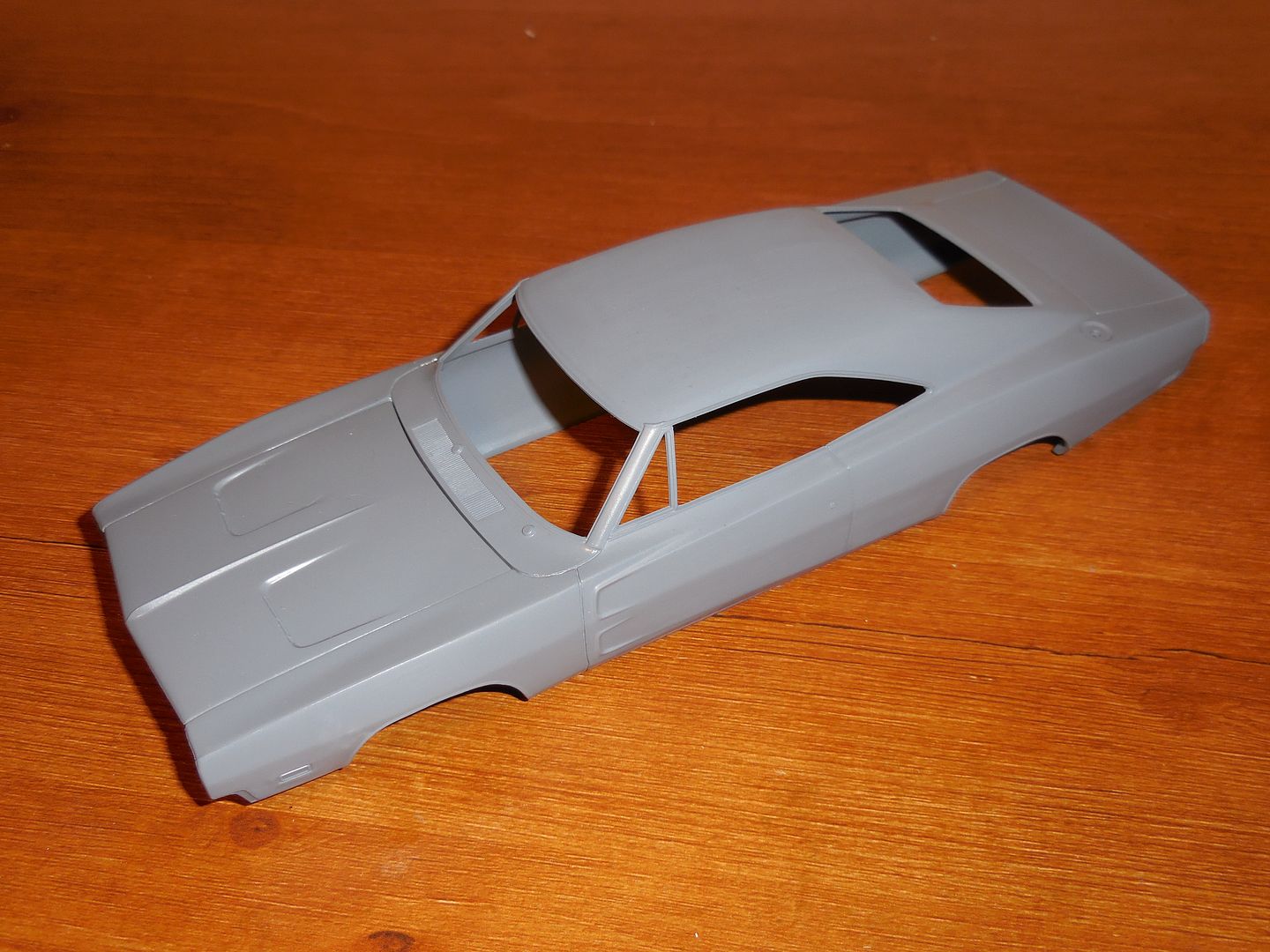

I have one that I have been playing with for a few years now. I was not very serious about a 69 Charger 500 when I started. I had an extra Daytona body and decided to cut off the front fenders and swap nose's. It came out nice. Now that the bodywork in 95% done I'm working on the grill. Here is my progress photos.
Edited by Sport Suburban

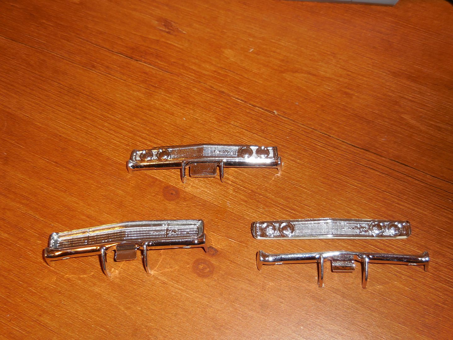

I have the 68 Charger bumper and an extra MPC grill. My thoughts are to trim it down and fit it inside the 68 Charger grill. The other bumper is the Revell 69 with the grill cut off. The MPC grill is wide enough but somewhat narrow.
As far as sales go. How well did the Missing Link 70 Charger conversion sell? I think that kit would sell better than a 69 Charger 500. That is just my opinion thou.
