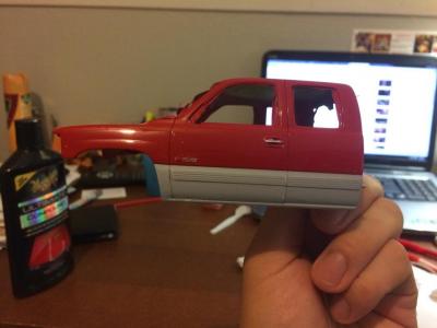

addicted2modeling Posted September 22, 2014 Posted September 22, 2014 As I peeled off the masking tape to work on the lower end, some bits of primer was peeled off along with the tape. Since this is primer, and its not too much of a concern for me, but since this incident happened, I am worried that if I mask off the top end to paint the lower, it can happen. How do I prevent this?

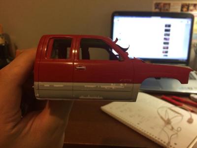

addicted2modeling Posted September 24, 2014 Author Posted September 24, 2014 I'm about to mask off the top end. I have Tamiya's 6mm masking tape, a roll of Scotch's automotive performance green masking tape, and a Scotch blue painter's tape. Which of these is better to use to mask off the top part of the truck so I can paint the lower half. I don't want to remove the masking tape and find some red paint chipping on the tape when im finished.
