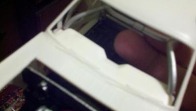

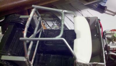

topher5150 Posted October 1, 2014 Posted October 1, 2014 This is in refrence to my "Trans Am Mustang" build http://www.modelcarsmag.com/forums/index.php?showtopic=92375 I need some help with fabbing up some of the roll cage. I've been hacking and cutting at the roll cage for a while now, and I've got most of it to fit, except for the part that runs from the main structure behind the drivers seat, runs the length of the roof and down to "A" pillar, and meets up near the dash. The donar NASCAR roll cage that I'm referring to is way to narrow and looks weird sitting that far from the "A" pillar. My problem is that the roof loop is ellipsed in the front behind the wind shield. I want it to look the same but not sure how to go about bending plastic like that, especially with out any tension trying to pop it out of place. I'll get pics tomorrow
topher5150 Posted October 2, 2014 Author Posted October 2, 2014 I tried cutting a section out in the center to make it fit in width wise, but it tapers to much to the front.

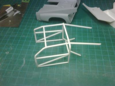

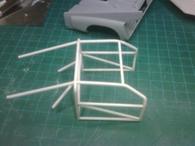

kitbash1 Posted October 11, 2014 Posted October 11, 2014 I'm building the same T/A Mustang. Here's the roll cage that I built using Evergreen rod and tube. I used a roll cage from a NASCAR kit as a basic guide and built my cage on a jig, where I could bend and glue the tubes.
