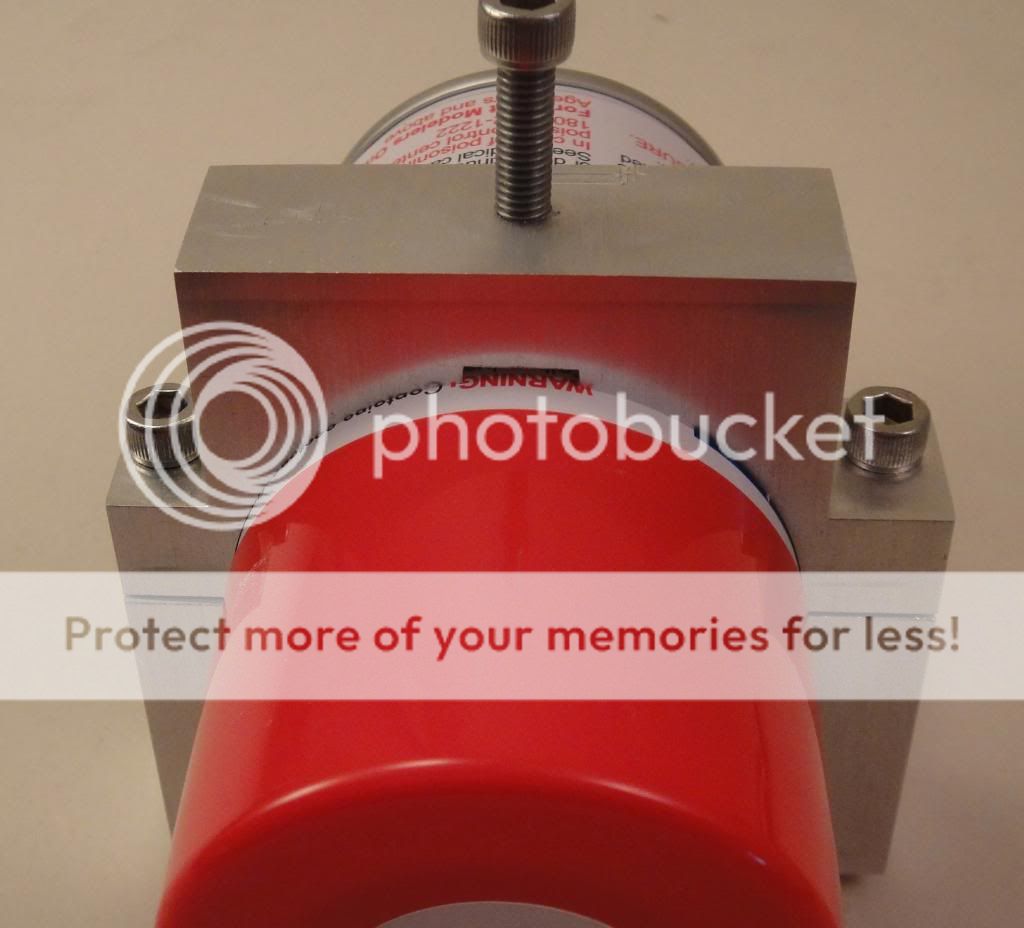

Pete J. Posted November 21, 2014 Posted November 21, 2014 There is a better way to decant paint and that is making holes in the can, but it is not recommended because no matter what I say, there is always someone who won't follow instructions and will hurt themselves. If you happen to have machining capability you can create a safe way to do it. I assume no responsibility for others doing this. Build this jig at your own risk, and no, I will not make one for anyone and no I won't send out plans. It is just my idea but remember you are releasing a flamible liquid and gas. This is no more dangerous than what Bret Greene suggested in the above video. NO IGNITION SOURSES around if you do it!
SfanGoch Posted November 21, 2014 Posted November 21, 2014 A fancy-schmancy method to shotgun a beer, eh?
Pete J. Posted November 21, 2014 Posted November 21, 2014 On 11/21/2014 at 6:25 AM, SfanGoch said: A fancy-schmancy method to shotgun a beer, eh?Pretty much. This just allows you to control the rate of release of the gas. Turn the screw in to make a hole and then open it in small increments to slowly release the propellant. I got the idea from a saddle valve.
