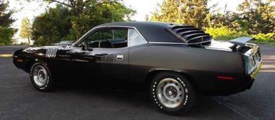

The70judgeman Posted October 7, 2014 Posted October 7, 2014 (edited) @Nick- This is the Phantasm tribute car built by GYC that Gary wants to build. Triple black with black 340 billboards. Edited October 7, 2014 by The70judgeman
Guest Posted October 8, 2014 Posted October 8, 2014 I almost wish I hadn't seen that photo Andy. It makes me want to build one myself! Luckily, I don't have one in the stash ATM or I would be starting yet another project.
The70judgeman Posted October 8, 2014 Posted October 8, 2014 @Roger- I know what you mean. Now that I have another '71 in the stash, you've got me thinking about it too! I think I need to find an AAR or Challenger T/A.
