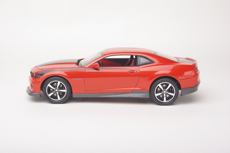

Have a look and see whatcha think, Joe:
This is AMT's. My sample was a huuuuuuge PIA in terms of getting wheel bosses and brake rotor pieces to coexist - but after that, I came away with the impression that it catches a few subtleties that this one does not:
Here's Revell's and you're catching it from the good side. Far more detailed, goes together without major problems; but lookit what you get for stance o o b:
Once you've been through all the grinding necessary to force the wheels on, AMT takes a better set, with more convincing tire profiles to boot:
I think the rear view tells a story too. Check the rear edge of the 1:1 decklid, and you'll see it's pinched and contoured -
More like AMT's and less like the broader slab just under Revell's spoiler.
