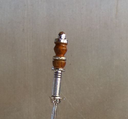

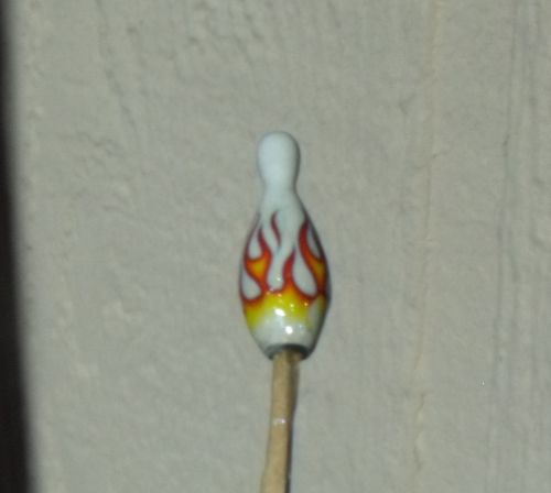

samdiego Posted November 21, 2014 Posted November 21, 2014 (edited) This started when I realized I'd lost the bell for a steam locomotive in HO scale. I chucked a short length of sprue and held the tip of an exacto against it until it was bell shaped. While it was still spinning I touched it with a piece of 1200 grit to smooth it. The whole op only took about 10 minutes. It looks a bit rough in the photo, but the actual bell is smaller than your cursor, prob. One of my signatures is the addition of custom shiftknobs. The Dremel technique occurred to me when I needed a grenade for a Revell '32. Worked like a champ. Then I decided to try a beertap for the 1/8 Big T. This started as a jackstand from a 1/8 kit That was followed by the flaming Bowling Pin for a Big Deuce project. I've also done a radio mic for a '58 Impala that's hard to photo I have a few Dremels but my favorite is is a 750 rechargeable, mostly because they are a little weak and spin slowly enough that they can work styrene without melting it. A couple that didn't need to be lathed. The top photo is a pair of tumbling dice. The Bud Tap handle shifter is for a custom semi-tractor. The eagle is carved from sculpy Edited November 25, 2014 by samdiego

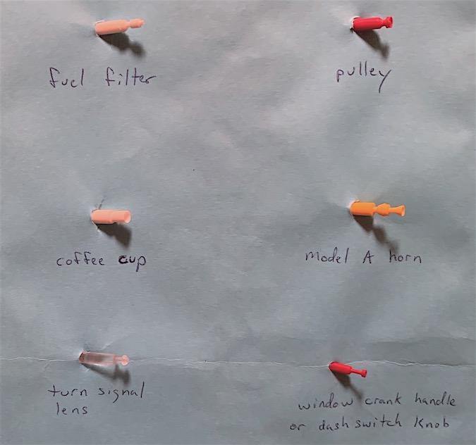

Russell C Posted December 12, 2014 Posted December 12, 2014 (edited) (copied 'n pasted back in here from the Google Cache "crashed version" of this thread) Posted 26 November 2014 - 07:37 PM On 11/26/2014 at 2:50 PM, 60s Doorslamr said: ... Great way to make breather caps for valve covers, distributers, oil filters, and fuel pumps... Expand Yes, indeed, anything that is small and round or cylindrical in some way. In my MG TD glue bomb restoration post #16 I showed how I knocked down the bulk of the too-thick steering wheel. 2nd pic below is a close up of a board I made back in the '90s to show to the guys at the Albuquerque Model Car Club of what could be done. I've had the same JC Penny variable speed motor tool this whole time. Wear safety glasses and be careful when you use a sharp blade as a cutting tool! Edited April 29, 2020 by Russell C fixed busted photo links
