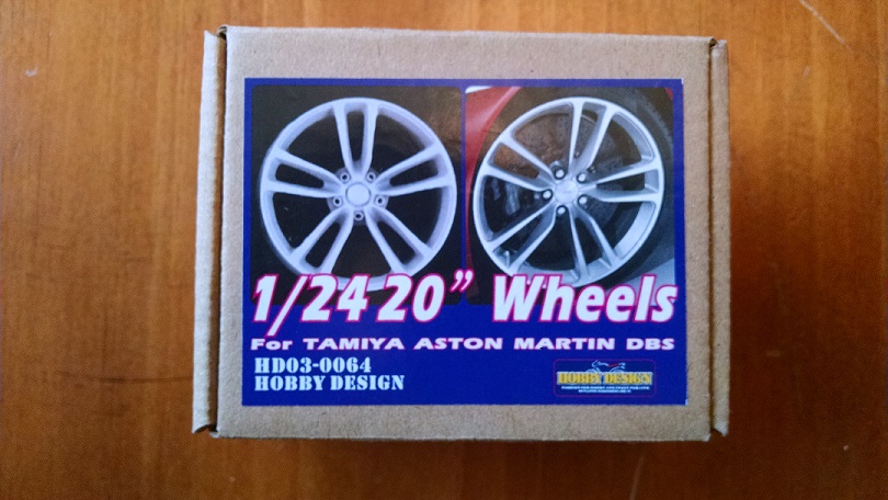

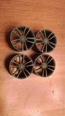

the rims will need cleaning up AND after test fitting the tires, the rims are not only too wide, but they are not big enough for the rubber. There is just a very small gap between rim and tire, it's hardly noticeable, but it does allow some "play" in the tire and rim. SO, I will have to attach a piece of styrene around the rim to widen its diameter.

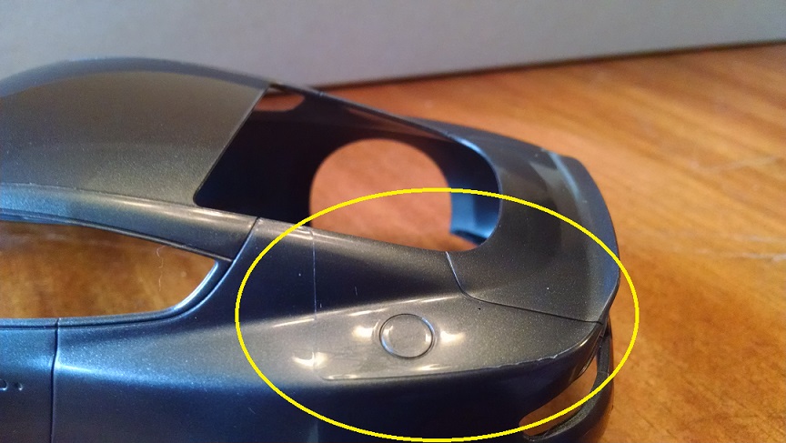

four nasty mold lines dominate the sides of the car. Thankfully, the rear ones run down the B pillar and across the ducktail spoiler, the front ones run down the A pillar and into the headlight assembly. Those'll have to go!

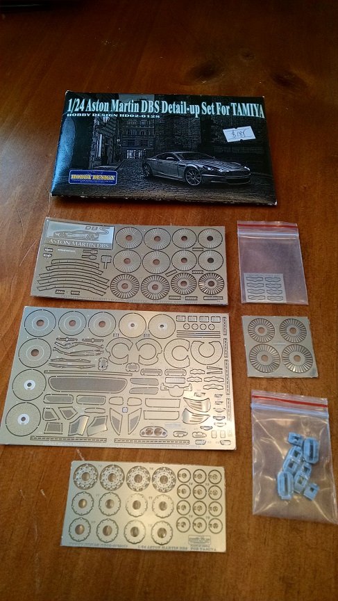

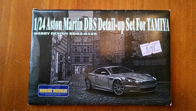

and for the PE, Hobby Design.

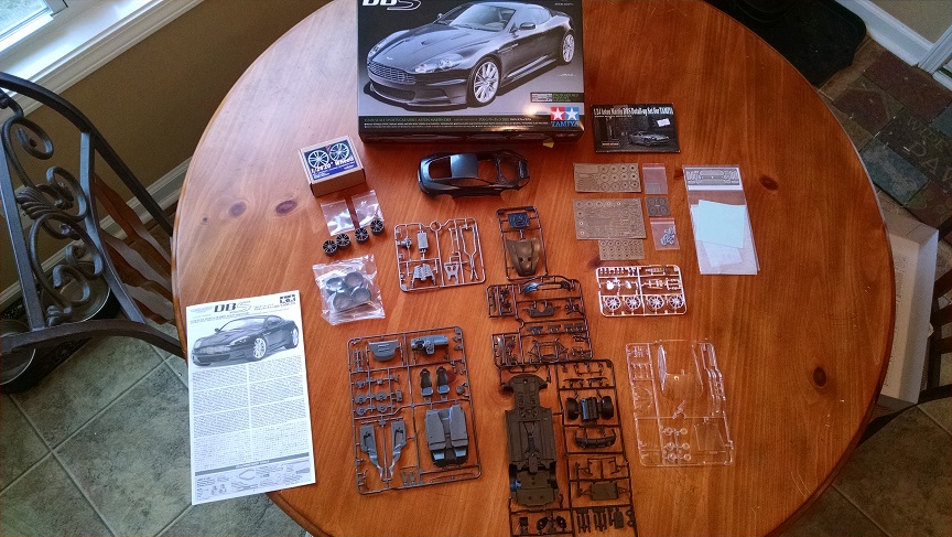

And the whole build:
post-14656-0-76855500-1418512924_thumb.j
Not pictured is the Scale Motorsport 1/24 twill weave carbon fiber sheets.

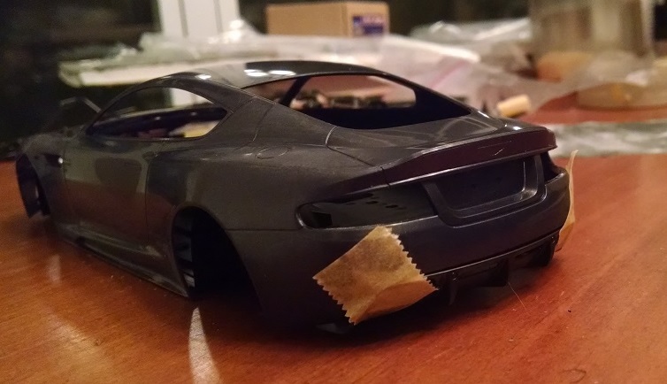

Except the easily lost little ones, parts were cut from the sprue and cleaned up. I did a very small mock-up and the parts almost snap together. Tamiya did leave a peculiar piece of, it is on the trunk just under the ducktail spoiler. The front bumper and this piece will be permanently attached tomorrow (or maybe Monday).
The mold lines were removed, they looked bad and are still visible but they have been sanded smooth. Then the body was washed in Dawn dish soap to remove any mold lubricant/oil/whatever-its-called and then wetsanded. Finally, the rims were cleaned up and now look respectable, although they will still need some attention.

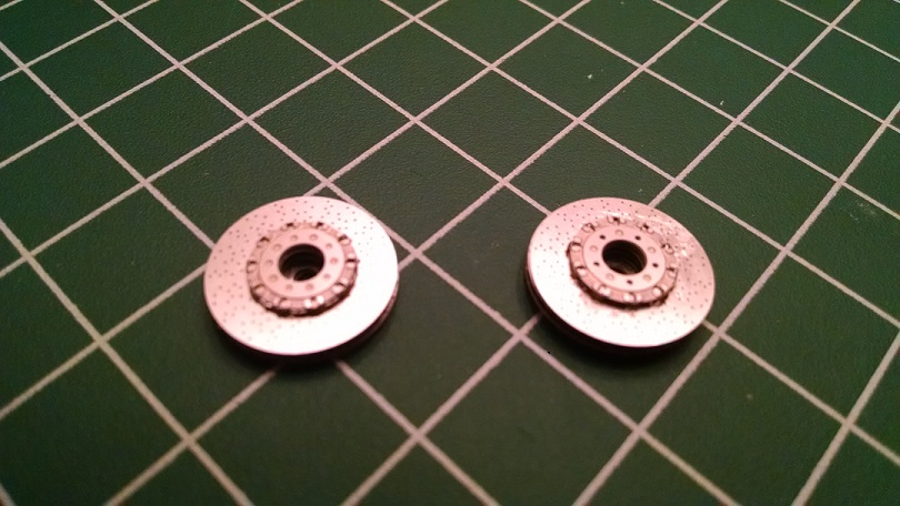

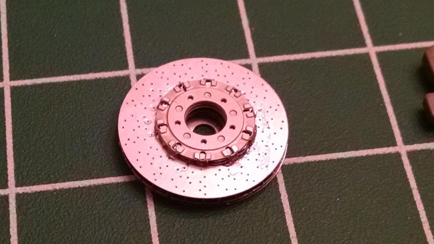

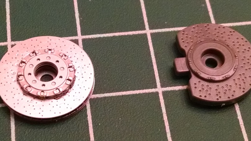

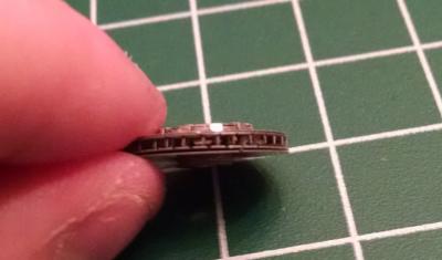

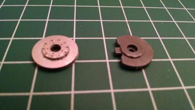

Chris, it looks like a great kit. Just the mock up almost snapped in place. So far I've only tangoed with the brakes and boy are they challenging yet fun. The rims are all different widths, so I've matched them up to the tires and will make the necessary modifications later. Also, I will have to modify the mounting point for the brass male connectors as it is too deep and doesn't allow the wheel to attach. I'll cover that when I get to it. Anyway, here are the awesome brake rotors compared to the stock plastic ones.
post-14656-0-13266500-1418541094_thumb.j
post-14656-0-04633200-1418541096_thumb.j
post-14656-0-58317000-1418541097_thumb.j
post-14656-0-17159200-1418541099_thumb.j
post-14656-0-78581500-1418541099_thumb.j
Total, it took me short of 2 hours to complete the front rotors. I made a small mistake on one, you have to attach a separate piece of PE for the actual rotor face. Well, I didn't realize that the holes are actually holes and some CA leaked through. I tried to wipe it up as best I could but I still have to weather the rotors to look used, no rotors look brand new so they'll need brake marks.
Anyway, that's all for tonight.

As for the wheels, I'm contemplating on cutting out the pattern and fixing them to the kit supplied outer rim. That's plan B after beefing up the outer diameter with thin sheets of styrene. Right now, the rims are "female" and come with brass pieces to convert them to "male." Right now, the part of the rim the brass pieces sit it are too deep and contact the brake rotors, so they will have to be shaved down to allow proper clearance for the brake rotors. I have a suspicion that this car will become a "don't pick that up!" car. Once she's done with her post-completion photoshoot in under construction diorama, I think it's off to a display case.
To answer the FG rims issue, the link you supplied says, laughably, "long sold out." LOL. That answers that. Worst case scenario, I simply use aftermarket rims of my choice.

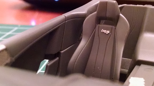

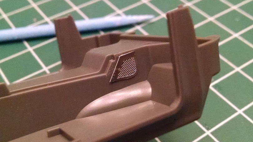

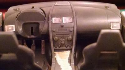

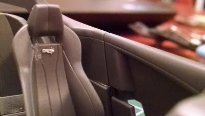

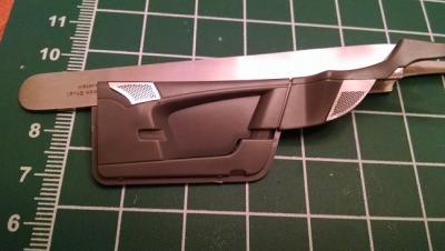

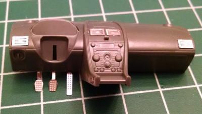

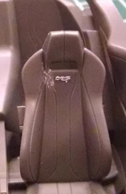

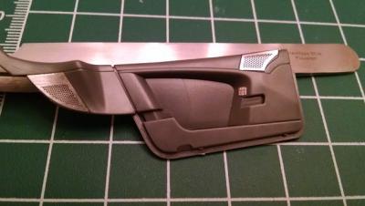

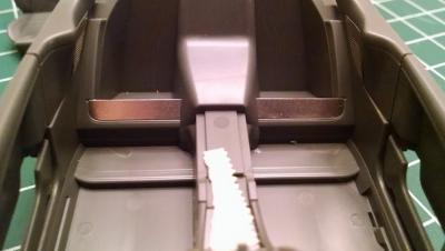

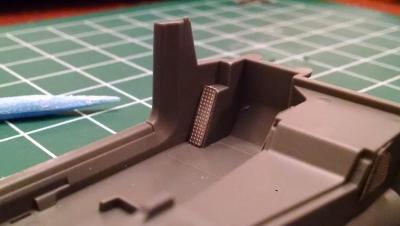

Today I focused on a slightly less tedious part of the car, the interior. The only thing that really tested my patience was the DBS logos for the seats. The driver seat decided to fall out of the tweezers and onto the shoulder of the seat, that glue and since been cleaned off. The passenger seat, you can still see the nubs from the sprue. I apparently didn't file off enough. That was the first one I did and I was hesitant to file it as it was so small! The second one filed ok, but I was so scared it would fall and I would lose it. Also, the center console air vents gave me fits until I figured out I had to remove the molded plastic from the dashboard that replicated the original vent and the piece that allows you to aim the vents up and down.
Anyway, I still have yet to add the gauge bezel but I don't know if thats before or after the decals and painting...

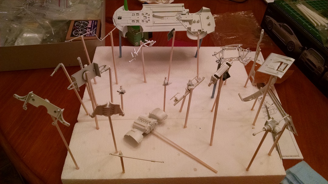

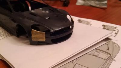

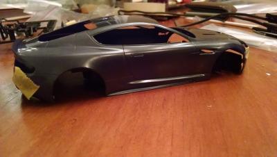

Today I primed all the suspension bits as well as the body and hood. I also spent some time practicing on spare styrene, the metallic black looks amazing. I discovered two things that contributed to some nasty orange peel on my R-33. First, I use a 60 watt light bulb to assist in drying time. I found out that this contributes to the orange peel by causing the paint to dry too quickly. Second, using the clear coat I put too much on at one time and likely over did it, again causing the clear to dry at different times. I did however practice with a set of 3200-12000 grit wet sanding papers. I was able to sand out the orange peel from the test piece of styrene and using Novus 1 and 2, I was able to bring the paint back to a fantastic shine. So I was happy for the practice.
Anyway, I have to assemble the rear rotors and experiment with Model Masters metalizer paints...

Hi, Justin... you're right that those metal decals are a bit tricky... I had a real issue with them on the matt white coated inlet manifold. Having messed up the "6.0 litre" completely, I had to print out a replacement with a "fake" metallic tint. After that I got wary. If I remember rightly, if you look at the decal sheet, you can see that there are a few large areas of clear carrier film in some of the number plates that you aren't going to use. I ended up applying the metal decals to those clear areas, where you can rub them down hard, and then once they were stuck, cutting them out and applying like normal decals. That was essential with the other underbonnet markings on the matt white. Even though they'd probably "take" OK on the clearcoat gloss finish, putting them on with the film carrier allowed me a bit of wiggle room, and time, to position them exactly right, rather than having to commit immediately they touch down. As for the brakes, the disks are carbon ceramic -- I find that Humbrol 56 "Flat Aluminium" is a pretty good match, since you don't really want any kind of shiny metal look...
Hope this helps!
bestest,
M.
Last night I messed with the spare metal transfer you mentioned. One thing i did after placing it on my spare piece of styrene was lay down masking tape that had been folded in half to hide the tacky part, then layed it on top of the transfer and rubbed like hell. It stayed. But thats a differrent story than the Aston Martin and 6.0 V12 transfers. I'll be looking into the waterslide idea as well...

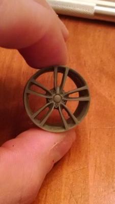

I fiddled with the rims today. I spent most of the morning mocking up the front end. First issue, the PE rotors are wider (measuring from the steering knuckle to the outside of the rotor hub- the part where the lugs stick out for the rim yo mount to) than the stock plastic rotors. Second issue, the HD rims and the supplied brass "male" connector sit further out using the stock rotors than the stock rims. SO...using the HD rims and PE rotos causes a significantly wider front end.
So to combat this, I cut away some material on the inside of the rim, allowing the brass "male" connector to sit closer to the area of the rim that it connects to. This solved most of my problem. The next issue, the round section of the brass connector, the part that looks like a hockey puck, is too thick. It needs to be shaved down to 3/4 of its size (i need to ax 1/4 of its thickness). That SHOULD solve my issues caused primarily with the thicker rotors.
I tested the clearance using both a stock rim and PE rotor and HD rim and PE rotor as well as HD rim and stock rotor.
Long story short, PE rotors and HD rims= wider wheelbase. So with a few mods to the rims and the male connector, this "should" be settled. I'll take pics tonight and hopefully you guys can help keep me straight on this or offer a better way!
Well, I cannot seem to get the rims to fit the tires, or clear the front fenders. I'm stuck between a rock and a hard place. On one hand, I can risk screwing up the hobby design rims by trying to grind down the brass connectors, allowing the wheel to sit closer to the rotor and subsequently further inside the fender. If done successfully, the tire should clear the fender. :blink:
However, even with the fenders cleared, the tires still don't fit the rim. I've tried using tape, i've used thin styrene, nothing increases the rims diameter without causing the tires to separate from the rim at the lip, causing a very ugly- in my opinion it would ruin the model- gap between rim and rubber.
So, my gut feeling is to abandon the Hobby Design wheels and the Carbon Black edition.

Sorry to hear that, but I'm not surprised -- I have a set of nicely painted HD DBS wheels in my spares box because I couldn't get them to fit the tyres acceptably no matter what I tried, either.
