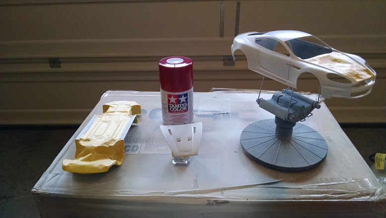

ferrari87 Posted December 21, 2014 Author Posted December 21, 2014 Happy weekend gents! An update and a choice for today. First, I've decided on Mica Red for the basecoat and gloss black for the rims. That leads to the update! After utilizing google to .00000000003% of its potential, i found out that bleach and coke can be used as well so I tried coke and i'm sure it works after a few days, but no thanks. So, into the bleach it went. This was just Clorox Household Cleaner bleach. After about 5 minutes, here are the results: I should have some paint laid down tomorrow and some other updates.

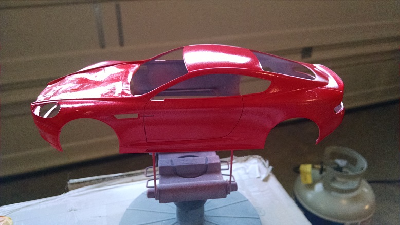

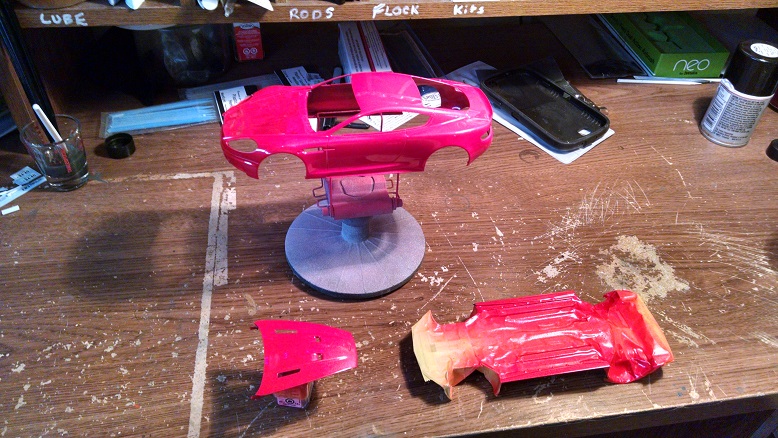

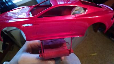

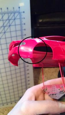

ferrari87 Posted December 22, 2014 Author Posted December 22, 2014 happy Monday gents. First of a big update today! I painted the body, hood, and underbody Mica Red. It's still curing, but final pics will come. These are a few I snapped during painting. Unfortunately, I laid the paint on rather thick. There are several spots that gathered paint, particularly at the bottom of the doors. So much so that the panel line between the rocker panel and the door has almost disappeared. All of those areas that need attention will be wet sanded of course. All in the name of learning I suppose. I'm off to paint the rims gloss black. Stay tuned!

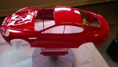

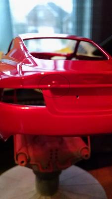

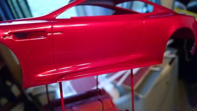

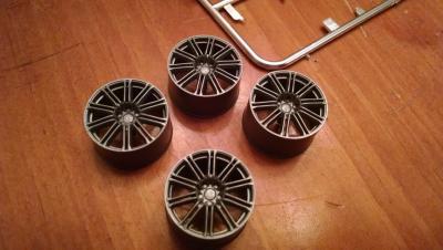

ferrari87 Posted December 23, 2014 Author Posted December 23, 2014 Ok folks, big updates here for you guys: Here are a few ok pics of the paint. I love the paint color, and I love how shiny it is right out of the can. However, I don't like spraying from a can. I can't control the pressure and I feel like a spray can is like a fire hose, it just blasts paint out in a deluge. I wasn't careful enough and there are many areas that need wet sanding tomorrow morning. They are below. From now on, I will be decanting the cans and using the airbrush. here you can see where the paint built up under the door/above the rocker panel, enough to completely cover up the bottom panel line. Here you can see a bubble. I don't know how these happen, so any advice would be much appreciated. and more bubbles... and the one bright spot, the hood. Boy this looks good. You can actually see me taking the picture in the hood. I was suprised how shiny the paint was without any work. I can't wait to see how it turns out.

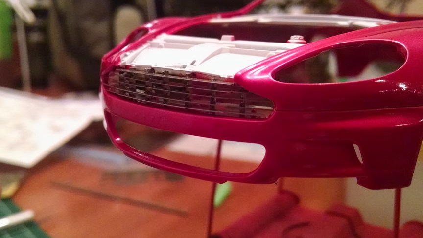

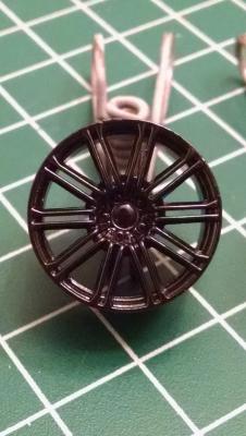

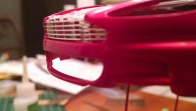

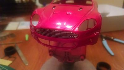

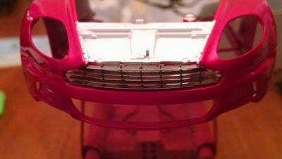

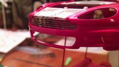

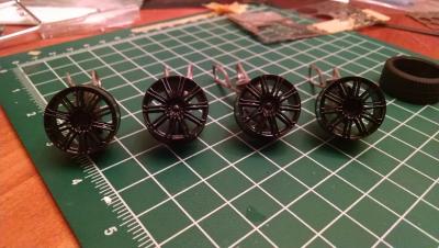

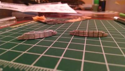

ferrari87 Posted December 23, 2014 Author Posted December 23, 2014 I also built the front grille. I do not know if I like it as the stock one once dechromed I think fits better, but is obviously too thick to be in proper scale. here are the grilles inserted into the car for comparison: and finally, gloss black rims: I would like to know which grille you guys think is best. I'd like to use the P.E. grille but I don't know how good it really looks. It will be painted flat black. Look forward to hearing any support, constructive (or non-constructive) criticisms welcome. Advice and tips are much appreciated!
Kennyboy Posted December 23, 2014 Posted December 23, 2014 I think that the PE grille will look better to scale when it is painted flat black. Paint bubbles like that are usually caused by moisture that gets into the paint stream. Perhaps from washing the body before paint?
Chillyb1 Posted December 23, 2014 Posted December 23, 2014 You should use the pe grille. It will add greatly to the look of the finished model. Back up a bit and take a look at the orange car above; you'll notice how the grille should look and you can compare that to your pe grille.

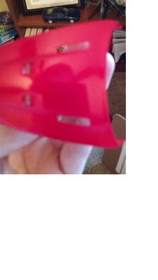

ferrari87 Posted December 23, 2014 Author Posted December 23, 2014 I tried wet sanding the issues out and it isn't working out. First, the bubbles had no paint behind them, so they have basically cratered. So in the center of the crater I have the white primer. I know sanding these out won't work on the back end when i paint as I will still have issues with the crater not having the same depth as the paint around it. So, I'm going to strip the body tonight with 91% iso alcohol and try this all again. This time, I'm decanting the paint and using my airbrush. That way, I have the best control of the paint.

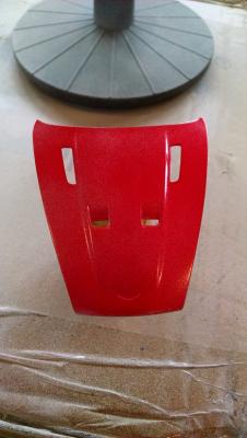

ferrari87 Posted December 24, 2014 Author Posted December 24, 2014 Ok guys, first bit of good news. I have stripped the hood of almost all paint and primer. I still have some work to do on it but I went to Lowes and got "Citrustrip." It read the same as Ready Strip and is probably the exact same thing except it smells like orange-glo. That is, it has a nasty orange smell to it. The bottle says "pleasant", I say noxious. Anyway, I let the paste sit for no more than 5 mins as I wanted to ensure the stripper did not have much time to get at the plastic. Almost on contact, the stripper turned red from the paint so my initial feeling was this stuff was "hot". I will post a few pics up tonight, after I finish the hood. Im planning on sanding it out a bit more from 800 on up to 3200, wet and dry. So far, this stuff works and works well!
