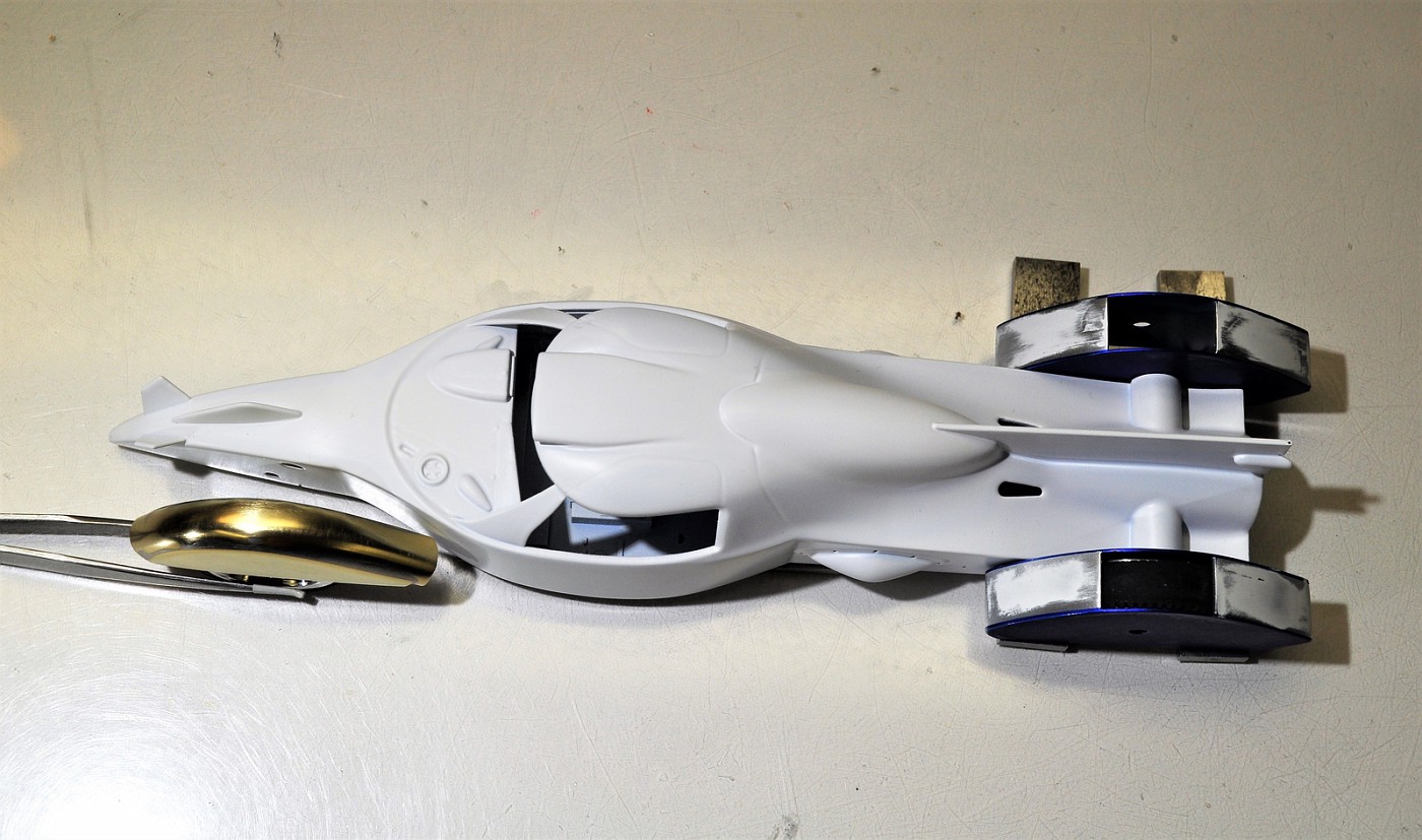

It's been several years since I originally posted this project.   After the demise of Henry and the Bantam approaching the finish line (I'm doing the steering link currently) I wanted to get one done.  The Bantam will take me 6 more months at the rate I'm going so it won't be done till Labor Day......HOPEFULLY.    When I started this car there was one thing I wasn't wild about, that being the wheel fairings.  As you can see by the pic on page one, they're flat on top because I couldn't figure out a way to make them properly curved/rounded.  Spent about 10 or so hours this week trying a couple new techniques and stumbled across one that I think will work.  I took brass tube, cut it down the middle and put small relief cuts (so it wouldn't crimp when formed) every 5mm.  I came across a carabiner at the hardware store that had a shape similar to the original fairings.  I annealed the brass and formed it over the carbiner while tapping the sides down with a forming hammer.  After a bit of shaping with files I  sweat soldered some brass sheet over the sides and cleaned it up.  The sample brass fairing is not the correct size obviously but it gave me an idea of what it would look like on the car. This is what I wanted all along.  So I'm figuring on a week of work to make all 4 fairings (the fronts are a bit smaller than the rears) and move ahead to finish it.   Comments welcome, Cheers....tim
Raw materials used to make the top portion
Here you can really see the difference of the two designs

Damit Tim!  Stop it!  Every time you show up with something new, I got to go try it out!  That is just spectacular!  Great thinking.  You are the master.

Bill, yeah, it looks short because it was just an exercise on how to fabricate it.  As noted above, I mentioned it wasn't the right size but it did proof out for me that I can make it using the method I came up with.  btw, I painted it black to show it's flaws so I could see what else might need to be done but it turned out perfectly.   Encouraged to do 4 new ones to wrap up this car now.   cheers !

Tim... I just love this build. Ot is going to be so awesome when done. Awesome fabrication on your test pieces. Is there anything you can't make..;) Cheers!! Seeing this has me thinking of a couple LSR cars I have been on the back of my mind that I would like to build one day.
you know, a mini english wheel and planishing hammer would have done the same thing...haha I am constantly amazed at your work..I do this stuff in 1:1 scale and still cant get over it in scale...We also need more land speed projects around here!!!!
