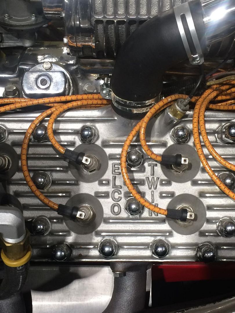

Ace-Garageguy Posted January 21, 2015 Share Posted January 21, 2015 (edited) There's a thread on here started a few weeks ago showing some dual-plug Ford flathead heads., and the plug placement is pretty obvious. Flatheads flow pretty poorly in general, and flame travel is poor. Dual-plugs could achieve more complete combustion, and add a little power. Porsche used a 12-plug-terminal cap for its dual-plug flat-six engines, with 2 coil inputs. This distributor cap is for a 12 cylinder '31 Caddy, and is also set up for 2 coil inputs. An old 12-cylinder distributor like this could be modified by a very competent hot-rodder to fire a dual-plug head on your Hudson. Edited January 21, 2015 by Ace-Garageguy Quote Link to comment Share on other sites More sharing options...

Erik Smith Posted January 22, 2015 Author Share Posted January 22, 2015 Thanks. The Ford post was mine also. That's what drove the next step... A big distributor like that shouldn't be too difficult. That's what the Ford Flattie used. Quote Link to comment Share on other sites More sharing options...

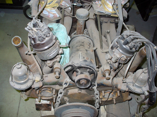

Ace-Garageguy Posted January 22, 2015 Share Posted January 22, 2015 (edited) Look at photos of old Nash Ambassador straight eights from the 1930's. That might give you some ideas on how to do it. Scott All he needs is a 12-cylinder, dual-coil distributor in the same location as the stock distributor. Easy. Or, if he wants to be esoteric, he could put 2, six-cylinder distributors side-by-side, on a common oval gear housing, on top of a distributor driveshaft, again in the same location as stock. Think of the housing as a little transfer case. One gear in the middle on the top of the original distributor drive shaft, and two gears on either side of it, driving two short-shaft distributors on top. The gear arrangement spaces the distributors far enough apart, and makes them both turn in the original direction. Split-timing would be easy, as all you'd have to do to change the timing on one set of plugs would be to rotate an entire distributor. With a single distributor, you'd have to remove the cap, and rotate one point plate relative to the other one. Doable, but a little fiddly. Either way would work in 1:1. Something like this...but perched on top of the original distributor location and driven from the bottom, rather than being driven by a shaft from the timing chain, as this setup is. Porsche used two distributors on the 4-cam 4-cylinder engines, sometimes like this... '28 Chevy, with 2 distributors... The point is, come up with something that looks plausible, and there you go. Edited January 22, 2015 by Ace-Garageguy Quote Link to comment Share on other sites More sharing options...
