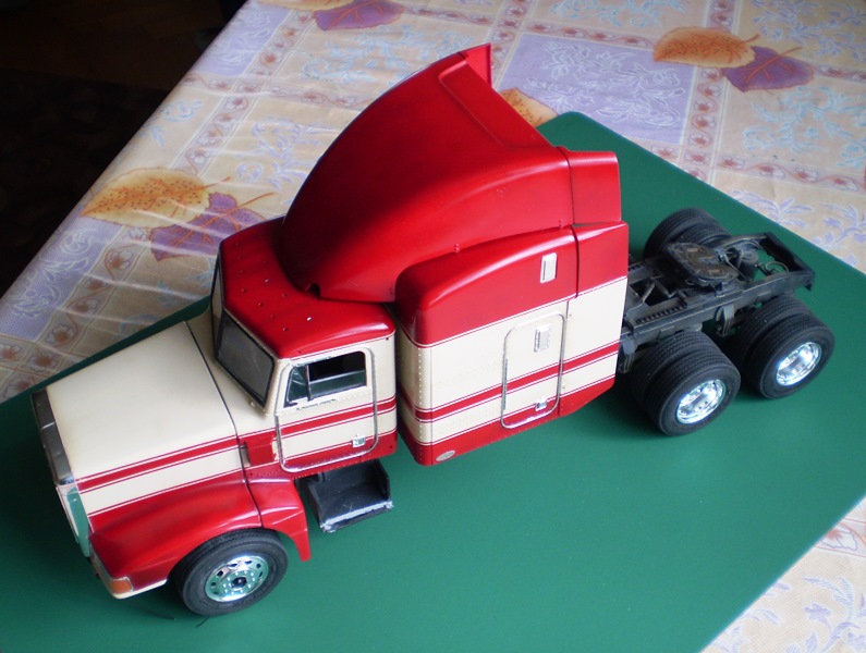

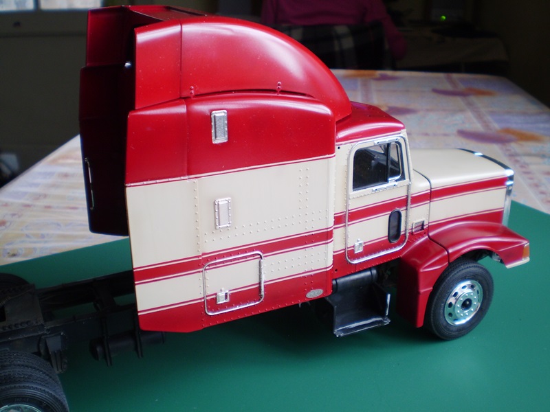

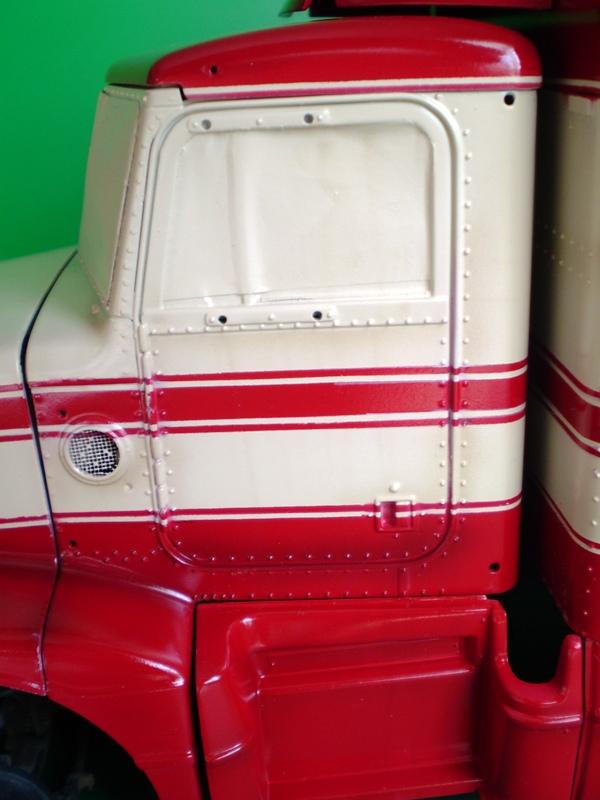

truckabilly Posted March 6, 2012 Author Share Posted March 6, 2012 (edited) Thank you guys for your kind words. I sprayed a few layers of clear coat and this is how it looks now. Not very shiny but I didn´t even want it that way. But still I think I could have done better. The skin isn´t very smooth. Is it possible to polish clear coat? Edited July 25, 2017 by truckabilly Quote Link to comment Share on other sites More sharing options...
bandit1 Posted March 6, 2012 Share Posted March 6, 2012 wow...really nice job on the paint work so far......i dont know about polishing clear...but i do know why dont you do a light wet sanding before...that will even everything out for final polish and wax???.... BUT HEY KILLER PAINT....I WISH MINE LOOKED THAT GOOD! Quote Link to comment Share on other sites More sharing options...
BigBad Posted March 6, 2012 Share Posted March 6, 2012 Oh yeah! That's what I'm talking about, told you this paint job would make that truck pop! Good Job! Quote Link to comment Share on other sites More sharing options...
mackinac359 Posted March 6, 2012 Share Posted March 6, 2012 I polish all of my clear coats using a mild rubbing compound followed up with a carnuba type car wax. Be very careful around the raised details (rivets, panel seams, etc). Tim Quote Link to comment Share on other sites More sharing options...

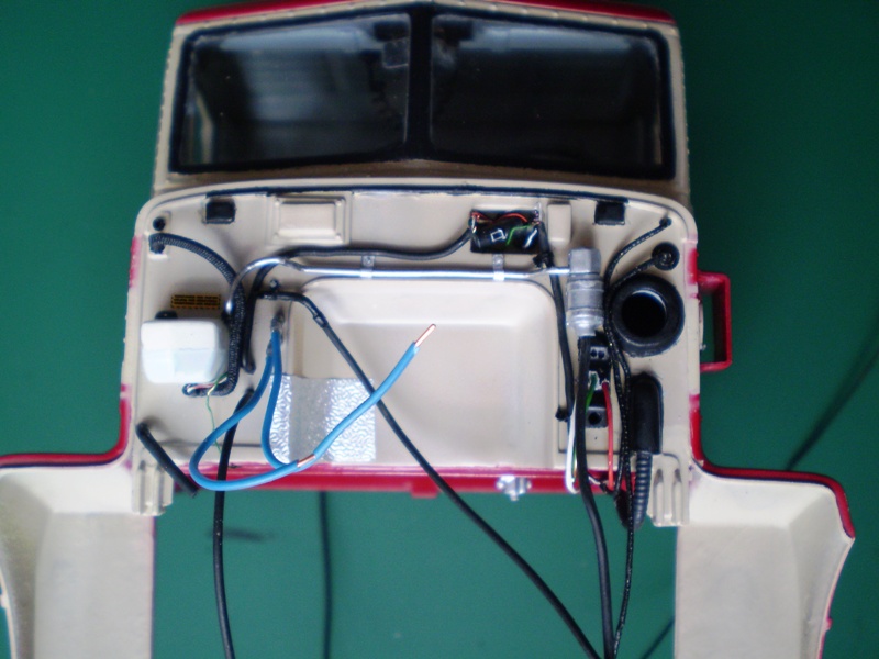

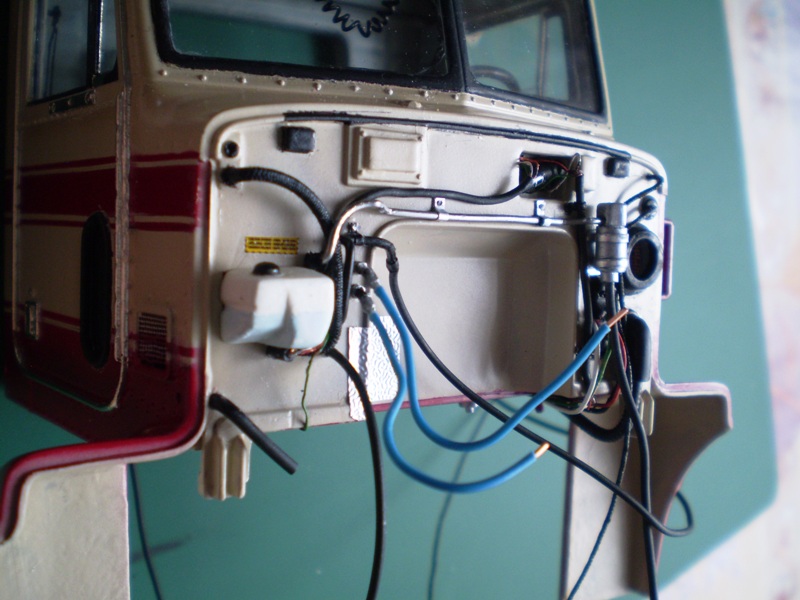

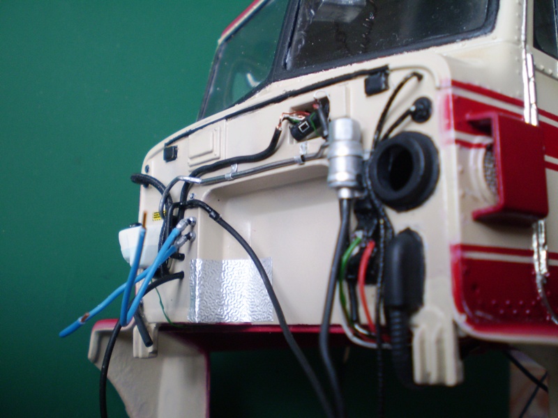

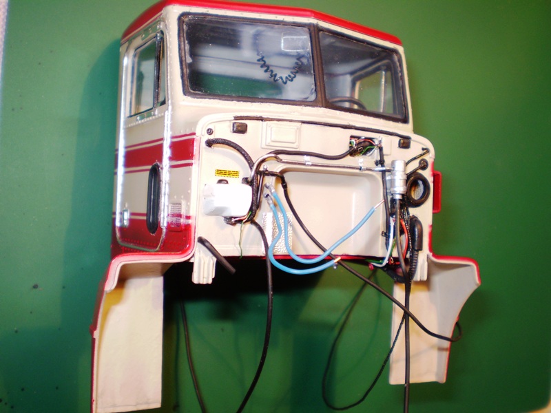

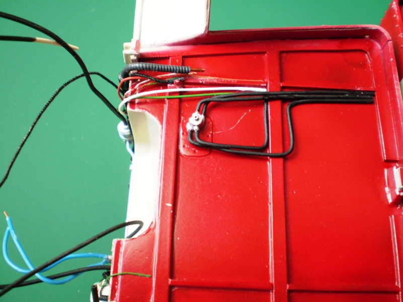

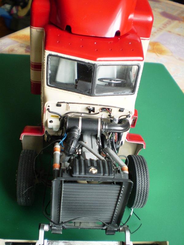

truckabilly Posted March 30, 2012 Author Share Posted March 30, 2012 (edited) I working on the details for this build. Right now I think I can show some pics of the firewall. I added a few details and plumbing. The firewall is not perfectly accurate. Italeri mirrored some of the elements on the firewall and I have noticed that after it was painted. I will take care of that on my future builds. I will add a beeper under the windshield center post and maybe a few more tiny wires. Unfortunatelly, I do not have a complete knowledge of all the wiring and plumbing so the wires and hoses will end up in some hidden spot under the cab. Edited July 25, 2017 by truckabilly Quote Link to comment Share on other sites More sharing options...
mackinac359 Posted March 30, 2012 Share Posted March 30, 2012 Nice firewall plumbing! You are correct, Italeri mirror-imaged most of the firewall, almost as if they were thinking right hand drive. Tim Quote Link to comment Share on other sites More sharing options...

bandit1 Posted March 30, 2012 Share Posted March 30, 2012 Nice firewall plumbing! You are correct, Italeri mirror-imaged most of the firewall, almost as if they were thinking right hand drive. Tim geez! ...Another problem i just have to fix...you wouldnt happen to have ref material needed that tells or shows how i have to correct it would you tim? Quote Link to comment Share on other sites More sharing options...
drinkone2 Posted March 30, 2012 Share Posted March 30, 2012 Excellent detail work!! Jim Quote Link to comment Share on other sites More sharing options...
mackinac359 Posted March 30, 2012 Share Posted March 30, 2012 Reference material such as photos of the firewalls? Tim geez! ...Another problem i just have to fix...you wouldnt happen to have ref material needed that tells or shows how i have to correct it would you tim? Quote Link to comment Share on other sites More sharing options...
catd11rpusher Posted March 30, 2012 Share Posted March 30, 2012 Being a novice modeler I have a lot of respect for you, your work is very nice. How do you make the exhaust coming off the turbo look so real!!!! I mean the rust look is very beautiful Kudos to you, Quote Link to comment Share on other sites More sharing options...
bandit1 Posted March 30, 2012 Share Posted March 30, 2012 Reference material such as photos of the firewalls? Tim Reference material such as photos of the firewalls? Tim that and anything else tim THANKS Quote Link to comment Share on other sites More sharing options...
mackinac359 Posted March 31, 2012 Share Posted March 31, 2012 Try here plus any of the "Peterbilt vacation" fotki pages off my site www.timstrucks.com - if you can't find what you are looking for, drop me an email and I can dig through more pics. Tim http://timstrucks.site.aplus.net/PB_detail.htm that and anything else tim THANKS Quote Link to comment Share on other sites More sharing options...

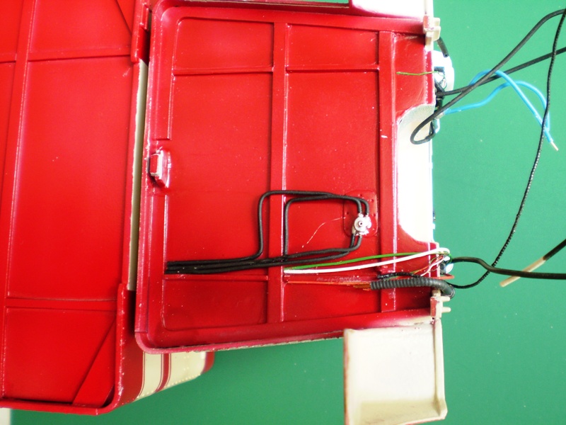

truckabilly Posted April 15, 2012 Author Share Posted April 15, 2012 (edited) Some details are easy to find. Some others not. I didn´t want to have the bottom of the cab with no details so I put some lines in there. You can see they end nowhere... for the lack of details of this part. The cab and sleeper are glued to the frame. The hood can still be removed. The air filter just sits on the engine. I will glue it later. Edited July 26, 2017 by truckabilly Quote Link to comment Share on other sites More sharing options...

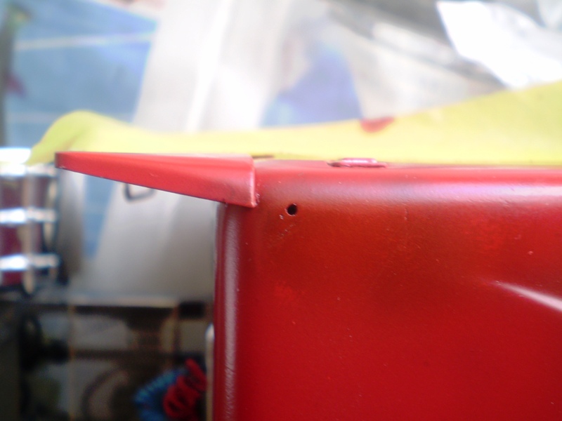

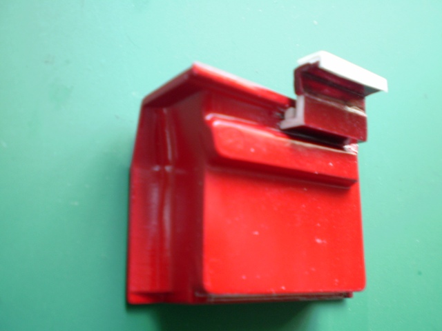

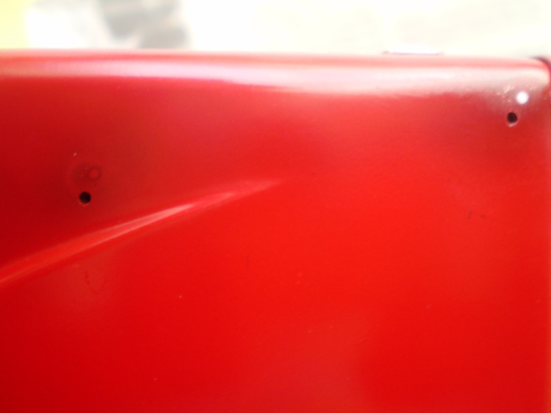

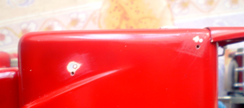

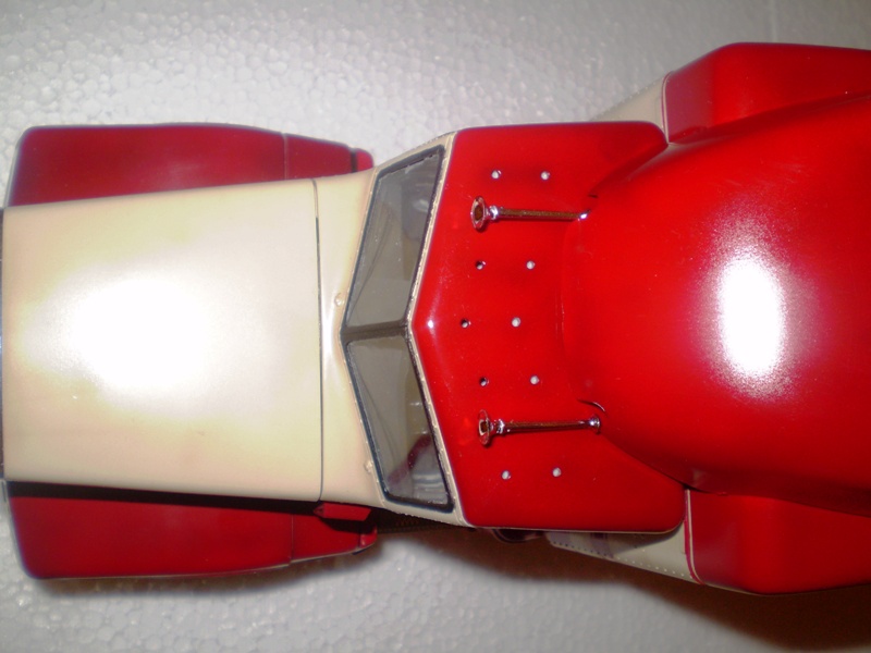

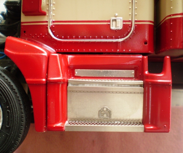

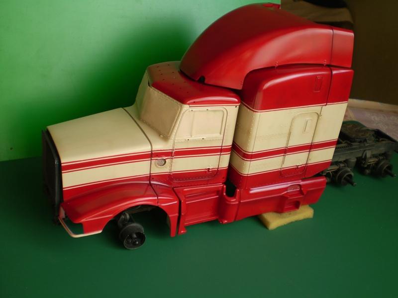

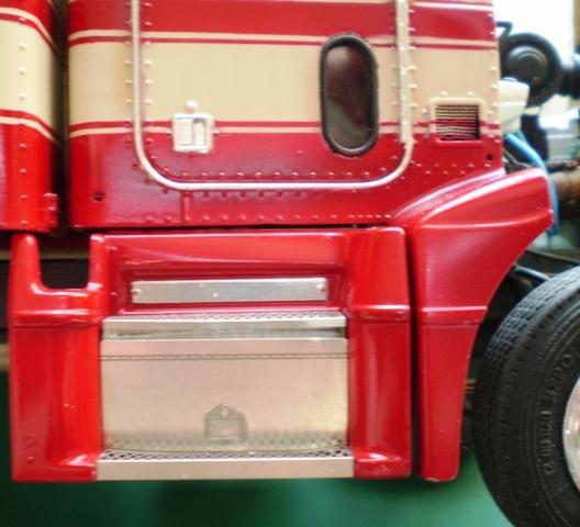

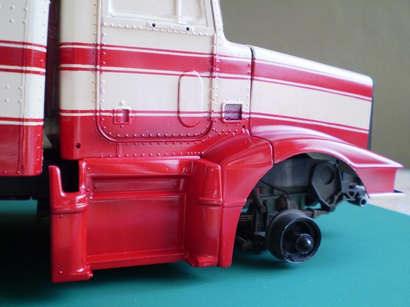

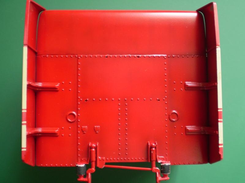

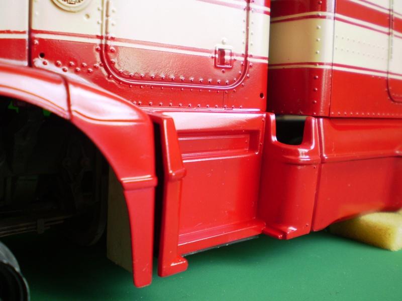

truckabilly Posted April 26, 2012 Author Share Posted April 26, 2012 (edited) So far I didn´t have any serious problems with parts fitting. But now I had to deal with a geometry issue. It was probably my fault but the under cab fairings didn´t fit quite right. Everything was okay on the passenger side but the driver side... oh, Lord! Also, the upper edge of the fairings was supposed to be glued to the cab lower edge. But there´s a gap between these parts on the real truck. I wanted to keep this gap on my model too. So I´ve done these channels to keep the distance and make a solid joint. Still the gap was different on each side. I did some adjustments and accepted this compromise. But... another problem occured when I test fitted the roof horns and the aero shield... The pic is no good but the horns and the aero shield didn´t fit right. I had to drill new holes to the sleeper roof. Edited July 25, 2017 by truckabilly Quote Link to comment Share on other sites More sharing options...

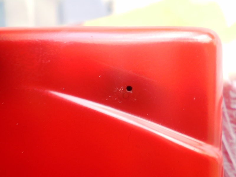

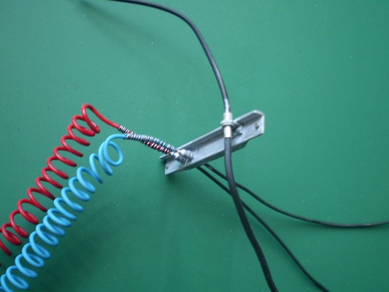

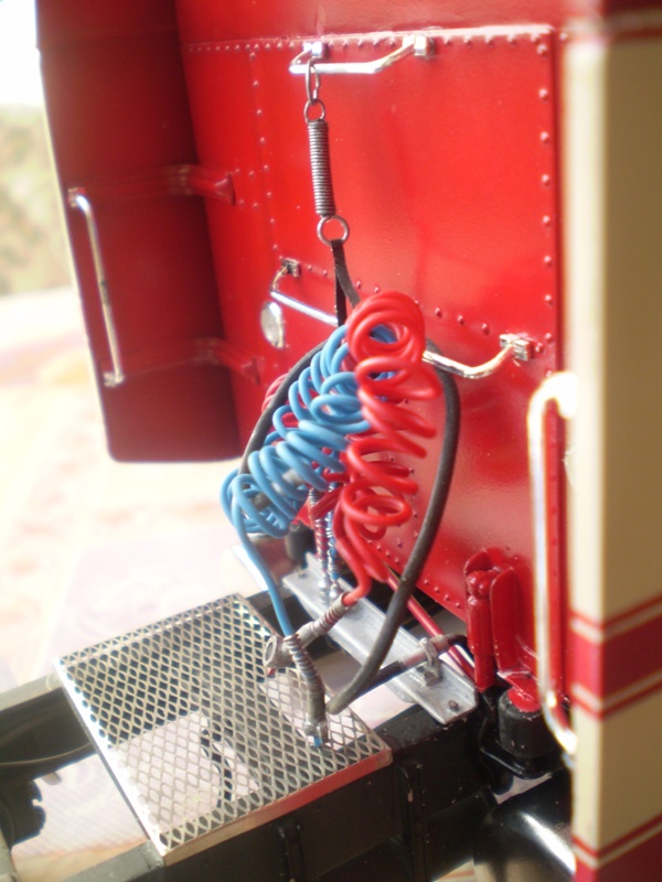

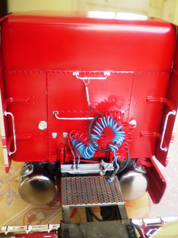

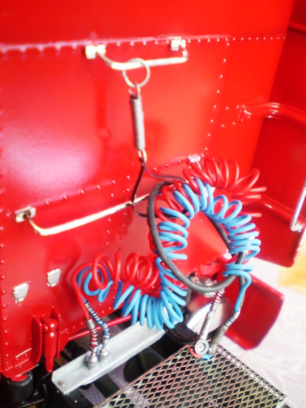

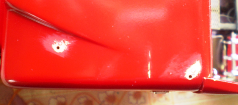

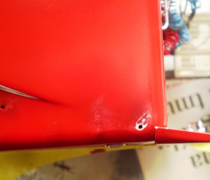

truckabilly Posted April 26, 2012 Author Share Posted April 26, 2012 (edited) Now it fits a lot better. But what do I do with the extra holes? I am not sure if I can fill in the extra holes and repaint the spots without a trace. Someone advised me to install another horns in there. I don´t know. I´ve never seen it this way. Before I make the decision, there is a progress on another parts. I finished the coil cables for the trailer connection. I installed them onto the truck. The spring is a lead wire 0,4 mm winded around another wire. The loop holding the coil cables is an adhesive tape. I joined two layers with the sticky sides facing each other. The black hose is an electric line. The glad hands are scratch built. Edited July 26, 2017 by truckabilly Quote Link to comment Share on other sites More sharing options...

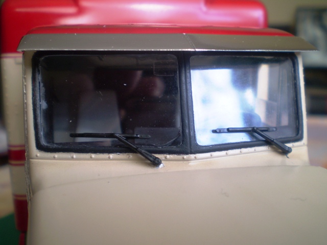

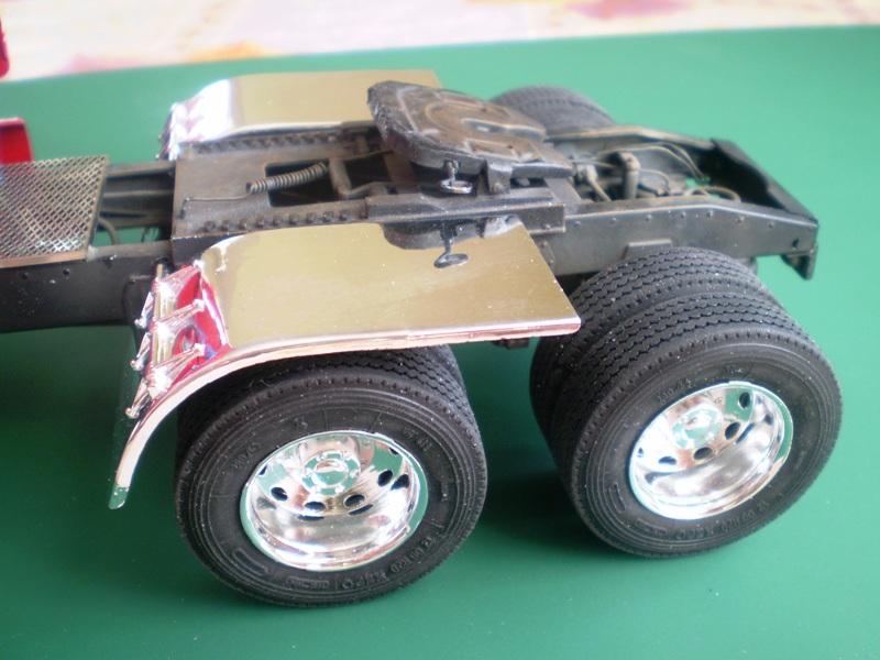

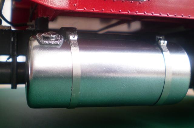

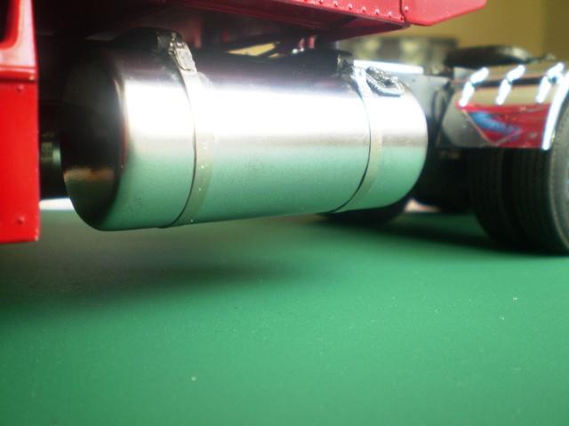

truckabilly Posted April 26, 2012 Author Share Posted April 26, 2012 (edited) Also in place are the fuel tanks. The Alclad chrome should look better but some tricks I have yet to learn. The stripes are photo etched and have natural nickel finish. The rear fenders are in the kit´s chrome. They come from RoG 359. The wipers and sun visor: That´s all for now. Any ideas how to get rid off the extra holes? Edited July 25, 2017 by truckabilly Quote Link to comment Share on other sites More sharing options...

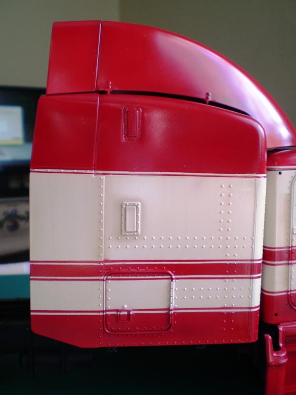

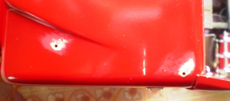

truckabilly Posted April 28, 2012 Author Share Posted April 28, 2012 (edited) Thank you Leo. I was thinking about something like this myself. The question was... do I have the guts? Well, here is what have done. I superglued the styrene rods in the holes and cut the flush with the roof, just like you suggested. Then I tried to smooth sand the spots but the superglue was not willing to cooperate too much. So I used a bit rougher sand paper and I never got rid off the marks. My fault, I shouldn´t have worry too much about the size of the sanded spots. I used a darkened shade of the original colour for the first few layers. I needed that dark shade for better coverage of the white ends of the rods and the light spots from the sand paper work. I sparayed a few thin layers and smooth polished them with the GT31 finishing cloth of GSI. Then I lightened the shade again to prevent too much dark spots from building up. Again, I polished each layer with the GT31 cloth. Finally I added one layer of paint over the whole roof. This will be wax-polished after the paint cures. Here is a few pics. Edited July 25, 2017 by truckabilly Quote Link to comment Share on other sites More sharing options...
