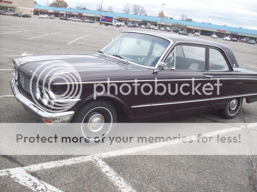

von Zipper Posted March 1, 2014 Share Posted March 1, 2014 To cross reference the origins of the Comet-read the Wiki report of the Ford Falcon http://en.wikipedia.org/wiki/Ford_Falcon_(North_America) Read the section called First Generation (1960-1963) I really don't want to start an argument over all of this, maybe it falls under the ill-fated topic that Harry P. started about "Scale Model Inaccuracies" and how some thing gets lost between the real cars and our models? when I put the AMT '67 Mustang chassis into the '61 Comet I had to cut it and add about an inch of length to get the proper wheel base. The Mustang in '67 was a larger car than the first generation Comet and you would think it would have to be shortened rather then lengthened. Although in the AMT/SMP days as with the real car world the Falcon and the Comet were both considered a compact while the Fairlane was considered a mid size. Also remember a few short years earlier the Fairlane was a full size car. I just want to have a healthy discussion about model cars and techniques. (period) Quote Link to comment Share on other sites More sharing options...

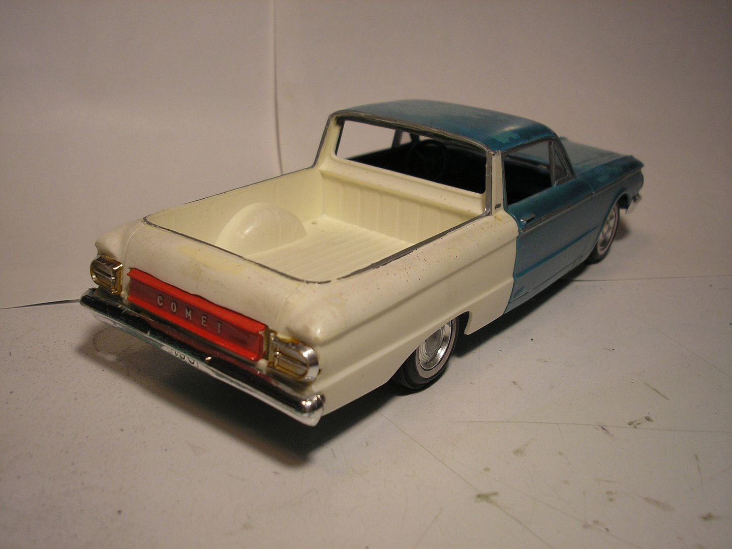

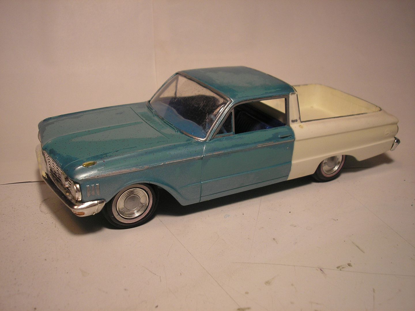

von Zipper Posted March 1, 2014 Share Posted March 1, 2014 I guess the reason I mentioned the Comet in a Falcon Ranchero thread is because at one time I studied on taking one of these re-issued Ranchero kits and bashing it with a 1962 Comet front clip As I mentioned before, the Comet wagon was a Falcon wagon with a Comet front clip-BUT- in Modelsville the two plastic bodies will not line up. ( I studied on it) And I thought the Comet front clip should line up to the Ranchero body. Obviously they interchange in real life but not in plastic. Quote Link to comment Share on other sites More sharing options...

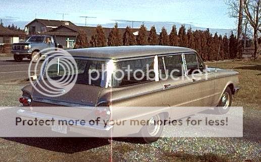

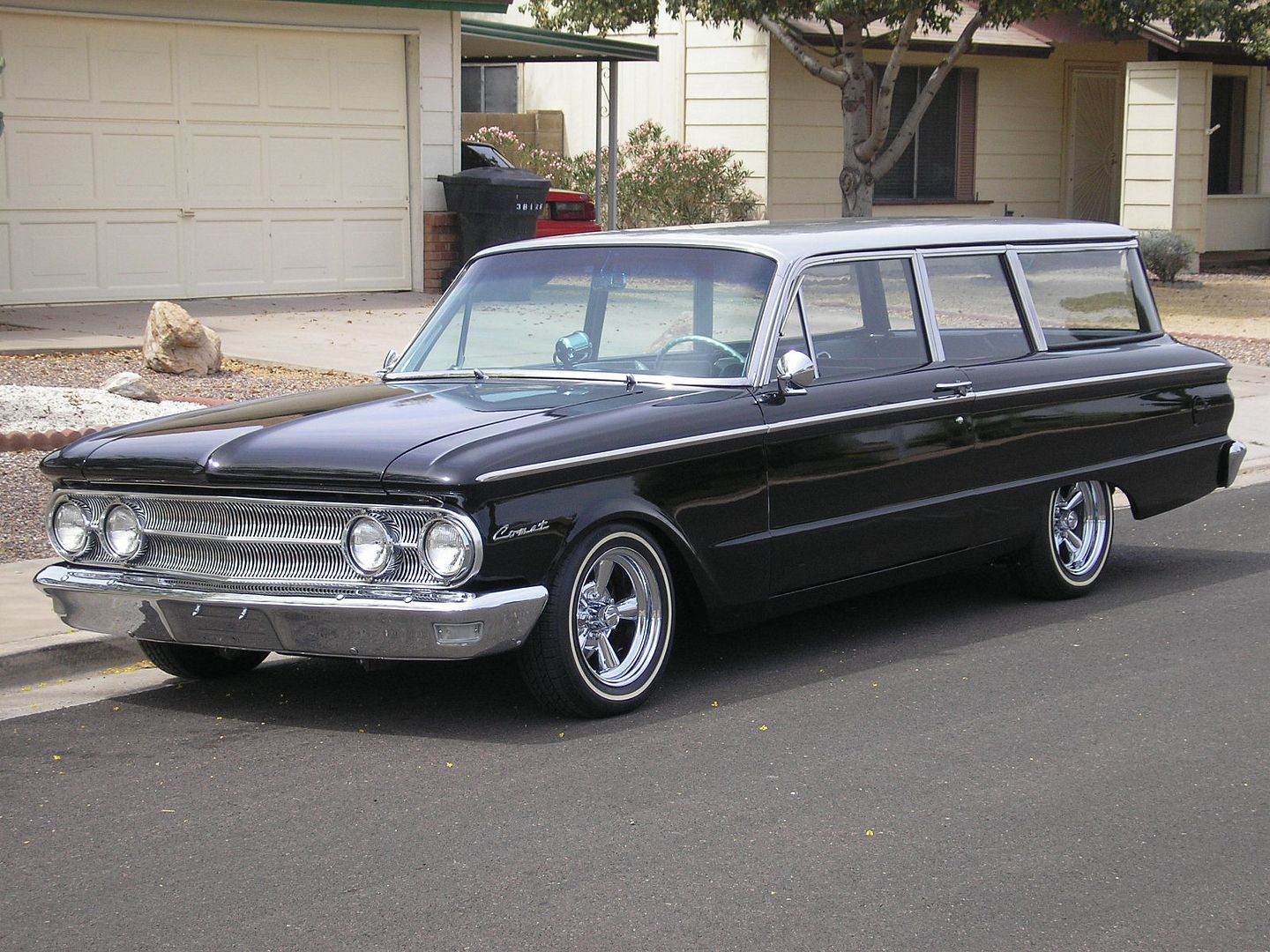

Maindrian Pace Posted March 5, 2014 Share Posted March 5, 2014 As I mentioned before, the Comet wagon was a Falcon wagon with a Comet front clip-BUT- in Modelsville the two plastic bodies will not line up. ( I studied on it)And I thought the Comet front clip should line up to the Ranchero body. Obviously they interchange in real life but not in plastic. You sure about that? My avatar car is in my garage: -MJS Quote Link to comment Share on other sites More sharing options...
mk11 Posted March 5, 2014 Share Posted March 5, 2014 Beautiful wagon mike Quote Link to comment Share on other sites More sharing options...
Dawson Posted March 5, 2014 Share Posted March 5, 2014 Mr. Maindrian Pace, You have a very nice Mercury Comet Station Wagon. What year is it ? Is your car built on the Ford Falcon chassis or the Ford Fairlane chassis ? thanks, Larry Quote Link to comment Share on other sites More sharing options...
Maindrian Pace Posted March 5, 2014 Share Posted March 5, 2014 Beautiful wagon mike Thank you Mike. I've owned it for almost 27 years now. Mr. Maindrian Pace, You have a very nice Mercury Comet Station Wagon. What year is it ? Is your car built on the Ford Falcon chassis or the Ford Fairlane chassis ? thanks, Larry Thanks Larry. It's a 1960, first year for the Comet/Falcon. It is based on the Falcon chassis, with the wagons being the same wheelbase as the Falcon wagons and sedans at 109.5". The Comet sedans had a five inch longer wheelbase at 114.5", but their chassis was otherwise the same. My Comet 2dr wagon uses the same 1/4 panels as the Ranchero and Falcon 2dr wagon, which shows just how closely related the cars are. The midsize Fairlane, introduced in 1962, had a chassis with a similar layout, but everything was different and nothing interchanged with the Falcon/Comet. -MJS Quote Link to comment Share on other sites More sharing options...
