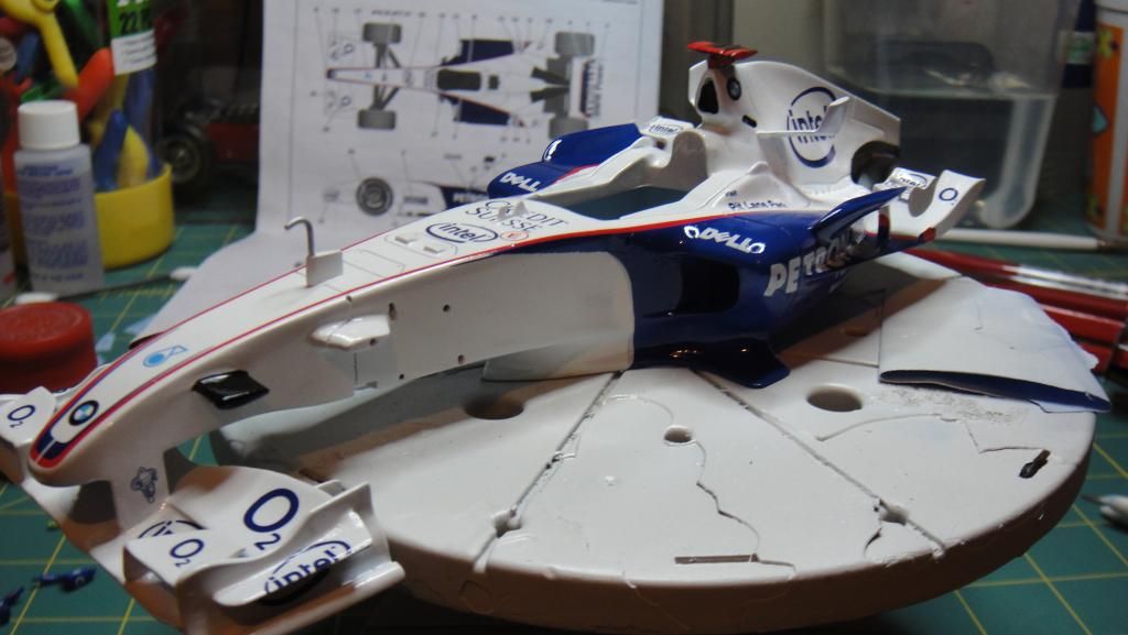

ferrarijoe Posted August 3, 2014 Share Posted August 3, 2014 Createx is pretty good (If you have hobby lobby 40% coupon you can get the set with reducer pretty cheap. It is a semi gloss finish, so you have to clear, and it likes to orange peel. Vallejo makes and pre thinned airbrush paint, its the Model Air line. My Studio 27 resin Sauber is Createx Wicked White and Wicked Blue thinned with their high performance reducer, with Future as clear. Quote Link to comment Share on other sites More sharing options...
