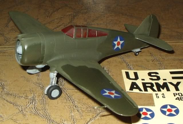

Snake45 Posted June 1, 2015 Share Posted June 1, 2015 (edited) Snake, would you share the ratios/proportions of each ingredient in your brew? Squirt some Elmer's in something like a pill bottle or 35mm film thing. Thin it with HOT water--the hot water mixes much easier/faster than cold. Thin to whatever you want for working consistency (I like almost a gel)--it will take MUCH less water to thin the Elmer's than you'd think. If you get it too thin, just add more glue. When you get it where you want it, add in a drop or two (doesn't take much) of Dawn or another dishwashing soap (to cut surface tension, and also seems to help with easy removal). A squirt of food color (I like red) is optional--it lets you see where you're putting the stuff, and where it is when it's dry (i.e., no bare spots). Apply with an appropriately sized paintbrush, which will clean up just fine under hot running water in your kitchen sink. Been using this stuff for years. Couldn't be simpler and I can't imagine anything working better. Here's some of my stuff being used to mask the clear parts of an old AMT P-36 model. The dark spots on the airplane are where I've hand-brushed Future for the decal application. Here's what the finished model looks like. Edited June 1, 2015 by Snake45 Quote Link to comment Share on other sites More sharing options...
