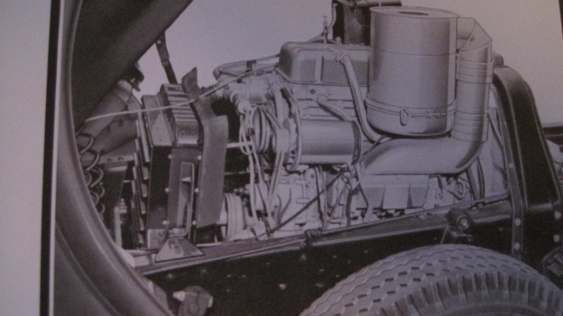

landman Posted March 21, 2016 Share Posted March 21, 2016 The 534 as installed in my N600: And in an ad: Quote Link to comment Share on other sites More sharing options...

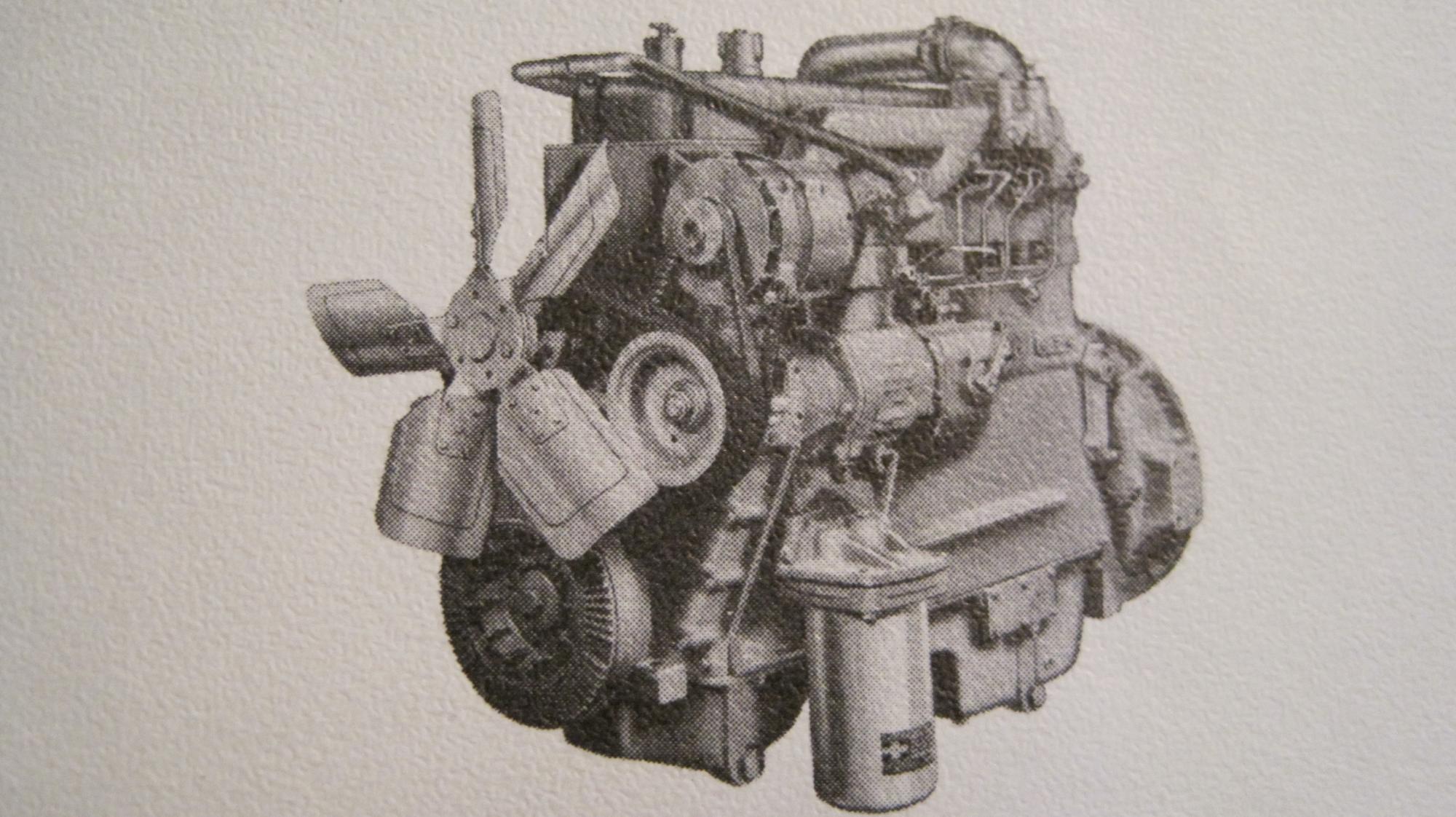

leafsprings Posted March 21, 2016 Share Posted March 21, 2016 (edited) Cummins C 160, similar to C 180 used from '65-'69 Edited March 21, 2016 by leafsprings Quote Link to comment Share on other sites More sharing options...

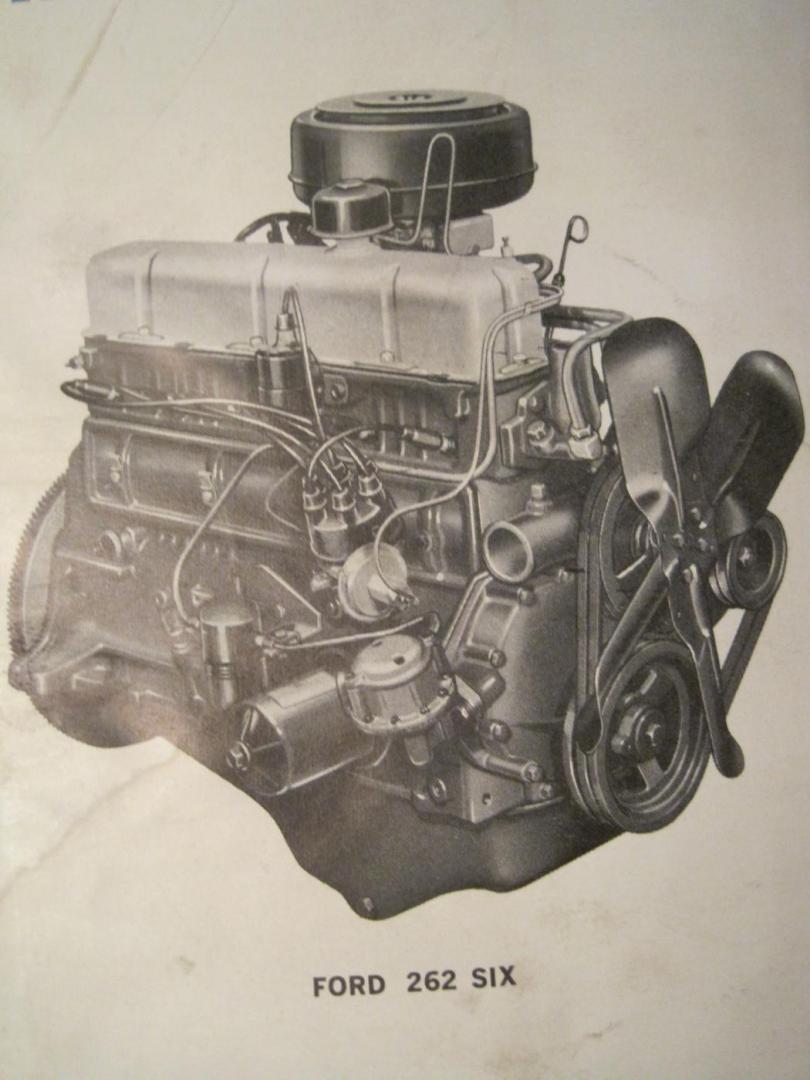

leafsprings Posted March 21, 2016 Share Posted March 21, 2016 262 Big Six, used from '61-'64, in C 550- C 600's. Quote Link to comment Share on other sites More sharing options...
