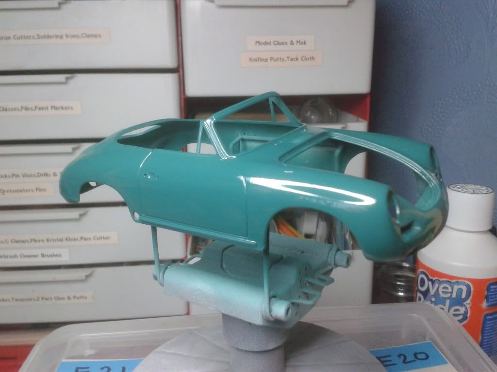

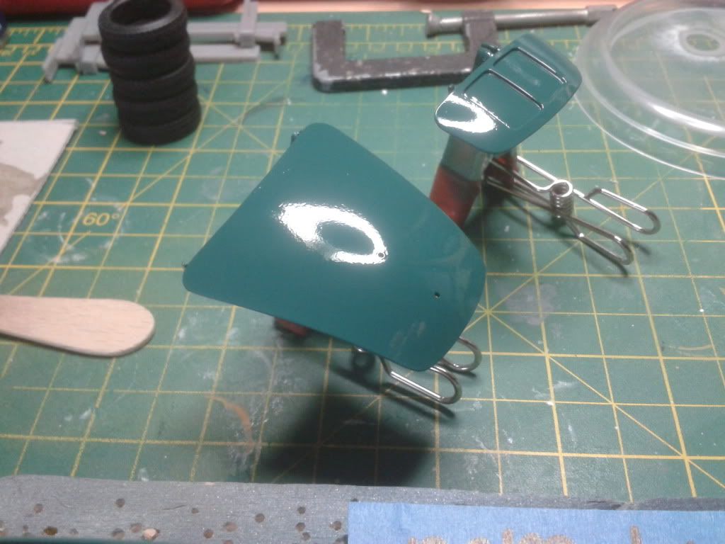

GeeBee Posted April 30, 2013 Share Posted April 30, 2013 I'll try and explain what I do using photo's Bodyshell sanded to remove any flash and mold line, a few coats of plastic primer, then wet sanded using 3600 grit paper, if you have any marks or defects in the primer coat no matter what you do, it's going to show through the colour coats I use cellulose lacquer, but most paints work the same, cellulose just sets quicker and needs a little more polishing, a few mist coats, then build up the coats until the coverage is good, then I usually go over with a good wet coat Although the paint looks good, you can see on the bonnet the orange peel, but that's not a problem, I leave my paint to harden for at least 48 hours, then it's on with the wetsanding, again starting with 3600, then 4000, and finish off with 6000 Once the paint is levelled out, I start the polishing process, first I use the compound that comes in the Micro Mesh polishing kit, then different grades of automotive polishing, starting the Poorboys SSR2, then finishing with meguires swirl X, if you've got it right, you should end up with the paint looking like this Quote Link to comment Share on other sites More sharing options...

John Pol Posted April 30, 2013 Author Share Posted April 30, 2013 Thanks guys I`m sure you helped me and others and thanks for the photos it does help. I guess with metallic paint jobs you would have to watch your sanding process. John Pol Quote Link to comment Share on other sites More sharing options...
