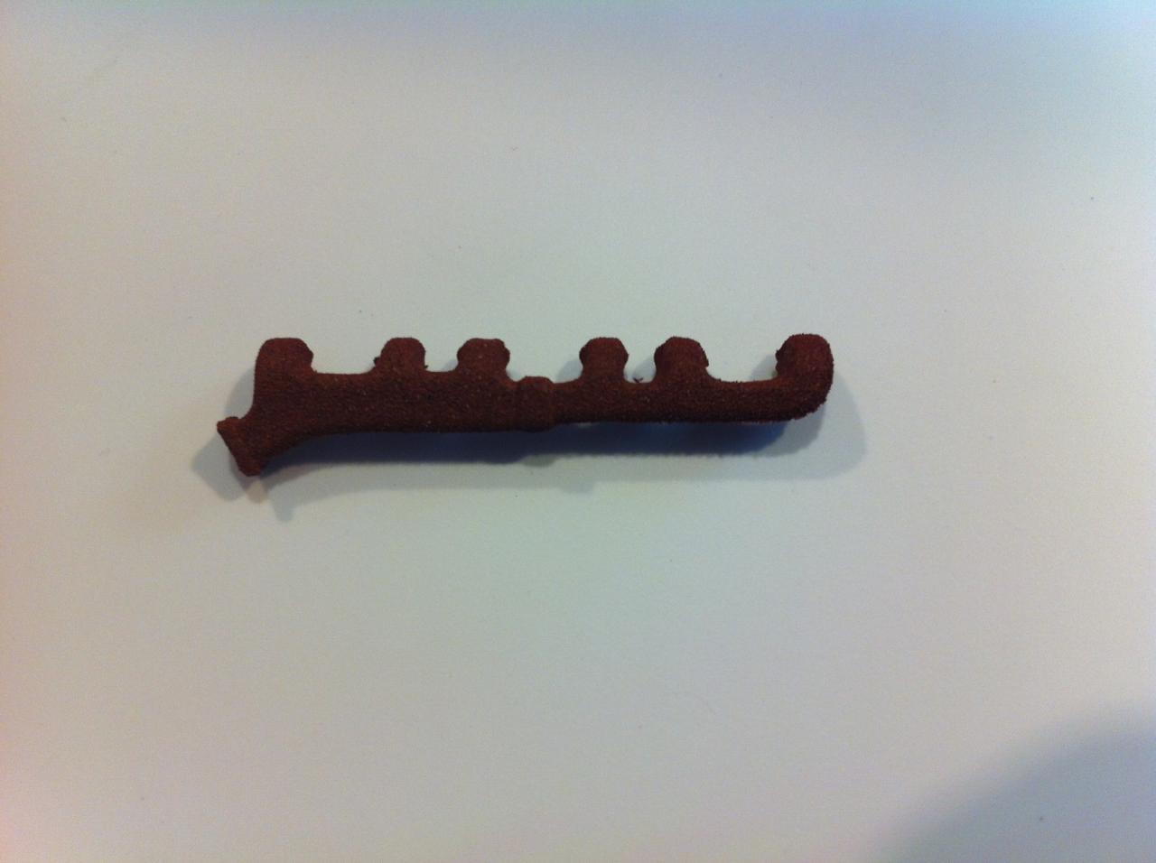

Petetrucker07 Posted September 29, 2014 Share Posted September 29, 2014 (edited) Here are a few pics of some small pieces. The exhaust manifold for a NHC cummins, the 5th wheel for freightshaker COE. The manifold i sprayed red oxide, let it dry, then held the can back about 4 feet and let the dust settle on the piece. Then dusted with flat black, flat beige, then dusted again with red oxide. The 5th wheel i sprayed CAT yellow, let it dry. Then sprayed flat black, while it was still wet, i dragged the surface across an old block of wood. That let some dust from the wood get into the grooves. Edited September 29, 2014 by Petetrucker07 Quote Link to comment Share on other sites More sharing options...
Superpeterbilt Posted September 29, 2014 Share Posted September 29, 2014 Looks good man Quote Link to comment Share on other sites More sharing options...
Jim B Posted September 29, 2014 Share Posted September 29, 2014 I like them both. They look nice. Good ideas. Quote Link to comment Share on other sites More sharing options...
