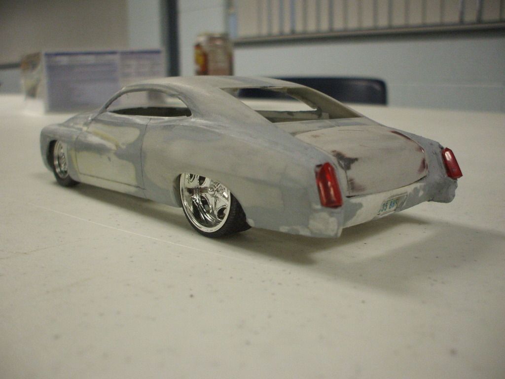

Trans Am Erik Posted July 20, 2012 Author Share Posted July 20, 2012 Flush mounting the tail lights Quote Link to comment Share on other sites More sharing options...
Trans Am Erik Posted July 20, 2012 Author Share Posted July 20, 2012 The lenses are not glued in yet. I get the shape of the sockets about right with putty. When the putty is about half dry I push the tail lights into place and take them back out. When the putty is dry I sand the fenders, put the tail lights back in, still with no glue, and check my fit. Pull the lights out and repeat til I'm happy with the fit. Quote Link to comment Share on other sites More sharing options...
crazyjim Posted July 20, 2012 Share Posted July 20, 2012 Oh okay. Thank you. Keep working on this puppy. It looks so good. Since it's a custom, I bet it'll be SHINY :) . Friday night. Time for pizza, pool, popcorn, and WWE Friday Night Smackdown. Yeah!!!! Quote Link to comment Share on other sites More sharing options...
Trans Am Erik Posted July 20, 2012 Author Share Posted July 20, 2012 Also, before the putty is dry if I have any putty on the lenses (I did), run the lenses under warm water and scrape off the putty with your fingernail. Quote Link to comment Share on other sites More sharing options...
Trans Am Erik Posted July 20, 2012 Author Share Posted July 20, 2012 Oh okay. Thank you. Keep working on this puppy. It looks so good. Since it's a custom, I bet it'll be SHINY :) . Your welcome, and yep it will be shiny, "Eleanor" gun metal grey metallic Quote Link to comment Share on other sites More sharing options...

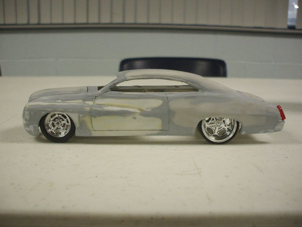

Trans Am Erik Posted November 1, 2012 Author Share Posted November 1, 2012 Quote Link to comment Share on other sites More sharing options...
Jantrix Posted November 1, 2012 Share Posted November 1, 2012 Hey good to see this back on the bench! Looking good! Quote Link to comment Share on other sites More sharing options...
mrm Posted November 1, 2012 Share Posted November 1, 2012 Very nice so far. What are the wheels from? Quote Link to comment Share on other sites More sharing options...
ll Brandon ll Posted November 2, 2012 Share Posted November 2, 2012 Dang dude, this thing is really cool. It started out soooo rough and is really turning into something awesome. Quote Link to comment Share on other sites More sharing options...
72 Charger Posted November 2, 2012 Share Posted November 2, 2012 that is just to cool i may just have to try somthin like that keep up the great sanding job Quote Link to comment Share on other sites More sharing options...

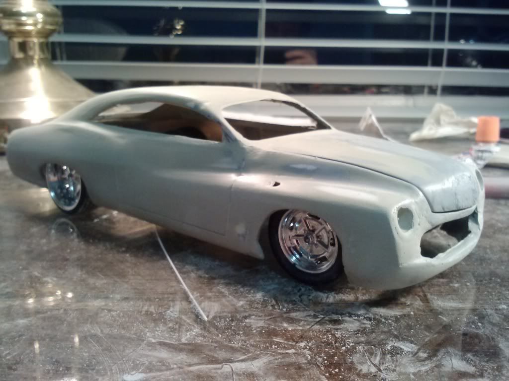

Trans Am Erik Posted November 28, 2012 Author Share Posted November 28, 2012 Quote Link to comment Share on other sites More sharing options...
BKcustoms Posted November 28, 2012 Share Posted November 28, 2012 Lookin good, I never would've thought an Impala rear would look so good on a Merc but it definitely does! What's the plan for the running gear? I think a modern powerplant of some kind would be right at home in this. Quote Link to comment Share on other sites More sharing options...
Psychographic Posted November 28, 2012 Share Posted November 28, 2012 (edited) If you look at the general shape of the hood and tops of the fenders, they are very similar on both cars, I wonder how the headlights from the Fusion would look on the Merc. It would bring some of the sharp angles from the back and bring them to the front. I don't know if you've noticed it or not, but the front is all rounded shapes while the back has crisp lines and angles, the headlights might balance it out a little. On the other hand it might be too much and you could lose all resemblance of the Merc. Edited November 28, 2012 by Psychographic Quote Link to comment Share on other sites More sharing options...
tooltas Posted November 29, 2012 Share Posted November 29, 2012 4.6 or 5.4 mod, would be cool Quote Link to comment Share on other sites More sharing options...
Trans Am Erik Posted November 29, 2012 Author Share Posted November 29, 2012 Hi guys, I will be starting on the frame soon and it will be modern. I'm using the CheZoom frame, the problem is I need to find a much more detailed Corvette suspension to use. The IFS and the four link provided are awful. Billy and Todd: The drivetrain will be modern. I have a Cobra engine and a Lightning engine in the parts bin. However, one idea was to take one of them and stretch it into a Triton V-10, and keep the supercharger. David: I am going to keep the round headlights to keep the identity of the Merc. I see the problem of the round/sharp thing. The grille will have sharp edges, plus I was thinking of modifying the hood, and maybe the front valance somehow. I would like to take the "whale" look the nose has and make it more muscular and angry. Quote Link to comment Share on other sites More sharing options...

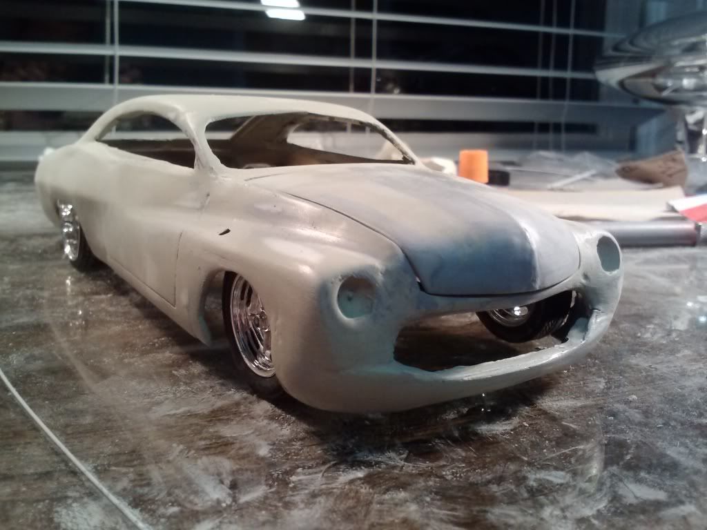

Trans Am Erik Posted December 2, 2012 Author Share Posted December 2, 2012 Quote Link to comment Share on other sites More sharing options...
Trans Am Erik Posted December 3, 2012 Author Share Posted December 3, 2012 So, along with adding the seam to the hood and squared off it's edges. I also flattened out the surfaces of the fenders quite a bit. Now I have to find the best way to do the same treatment to the valance. The grille won't have a center seam. Quote Link to comment Share on other sites More sharing options...
BKcustoms Posted December 4, 2012 Share Posted December 4, 2012 I think that helped the lines a lot, The only thing I'd suggest is maybe rounding peak above the headlights just a little bit like the picture of the black merc you posted so it follows the curve of the hood a little better. Either way I like where this is going and I can't wait to see the end result! Quote Link to comment Share on other sites More sharing options...
