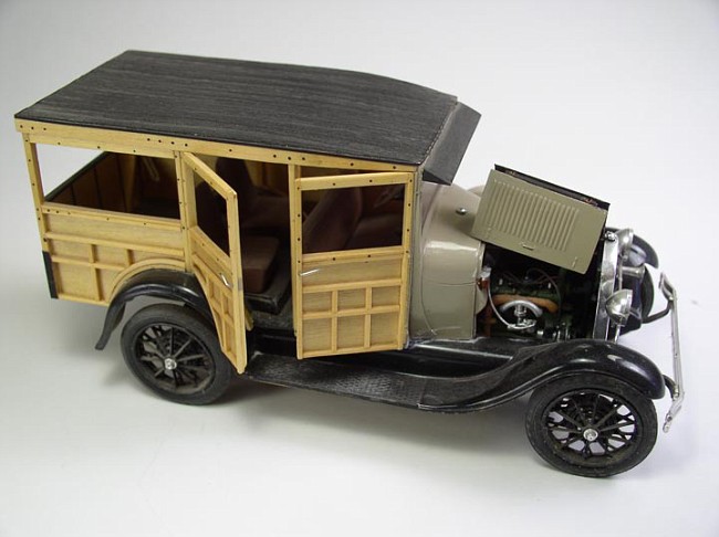

I built my first model woody back in 1985. After that I was hooked and built 5 more since using real wood to construct the passenger compartment and to this date have constructed a 1929, 1932, 1936, 1938, 1941 and a 1948 Ford woody wagons. All are a variety of vehicle types, the 1932 having a set of tracks and skis and the 1941 a Rat Rod of all things, LOL.
This time I decided to do a slot car based on the article posted above by the great Don Emmons. Don's article inspired this very model that I built back in 1988, but I took it a few steps further by making the doors and tailgate open. The woody was based on Revell's antique '29 pickup kit and because of that the running boards do not have passenger car rubber mats. This is something no judge has yet to catch, Haha, but since it's not really correct I added some weathering (mud) to hid that fact.

As Don did in the above article, 4 strips are soaked in hot water for about 10 minutes. After that the strips are very pliable and wrap around an object quite easily without breaking. After holding in place with rubber bands or a clamp, it is left overnight to dry.
The bent pieces are for the wheel arches and I did them side by side and stacked so that there are 4 total in two different diameters.
Then pieces are slowly cut and glued down in place using Elmers Carpenters glue because it is very strong and waterproof. Epoxy is used only where additional strength is required.
First attached: a top rail, then the doorposts and then the belt line and bottom piece. Lastly the inside structural pieces are laid down using the kit parts as a pattern, horizontal first and then the vertical.

If you are still following along the final step, after all the pieces are glued to the sides and the tailgate, is to block sand the edges flush. Some of the pieces are not exactly the same dimension and block sanding will ensure a nice flush look.
I didn't take any pictures of the step, but one of the last pieces added to the sides is a wide top rail, which I wetted in the middle and warped into a slight curve. This piece, once dry is glued securely. It will become the overhang over the doors. Plus, it will be carefully rounded for a nice transition to the rooftop.
With that in place the task of cutting open the window openings is next. "Window" is really a misnomer because no woody had any side glass until 1935 when Ford finally put roll up windows inside the doors of the front seat passengers only. Until then, all side openings were open to the air, and for inclement weather, snap-on canvas and isinglass curtains were provided.
Note that some plywood material is left in the upper cargo openings. This will replicate the cast iron gussets and brackets that were used to bolt these beautiful panels together. This also provides added strength. In-fact, I placed gussets and fillets in numerous locations for the same purpose.
Now, on a flat surface, the tailgate and the side panels are glued together and left to dry. Care must be taken to insure that the sides are parallel and the perpendicular to the tailgate. Use of a square is an excellent idea about this time.
At this angle is it possible to see that the top most rails project above the side panels quite a bit. This is to provide a place to lay the roof ribs, which we will do next!

Time to turn attention to the roof. Roof ribs from the middle door post to the rear are all the same width so a stack of them are carefully notched on both ends so they fit snug on both sides leaving a bit of a recess below the side rails for the roof slats. This is a great place to start using epoxy. The two ahead of the middle door post are custom cut to fit since the roof tapers toward the cowl. The header took a lot of fiddling and to get correct, as I want a nice tight fit between the wood and the cowl. Mounting on the fenders/cowl is necessary and epoxy a requirement in this location.
After the ribs are solid it is time to start on the roof slats. All woodies from the early horse drawn "wagons" to the last all-wood Station Wagon of 1948 used similar construction techniques. With regard to the roof... that means a series of thin slats laid over ribs followed by a chicken wire mesh, then batting and finally an oil-cloth/vinyl roofing material. The last was pulled tight and attached with a tacking strip all around the edges held in place with small nails.
Since most early woodies had mostly flat roofs, the laying out of the slats is pretty straightforward. Tack on the slats at the rear and once that is dry a touch of water applied to the curved area with a paint brush and allowed to soak in. Then epoxy applied to the header (where I left a nice wide shelf for attachment purposes.) and the slat bent down. It is held in place with a clip until the epoxy sets.
This part of the project is the most tedious as I can only do a few slats at a time so as to allow plenty of drying time. Eventually, only the last few slats in the center are left. At that point I slather a lot of epoxy over all the slats effectively burying them permanently assuring plenty of strength. While it is drying, a few clips and a nice block used to insure that all slats dry smooth and level. Leaving like this over night is a must.
After all has cured, block sand the roof and round off the side rails, first with 220 and then with 2400 to get it all smooth.

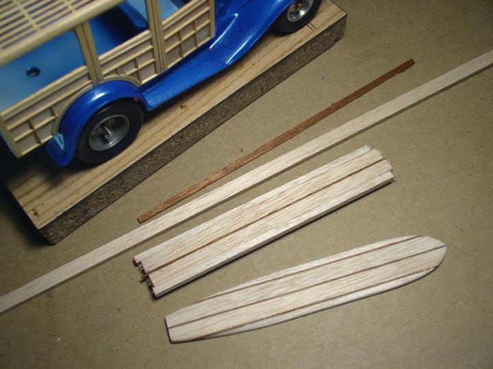

Picked up some balsa wood from the hobby shop today and laminated that with thin strips of Honduran Mahogany. The goal is sanding and forming a set of "Dewey Weber" long boards, the best of the best in 1964! Going to take a long time to carefully form them as I don't want to take off too much material. Both will be fiberglassed but only one will be painted, the other hopefully to remain wood with nothing more than a hand painted decal.

I spent most of last night shaping a couple of surf boards. Tried to get them like the famous "Dewey Weber" long boards. One with a standard skeg and the other a custom "Hatchet" for better control. Both boards have received a coating of fiberglass which will be wet sanded and then clearcoated. One will remain wood and the other gets a period coat of graphics before the clear.
