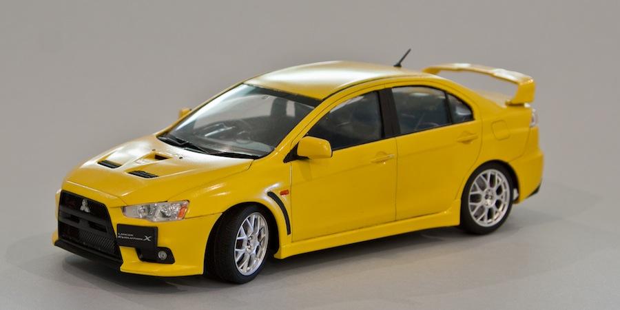

I use Tamiya tape. The edge is pretty sharp by itself, if it's burnished well, but a trick I learned is the lay the tape on your cutting board and use a ruler to slice the tape in half. With a sharp #11, the two "inside edges" will be super-sharp. Just remember to burnish, burnish, burnish!
Attached File  Lancer 1.jpg   34.64K   6 downloads
