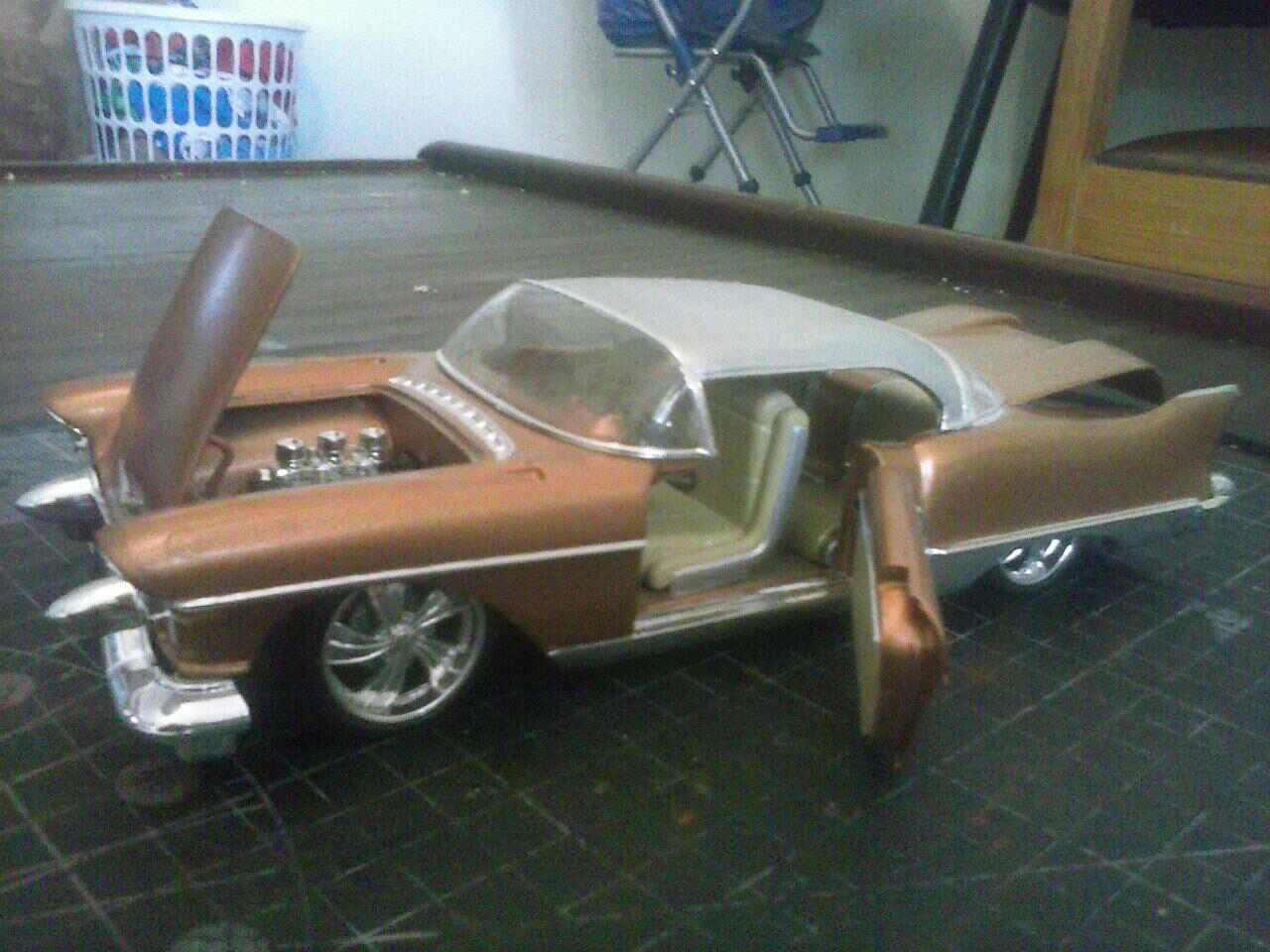

codie27 Posted April 1, 2013 Share Posted April 1, 2013 Here's my only build of this kit. I decided after opening the box there was very little I liked about the kit so I decided a kustom was the way to go for me. The mods speak for themselves so I won't go into it unless anyone has any questions. As unimpressed as i was with the kit I would buy another one. Quote Link to comment Share on other sites More sharing options...
