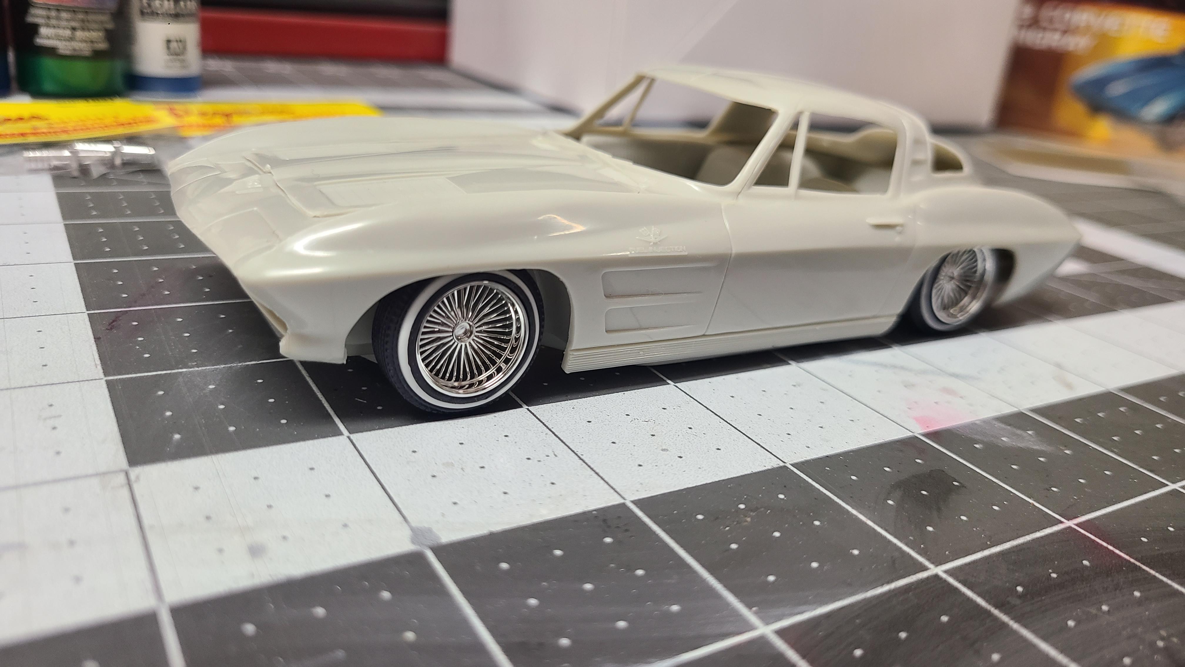

  6. Spent some time on the Vette today. Got most of the engine assembled, it's not much to see atm. Also worked on this for the interior.
  7. I was inspired by a rendering I saw online. Was originally thinking white pearl with some silve/blue/green panels. Now having second thoughts. I like the original rendering color as well.
  8. Not much done other than set the ride height. Had to make some axle locators from sheet styrene, as the kit ones wouldn't allow it to sit low enough. Also realized that my hood hinge isn't really prototypically correct, but I like the way it hinges out better.
  9. Yes, wire axles. Should make it easy to lower.

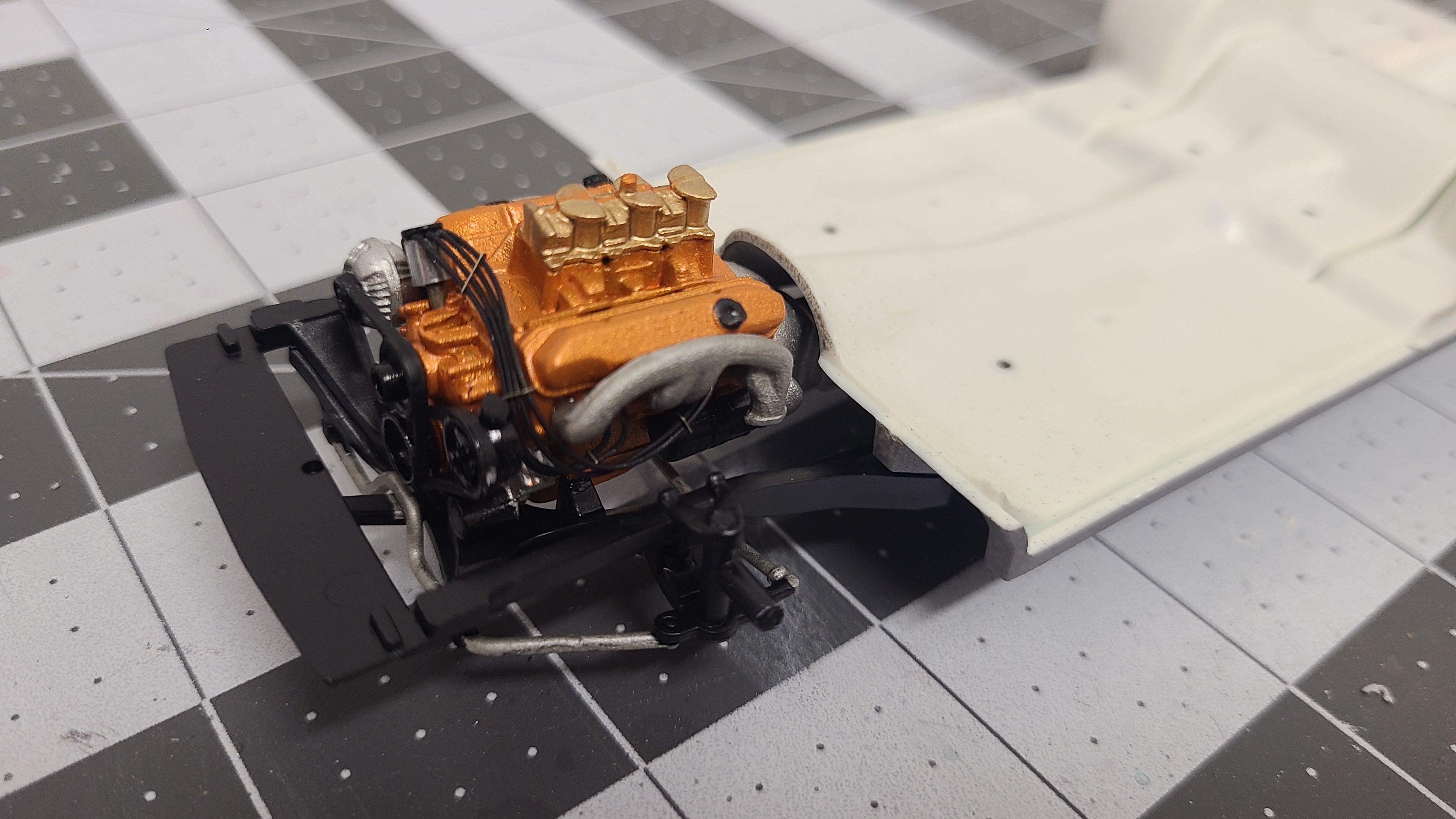

  12. AMT 1968 Plymouth Roadrunner. Swapped in a 440 6bbl from the AMT GTX kit. Made some drop spindles for the front, though not as much as I would've liked, and the big wheels negate some of the drop. Paint is Createx Wicked Silver metallic. Trim blacked out with Sharpie (I really need to work on the steadiness of my hand), bumpers and grill painted a custom mix of Gunmetal with Createx acrylics.

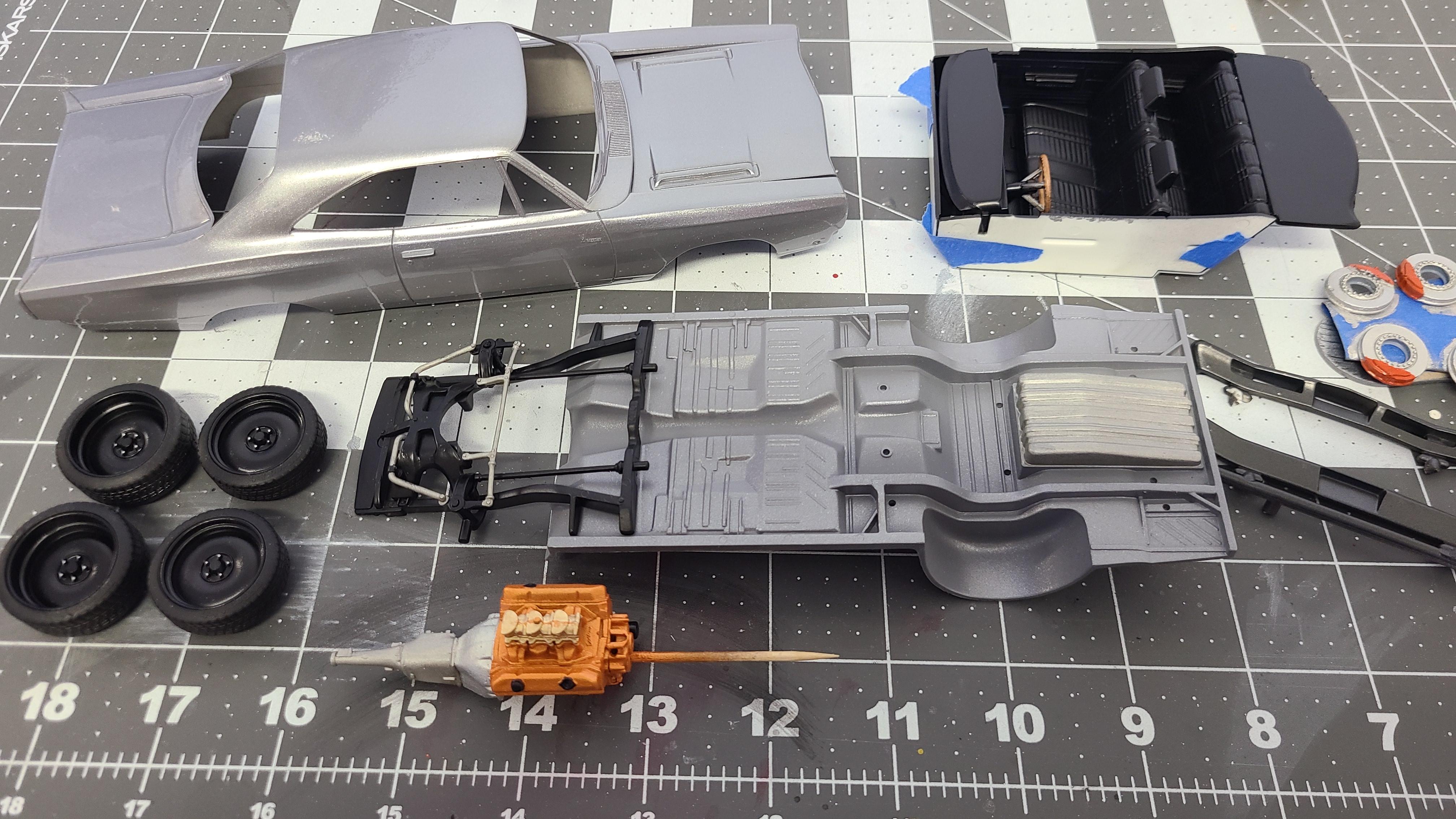

  14. Progress mockup of my '68 Roadrunner.
  15. Some progress today.
  16. Small amount of progress.

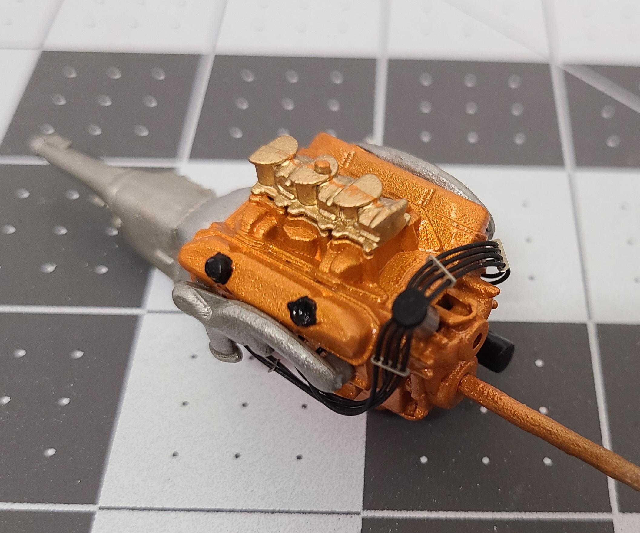

  17. Thank you. Wired up the engine last night.

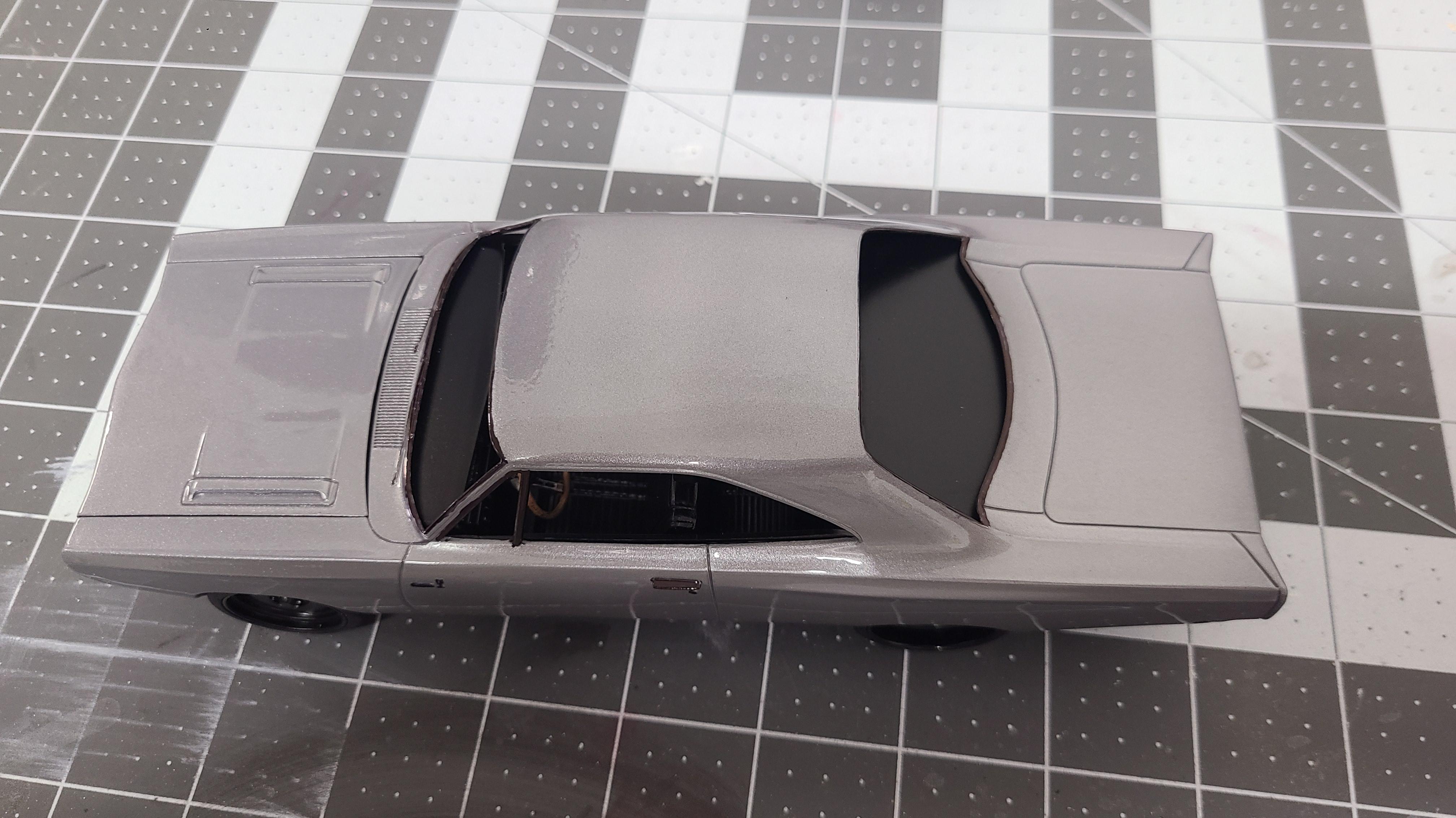

  20. Body now refinished, Stynylrez primer, Createx Wicked Silver metallic, 2k clear. Much better. Also got some other parts painted.

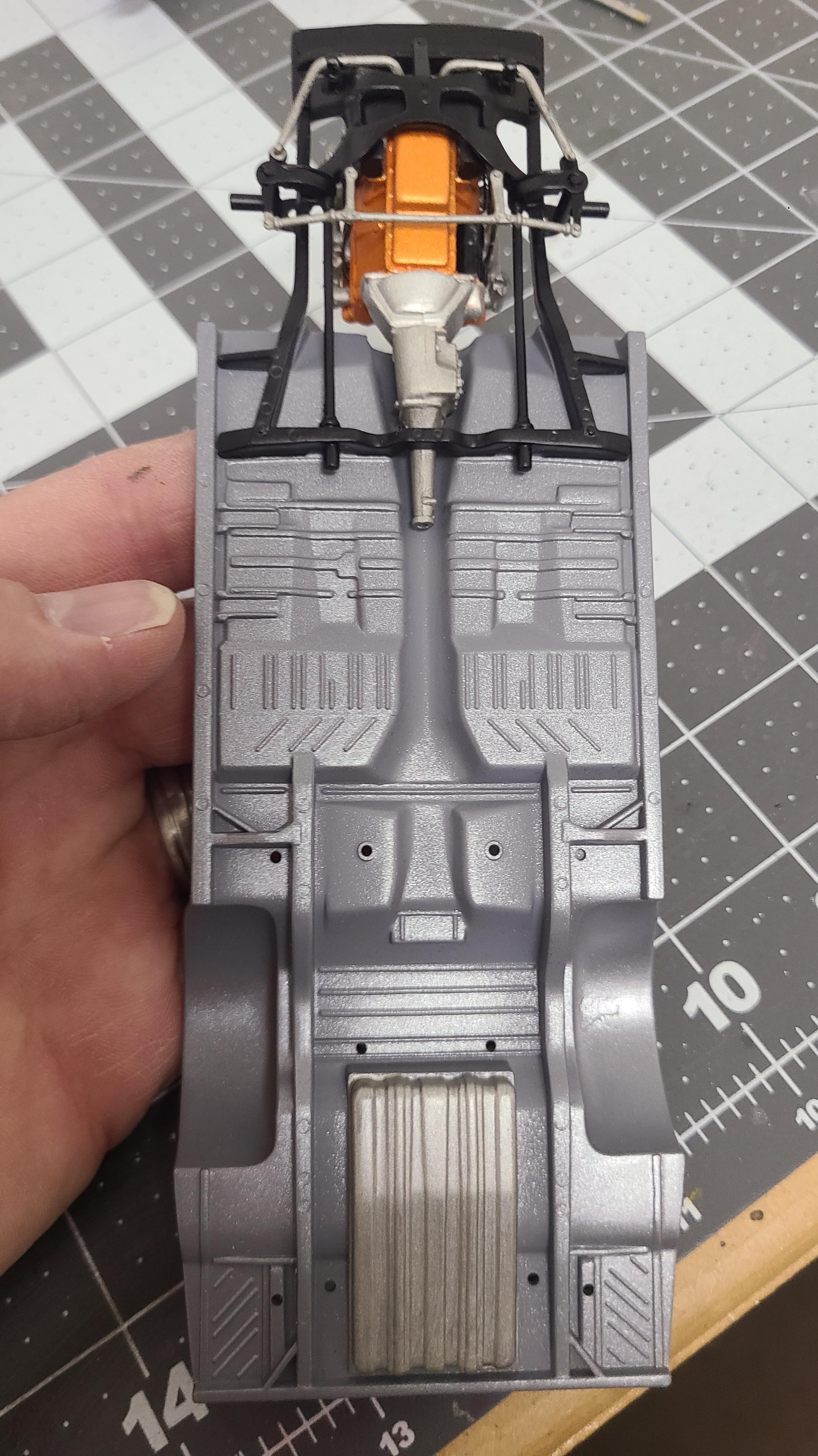

  24. The four speed that comes in both the Roadrunner and GTX kits is the same, just using it.
