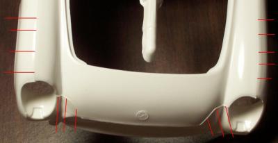

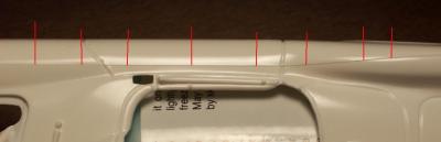

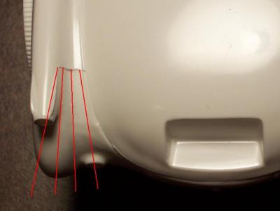

Sidney Schwartz Posted March 16, 2015 Posted March 16, 2015 This is my first question here (see my post in the Introduce Yourself section). My first project will be the Monogram 1953 Corvette. Kit number seems to be 2291. The body has some lines on it that I'm guessing are molding lines that need to be removed, but I thought I'd check with the folks here and make sure before I do try removing them. Thanks in advance for your assistance.
1930fordpickup Posted March 16, 2015 Posted March 16, 2015 Most of them seem to be just that . Google the car you are working on and see if you can find picture of the real one to check where the body seem are and are not.
Sidney Schwartz Posted March 16, 2015 Author Posted March 16, 2015 Thanks, Andy. The photos I've seen don't show any such seam lines. Looks like I get lots of filing and sanding practice. Oh well...you deal with what you find when you open the box. I think Forrest Gump said that.
southpier Posted March 16, 2015 Posted March 16, 2015 those are pretty prominent. after you get the most obvious gone, you might try a guide coat of primer to help you see what's left.
Drake69 Posted March 16, 2015 Posted March 16, 2015 those are pretty prominent. after you get the most obvious gone, you might try a guide coat of primer to help you see what's left. Agreed. A light coat of gray primer will help you see anything you might have missed earlier. This happens a lot with repeated repops.
Art Anderson Posted March 16, 2015 Posted March 16, 2015 Agreed. A light coat of gray primer will help you see anything you might have missed earlier. This happens a lot with repeated repops. FWIW, that body shell was shot in tooling originally designed and used to cast the body as a diecast metal shell--it had those mold parting lines rather prominent way back in1977 when the metal bodied kit was first introduced. Art
Sidney Schwartz Posted March 16, 2015 Author Posted March 16, 2015 FWIW, that body shell was shot in tooling originally designed and used to cast the body as a diecast metal shell--it had those mold parting lines rather prominent way back in1977 when the metal bodied kit was first introduced. Art Interesting. Annoying, but interesting. Thanks all for the help. Once I get started on this project I'll post some pics of my progress.
