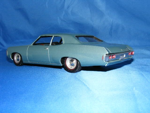

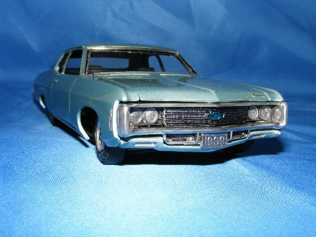

No one makes a 4 door '69 Chevy. However, MCW Resins makes a '69 Biscayne 2 door post sedan, which can be used as a basis for the 4 door sedan. It will take a little work, but it can be done. Here is my model from the resin kit.
A 4-Door woild be very interesting. If it were me, I would use this kit as the base, along with the currently available AMT '70 Impala, which is the kit that should be used to do this. MCW also does the '69 Impala SS, so he could supply the three lamp rear bumper used on the Impala also. In doing my model, I did not care for the way that the roof line was done, so I slanted the rear window forward, and re-did the side window profile, adding new drip rails in the process.
To do the 4-door, I would completely remove the center pillar, and shorten the sail panels, along with the other modifications I performed on the sedan. I would use the the '70 Impala interior, even though the upholstery pattern is different, it is the closest thing available in scale, and it has a front bench seat.
On the one to one, the roof panel is the same between the two and four door sedans. Add some body side mouldings made out of plastic rod, some photoetch Impala scripts, and there you go.

Ron, wow, thanks for the pics and explanation. That biscayne looks incredible, and through your pics and description I can see how I could use it as a basis to make a 4 door Impala. Who is MCW?
