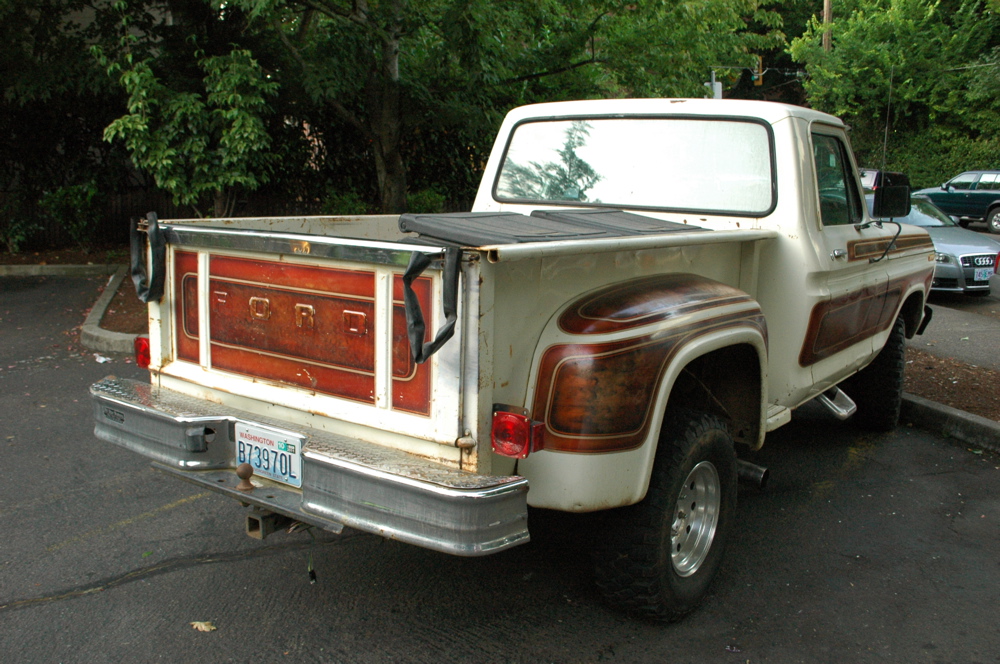

Fat Brian Posted August 3, 2016 Share Posted August 3, 2016 (edited) The only modification you'll need to make is that the 50's beds had the tops of the bed rails angled were on the later trucks they were flat but this is a super easy change to make. This is an early bed And this is a later bed Edited August 3, 2016 by Fat Brian Quote Link to comment Share on other sites More sharing options...
mk11 Posted August 10, 2016 Share Posted August 10, 2016 (edited) The flat top sides started with the '77 trucks. Ford used the same style and width flare top beds from 53-72. In 76, after a three year break, they reinstituted the short flareside box, but it was wider (just a shortened eight foot flareside box) to match the new rear axle width brought out in 73. The sides proved too tall with the flare so they flattened them for the 77 and later trucks.You basically have your choice of four boxes: the 1/25 mpc and amt '53s, the 1/25 revell '56 or the 1/24 monogram '55. mike Edited August 10, 2016 by mk11 Quote Link to comment Share on other sites More sharing options...
