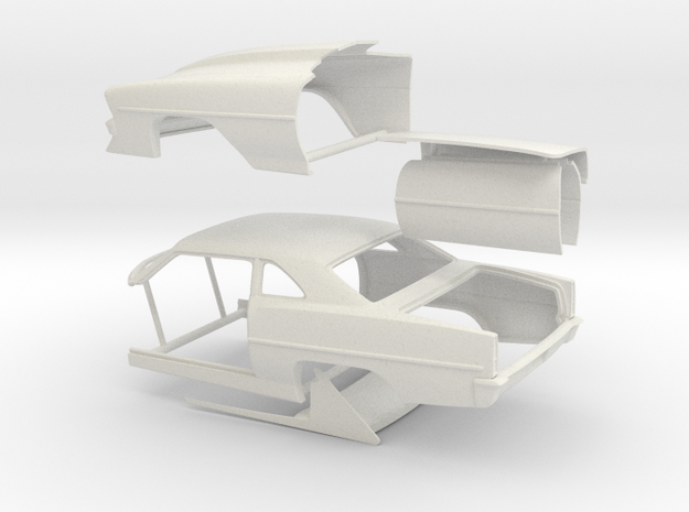

Mooneyzs Posted May 13, 2017 Posted May 13, 2017 Great looking body, is there a link or a website for TDR?Here is 2 links.... their site and their store on shapewayshttps://sites.google.com/site/tdrhtmllearn/https://www.shapeways.com/designer/tdr_innovations/creations

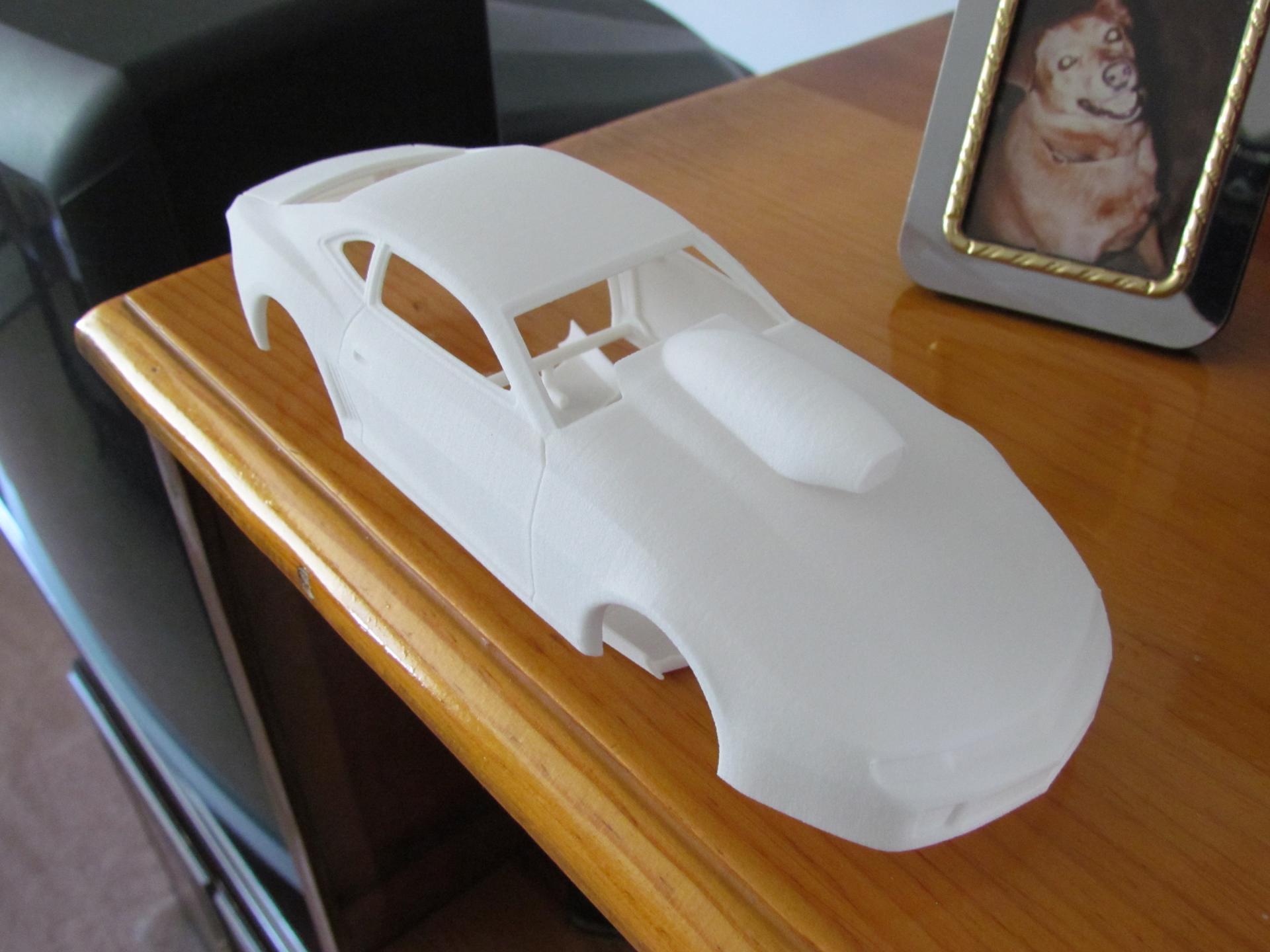

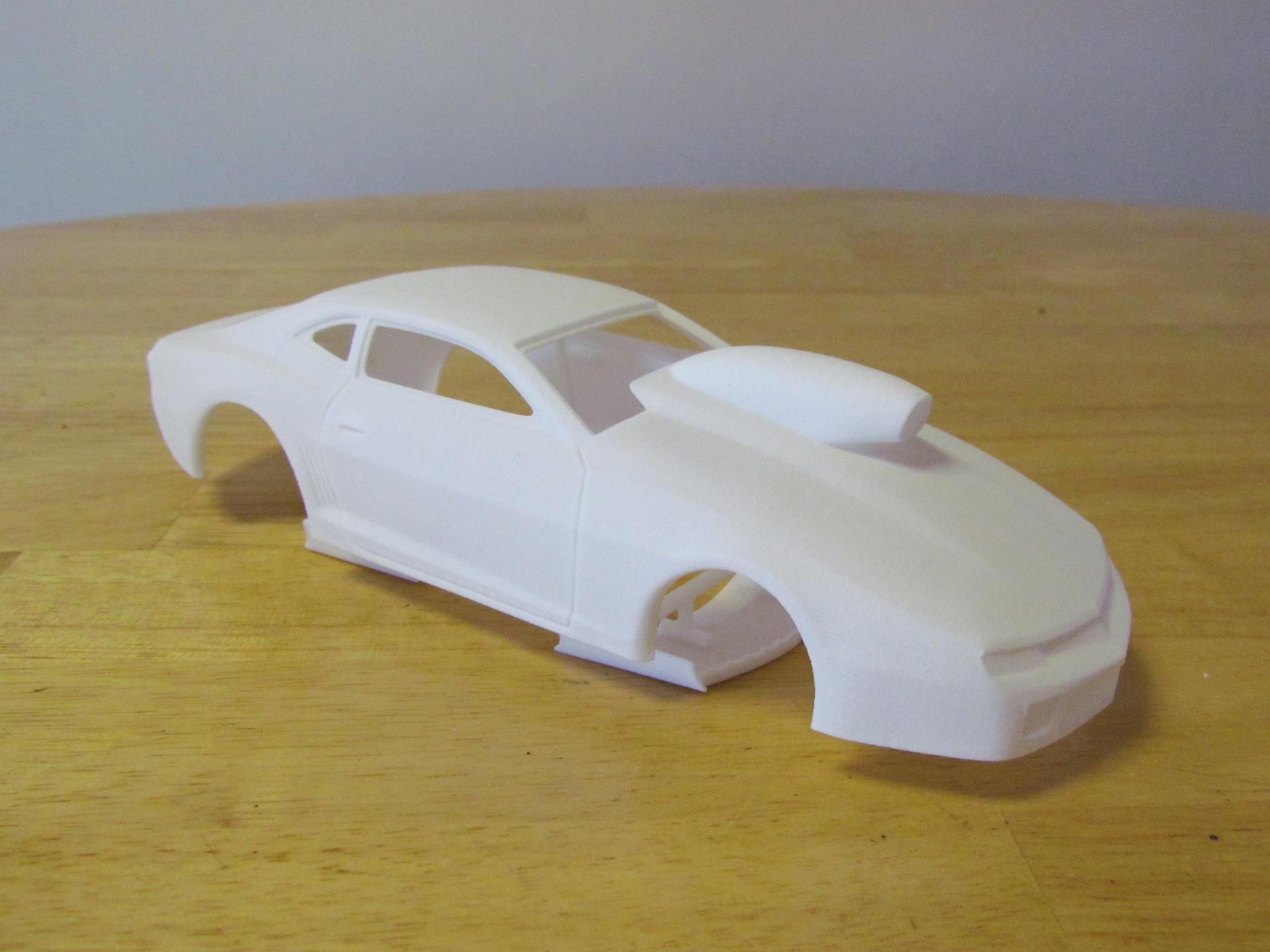

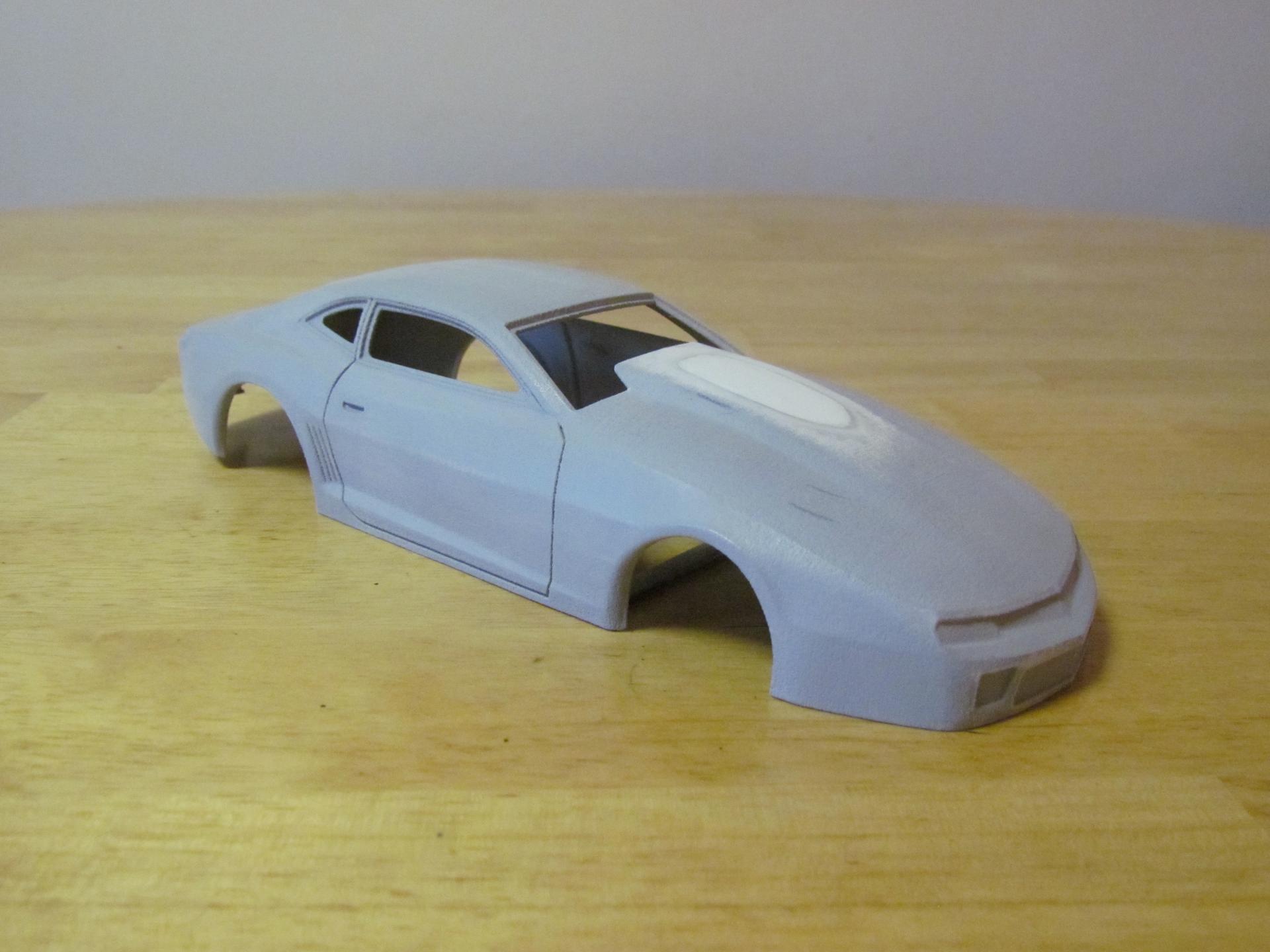

crowe-t Posted May 14, 2017 Posted May 14, 2017 (edited) I recently got a body from TDR! I got the 2013 Pro Stock Camaro in White Strong & Flexible material. It has a grainy surface so I'm using Duplicolor Filler primer to smooth it out. It takes some priming and sanding a few times but smooths out nicely. The picture in primer is almost done. I still have to finish sanding and maybe another coat or so of primer. Edited May 14, 2017 by crowe-t

crowe-t Posted May 20, 2017 Posted May 20, 2017 (edited) Ron, The TDR 2013 Pro Stock Camaro I posted above is the 1st 3D printed body I got. The White Strong & Flexible(WSF) material does have a grainy surface. This attached picture shows the grain. I am using Duplicolor Filler primer on the body. If you also got the WSF material you don't have to clean it. Just spray on high build filler primer and sand. Don't even bother sanding the body first, just spray the primer on and after it cures sand the primer. I am using 400 grit paper and wet sanding. This procedure(priming and sanding) will have to be done a few times depending on how much grain is on the body. As long as you follow the body lines while sanding the details will stay. The 3D printed WSF bodies aren't as easy to work with as a styrene body but after you start priming and sanding you'll see it start smoothing out. My 2013 Pro Stock Camaro is just about all smoothed out and looks good. I'll take more pictures over the weekend and post some. Edited May 20, 2017 by crowe-t

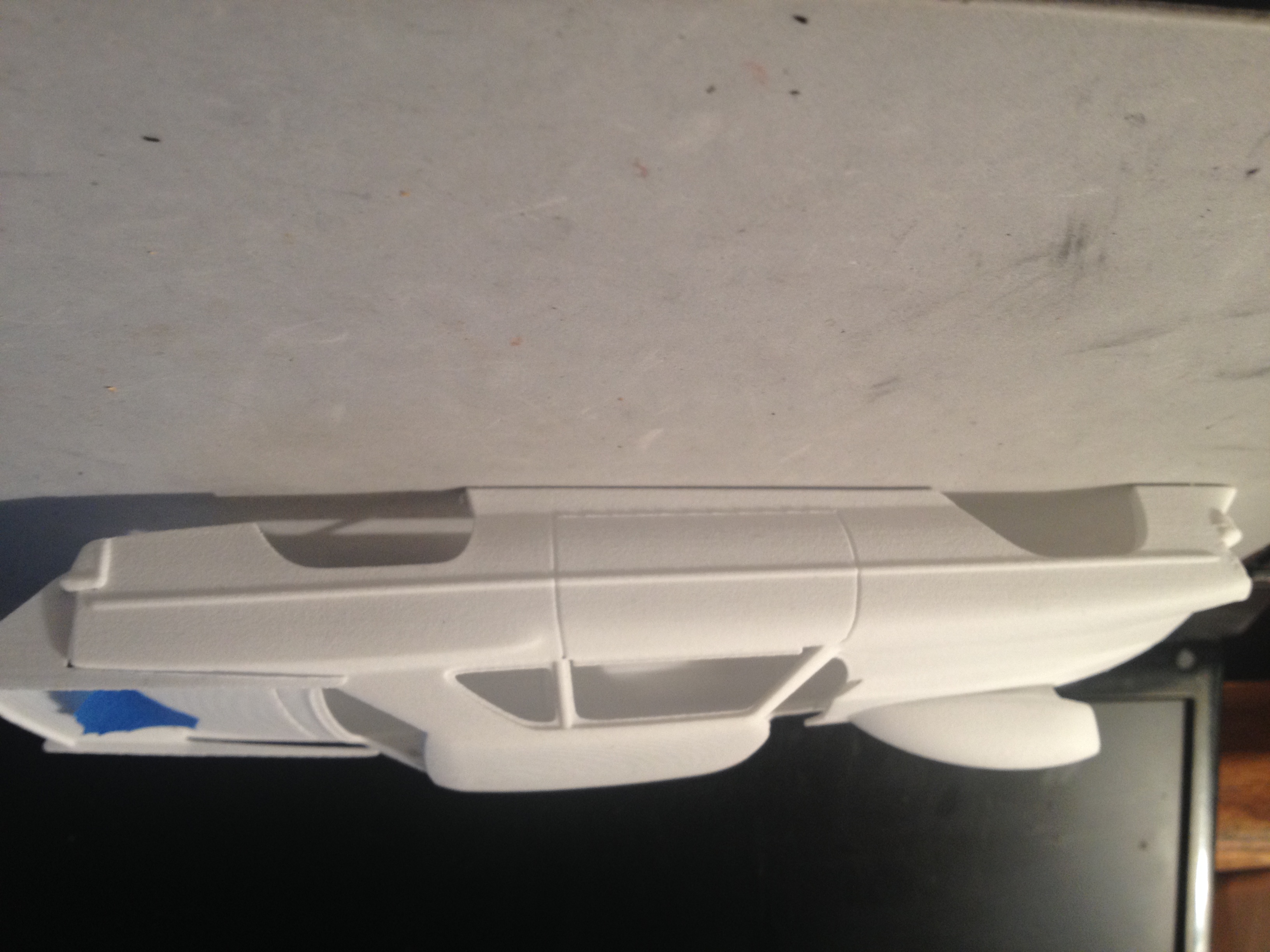

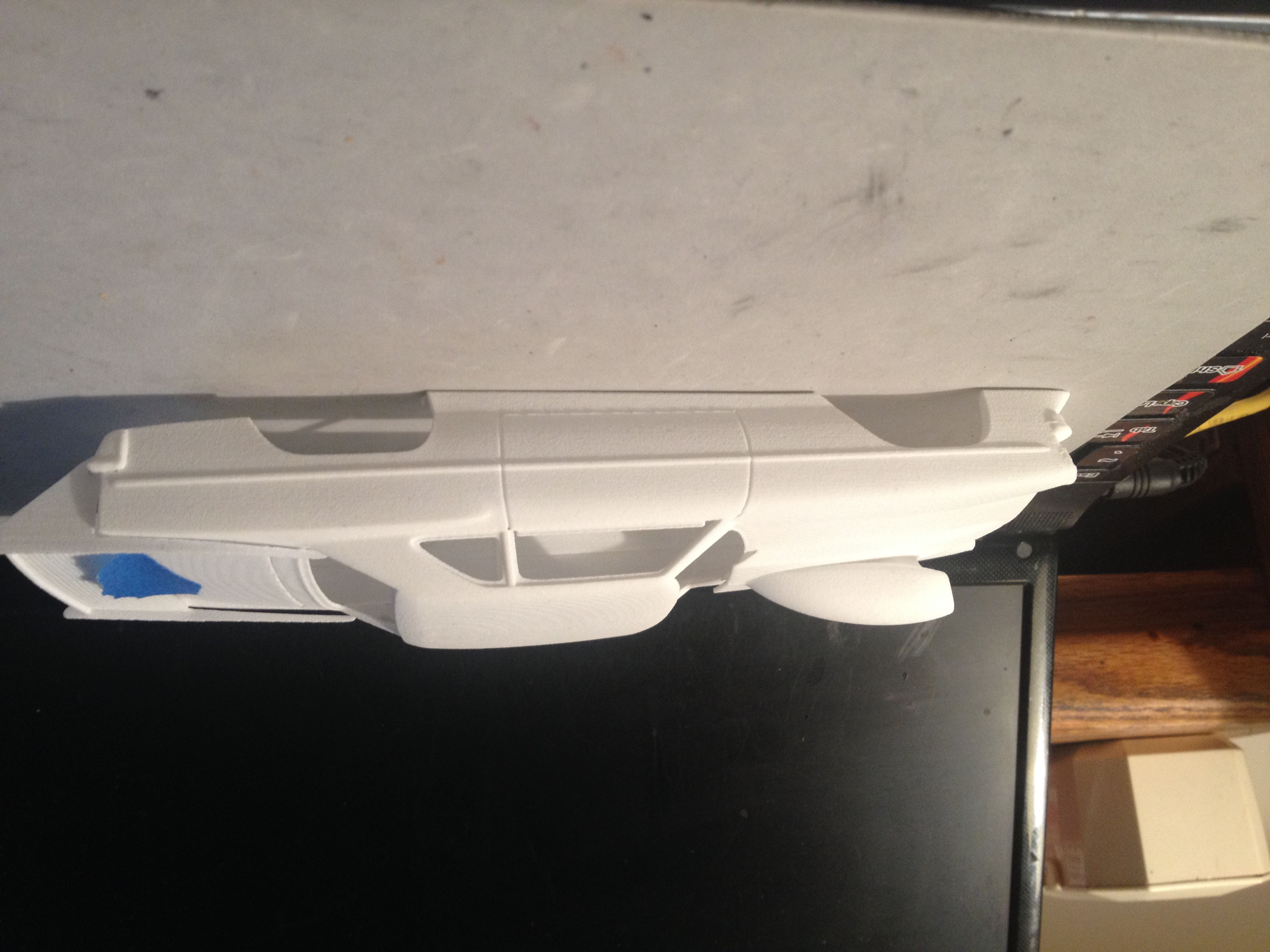

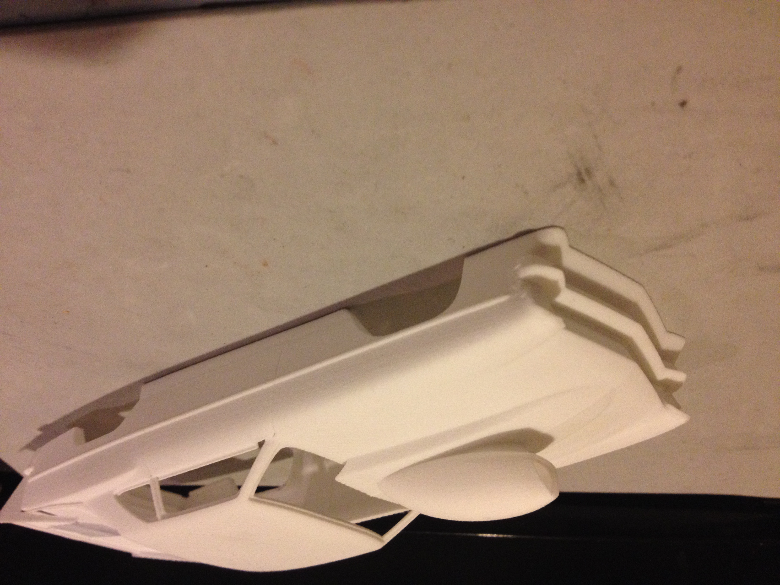

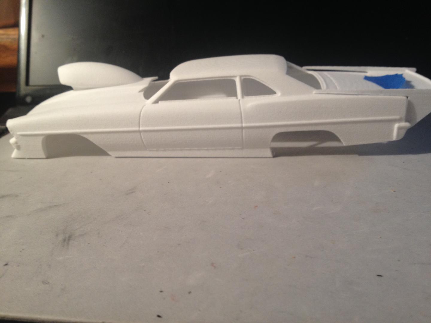

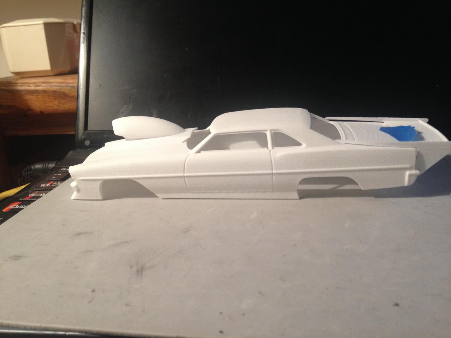

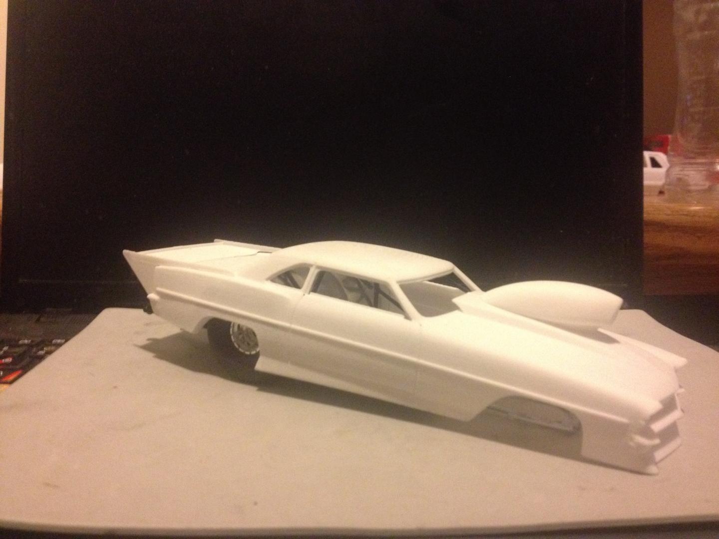

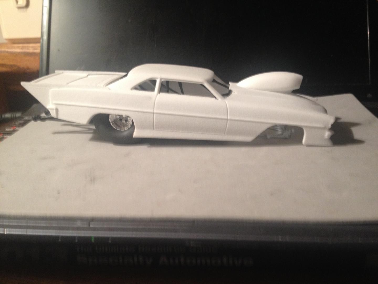

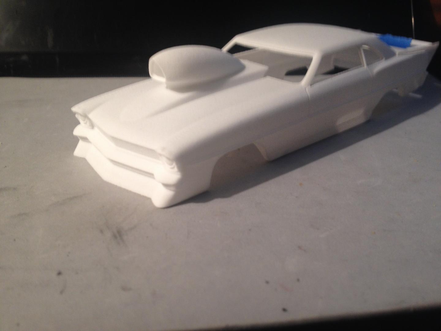

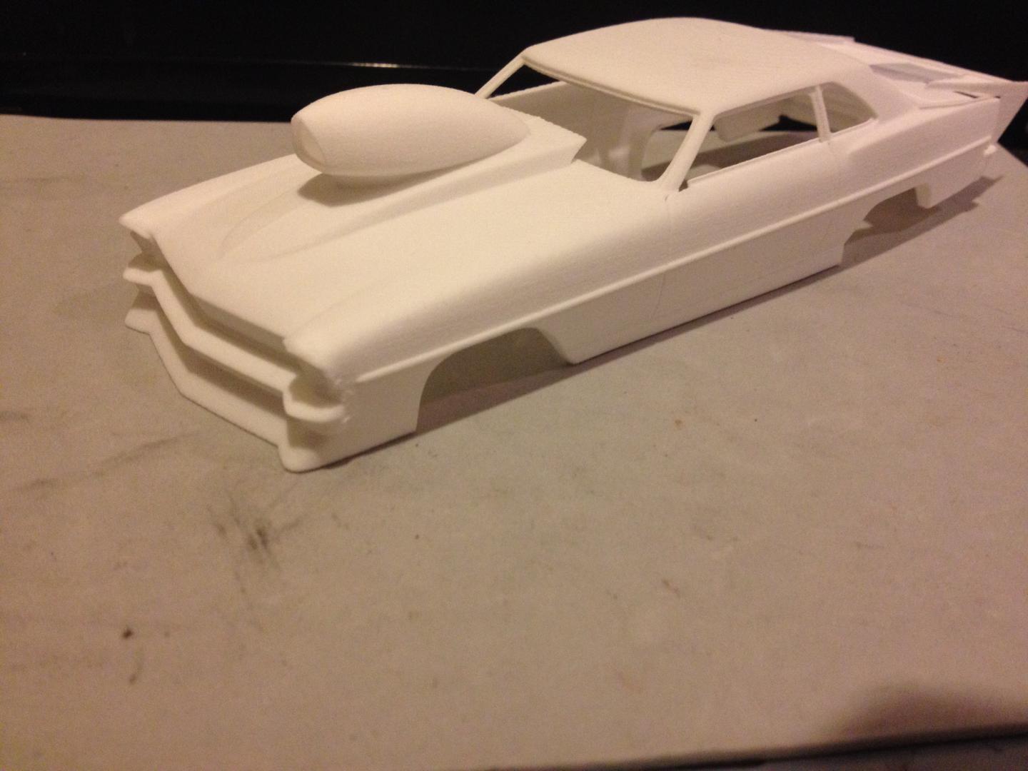

NYLIBUD Posted May 27, 2017 Author Posted May 27, 2017 Ok,so the Nova finally arrived in the mail.The body is pretty wild.However you were right Crowe,the material,and texture of the car are very weird,to say the least.It has circular lines through out the body.It certainly doesn't feel or look like resin.There is definitely going have to be a lot of sanding and filling..
Mooneyzs Posted May 27, 2017 Posted May 27, 2017 Ron... Awesome body, going to be a killer build. Now this body doesn't feel like Resin because the material is actually Nylon. They start out with Nylon Powder and sinter the powder layer by layer with a laser. You will want to clean the body by washing it in warm water with some dawn. and to seal you can you use some thin superglue or you can primer with some high build primer, sand and repeat. either way you are going to have to prep the body with sanding. The reason you are seeing the circle like pattern in the body is from the laser doing its thing to bond the material together. It also depends on the orientation of the part in the printer on how the layers are built up. Here are a few youtube videos that TDR Innovations have done to clean and seal some of their items that you may find helpful. Superglue seal only Finishing TDR Innovations' "Sand Cast" Material Step 1 https://www.youtube.com/watch?v=dzbyY4qllFI Finishing TDR Innovations' "Sand Cast" Material Step 2 https://www.youtube.com/watch?v=kAUiBUPNW9M Finishing TDR Innovations' "Sand Cast" Material Step 3 https://www.youtube.com/watch?v=hh94cEIGqqU
NYLIBUD Posted May 28, 2017 Author Posted May 28, 2017 Thanks Monneyzs...Yea the body is pretty wild.I read some info on line about how 3D printers actually work.And your right it's done in layers.What an invention,they can make anything with these incredible machines..Anyway,thanks for all the tips.Yea,this car is going to have a ton of sanding,and filler primer..I just hope I don't screw it up.
crowe-t Posted May 28, 2017 Posted May 28, 2017 (edited) Ron, The body looks real cool! Get a can of Filler primer and shoot a few heavy coats on and start sanding with 320 or 400 grit paper. You will have to repeat this over a few times. I talked with some guys on the TDR facebook page and they said using superglue is harder and details will get lost. A high build filler primer is easier to use. You actually don't need to clean the White Strong & Flexible(nylon). Tim who runs TDR said you only have to clean the Frosted Ultra Detail material. Don't bother sanding it until you apply the primer. The nylon doesn't take well to sanding. Edited May 28, 2017 by crowe-t
Mooneyzs Posted May 28, 2017 Posted May 28, 2017 You are Welcome Ron... Yeah it is totally crazy what all can be printed. I have been pushing the limits with a few things I have been drawing up just to see what I can and can't have printed. I would do as Michael mentioned and probably just primer and sand, then repeat as needed I know that the super glue is hard as a rock and sucks sanding, Plus you don't want to loose any details. Take your time and not rush anything, I am sure you will do an awesome job on it.

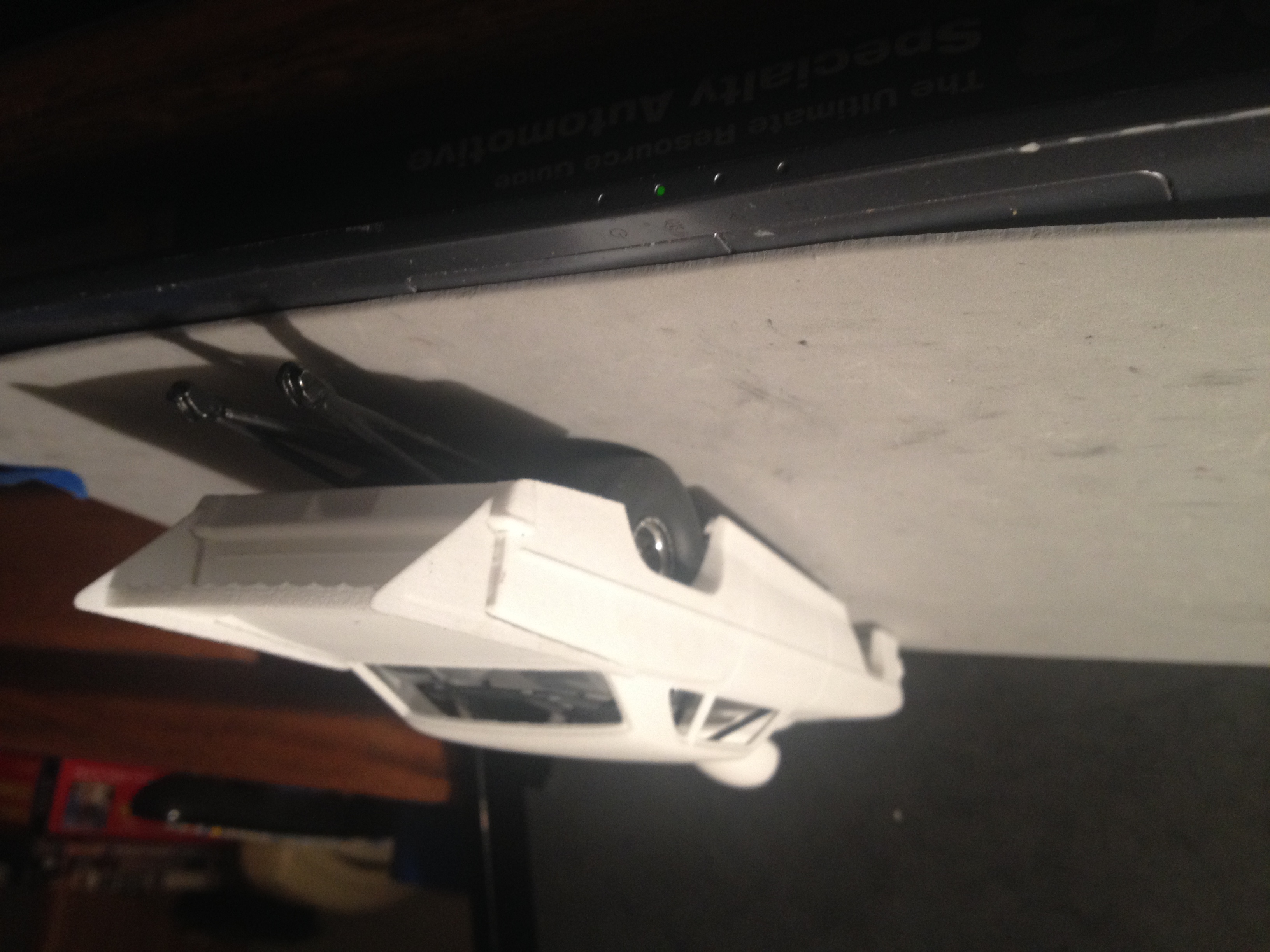

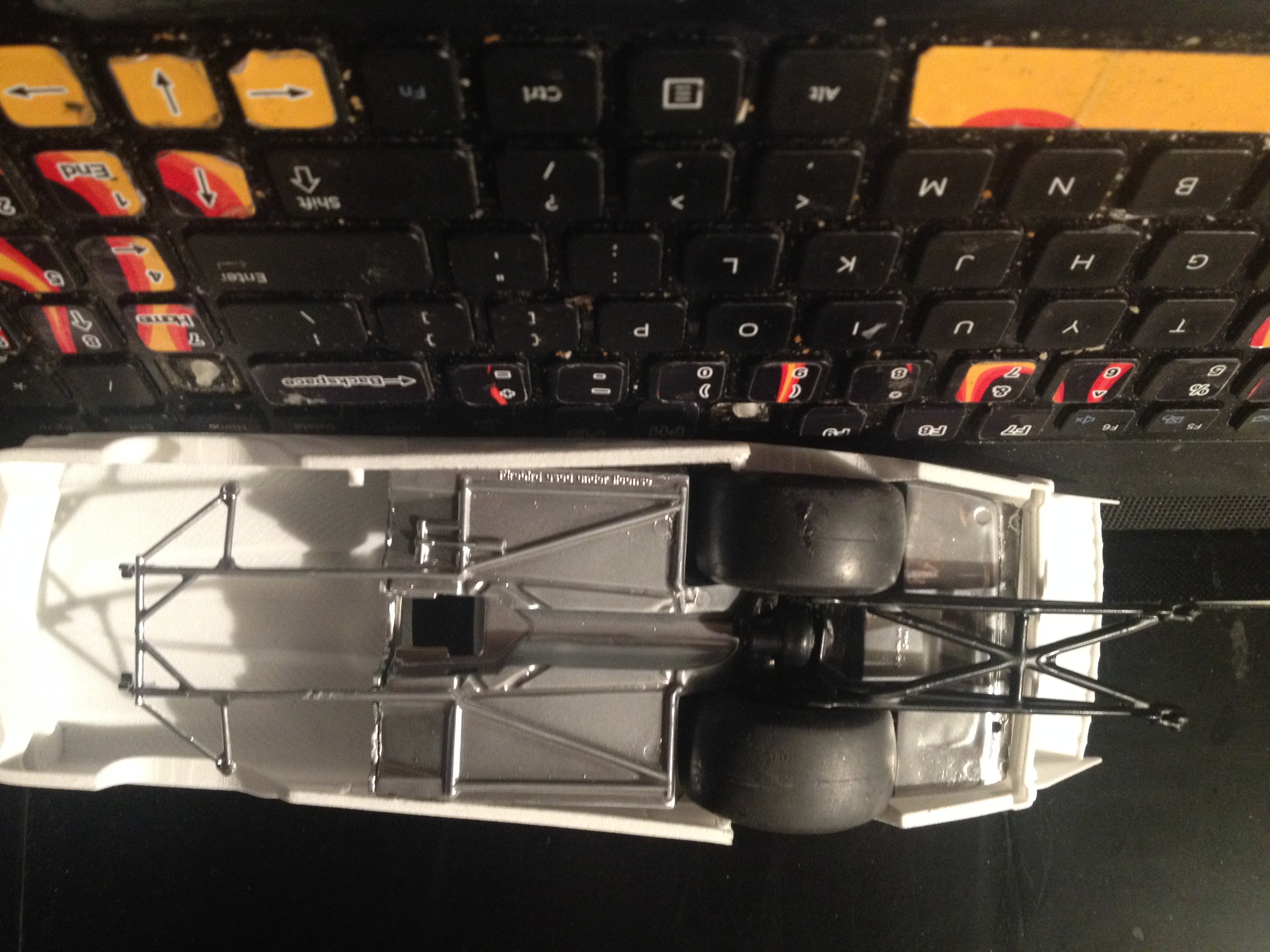

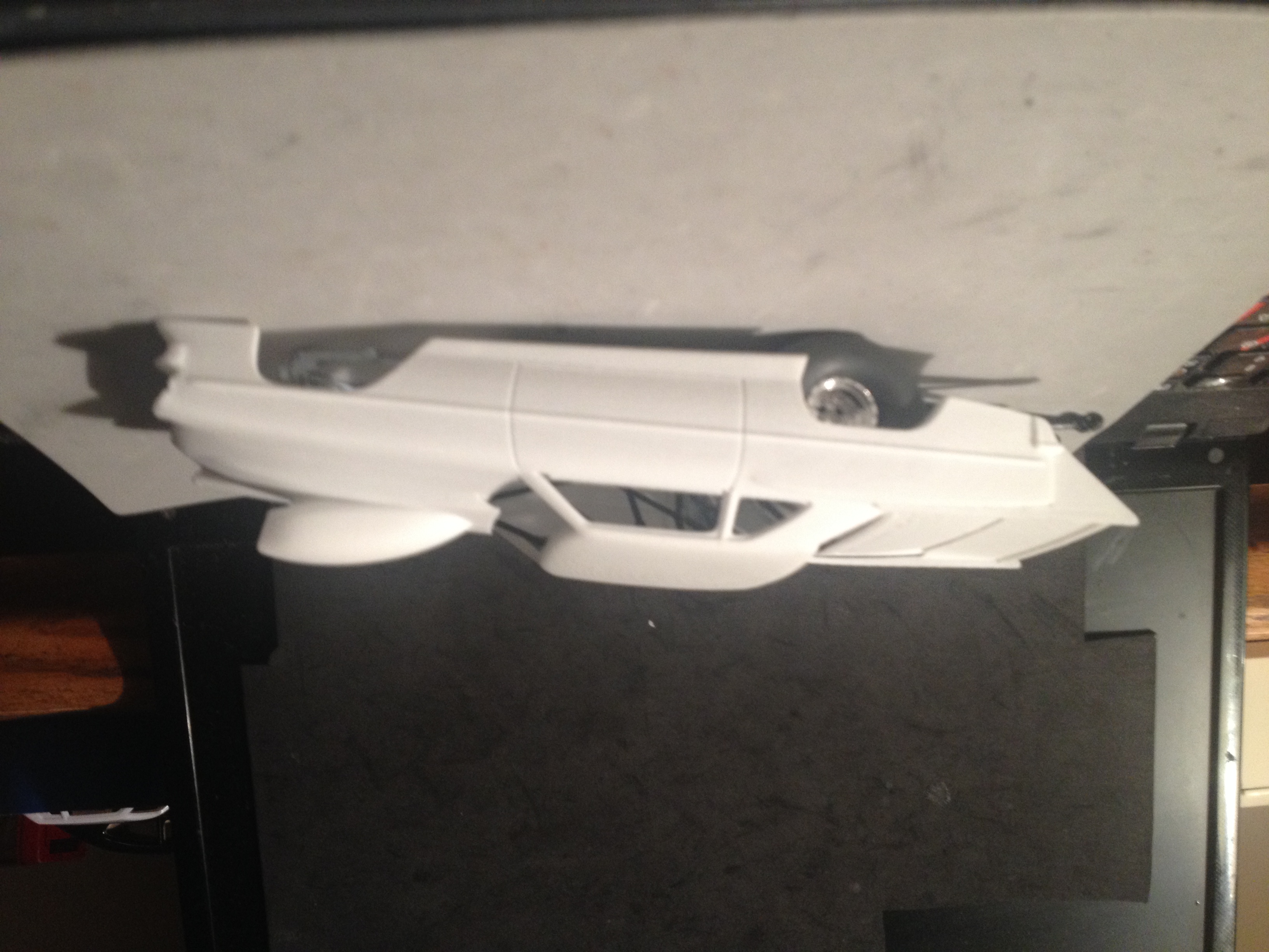

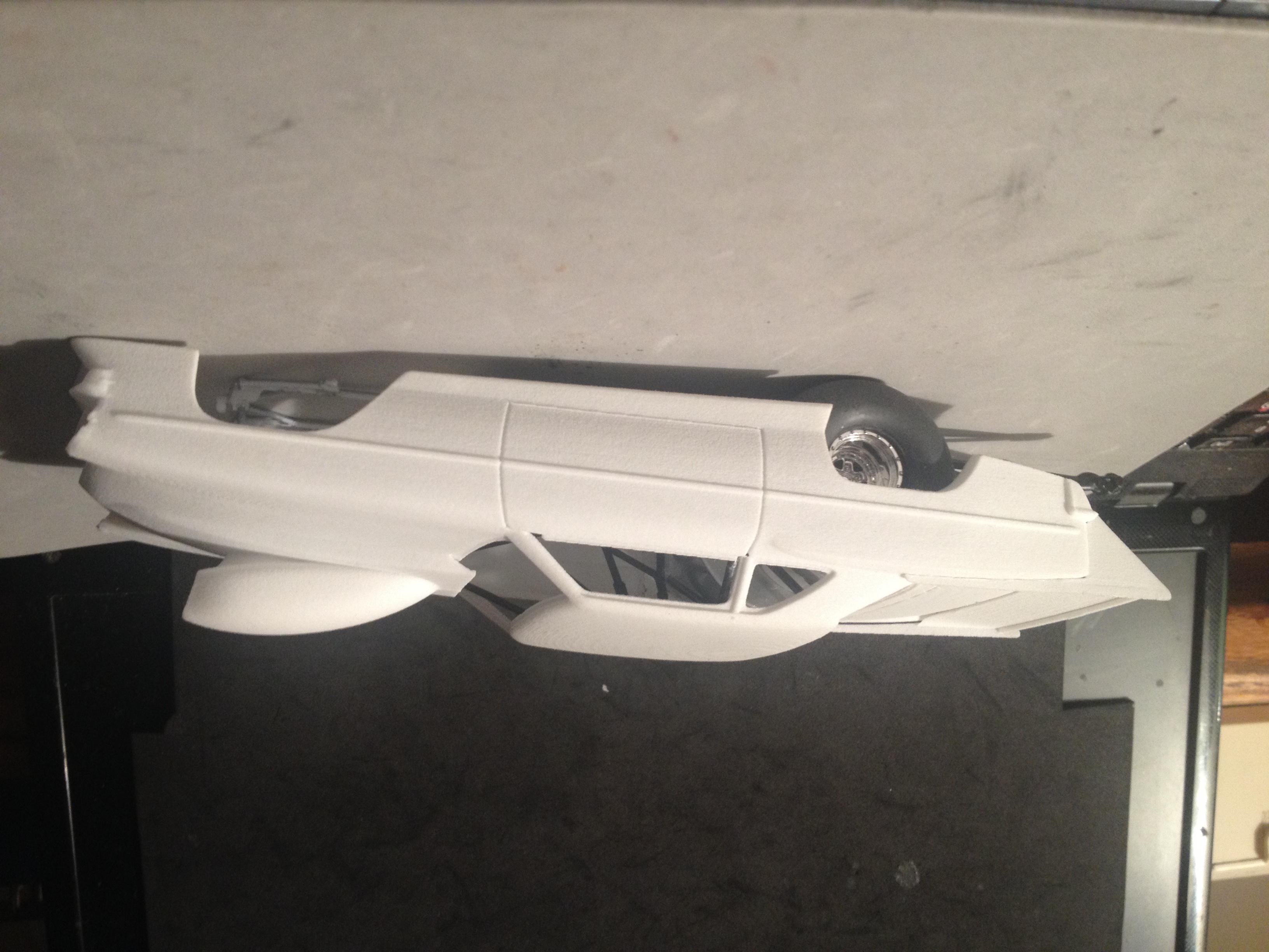

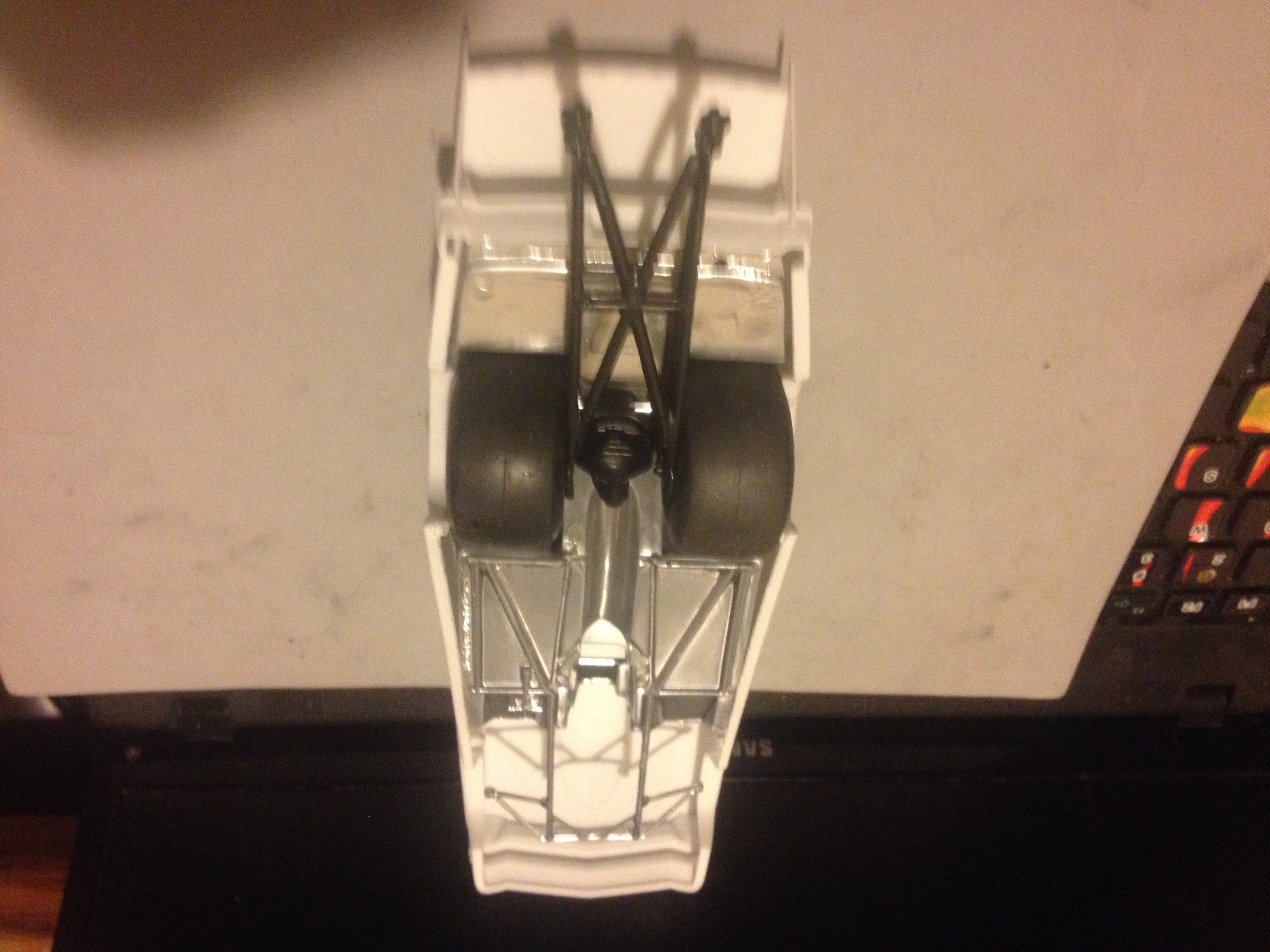

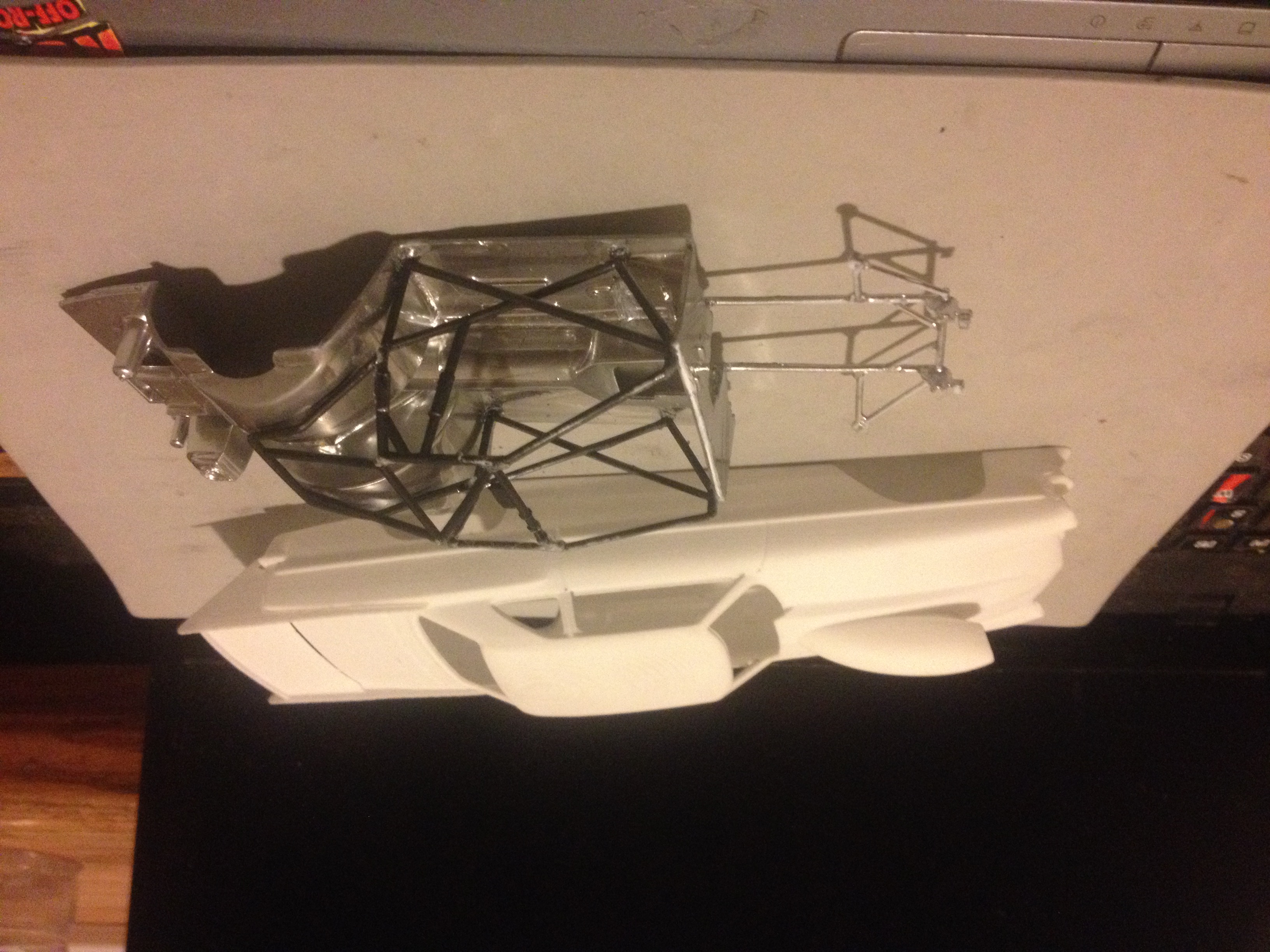

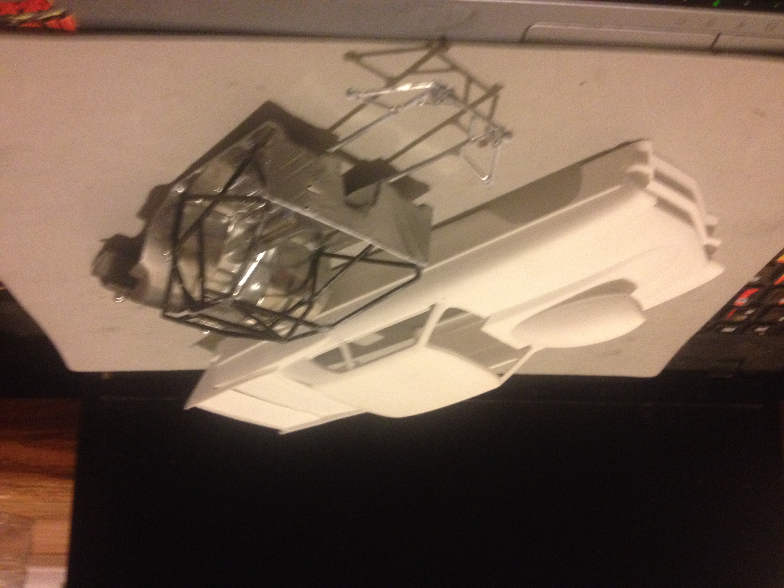

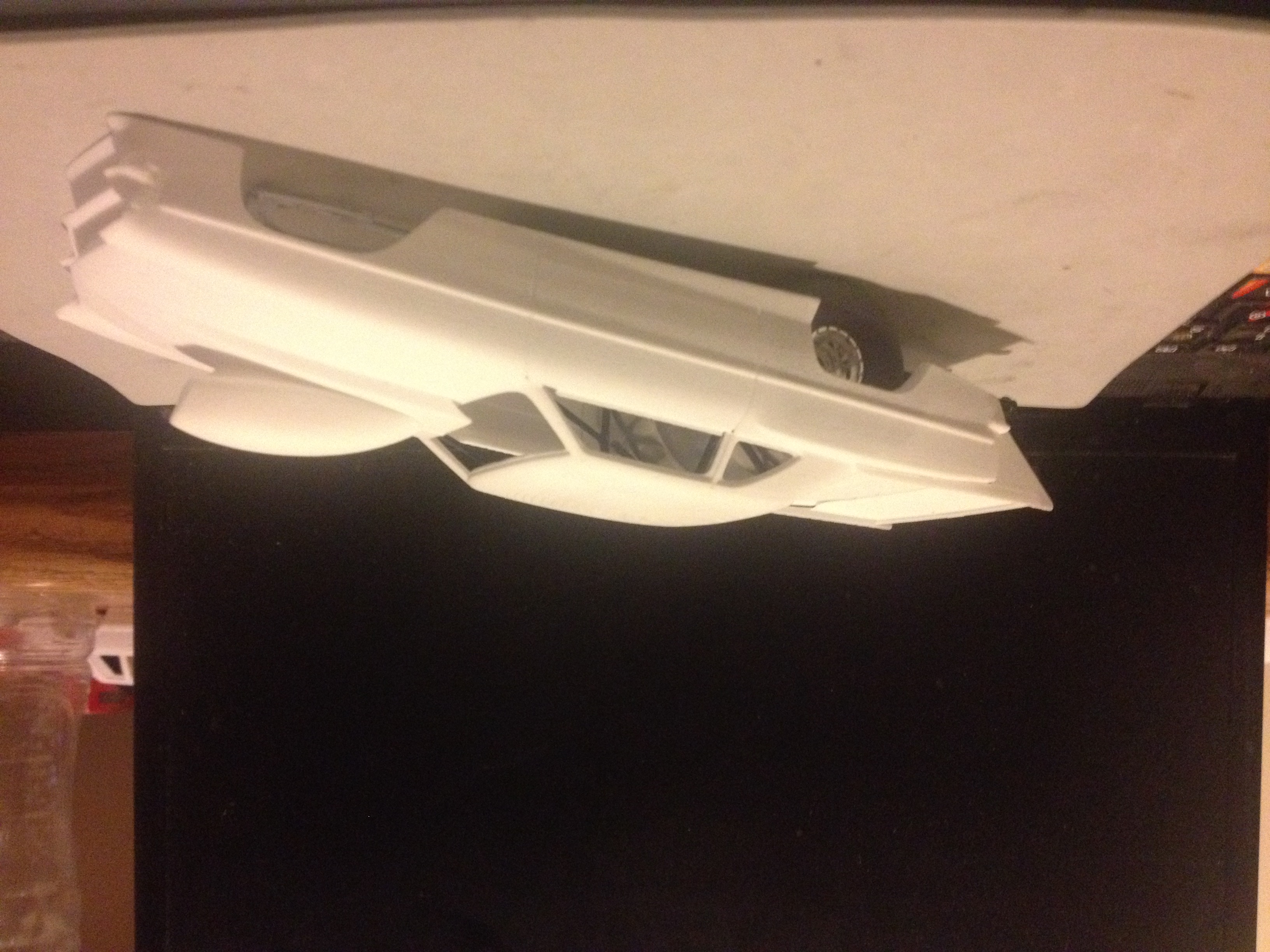

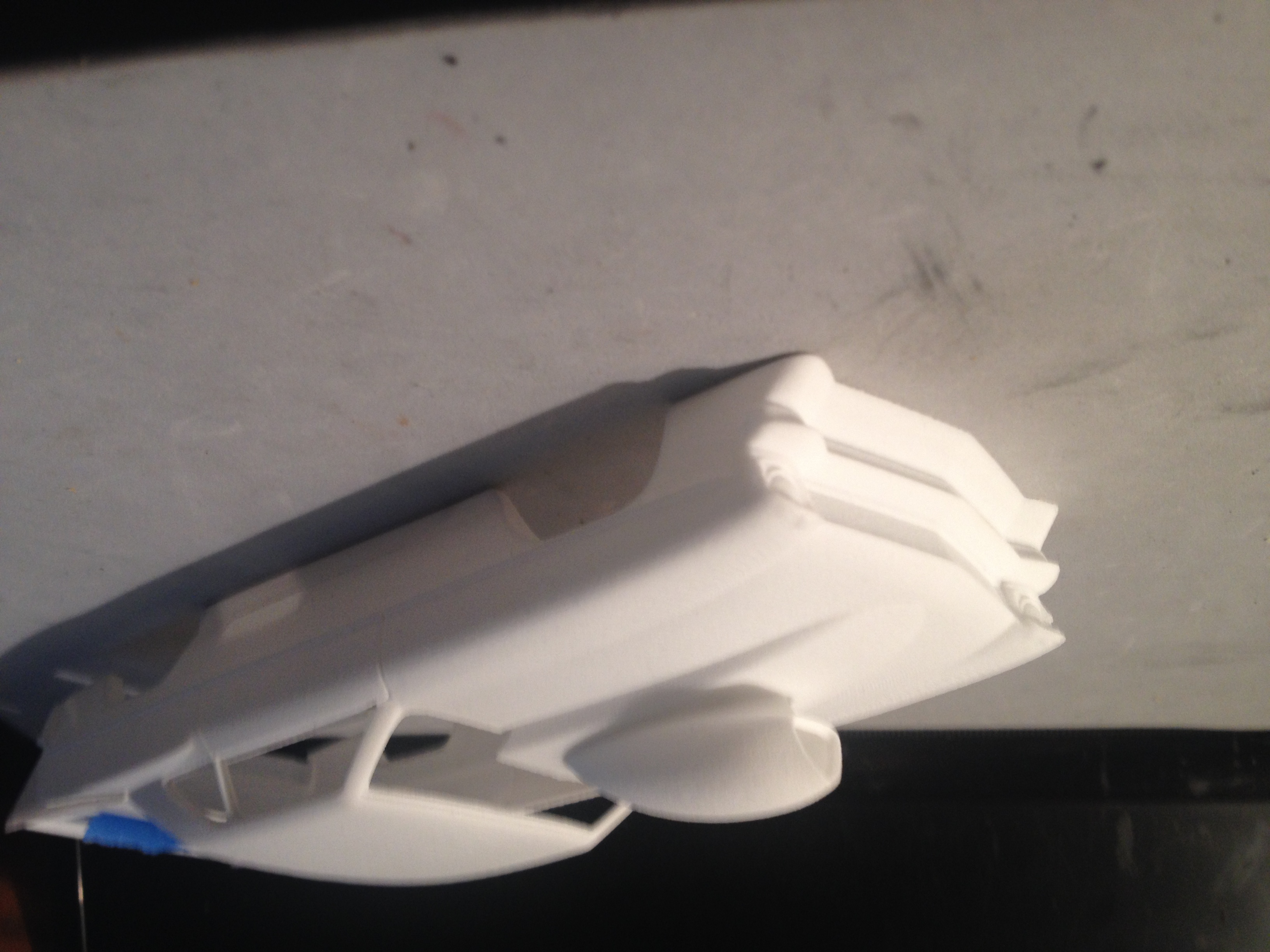

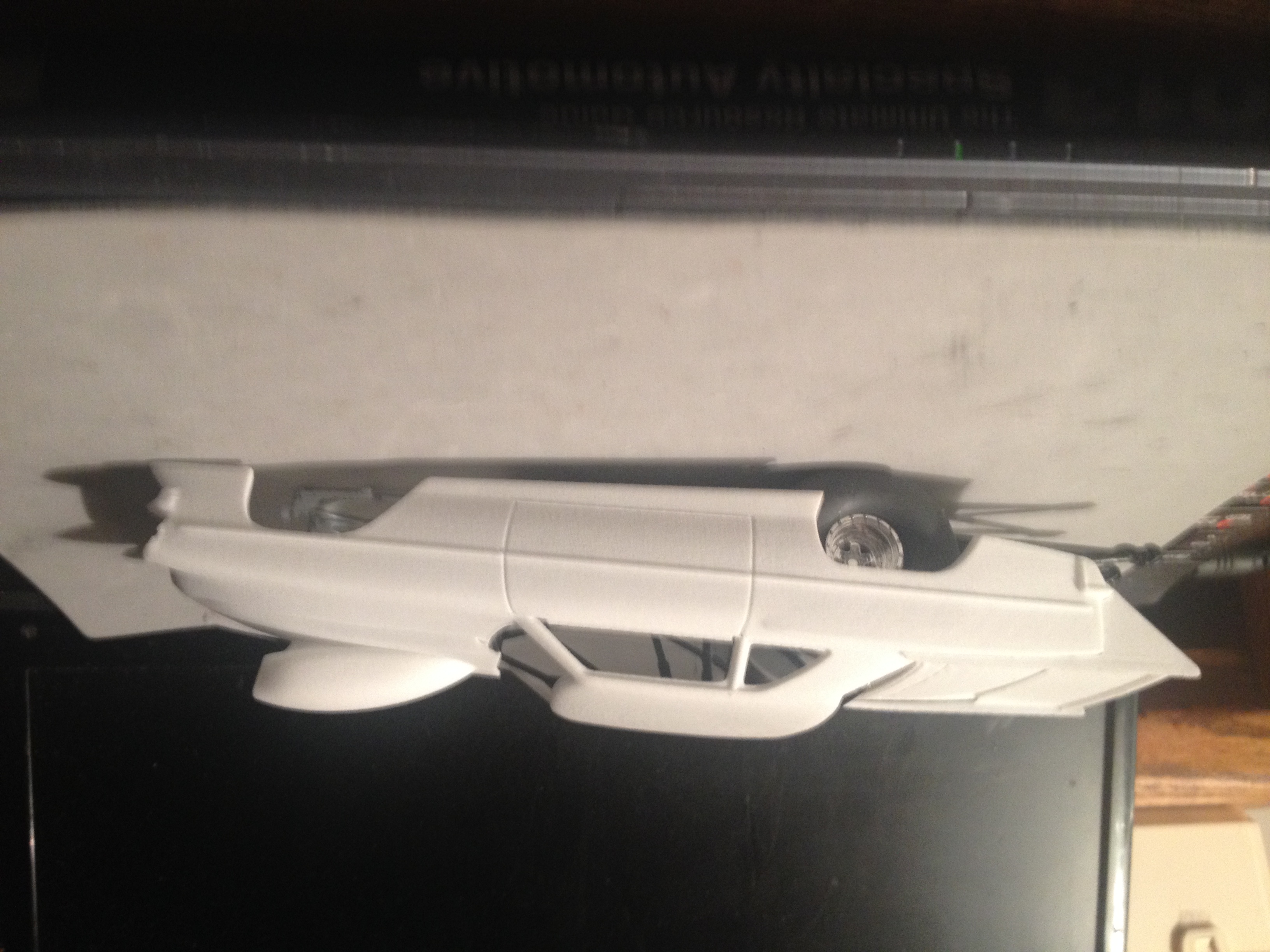

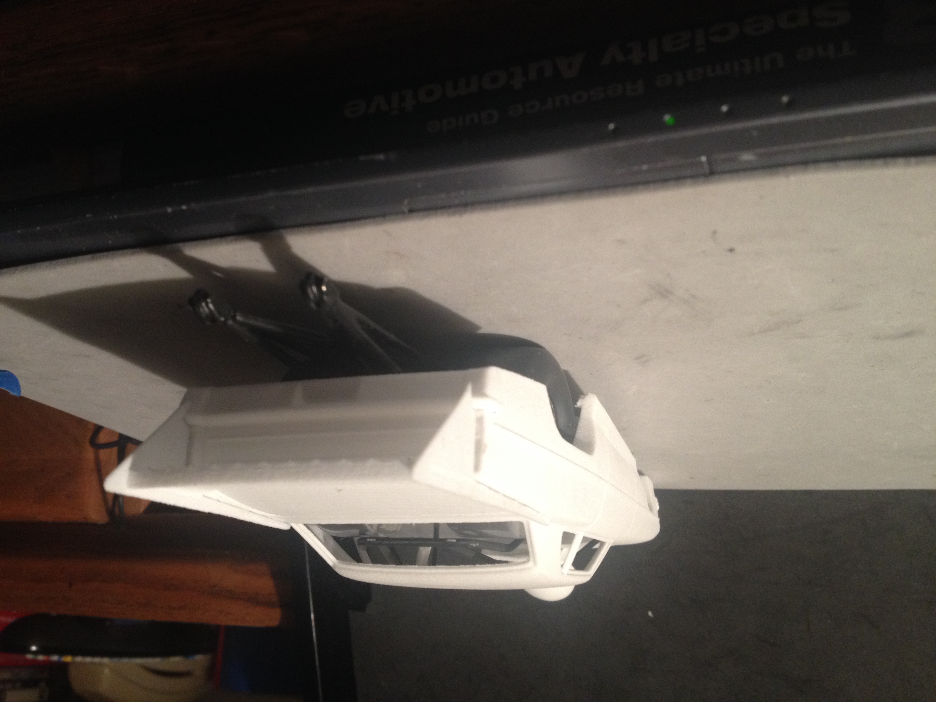

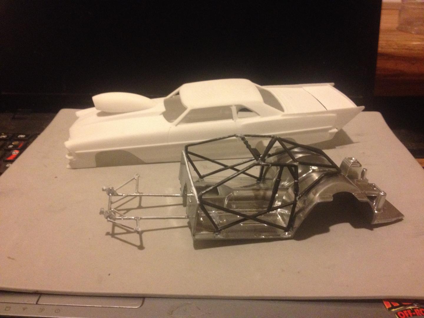

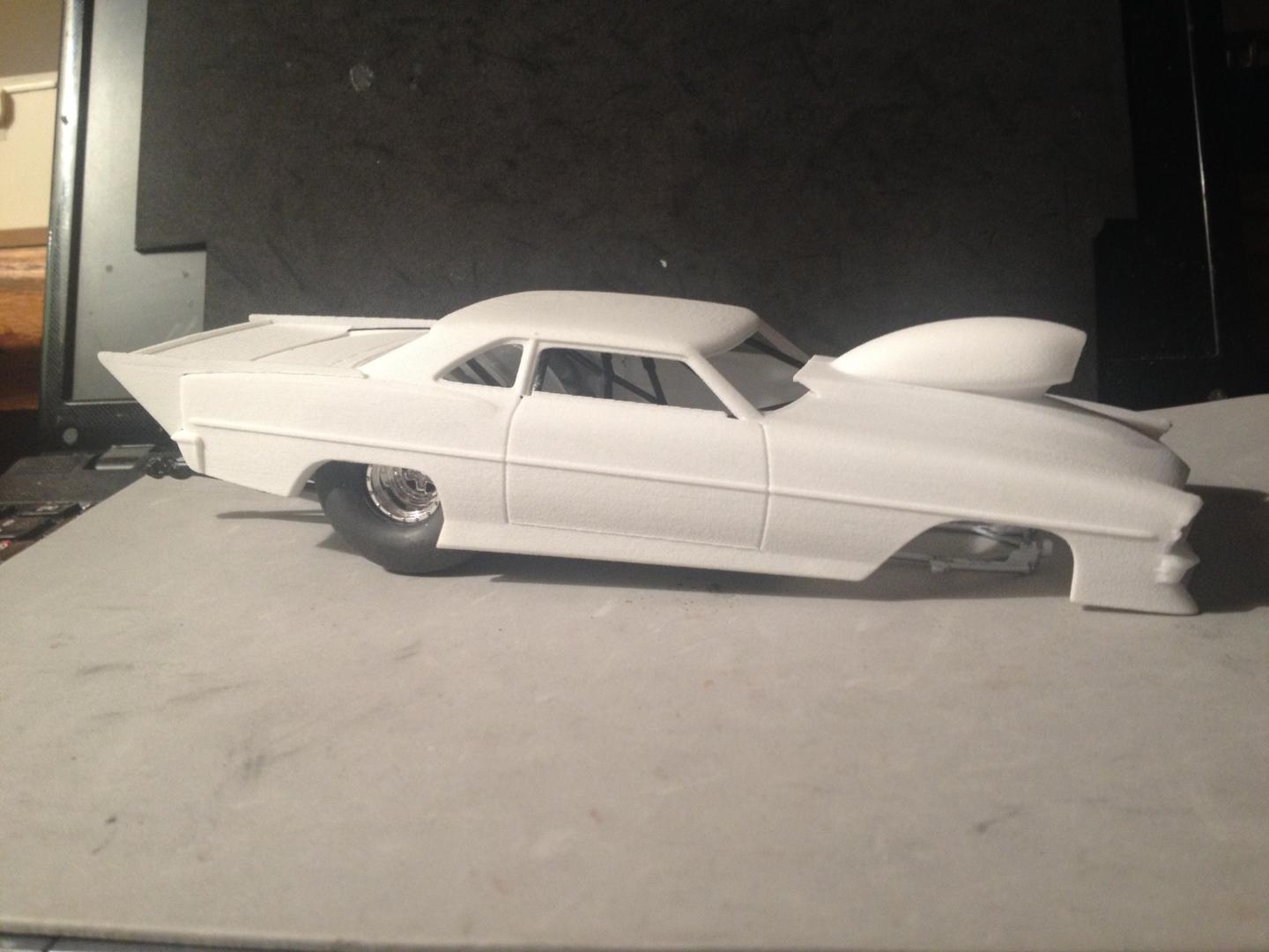

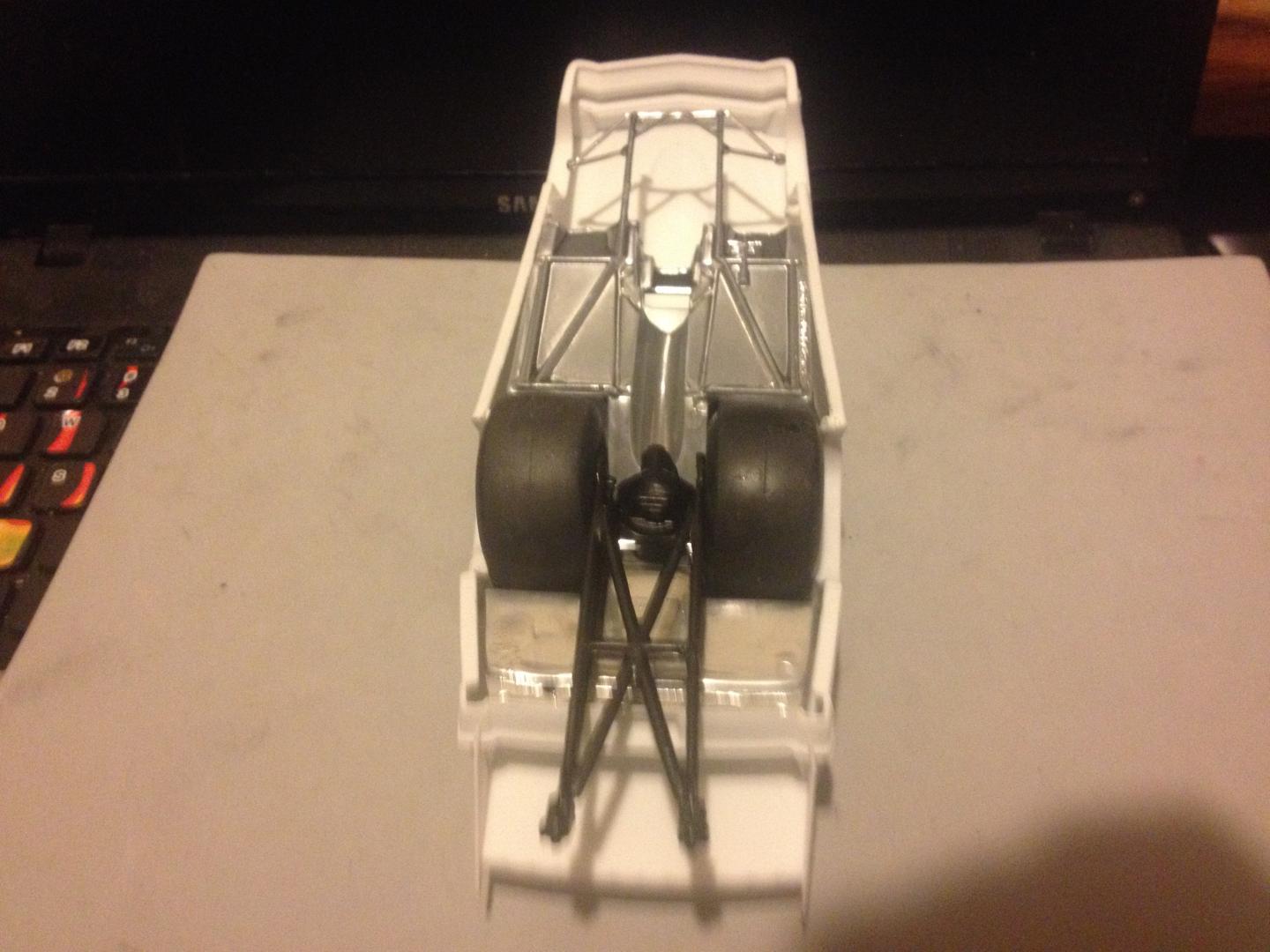

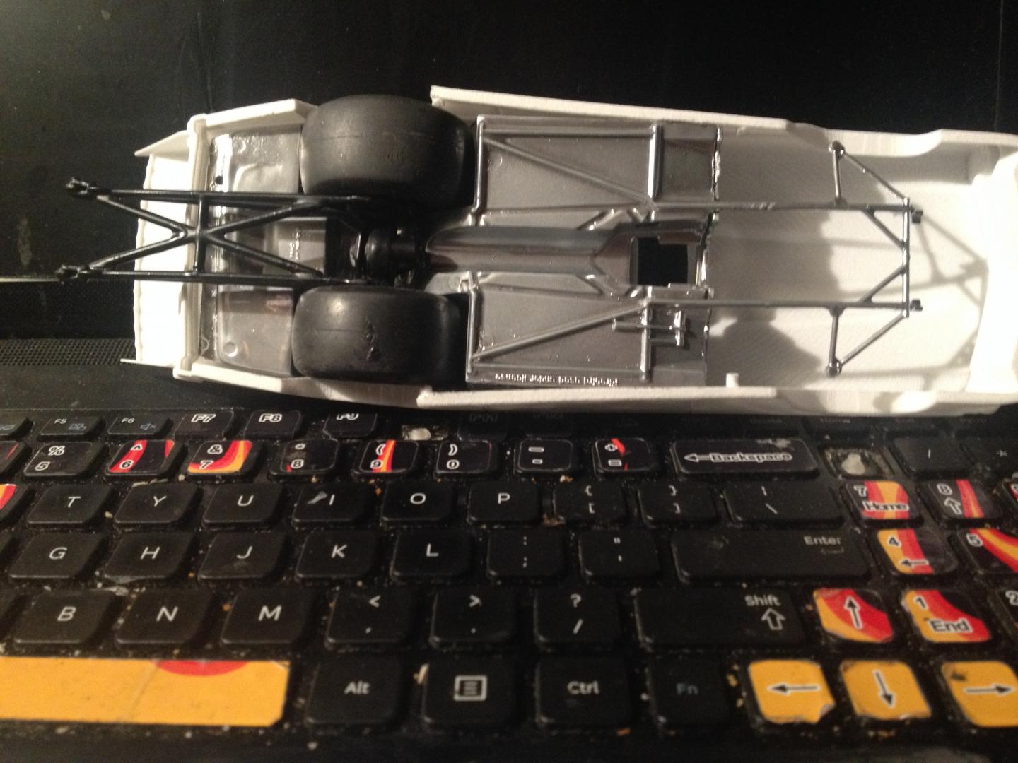

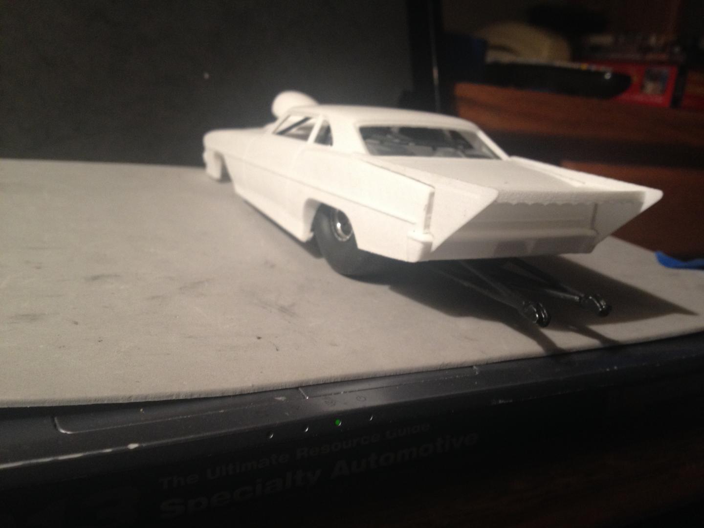

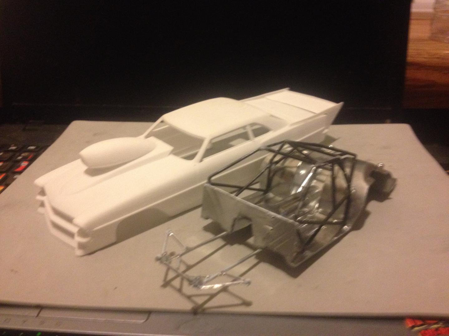

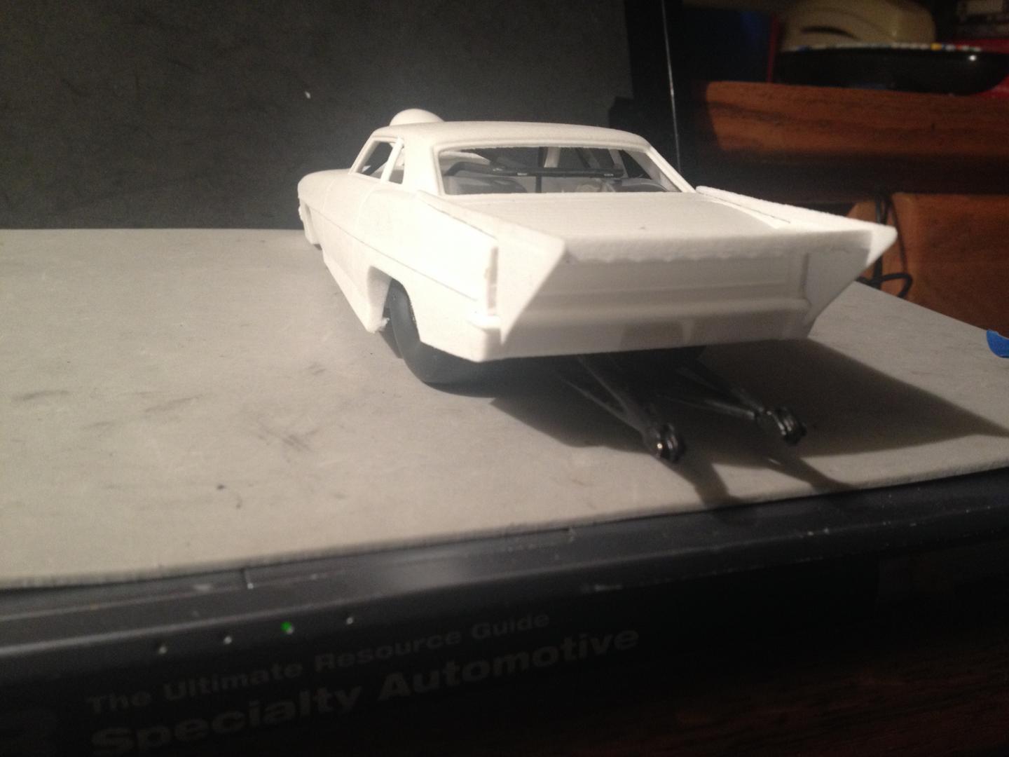

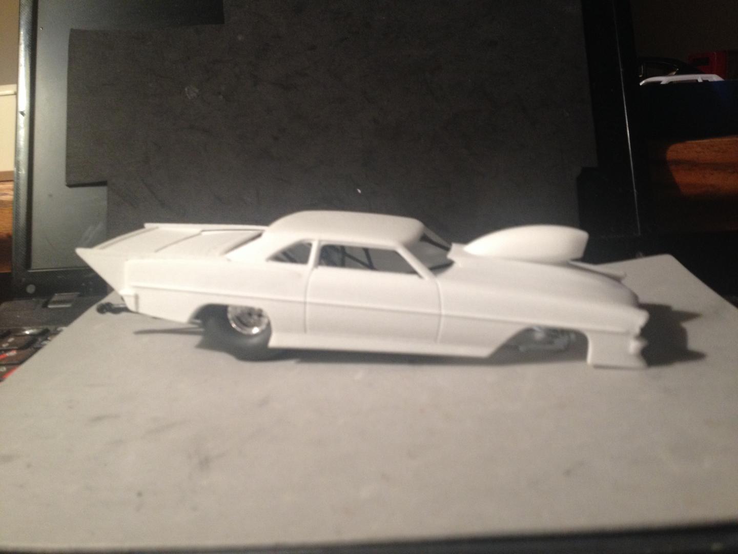

NYLIBUD Posted June 19, 2017 Author Posted June 19, 2017 Trying to fit a chassis/cage into the body.I still haven't even prepared the body with the filler primer,and sanding.I did attach the wing,And hopefully the chassis I use fits well.
NYLIBUD Posted June 21, 2017 Author Posted June 21, 2017 Well,I found a great chassi/cage to possibly be used for the car,and it fits like a glove.So now I don't have to scratch build a chassi.It should make the car easier to build
