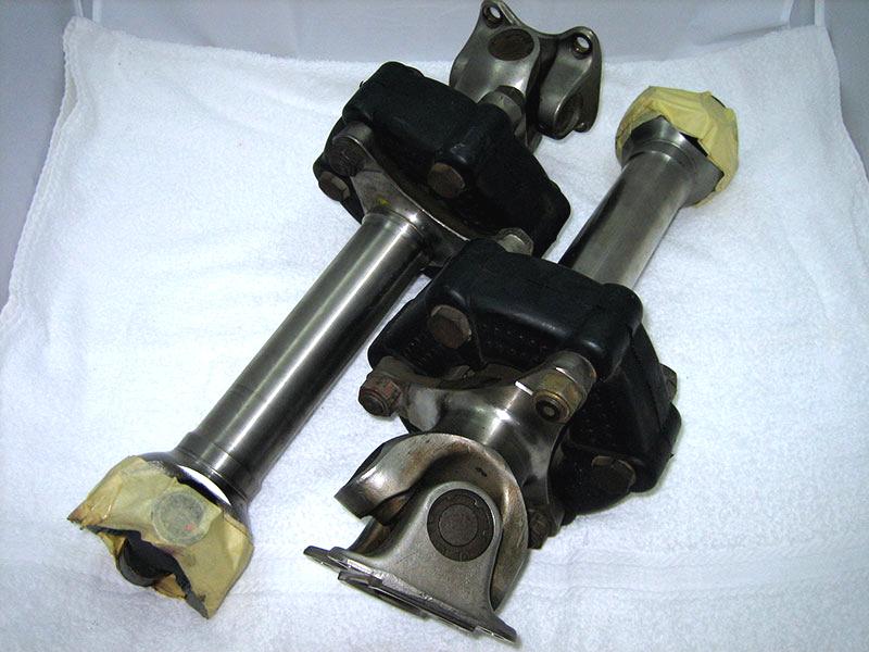

$75000.00 of titanium 935 halfshafts.

Cal, Last piece of raw Titanium I saw the price on was $900.00 (back in mid 2000 mind you) for a 7 inch diameter, maybe 4 or 5 inch tall chunk of round bar. What you are looking at are real deal 70's factory Porsche Works half shafts. That along with the price of Ti makes it the price they are. And the price of raw unmachined Titanium is highly volatile depending on current markets for military and/or medical. (mostly military drives the prices up or down depending on demand.) The 934 was a little bit different from the 935 but some of the photoetch would or should work on the 934 and I know a few people at least have done just that.
