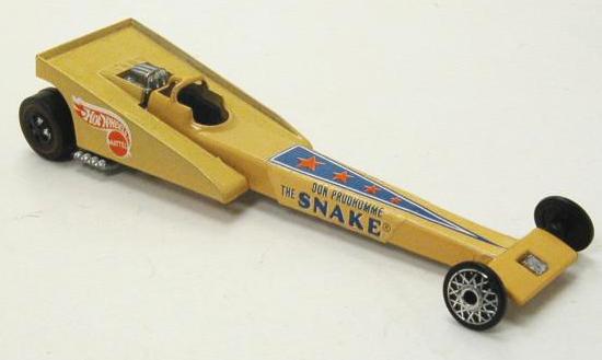

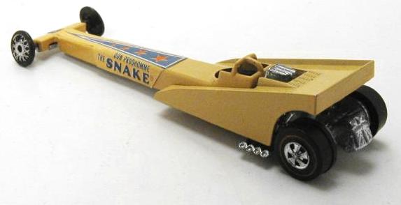

I agree with accepting some inaccuracies. I accept that. The frame is off, AMT reused the old Ivo frame. Its far from accurate for a Buttera frame. I'm okay with that, but by golly.....they tooled up an all new body. Get the body near right! Built from the box, I doubt the driver could see out of it. The blower would also hid below the deck work.
I'm okay modifying a kit.....I can't remember reading directions.....but please get something near right. They designed a new body......why, oh why couldn't they got it closer? I swear they used the Hot Wheels die cast as a model.
