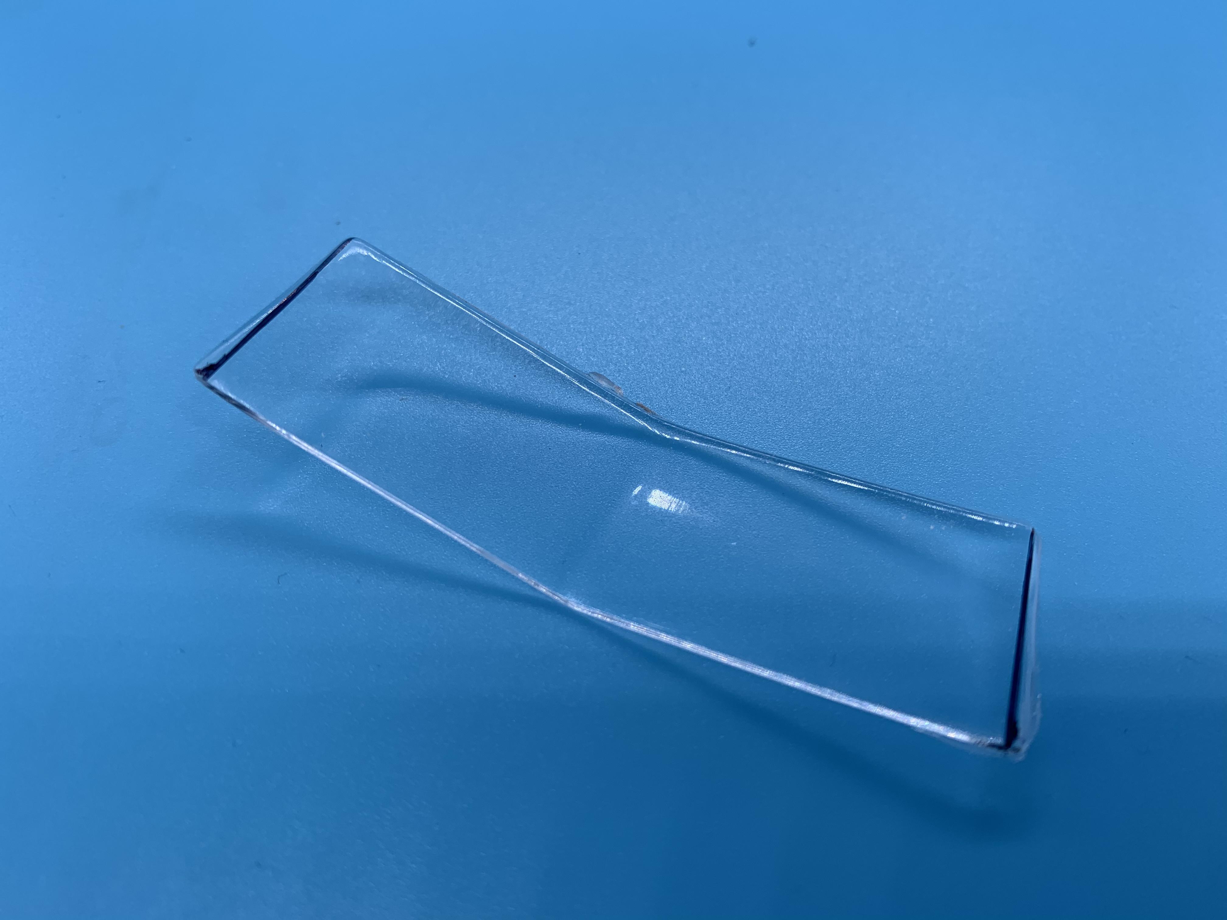

A little progress today, but nothing too substantial either...turned out I didn’t need to do much sanding to make the kit glass fit - just had to run up to the Sharpie lines marked here:
Fits in ALMOST as a snap fit - oughta fit real nice with a coat of paint on there!
I’m still not totally sold on the idea of using the thick kit glass over just replacing it with acetate sheet..definitely needs some polishing either way.

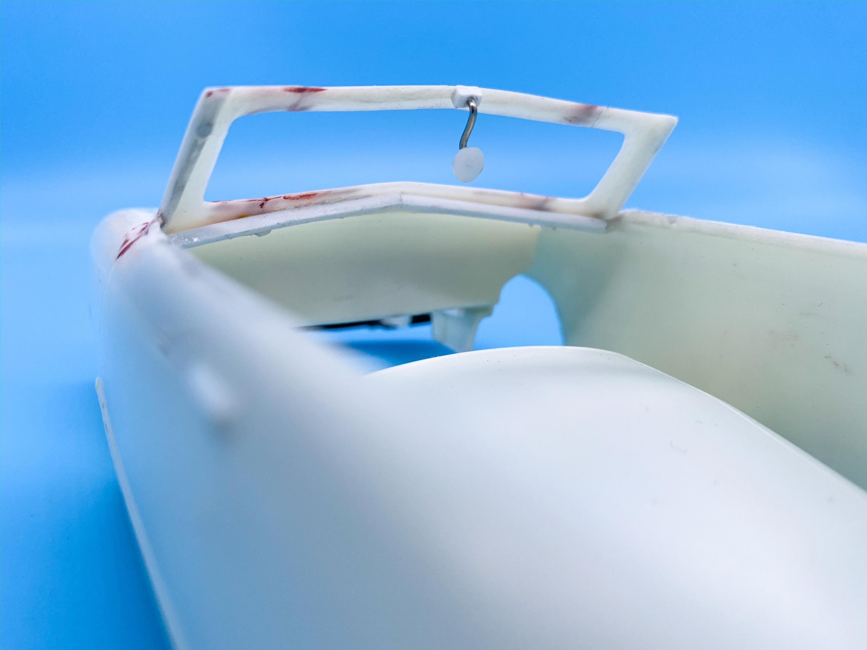

Scratchbuilt an interior mirror from a half-spherical bead from the scrapbooking section in Michael’s...

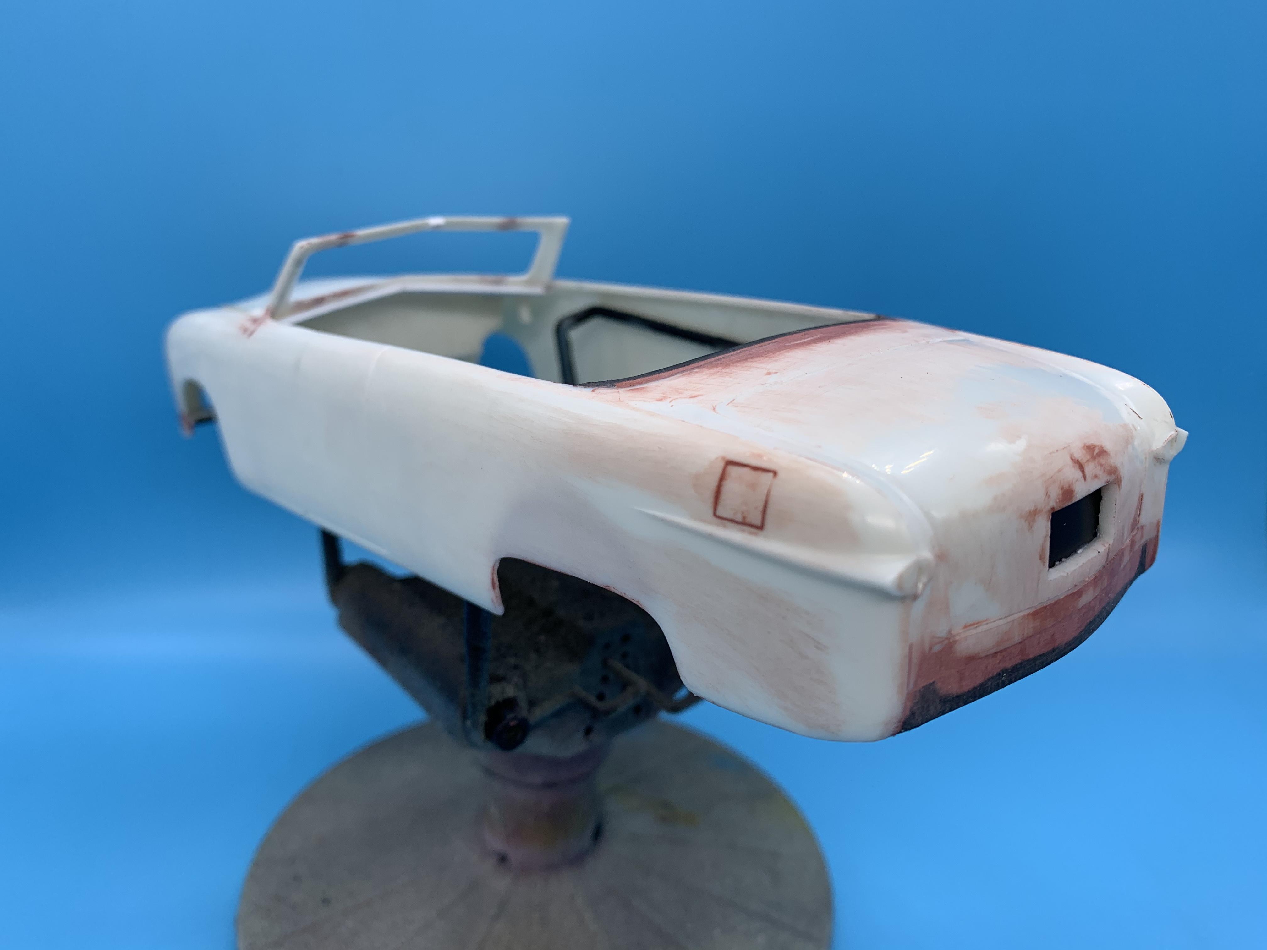

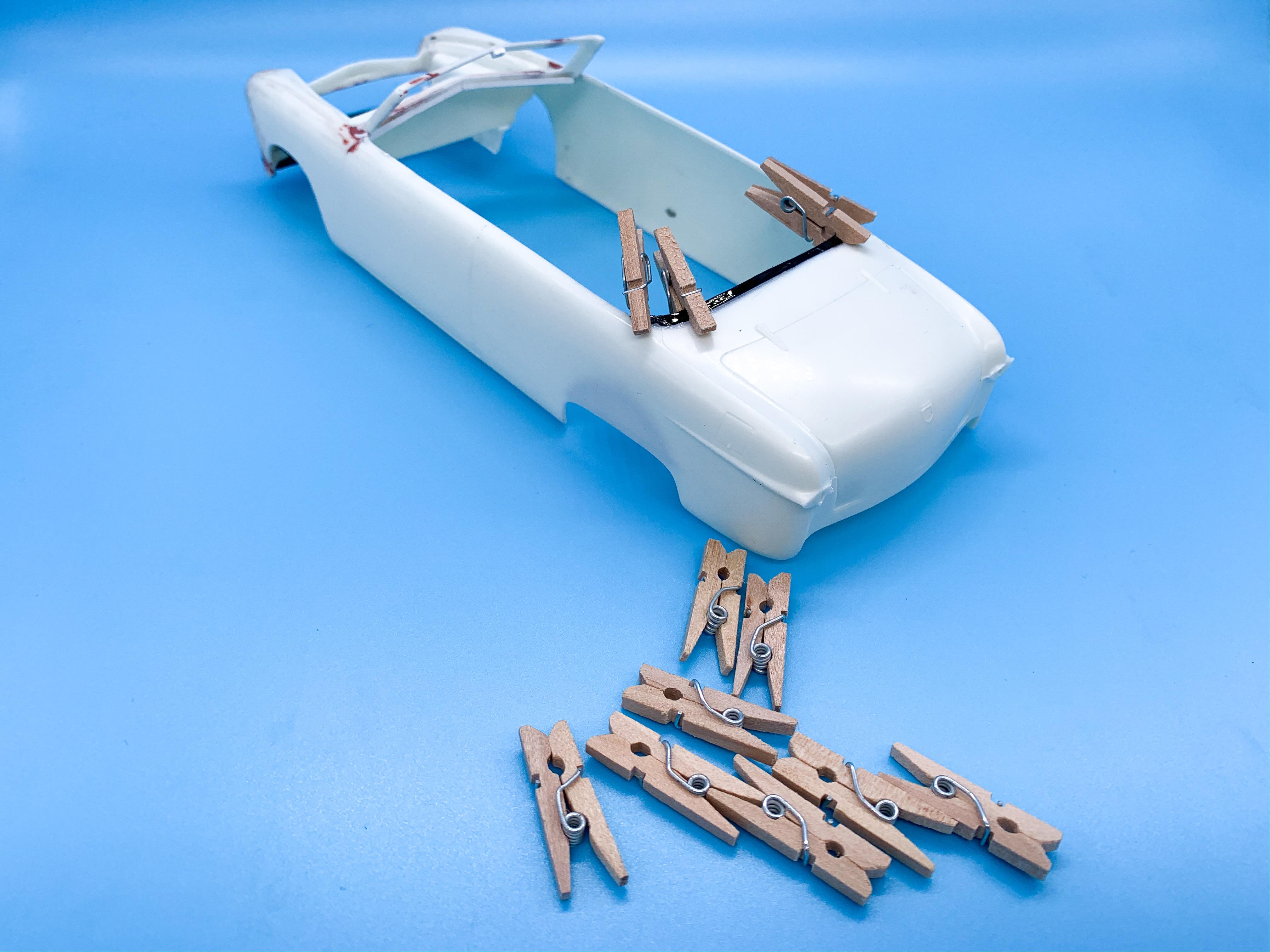

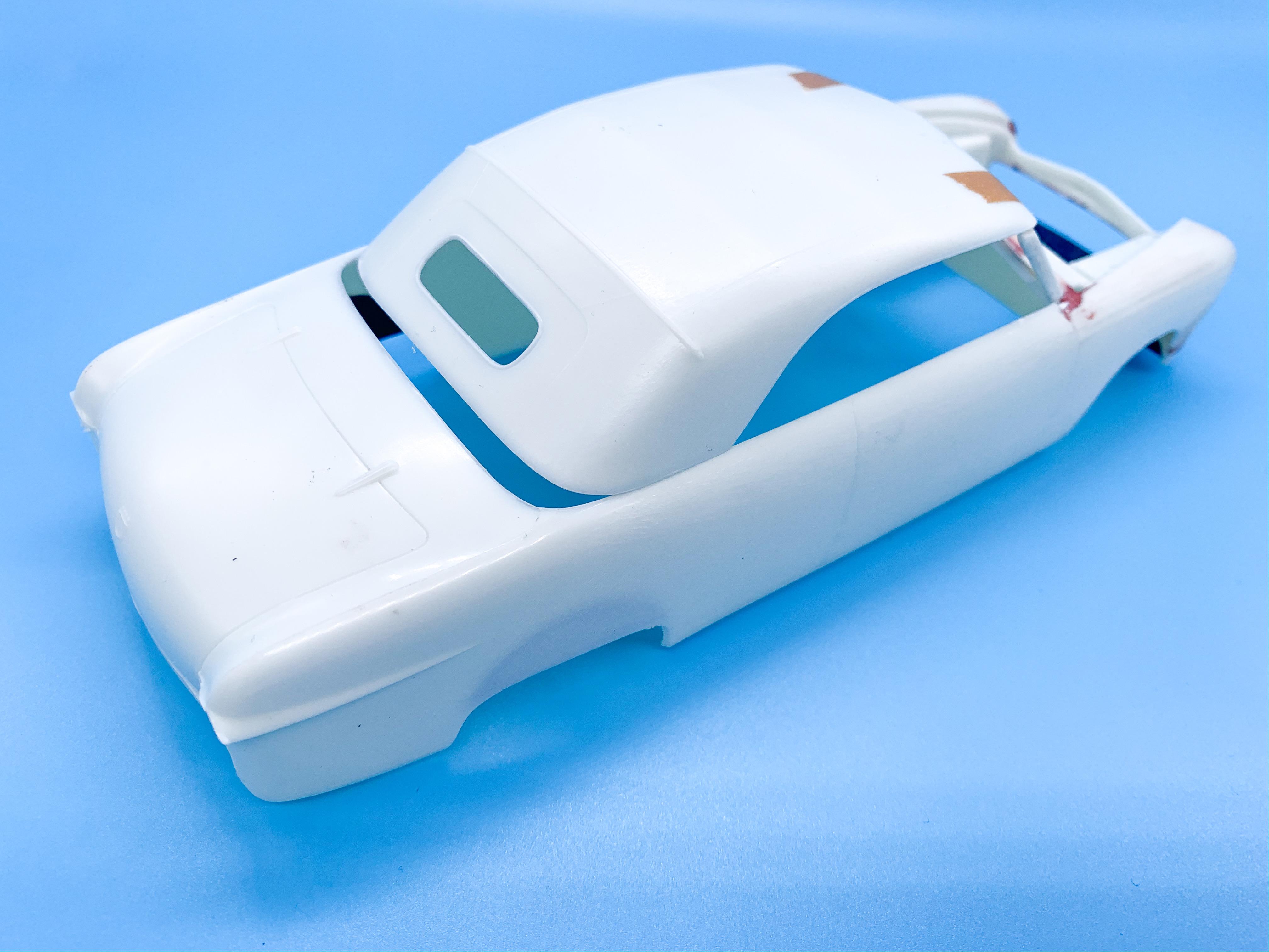

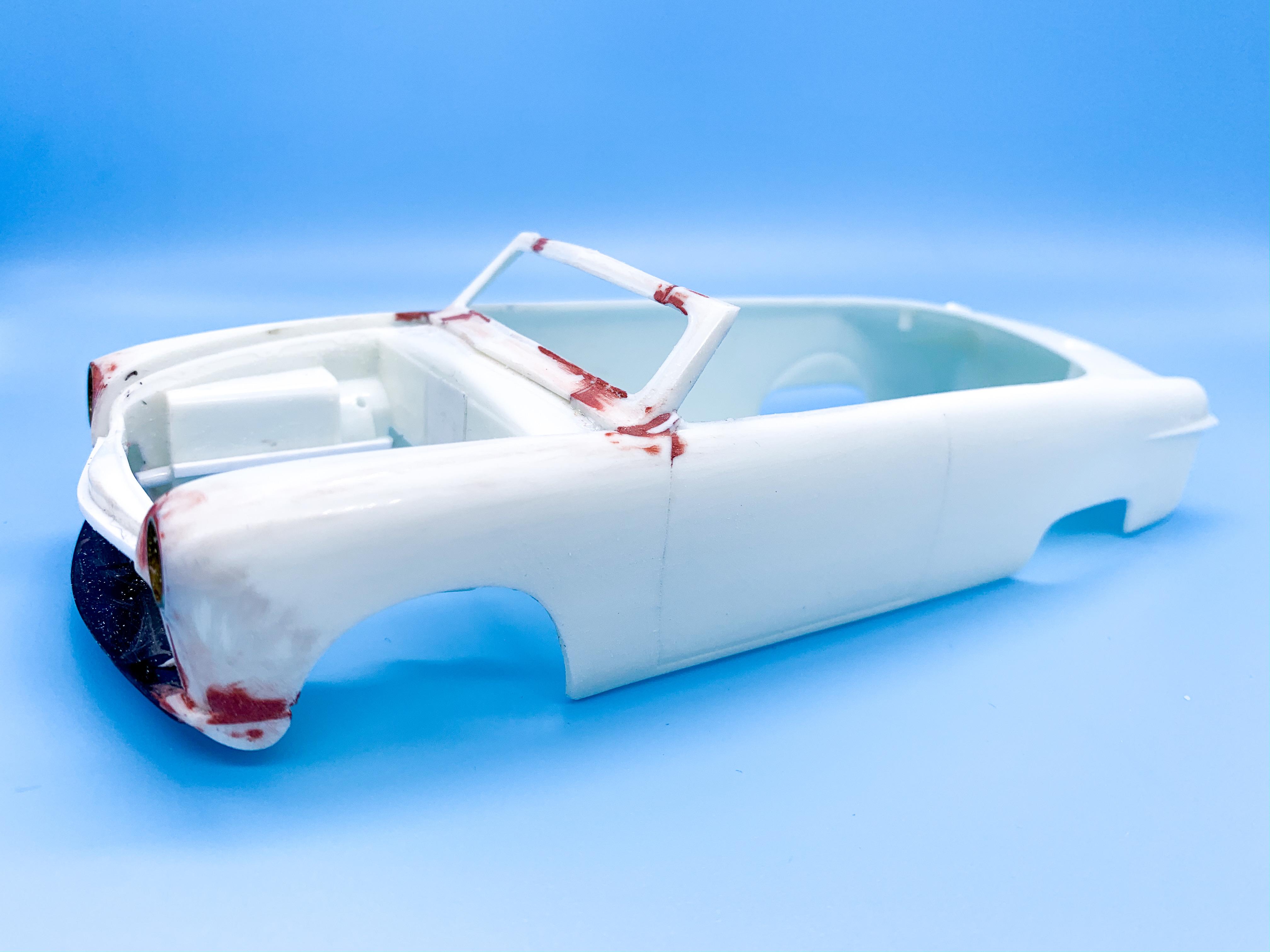

Just a couple of little bits today...had to fill this gap between the roof and the body, which I hadn’t been looking forward to handling:
I taped the roof in place and laid some tape inside the body and marked the gap out so I could make an insert piece:

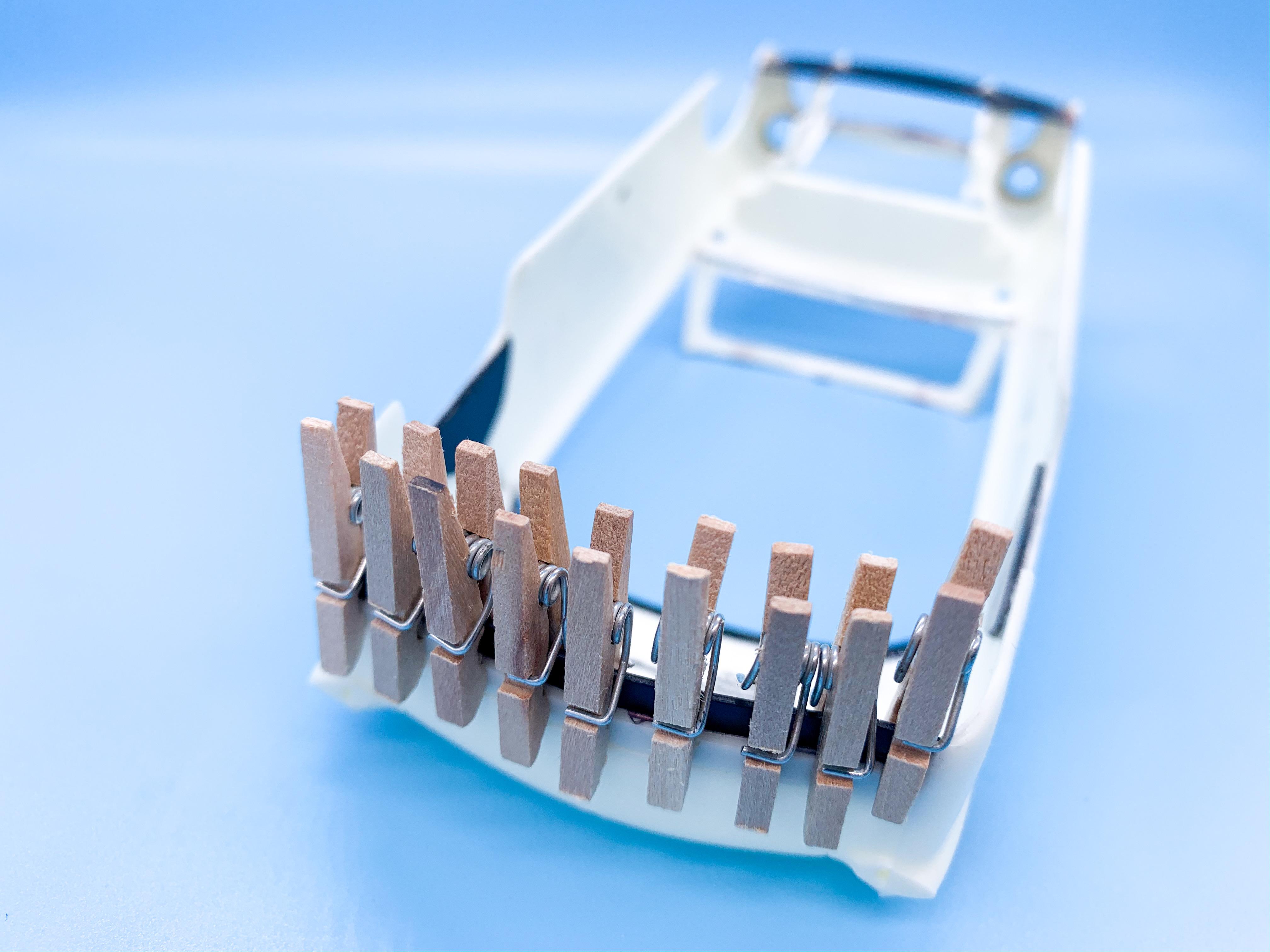

those little dollar store clothes pins are super useful for clamping stuff like this to dry!  I need to make a little piece to sit underneath this new ‘slither’ that I’ve made just to make sure it’s secure and won’t crack or move further down the line when paint’s on there and I’m polishing it.

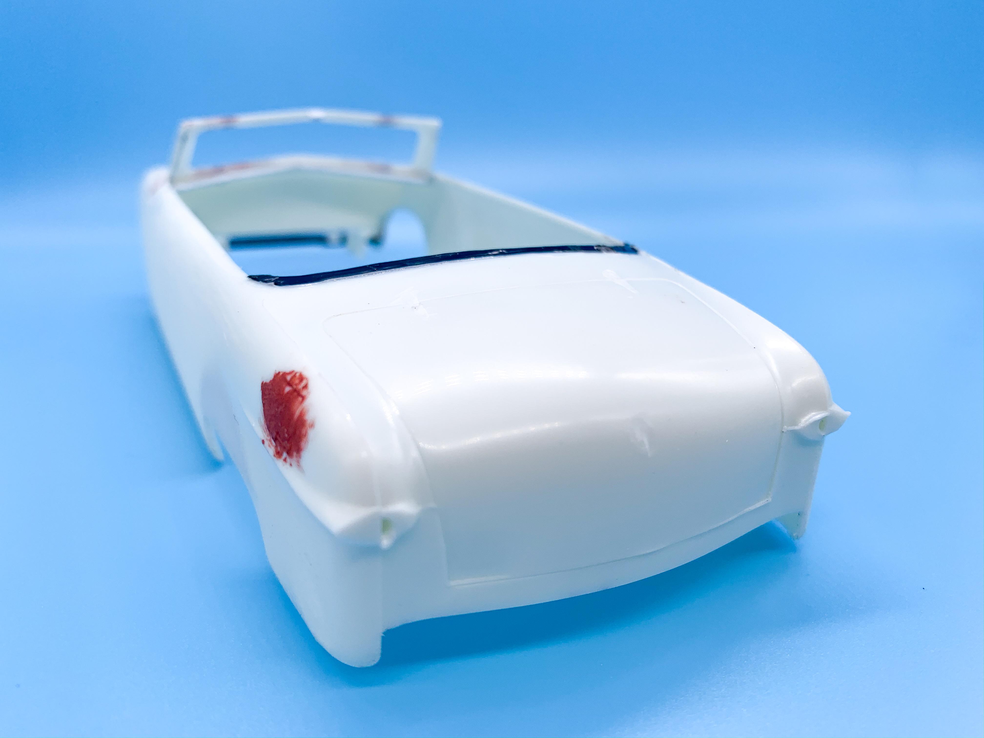

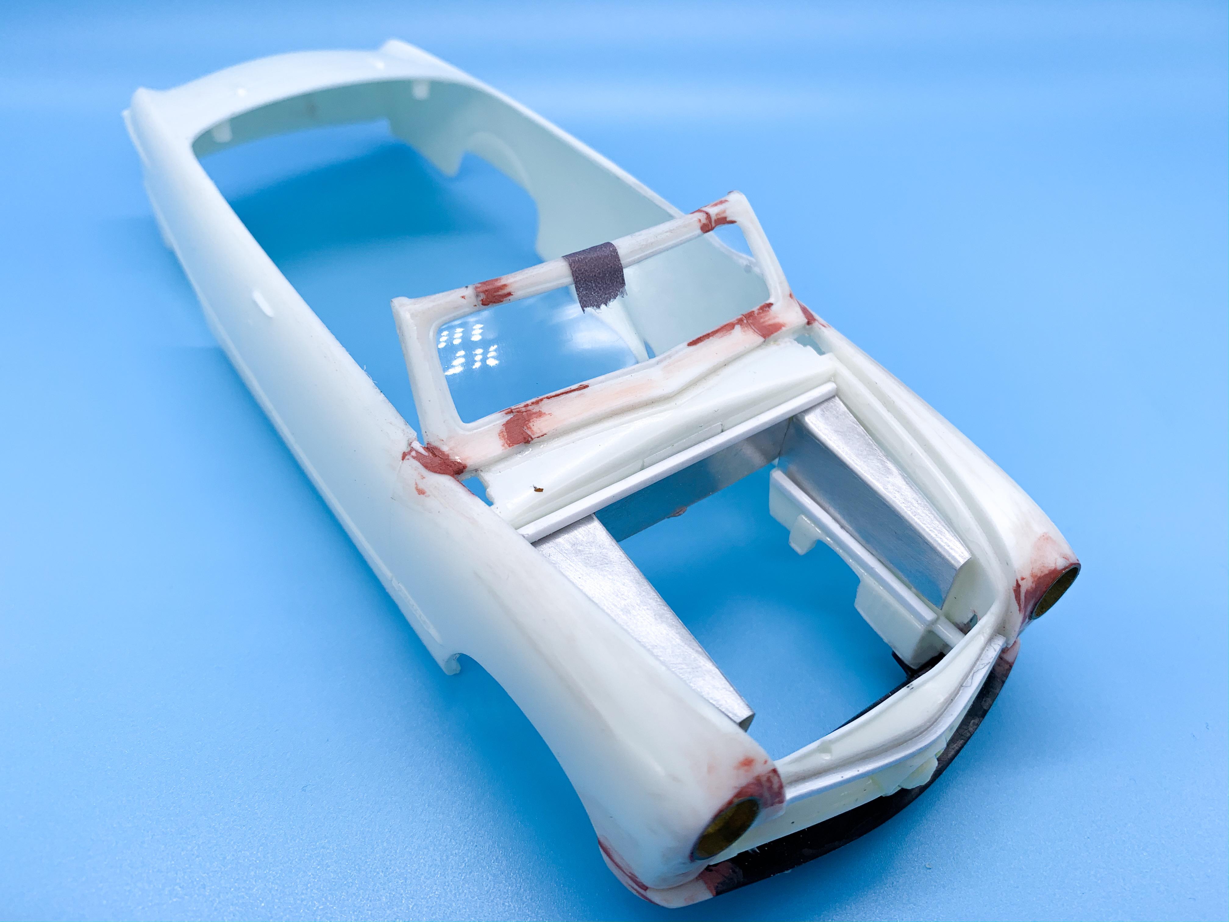

Next thing I wanted to tackle was making a start on filling this opening, which obviously would usually be hidden by the bumper:
I like that subtle curve that the rear end has, where it bulges out in the center and then revolves left and right with a little flick outwards - so to preserve that I made a piece that can sit inside the body that matches the shape as close as possible and will allow me to glue the ‘outer’ filler panel nice and secure:
More on this soon as the glue and Bondo dries 😂

I have a bag of those little clothes pins on my bench too, they do come in handy
Share this post
Link to post
Yeah, those clothes pins come in real handy for clamping stuff together while the glue sets up.
Share this post
Link to post
The trick with the clothes pins is to find the wooden ones without paint on so you don’t end up with little spots of colored paint all over what you’ve just glued 😂. I had some plastic ones too, but guess what - plastic glue will stick them to the plastic they’re holding 🙄😂.  Hey, no one ever said I was smart 🤷‍♂️😂

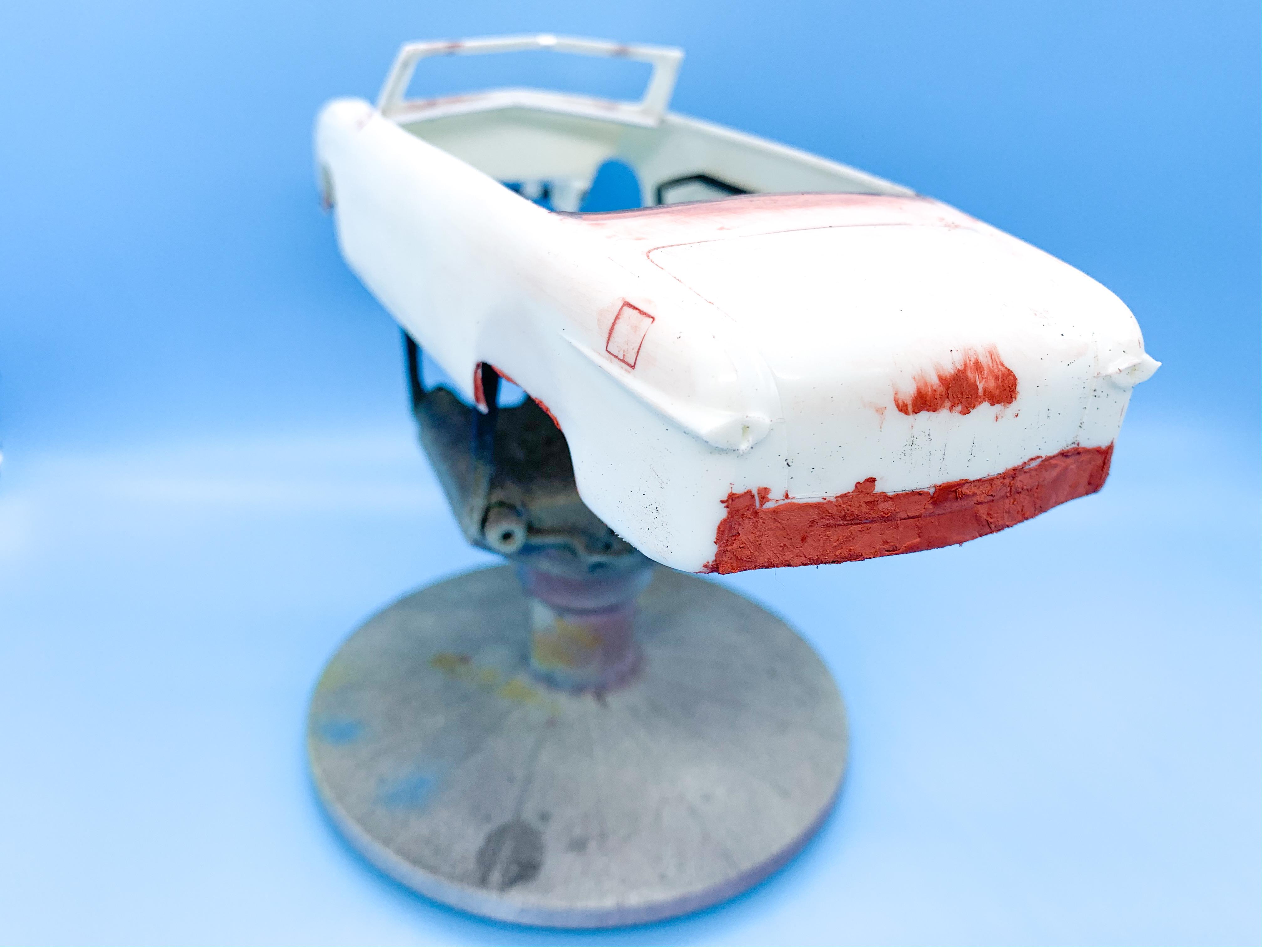

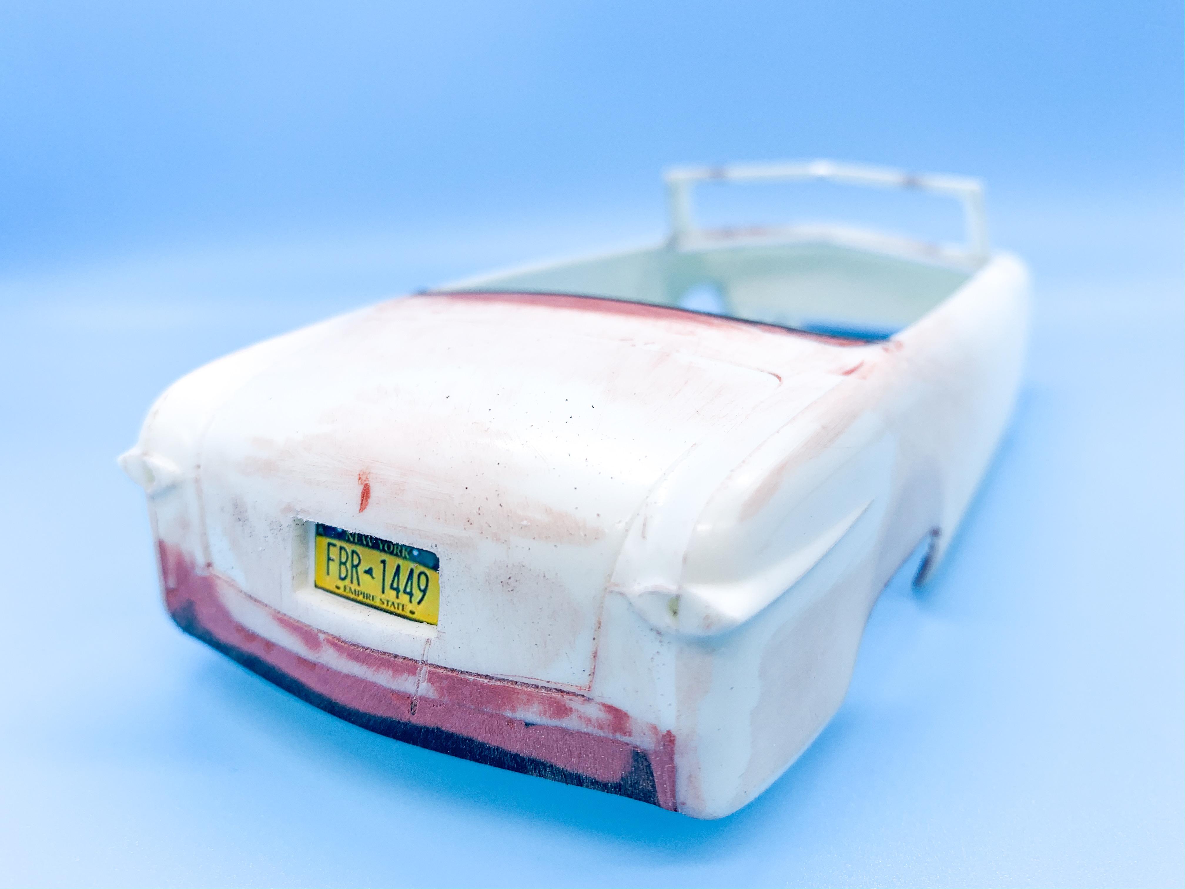

Got some putty on the back end of this thing:
And whilst that was setting up I decided upon a frenched license plate...I kinda didn’t want to run one but it was an extra detail to add and I hadn’t done one before so what the heck:
I’d like to try making a plate with actual raised lettering so that photo-printed one won’t stay but I think it looks ok there - just toget the edges nice with some filler and we’re set.

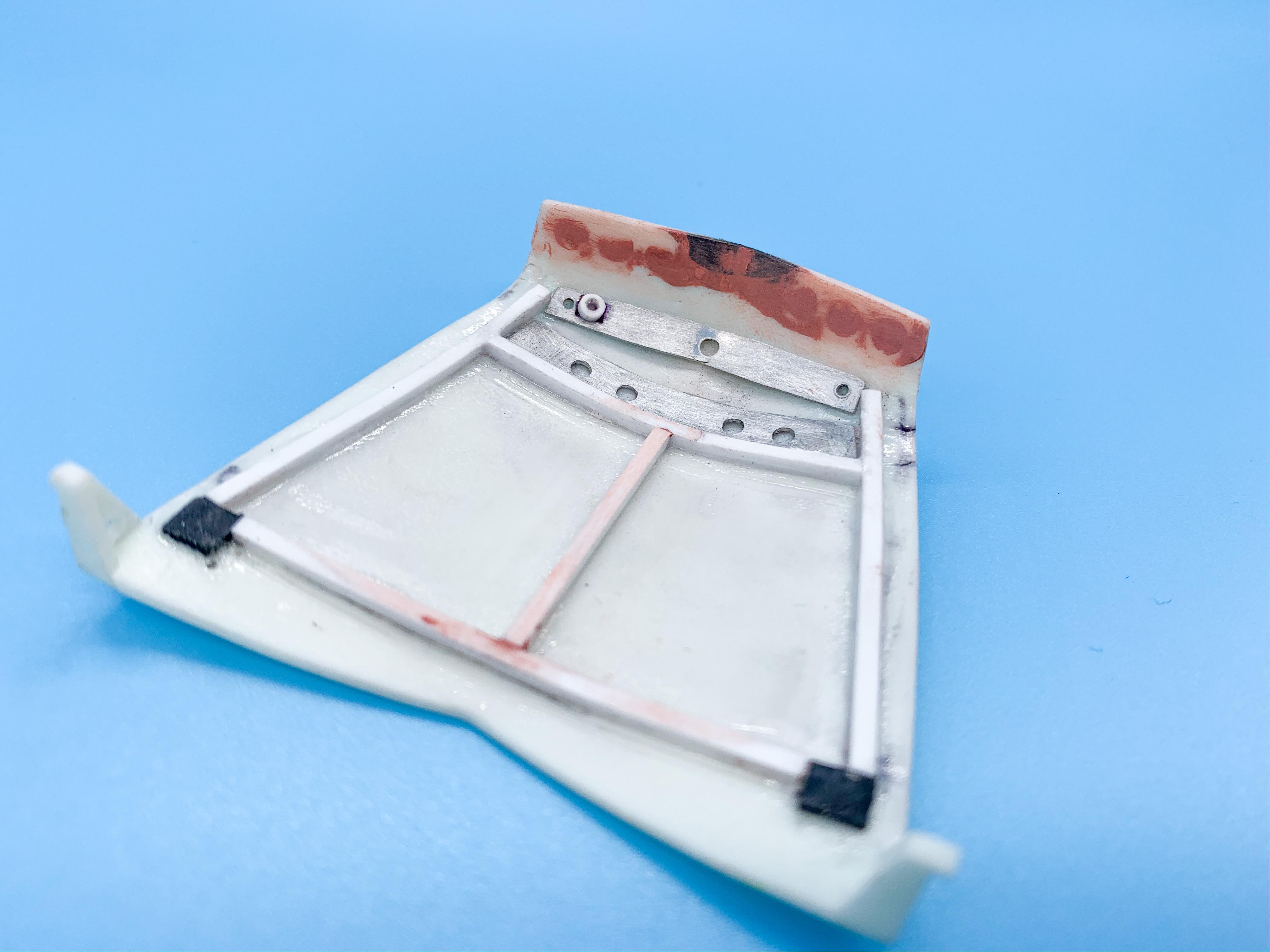

Meanwhile, I decided that if this was going to be displayed with the hood open I wanted to have a little spot to hold the support rod up so that it’s always straight and true and can’t fall over, so I added a little styrene bar donut to the bracing I’d done earlier and whilst I was at it smoothed out the inside of the lip:
Not super interesting stuff - but next step is getting this thing in primer so we can REALLY see what all is left to do.  Pretty close on the body mods though!

Found one more little job that I forgot before primer...added a little metal hood latch:
Ignore the drill bit, that’s my temporary hood prop 😂
And added a little strip of, well, strip, just underneath the hood where it meets the body to fill a little gap that I’d been meaning to fix but forgot about
Ok, NOW, we’re ready for primer!  More soon!

I like the "shadow box" license plate mounting.
Share this post
Link to post
I can’t take any credit for that idea - someone came up with that about 30 years before I was born I think 😂

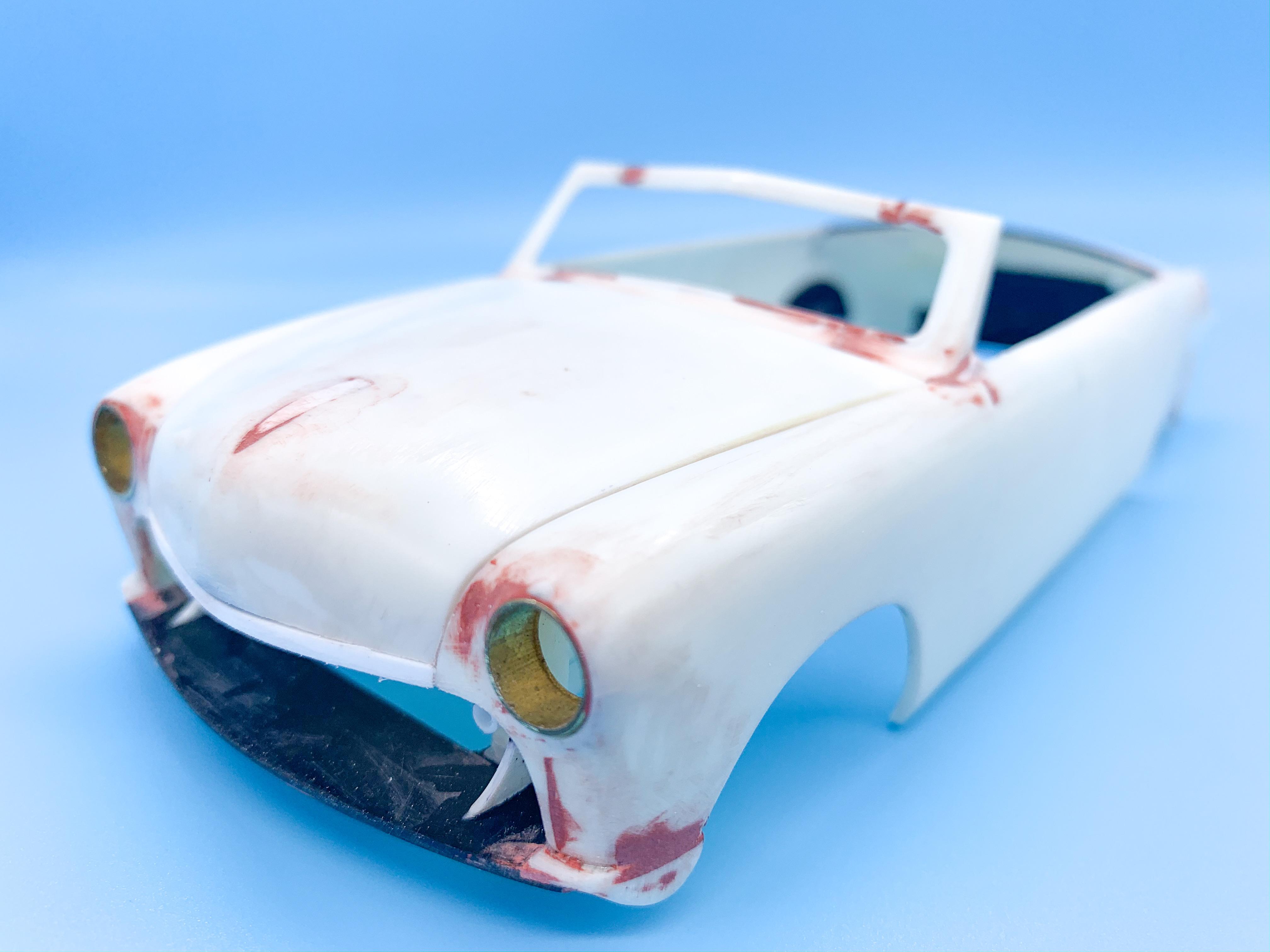

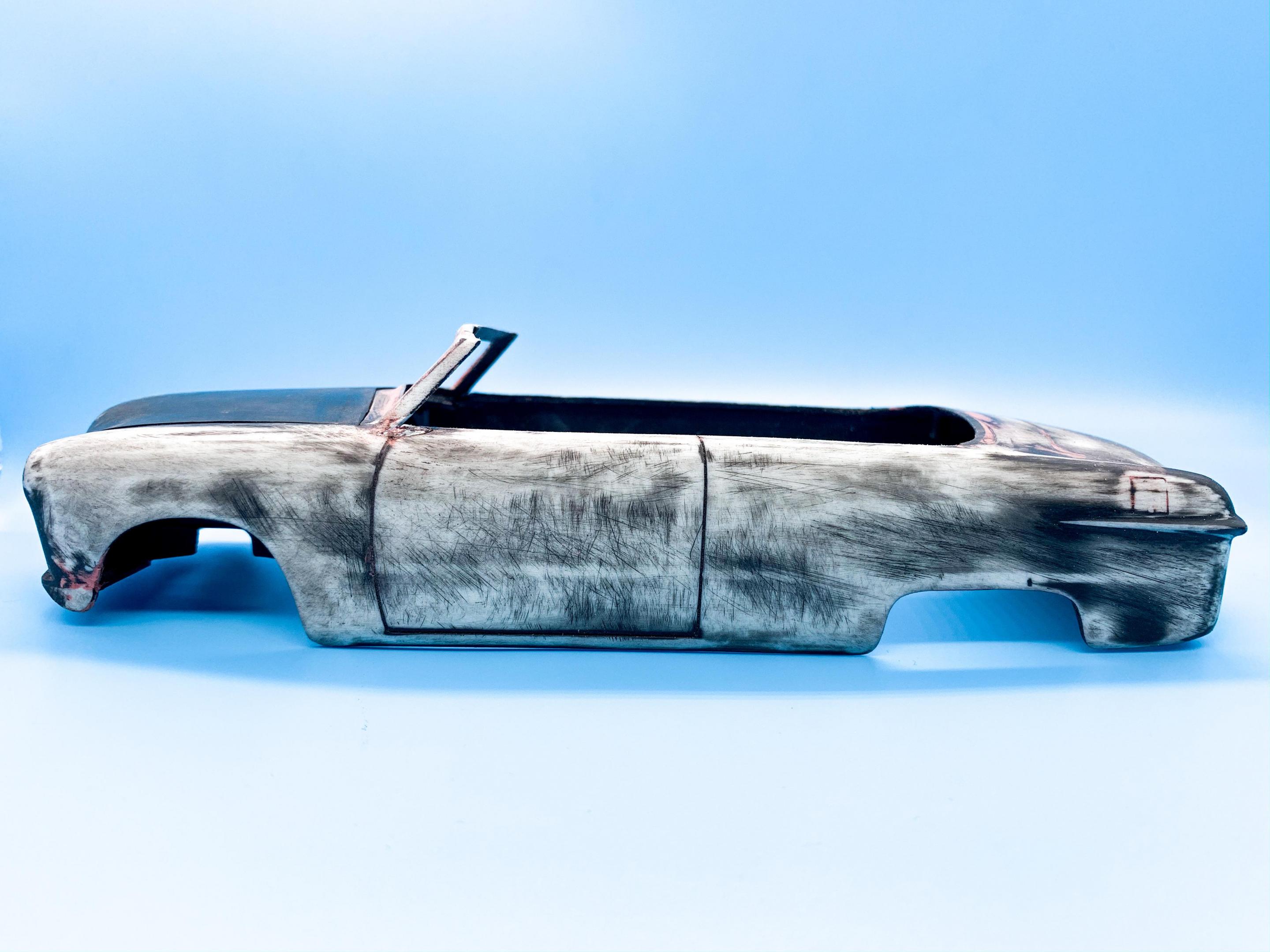

Just a little progress - got some primer on this, this week!  Wanted to see how much more sanding and filling was in my future...turns out some, but not too much!
Nice to see the body all one color finally!

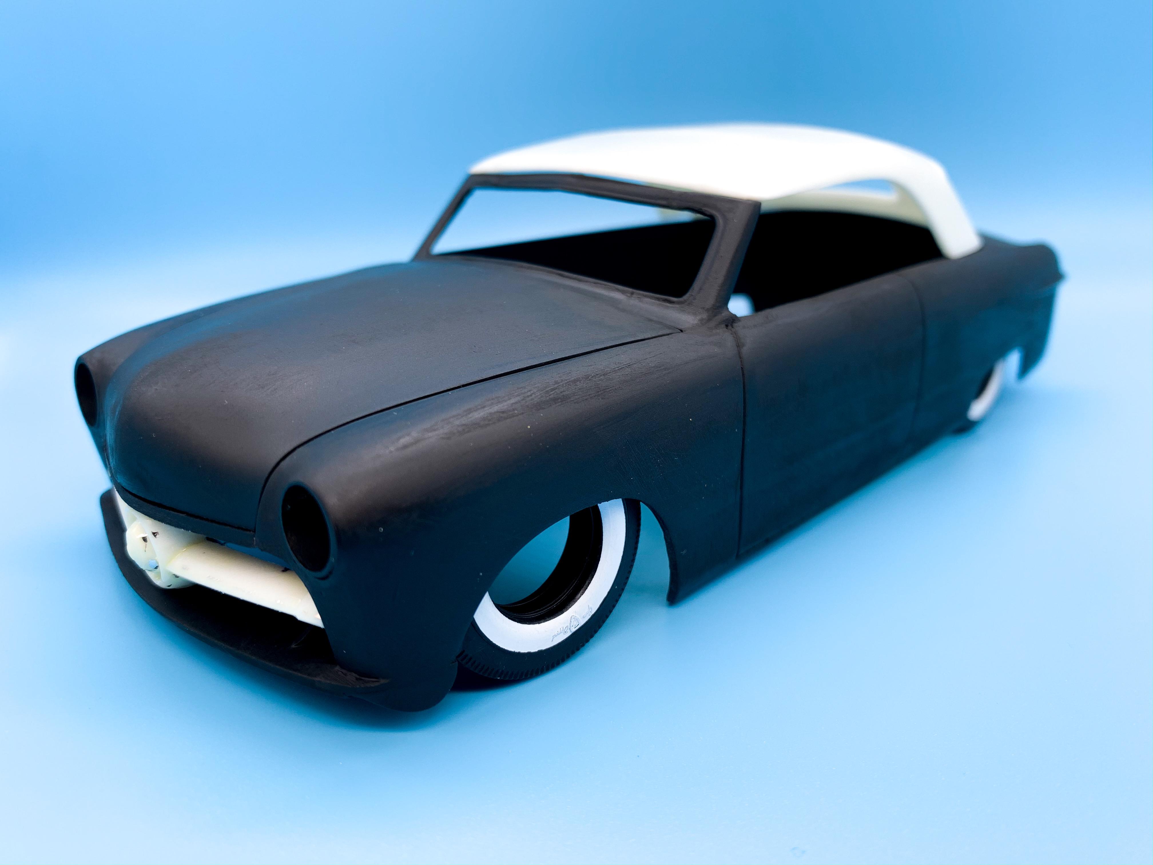

Just a little progress on this, as I’m replying anyway...started levelling out that primer to see how much work I’ve REALLY got to do to be ready for paint...there’s definitely plenty more work to go to get those big side panels level and smooth:

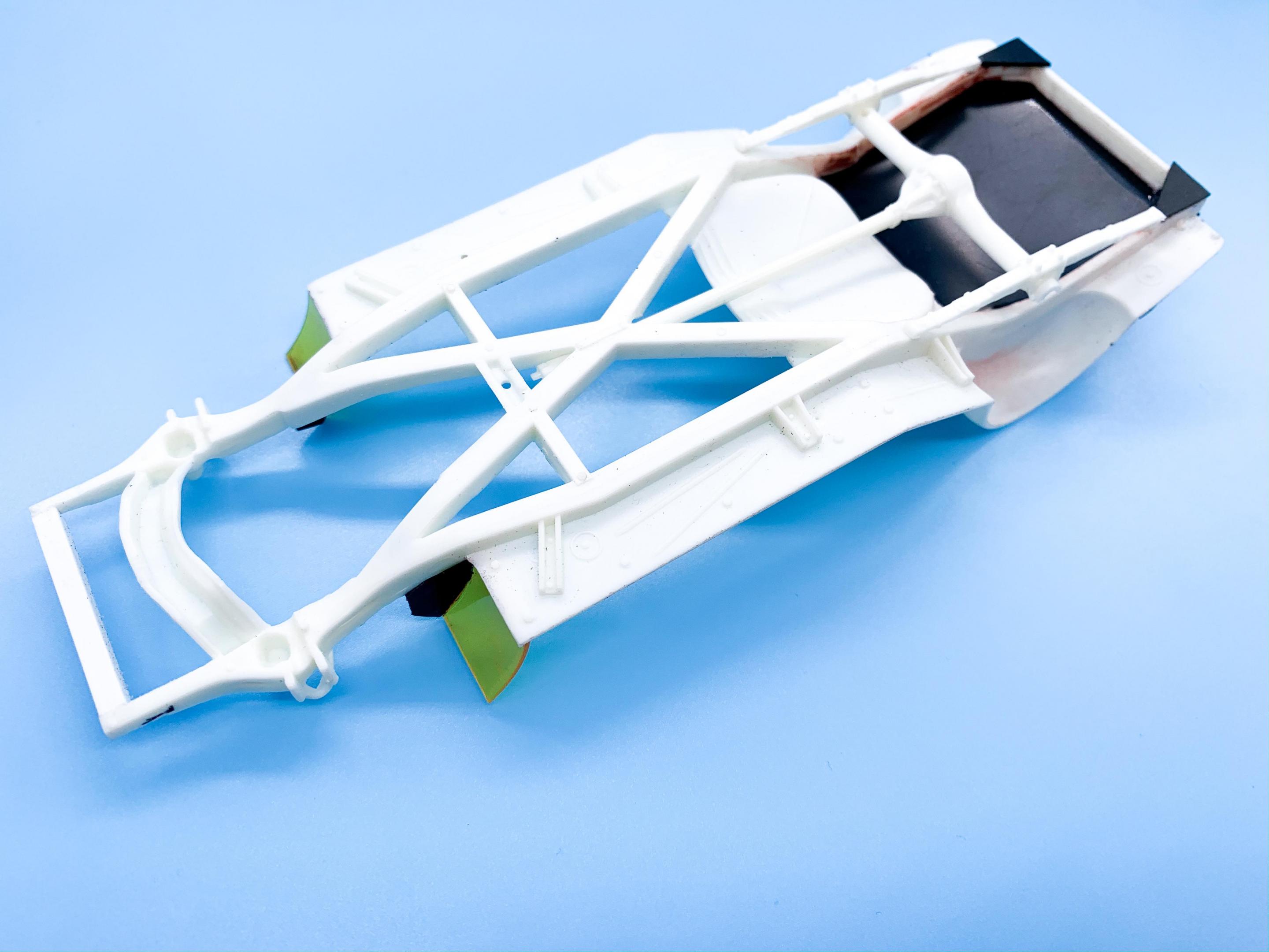

And I started work on the kit frame - I want to approach this roughly how I did the body, keep it fairly traditional on PAPER, but smooth it all out and add some nice custom details and touches.  The kit frame looks like this:
I started by removing those flat angled inner arches and replacing them with some scratchbuilt ones with a slight curve, then I removed the moulded in exhaust detail and scribed out that trunk floor so that I can tidy up that area...will probably scratchbuild a fuel tank that fits nicely between the rails, delete the spare tire hump and find a nicely detailed rear axle to replace the stock one:
