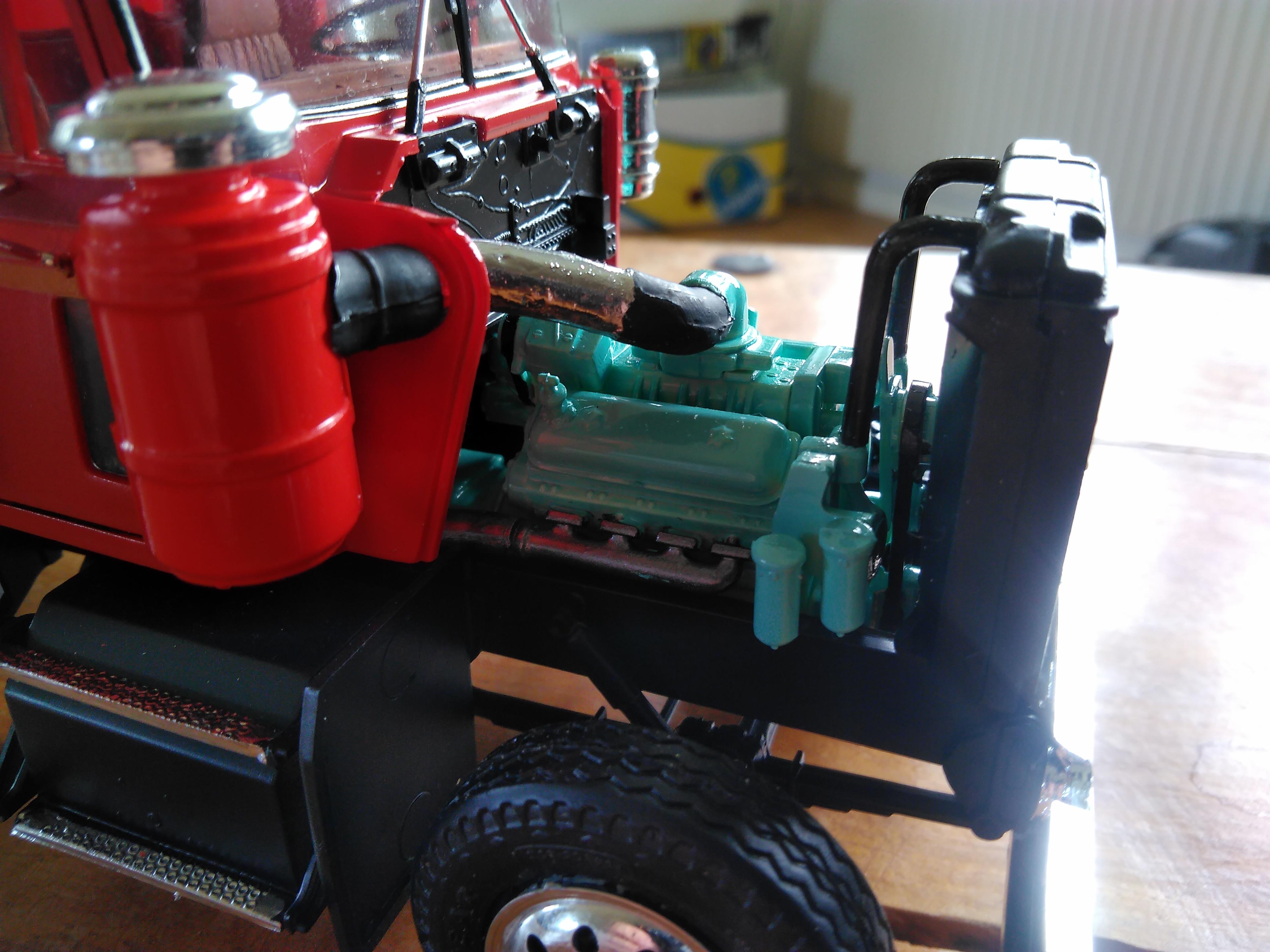

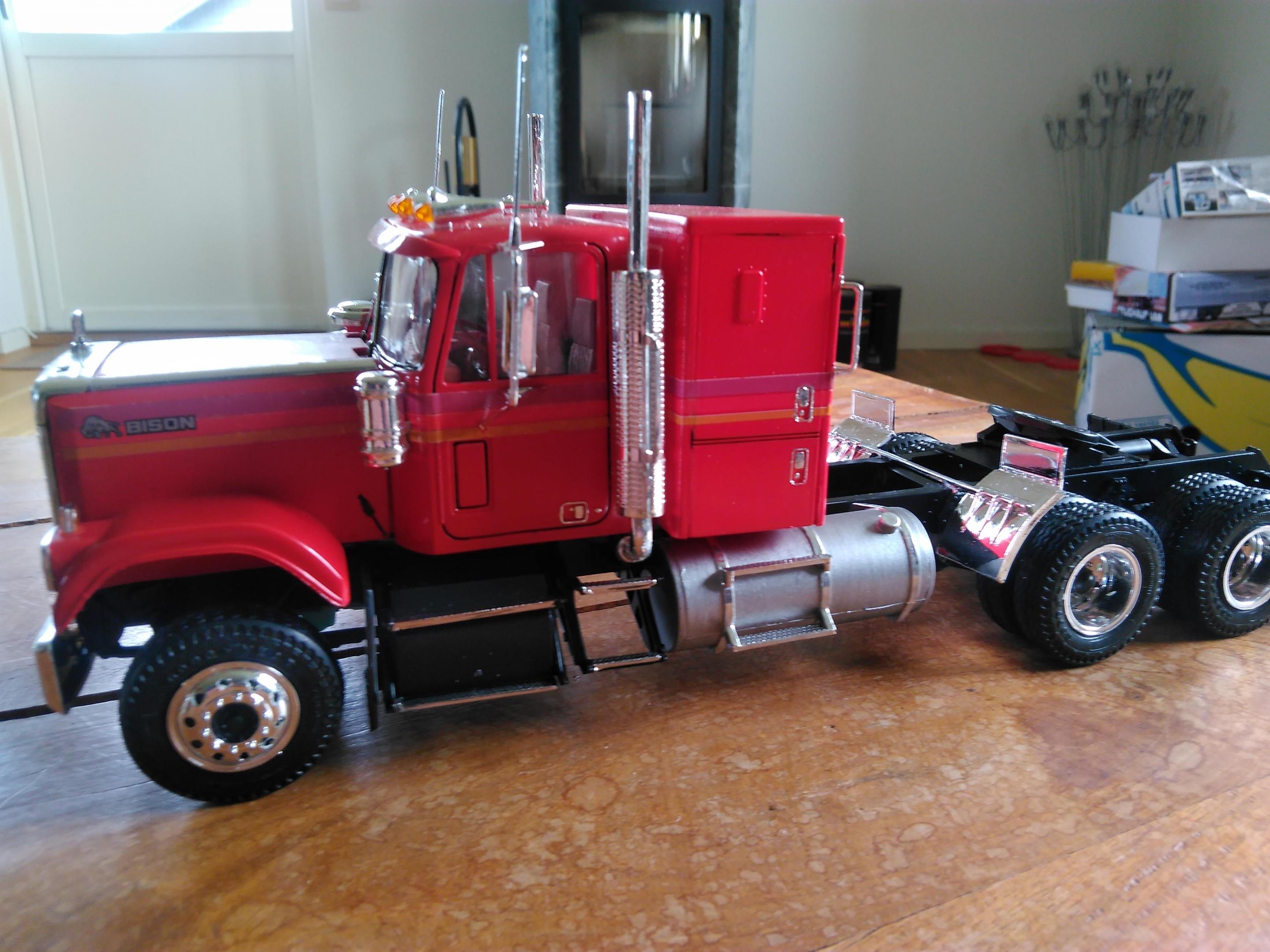

Got this done today.
It had almost the same problems as the General did exept this had much more flash on the parts and way more warped hood and cab.

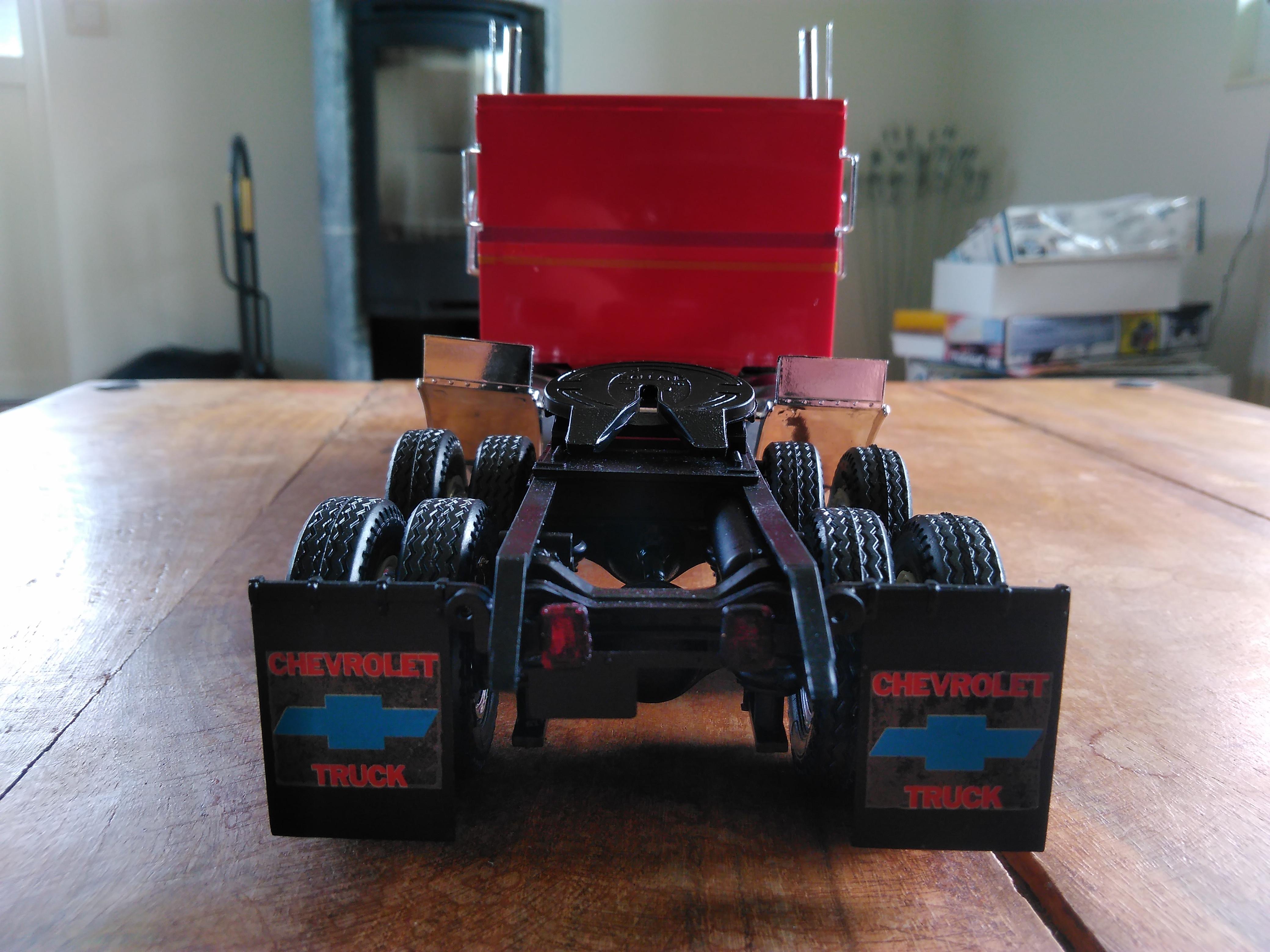

I was surprised that the decals even worked since they were from 1979.

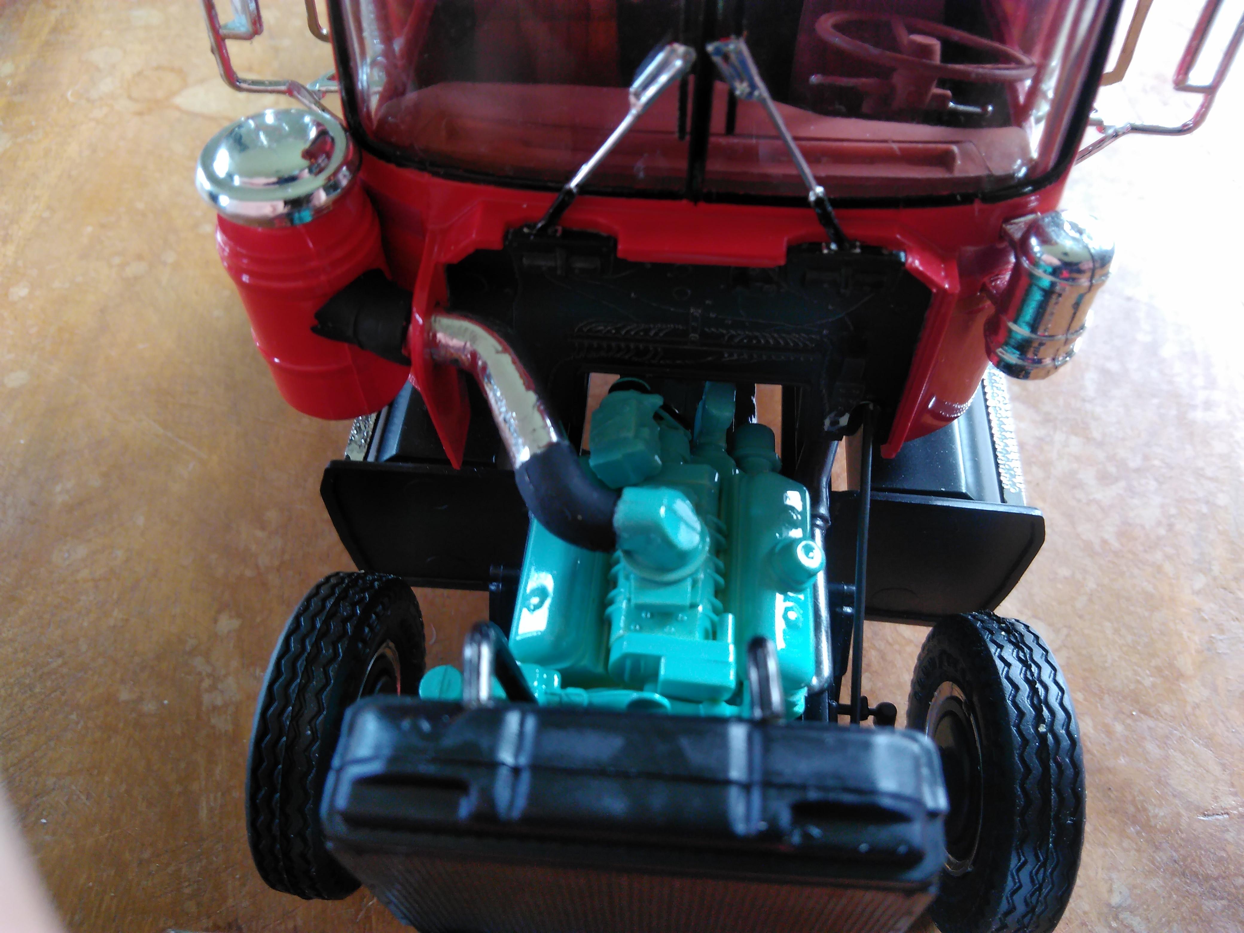

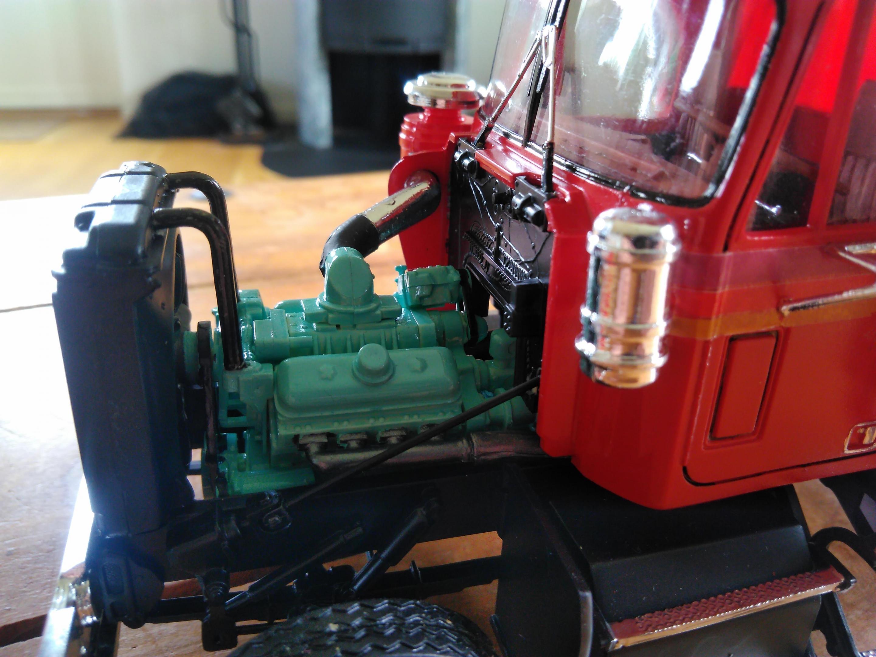

Also found out why the hood hinges does not line up, they have flipped side on the parts in the manual so the left side should be on the right.
The manual shows the pins facing the radiator but if they are flipped they will face the headlights and line up much better with the hingepart that glues on the back of the bumper.
I only looked closer at it after i painted it and just left it as it is because i did not want to destroy the paint so the hood is just loose ontop as on the General.

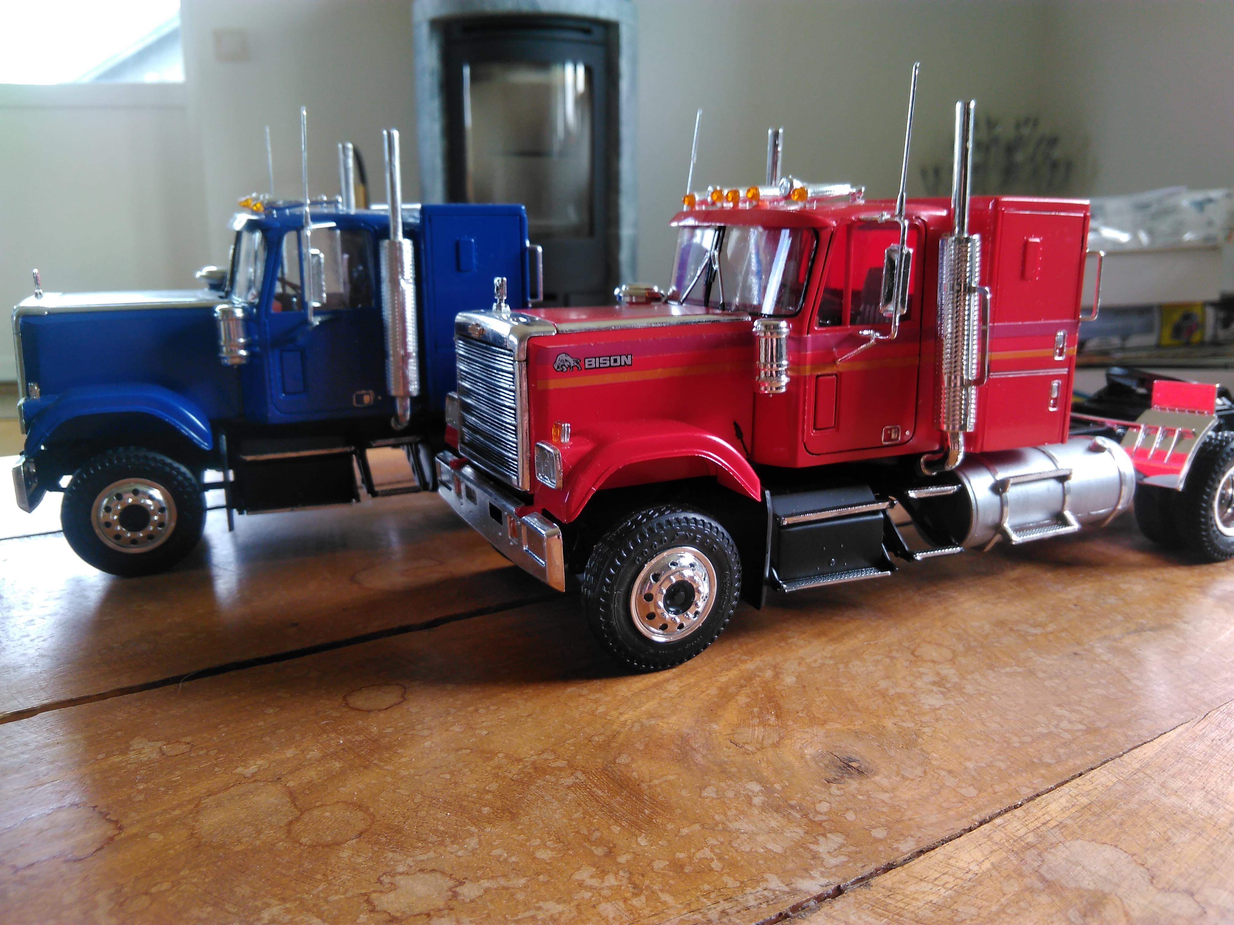

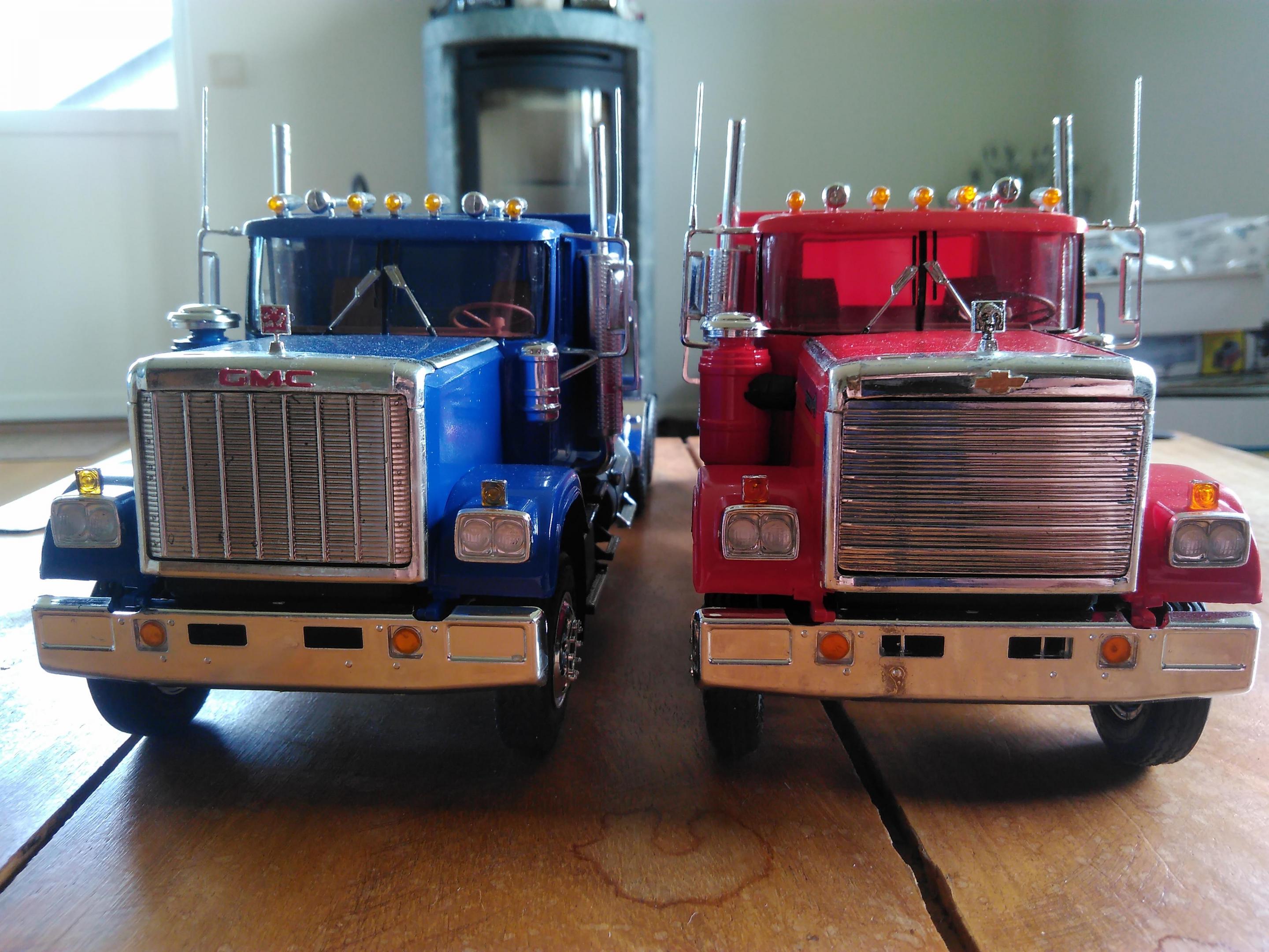

Nice looking Bison.  The Bison & General look good together.  Great job on some tough kits.
Nice job on these! It’s been 40+ years since I have built one of these. I have a couple in my stash ready to hit the bench. Thanks for the tips.
Thanks.
Yes they look great standing next to eachother.
Thinking about buying the Gmc astro and Chevy titan and having them next to eachother to.

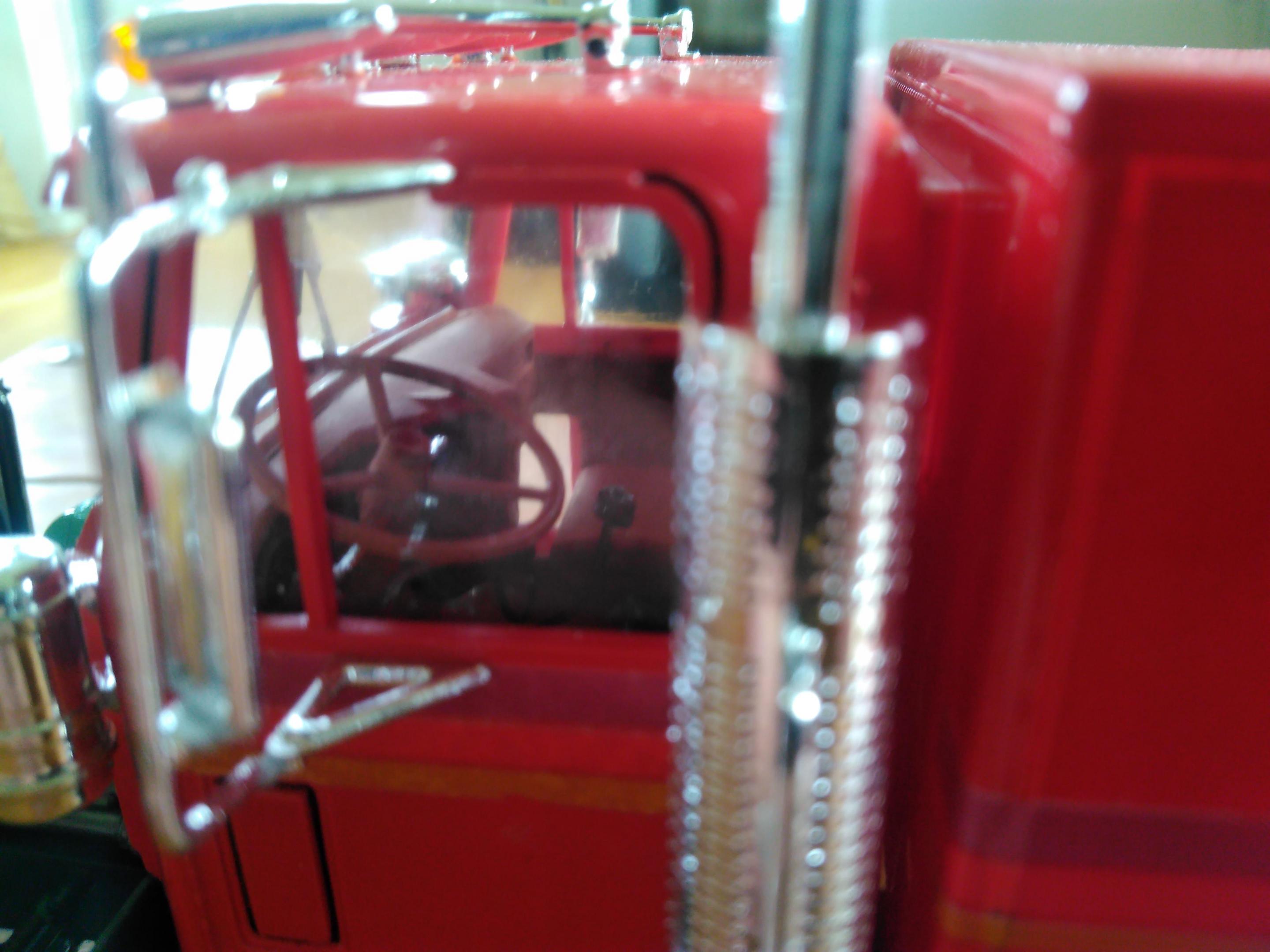

Only thing i regrett not doing is painting the inside of the sleeper black to stop light shining through it.
Did not need to do it on the General because of the blue color.
