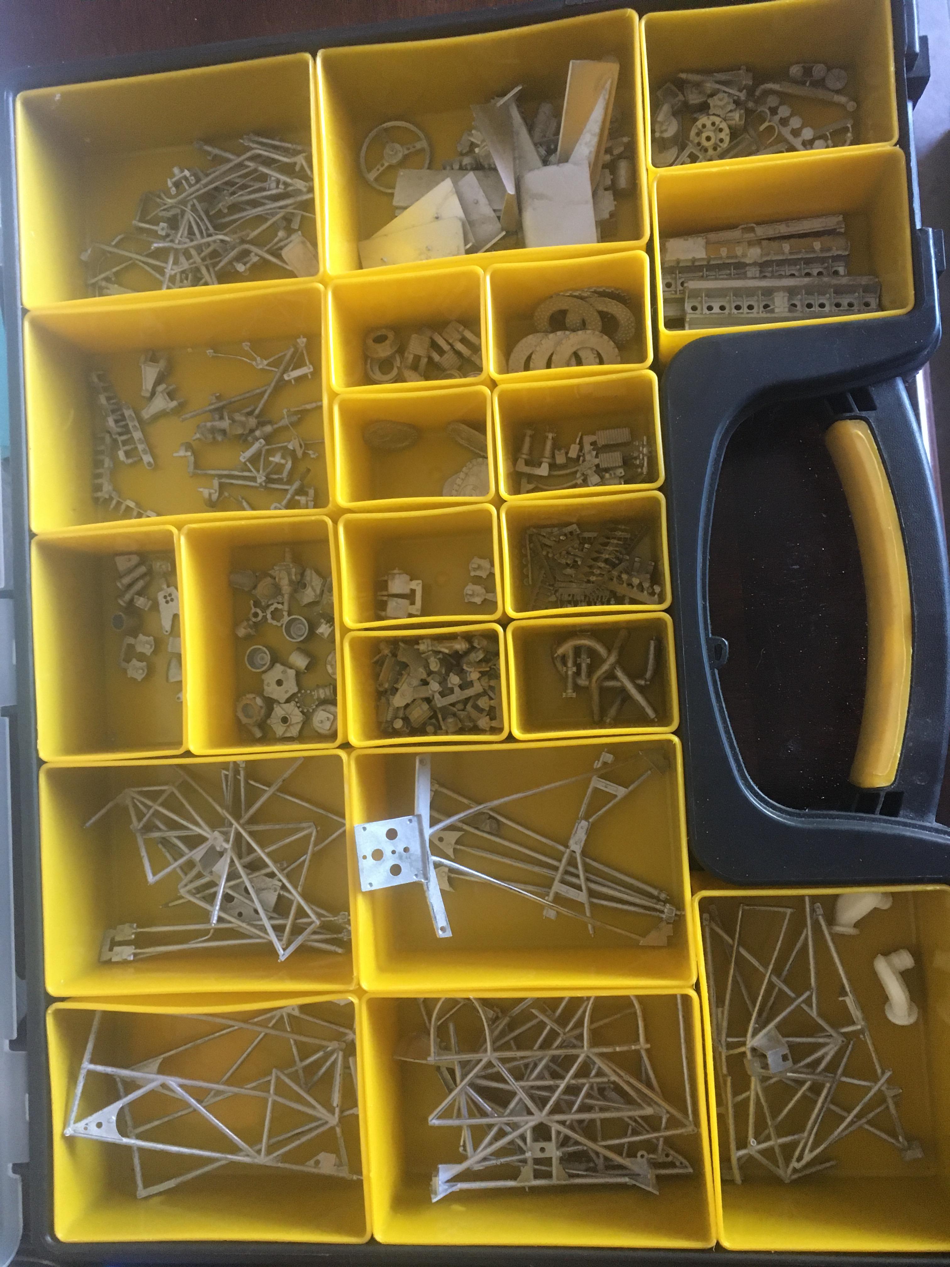

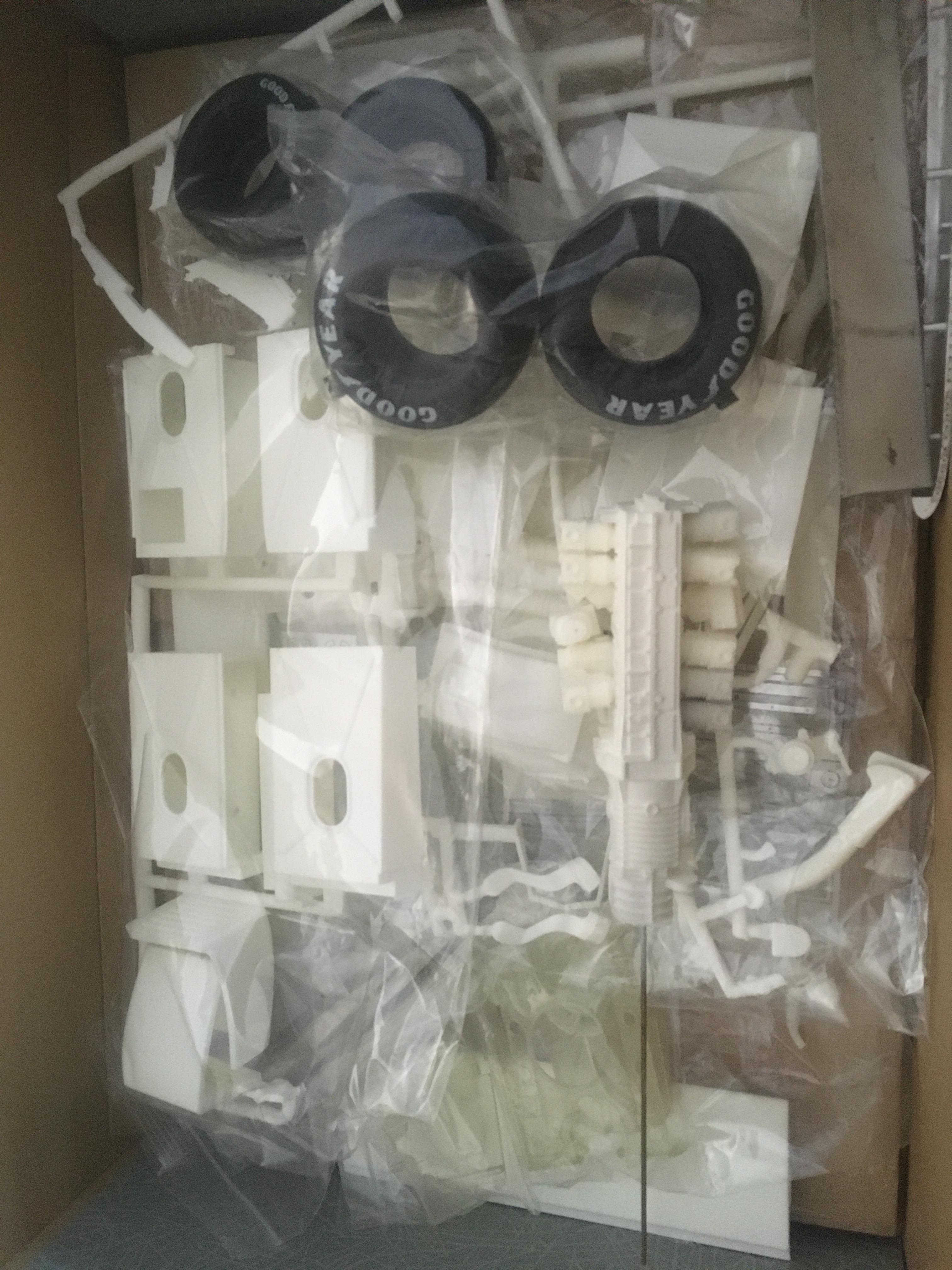

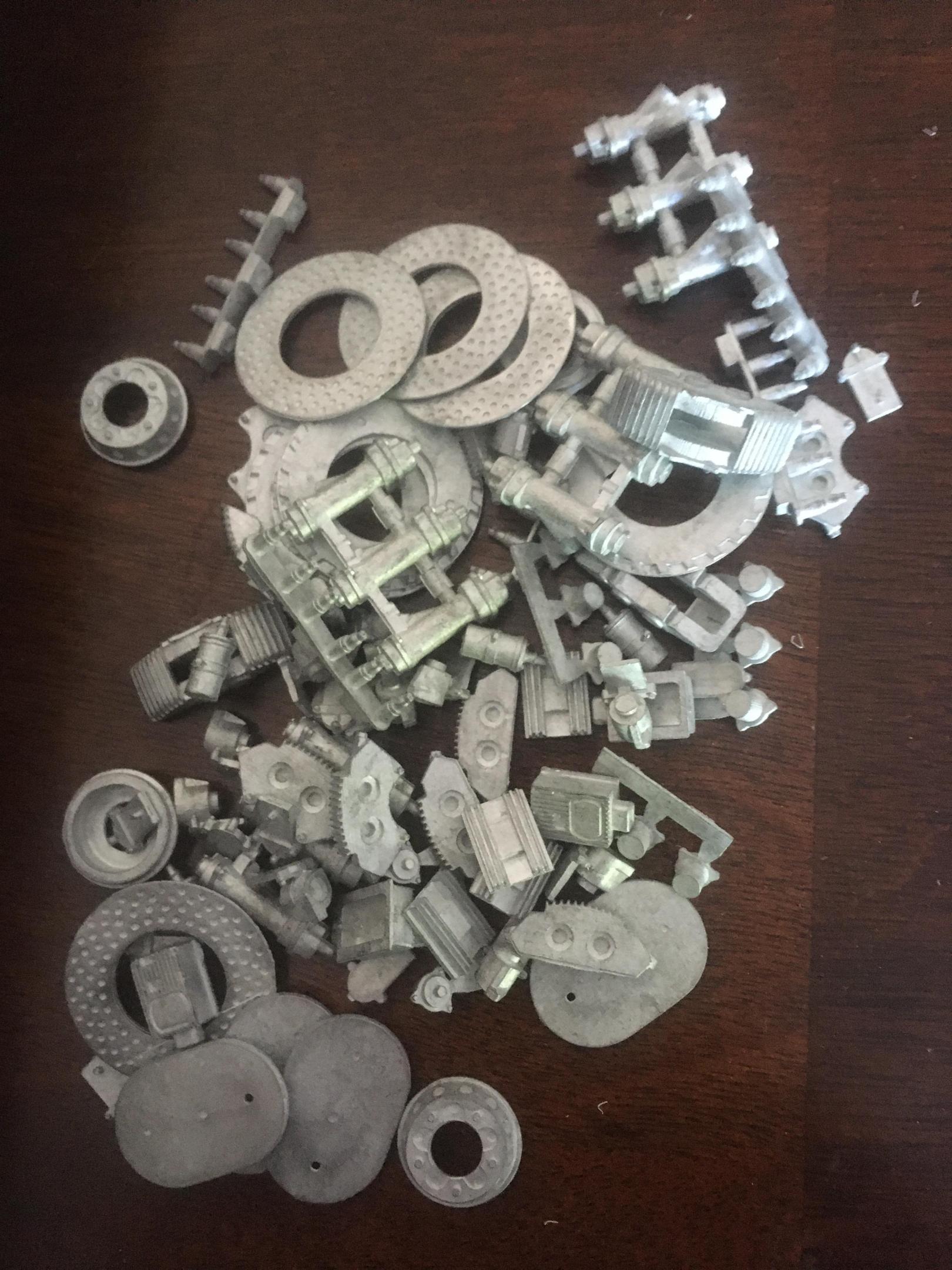

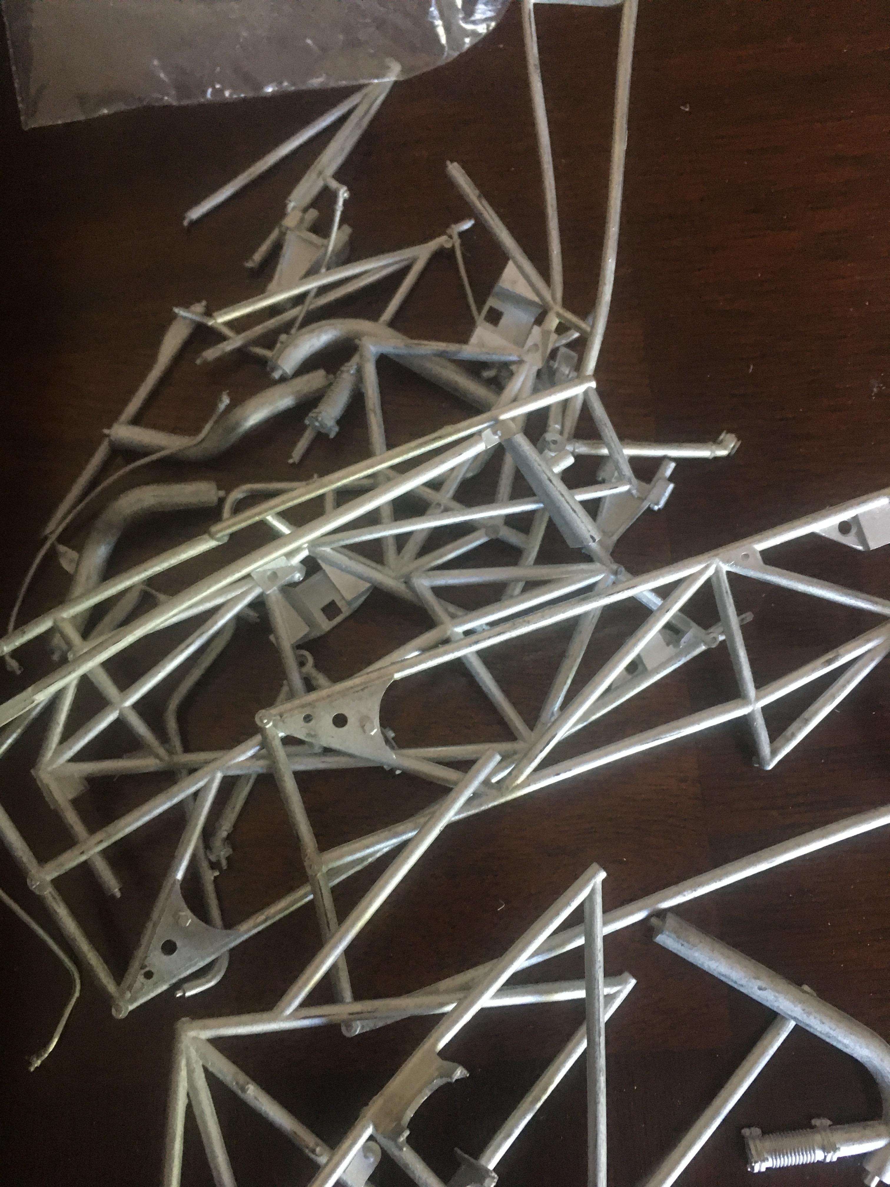

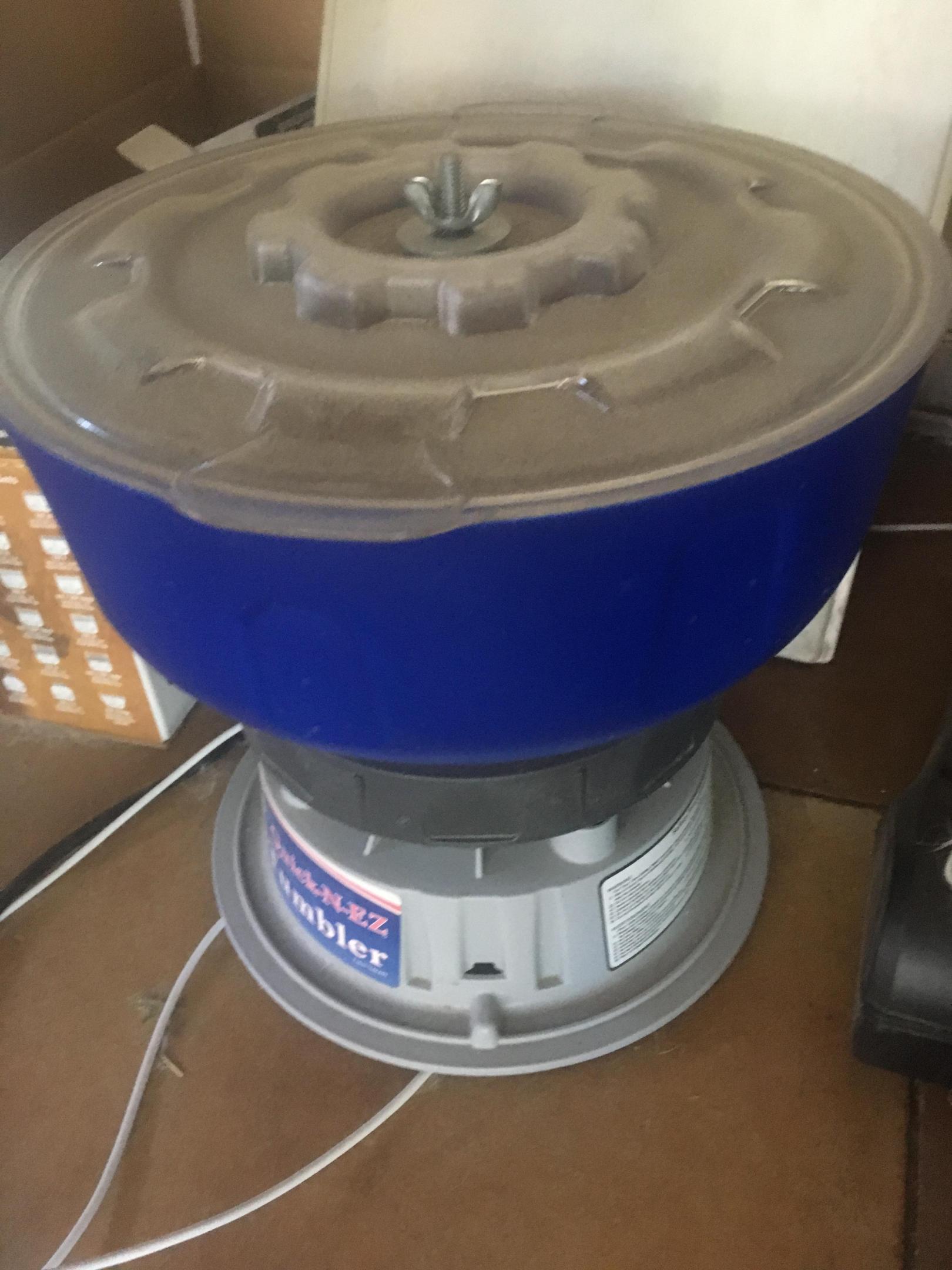

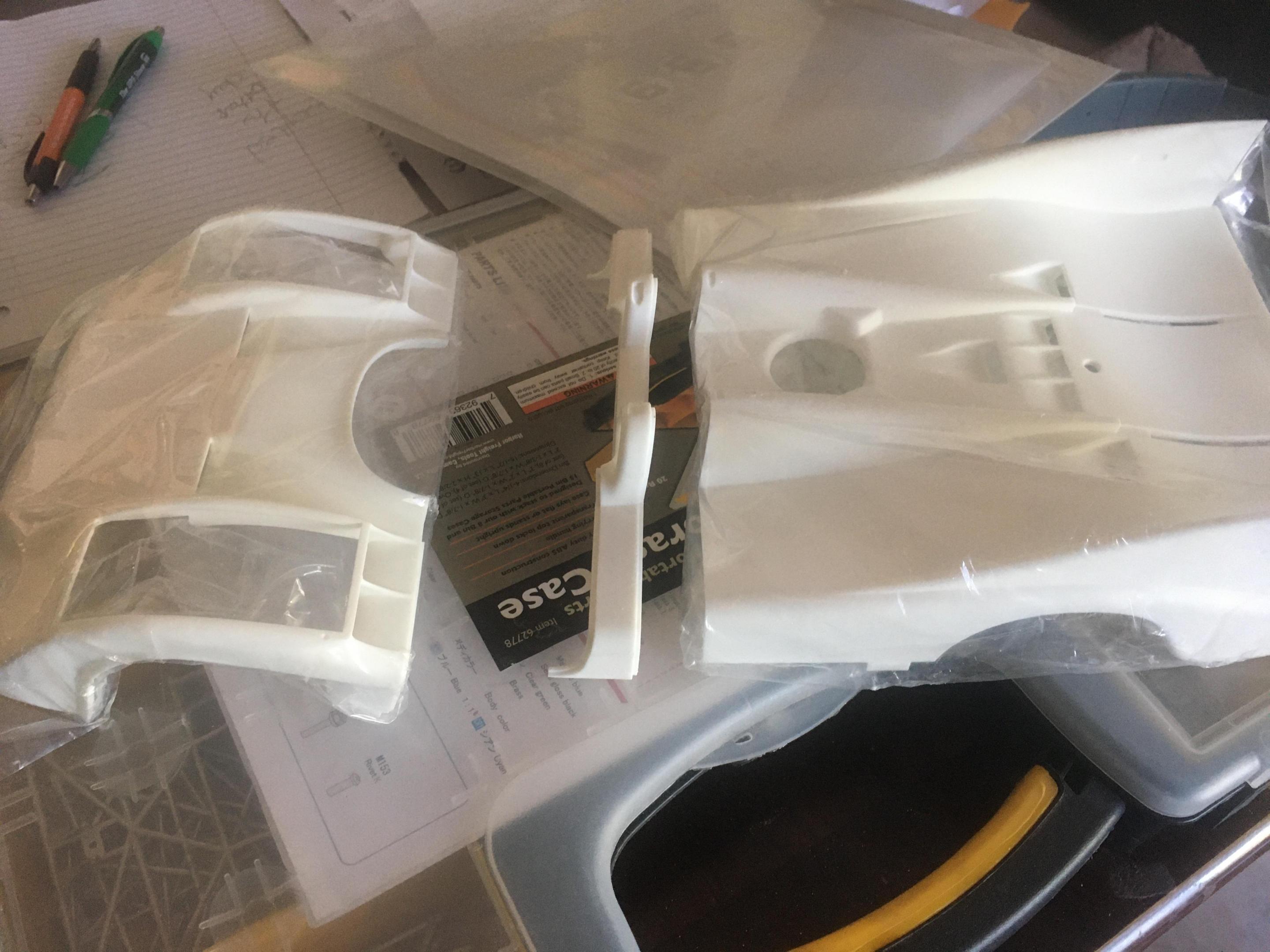

Brudda Posted August 2, 2020 Share Posted August 2, 2020 Well going to start the 1/12 mfh 917/30. I must be insane. To do these kits you turn kind of crazy. Anyway i have some pics of things to start. Will not bore you with the very boring part of prepping the parts. I believe the mfh P4 had over 2000 parts. This kit has about the same. There are bags and bags of white metal parts. You must organize these or you will get lost or worse lose parts. You have to polish the white metal parts in a tumbler. (I use a brass tumbler for gun shells)Took 10 months to build the P4. Each PART DEMANDS attention. So here we go........ Quote Link to comment Share on other sites More sharing options...

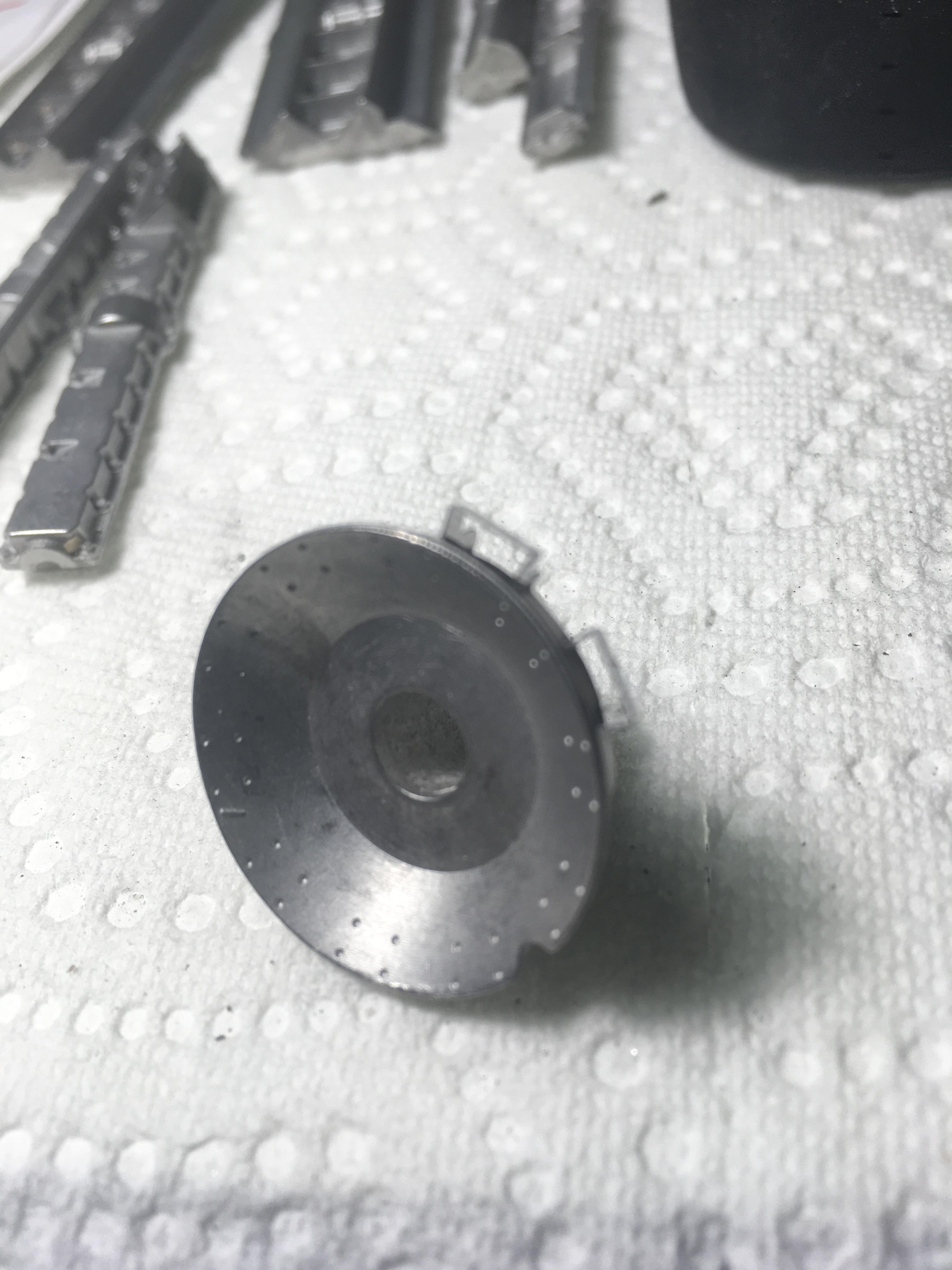

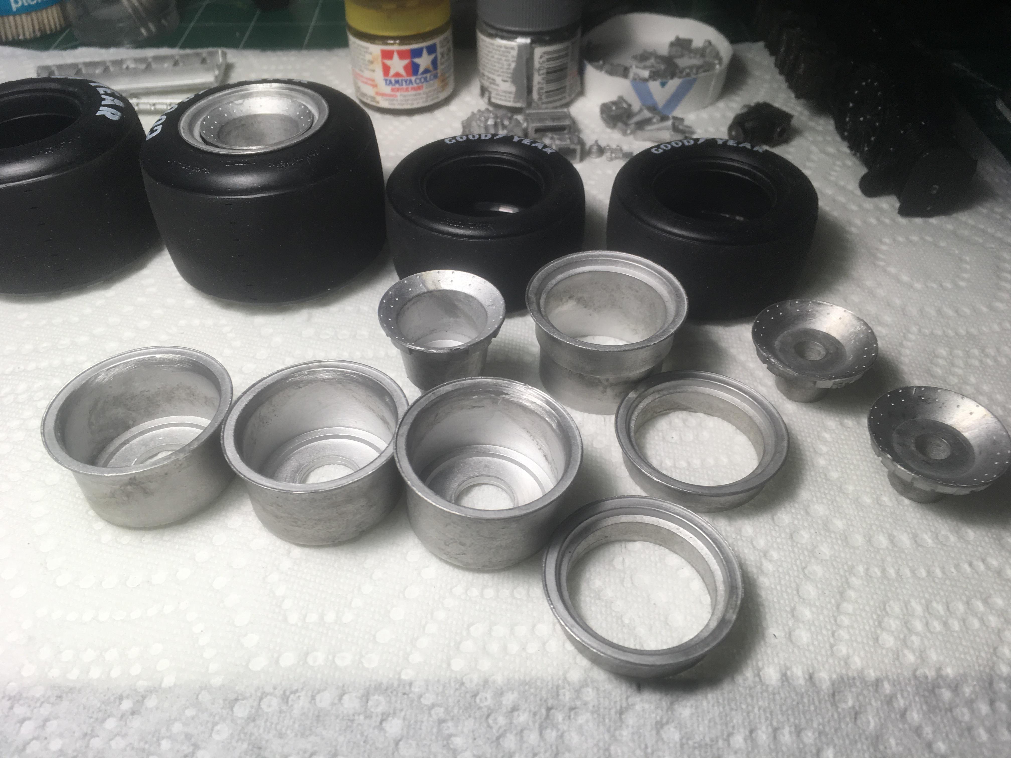

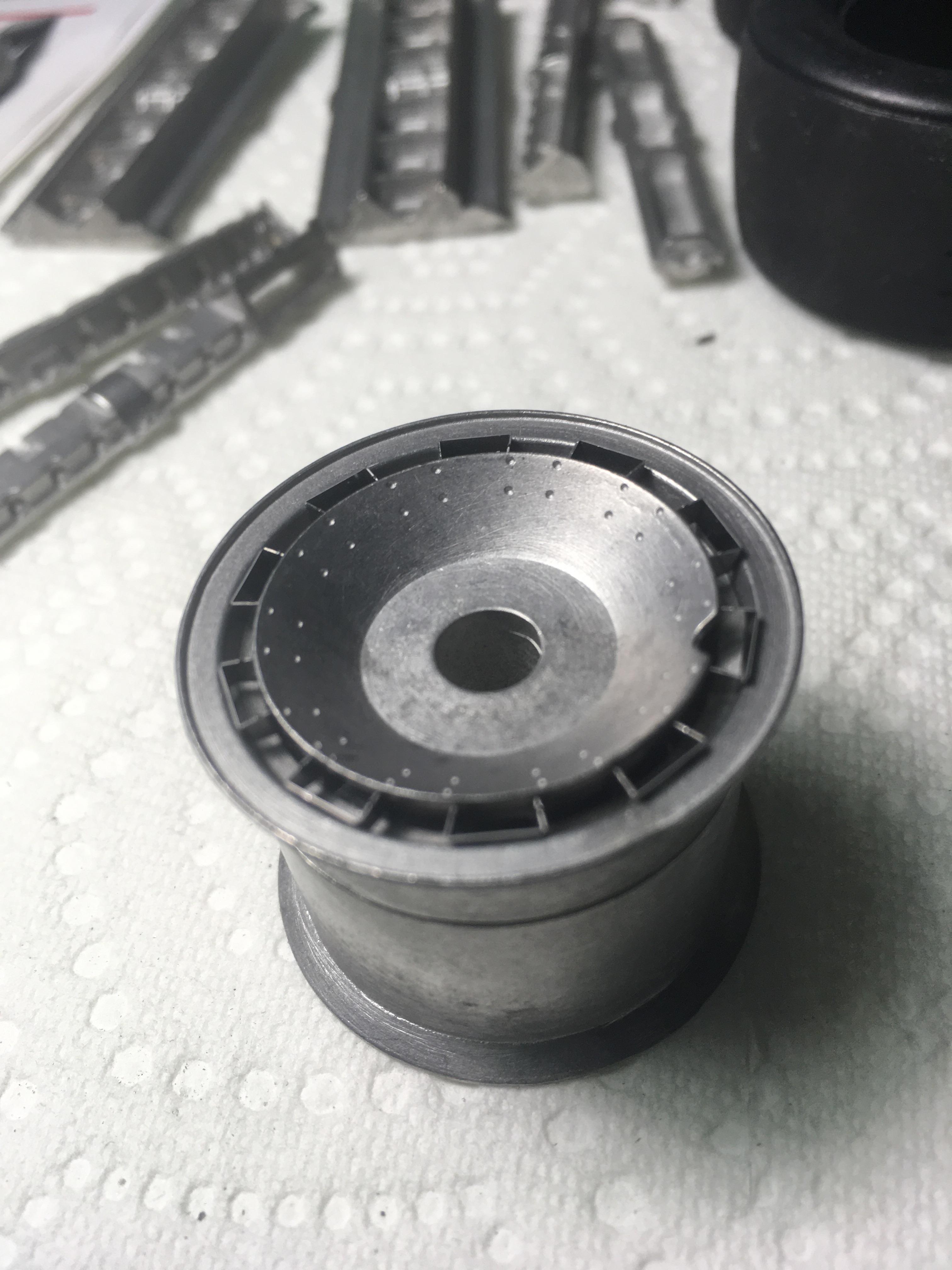

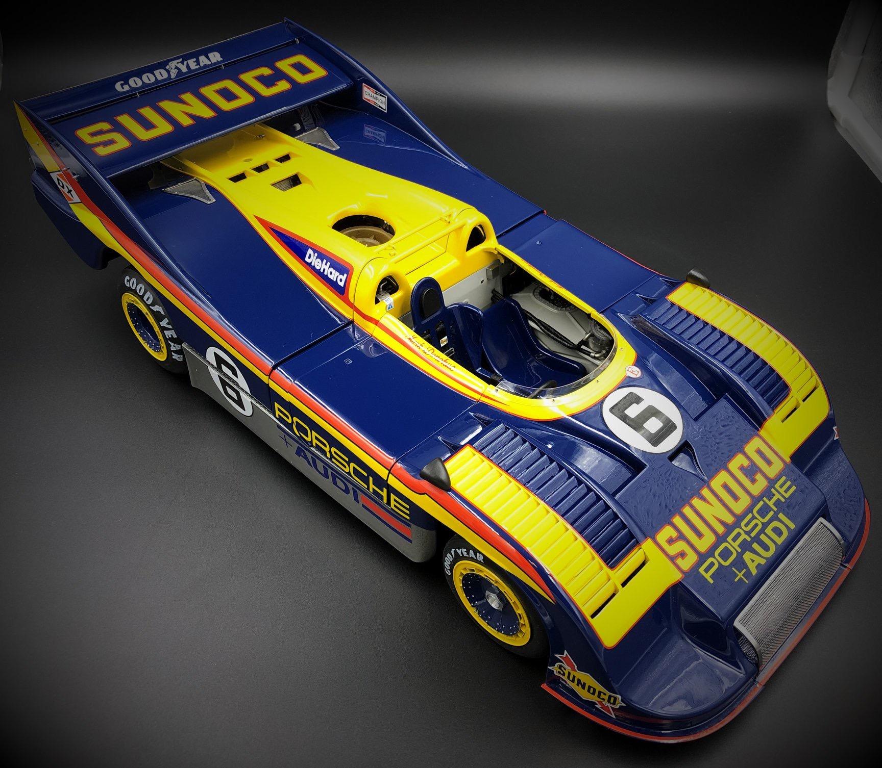

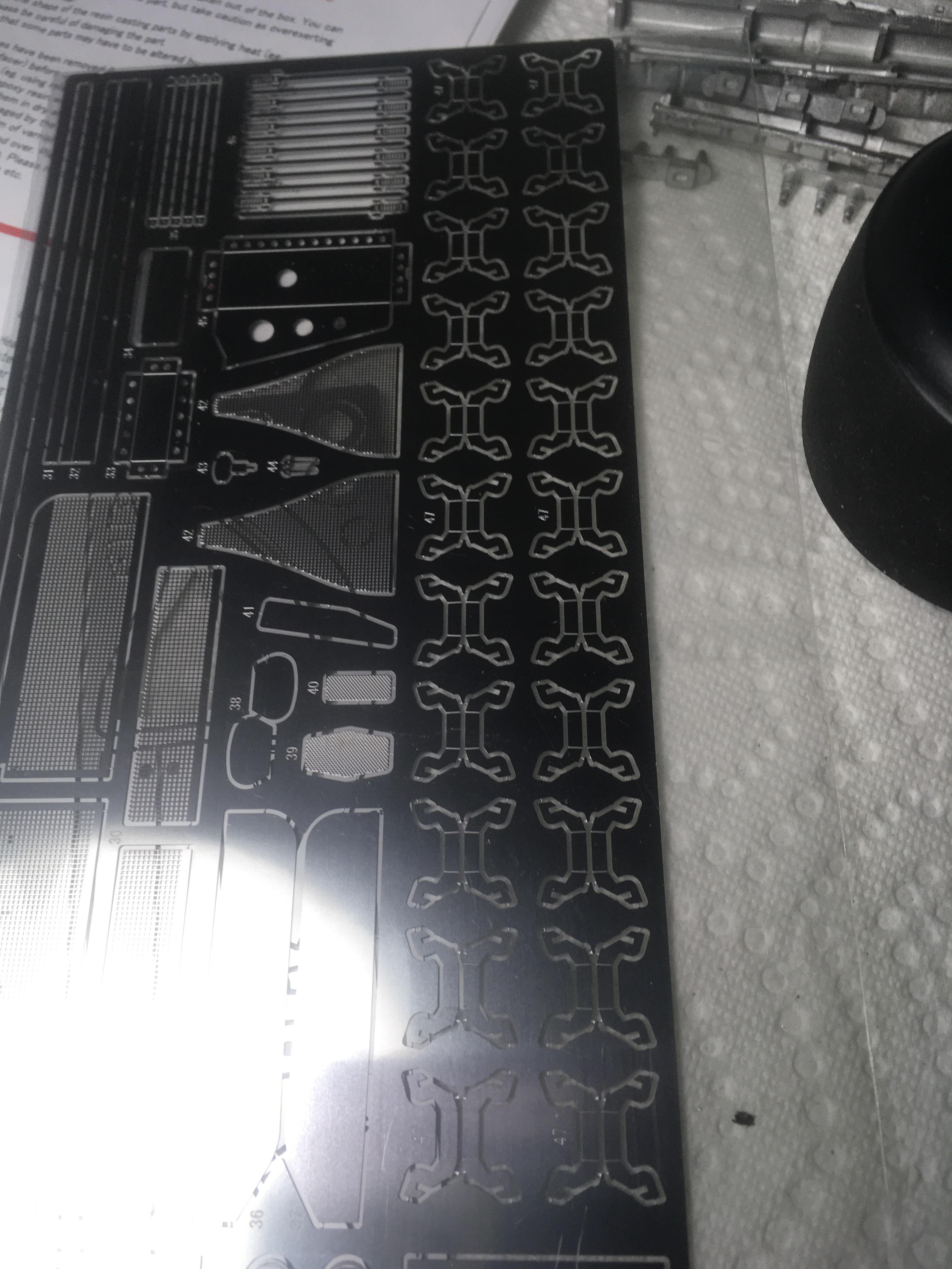

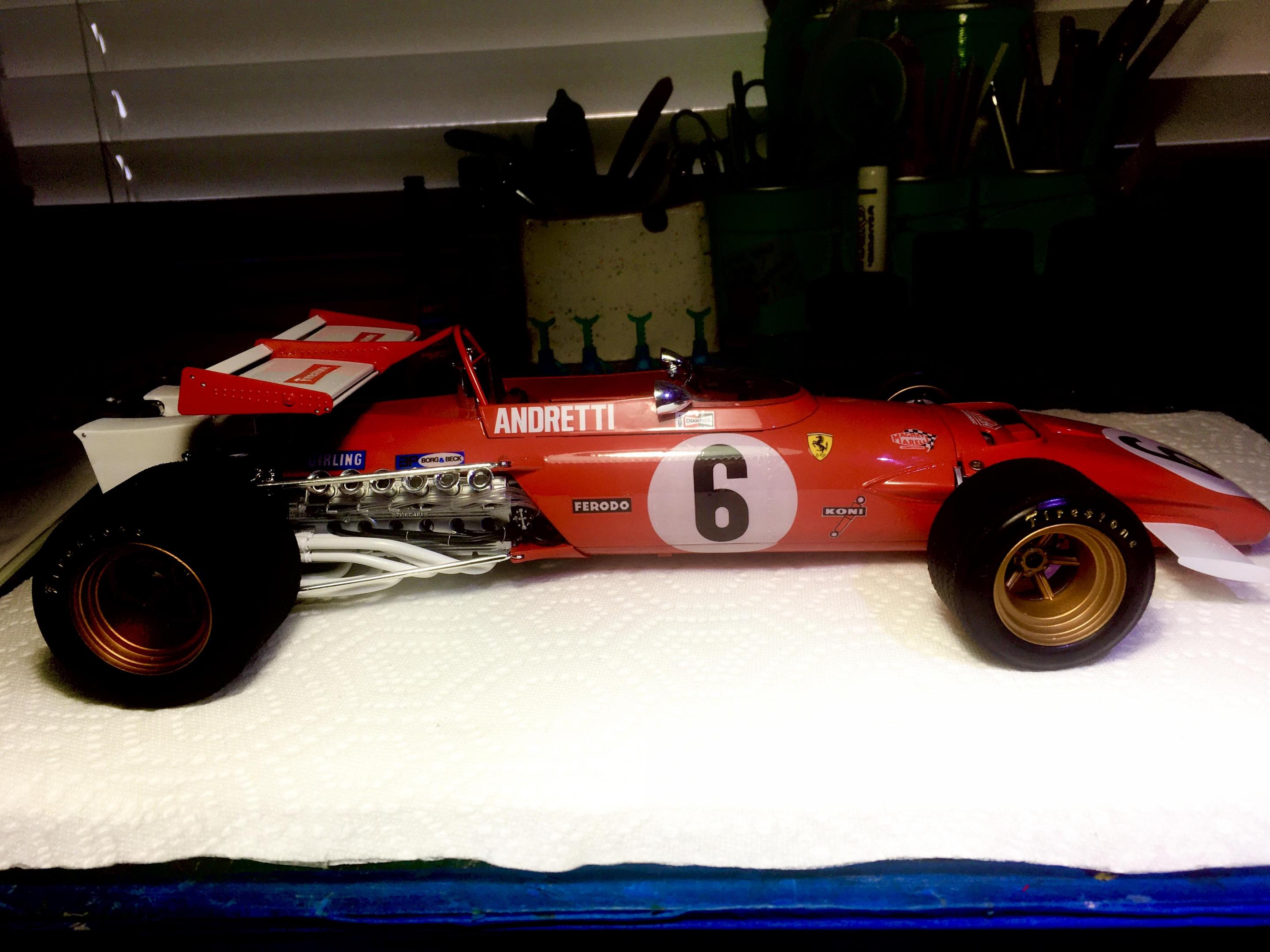

Brudda Posted August 5, 2020 Author Share Posted August 5, 2020 The cleanup on the wheels and other parts took several hours. Next is the tumbler. Have to cut out the fins on the wheels. They are photoetch. Install after the tumbler. Prime with acidetch primer. Then paint and clear. This process will take a few days. I builta 1/12 tamiya Ferrari in 9 days. Out of box. These wheels alone will take about the same time. There is a pic of the Ferrari. That’s how intense a model factory hiro kit is. If you guys love detail, get a mfh kit. You will not be disappointed. Quote Link to comment Share on other sites More sharing options...

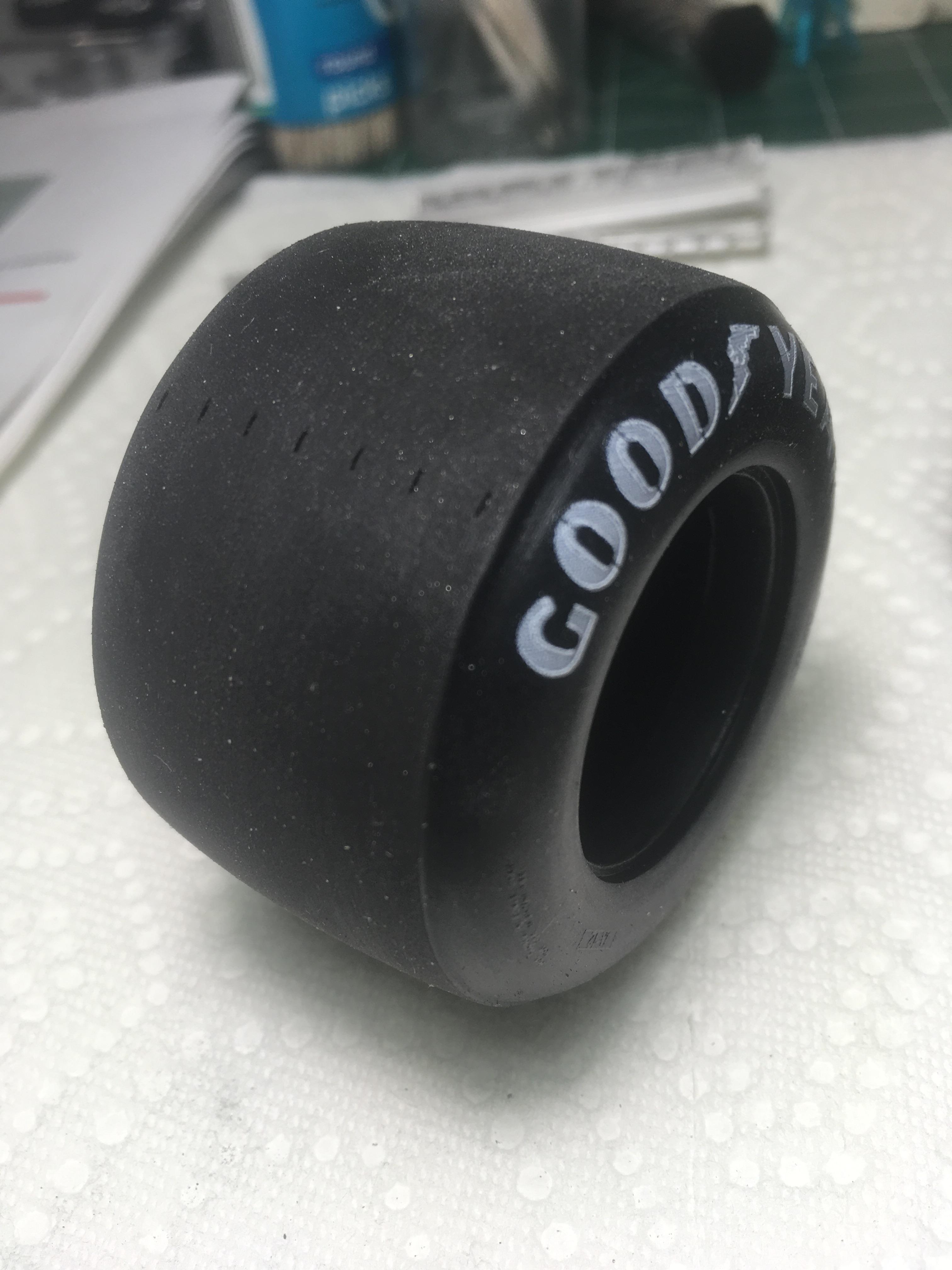

Brudda Posted August 5, 2020 Author Share Posted August 5, 2020 The tires are really good in a mfh kit Quote Link to comment Share on other sites More sharing options...

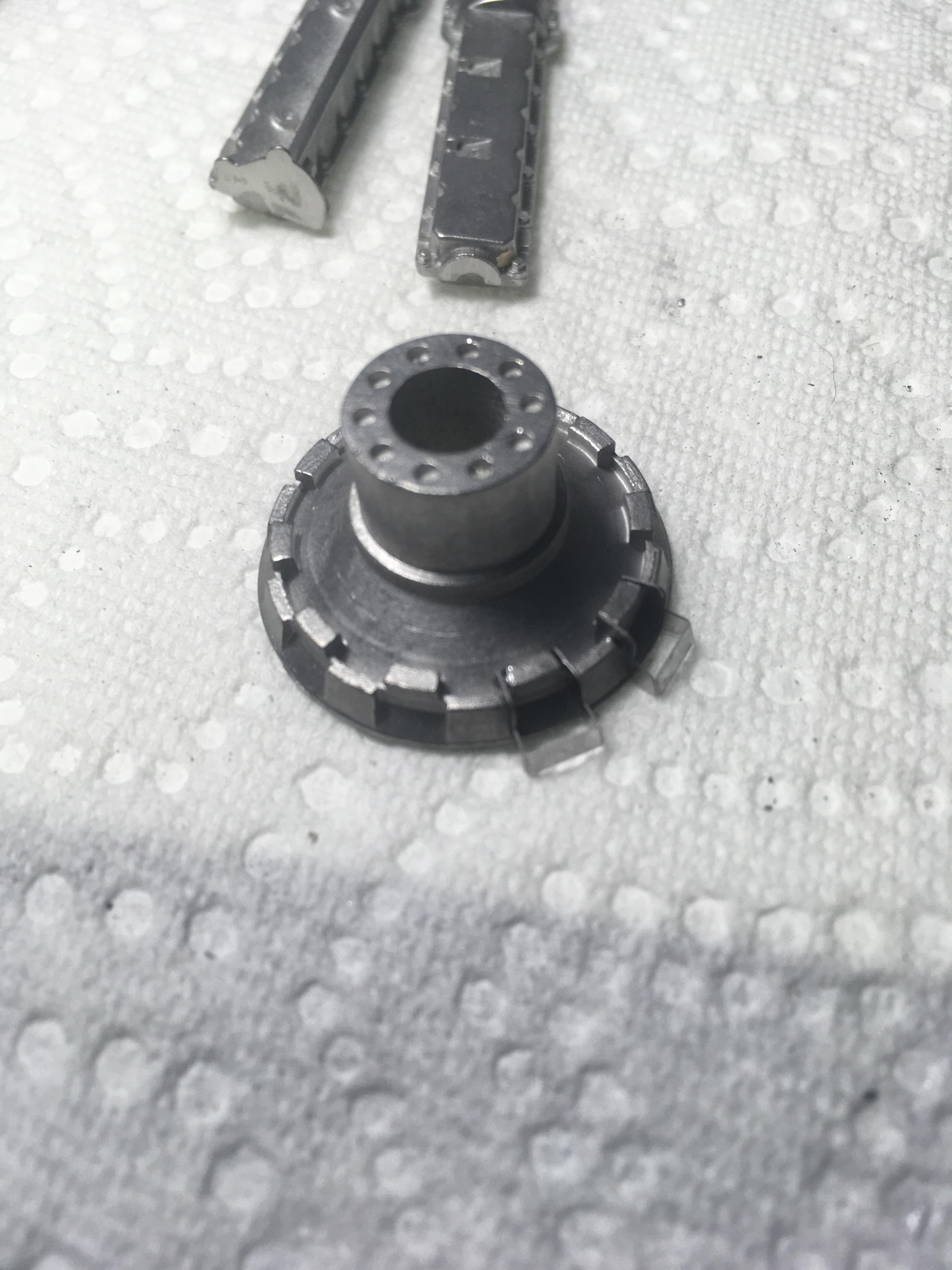

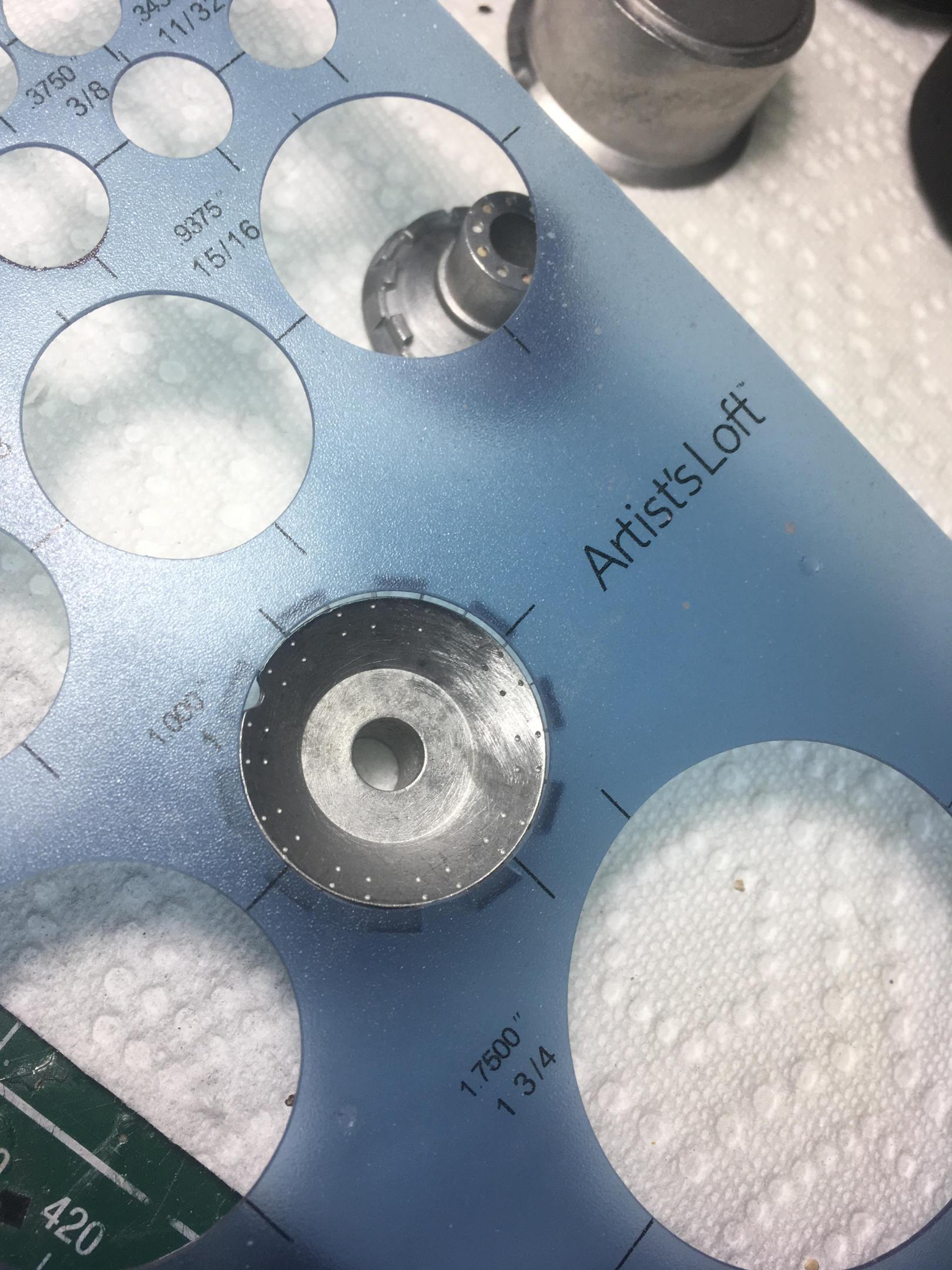

Brudda Posted August 7, 2020 Author Share Posted August 7, 2020 The fins on the wheels. This will take awhile. Quote Link to comment Share on other sites More sharing options...

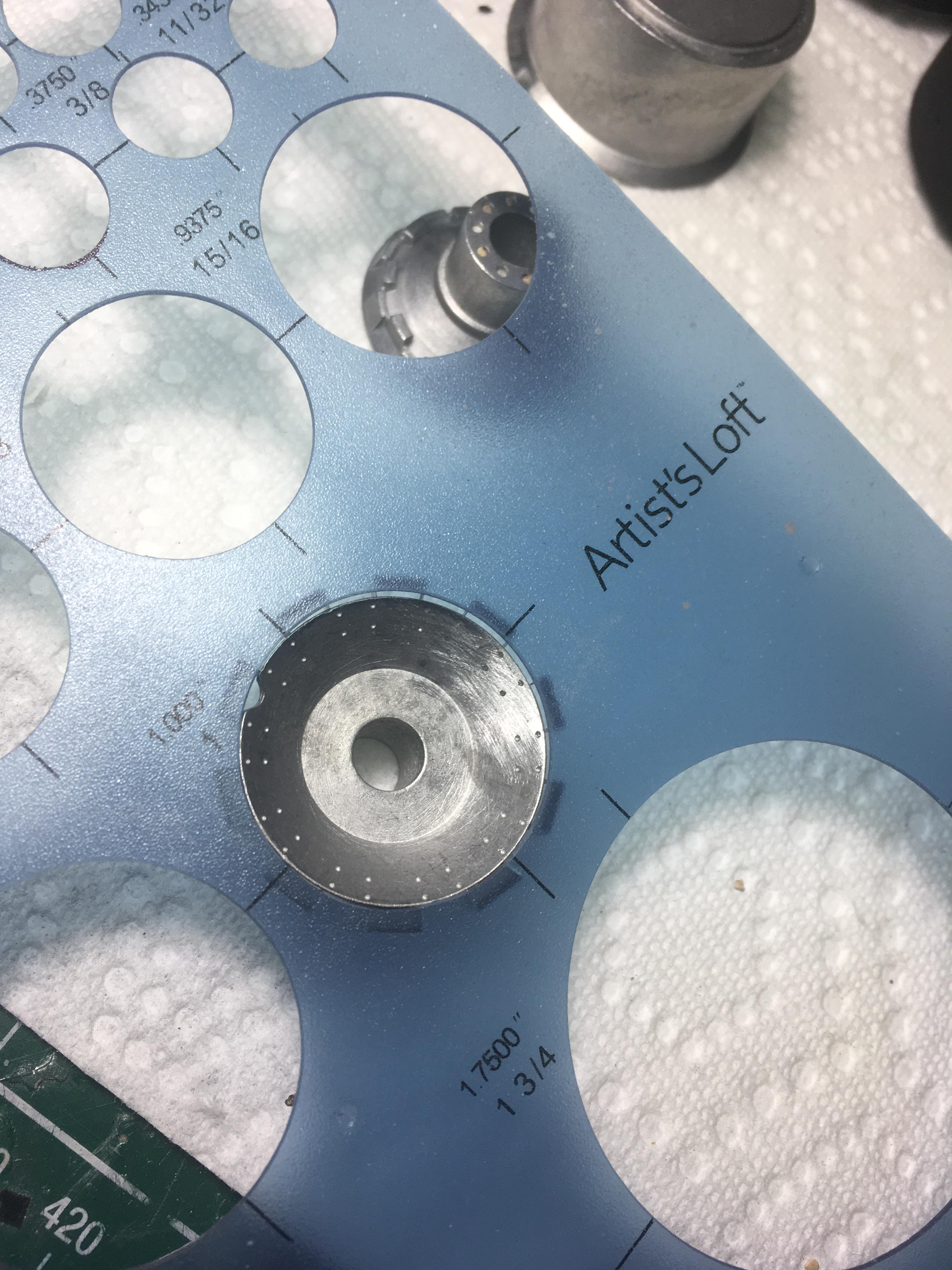

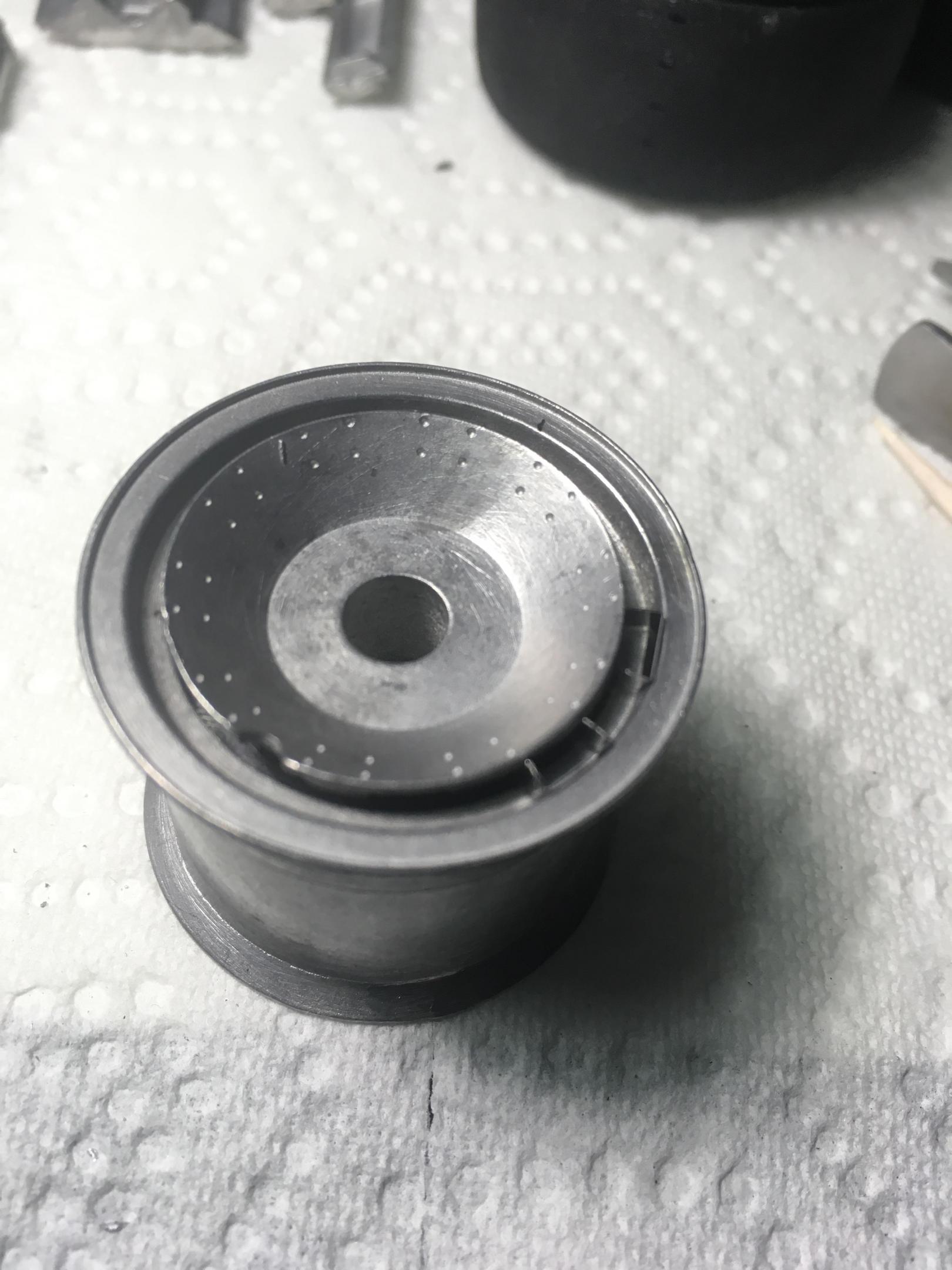

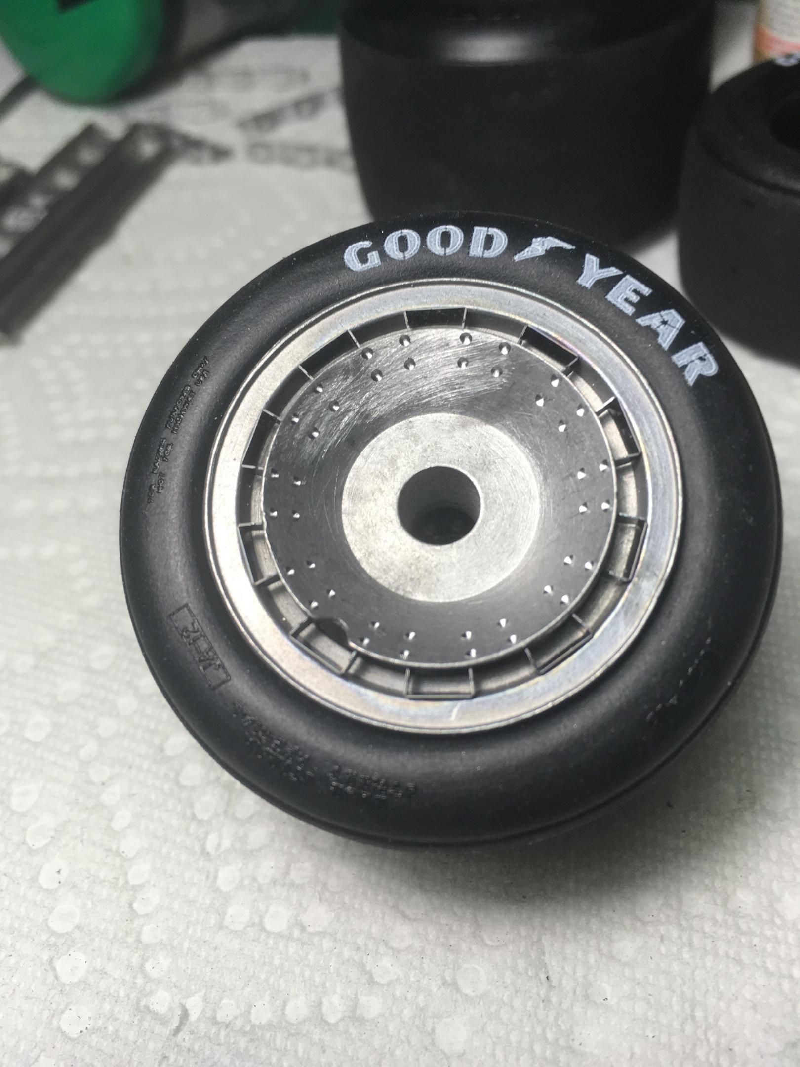

Brudda Posted August 7, 2020 Author Share Posted August 7, 2020 Drilled the dimples. Prime then paint yellow then blue , then clear. Then redrill dimples. A lot of work but the wheels and tires will look good. Quote Link to comment Share on other sites More sharing options...

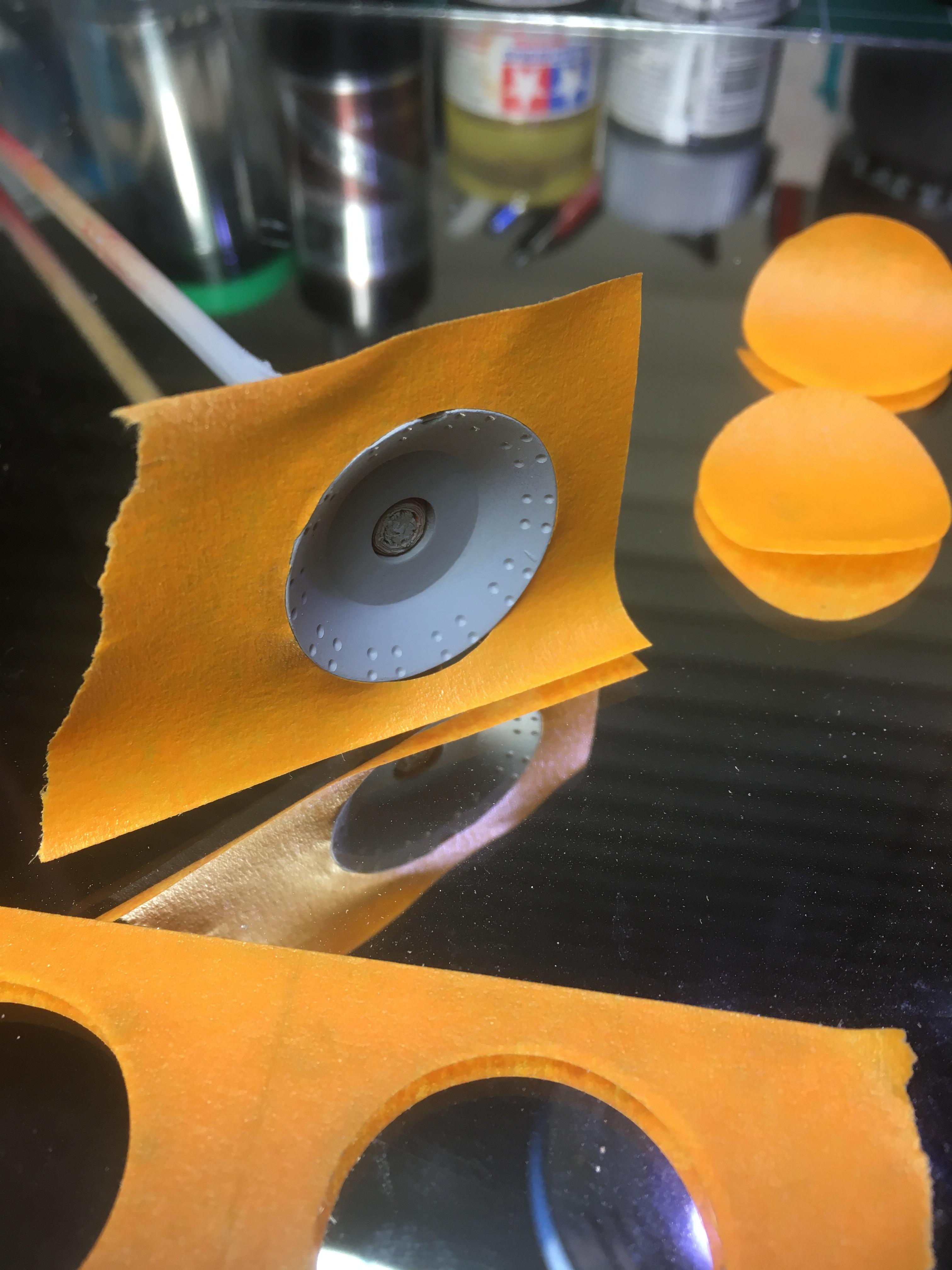

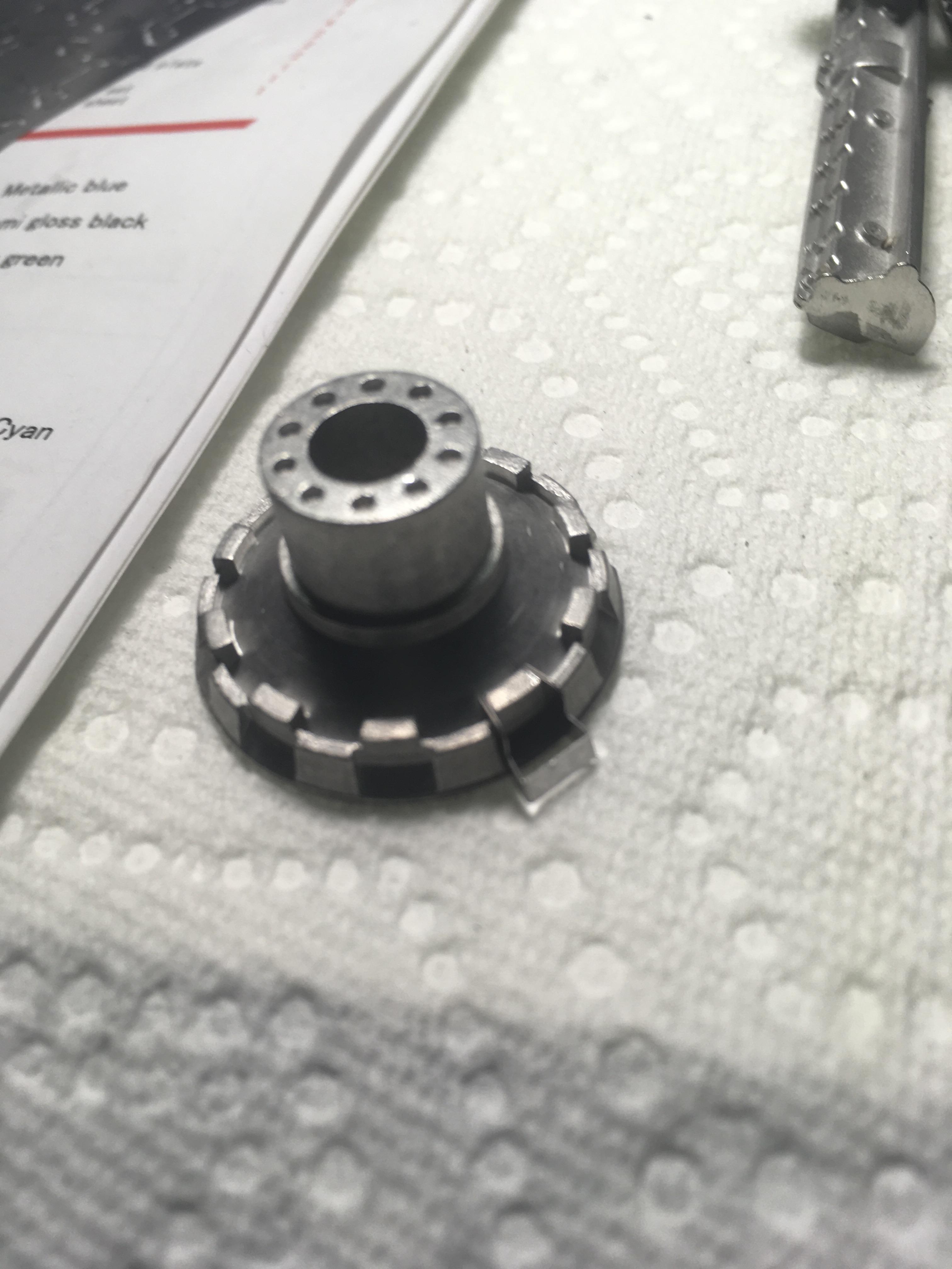

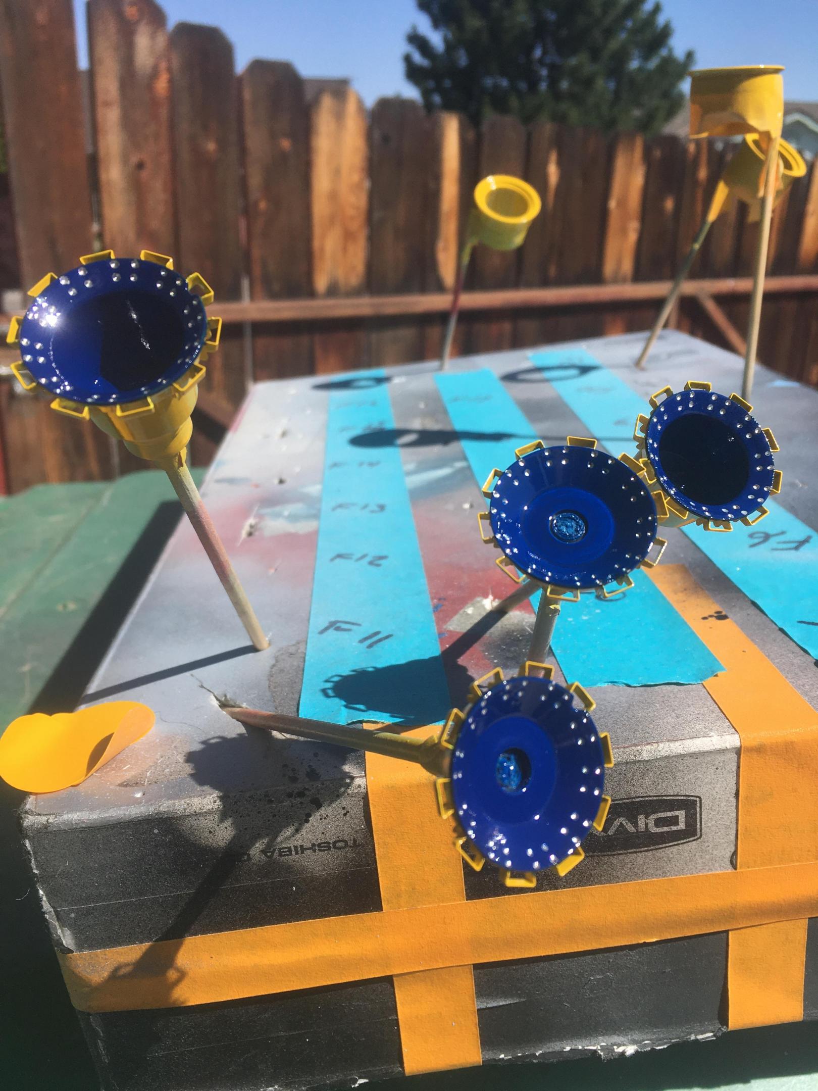

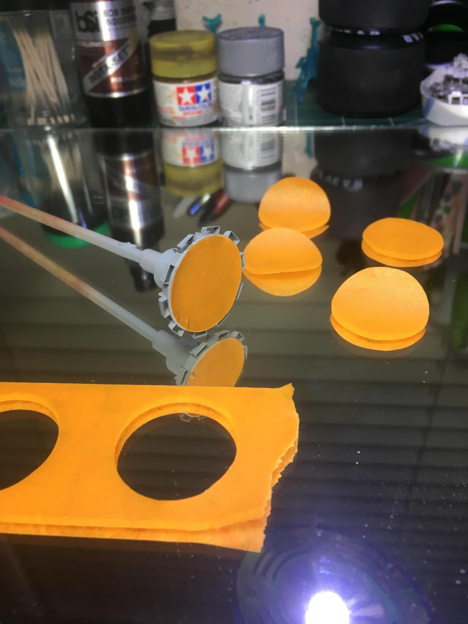

Brudda Posted August 8, 2020 Author Share Posted August 8, 2020 Hello Chris. Here is how I mask the yellow and blue on the wheel. At least in theory. We will find out soon , to see if it works. First time I have used zero paints. Hope it works. The primer I use on white metal. It’s a little expensive but it sticks. You still need to put the white metal in a tumbler to get the release agent off the parts. Quote Link to comment Share on other sites More sharing options...
Funkychiken Posted August 8, 2020 Share Posted August 8, 2020 This is going to be a long journey, I will follow along for the roller coaster ride, hopeful of more ups, than downs. It's great progress so far! I guess the tumbler is like a surface etcher? Quote Link to comment Share on other sites More sharing options...

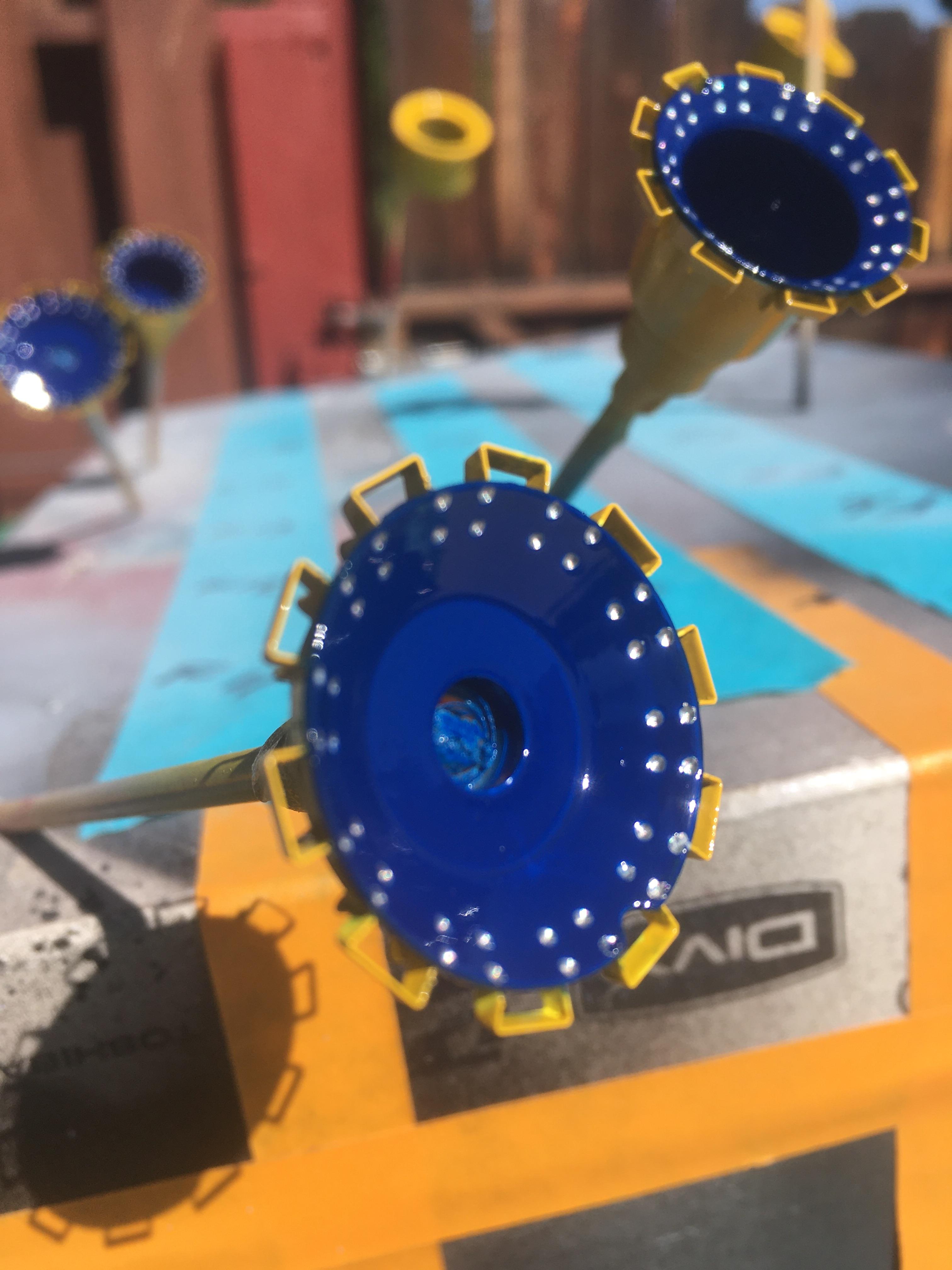

Brudda Posted August 8, 2020 Author Share Posted August 8, 2020 Hello Funkychicken, yes the tumbler lightly sands the part. If you leave the part in the tumbler for awhile, the part will be polished. . Painted the wheels. They will get clear this afternoon I hope. And yes a long journey sir. Quote Link to comment Share on other sites More sharing options...
Brudda Posted August 8, 2020 Author Share Posted August 8, 2020 They look like flowers. Had to clear them. Quote Link to comment Share on other sites More sharing options...

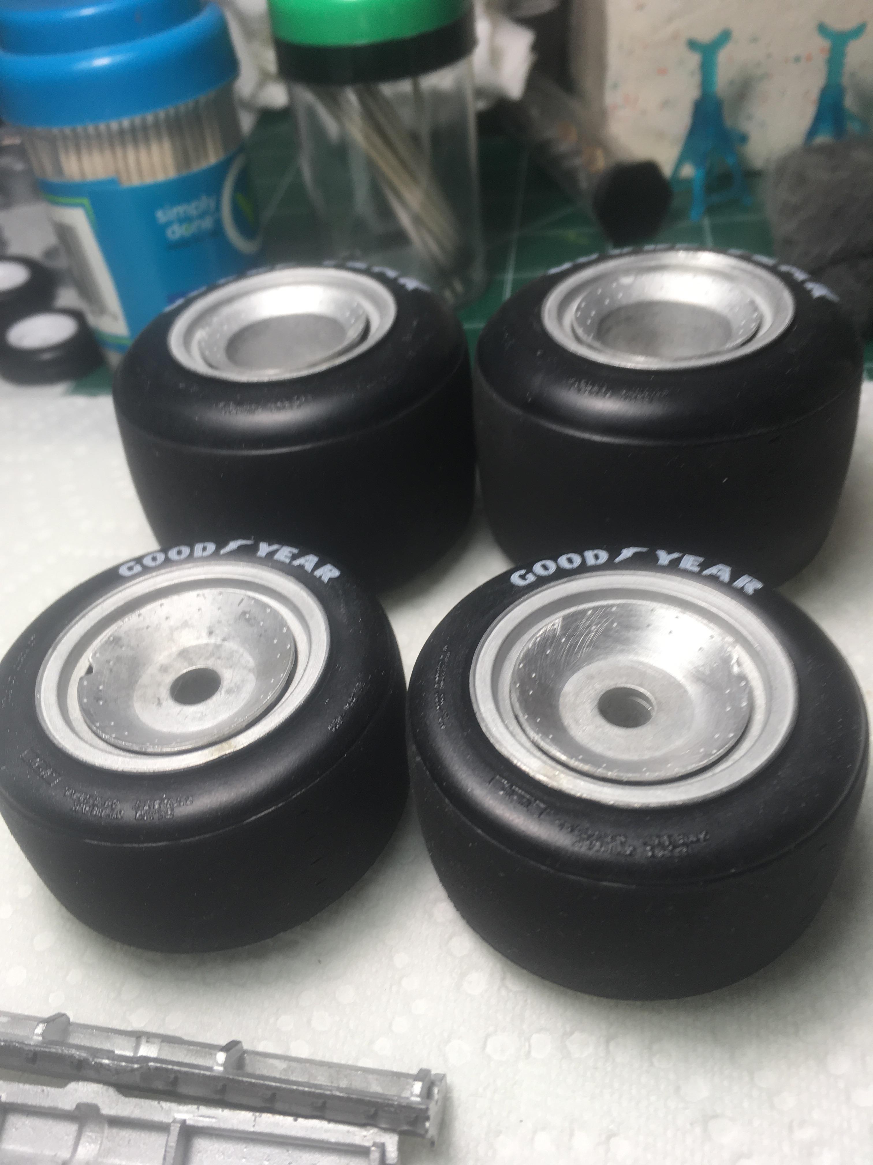

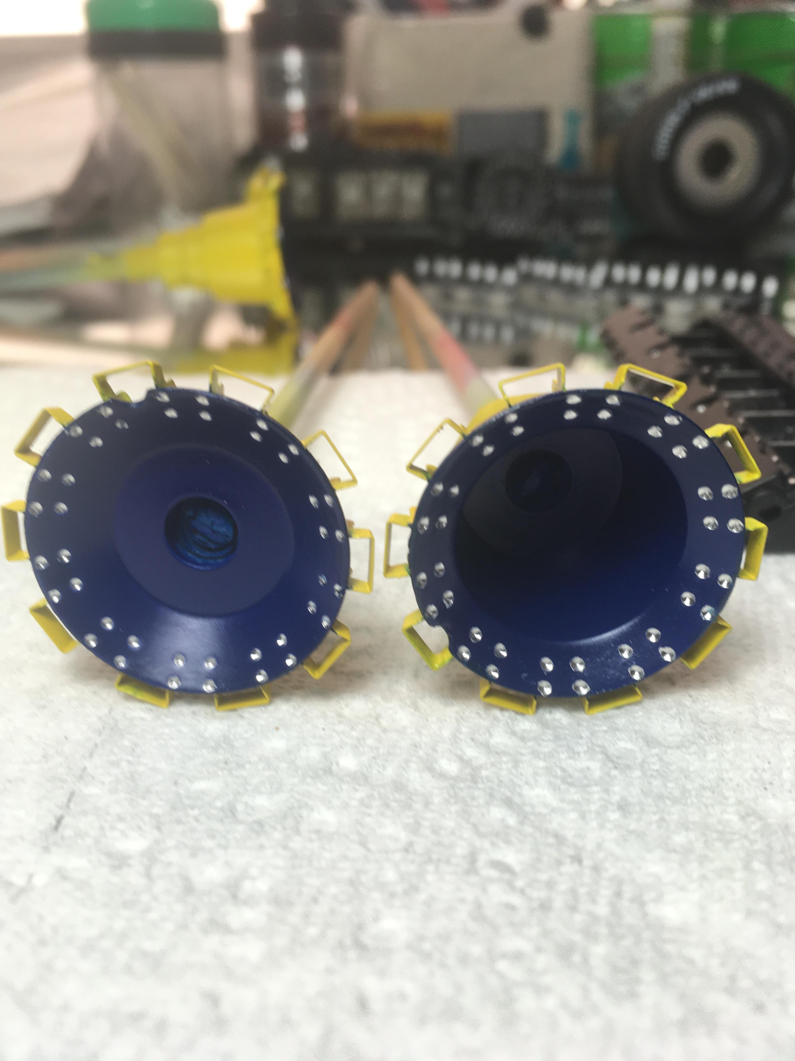

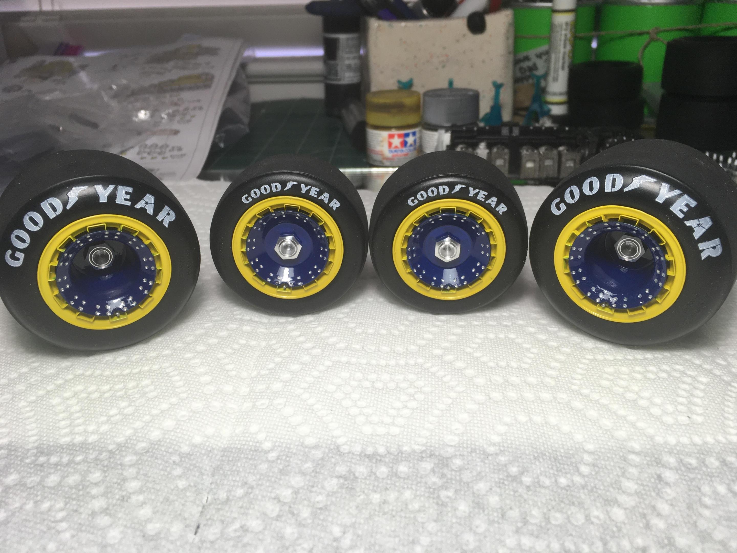

Brudda Posted August 8, 2020 Author Share Posted August 8, 2020 Thank you absmiami. Here are the assembled tires and wheels. I am very happy with the results. I usually like to paint the body first then tires and wheels. But with these mfh kits you have to go with the flow of the build. The Ferrari P4 frame seemed to always move around. So you had to modify the body. So you could not paint because of the mods. This build has a tub center section. Should keep it from moving around. I hope. Quote Link to comment Share on other sites More sharing options...

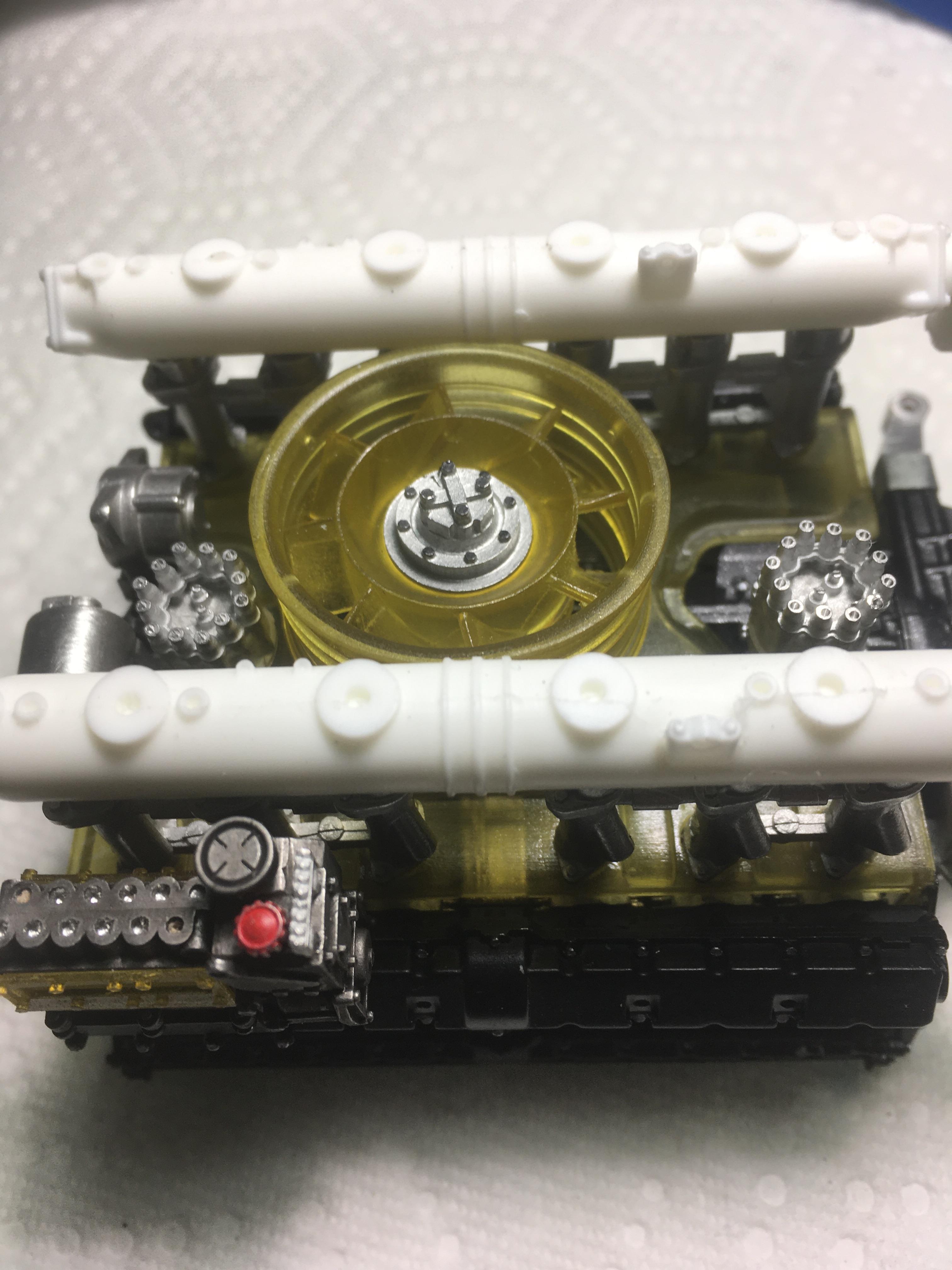

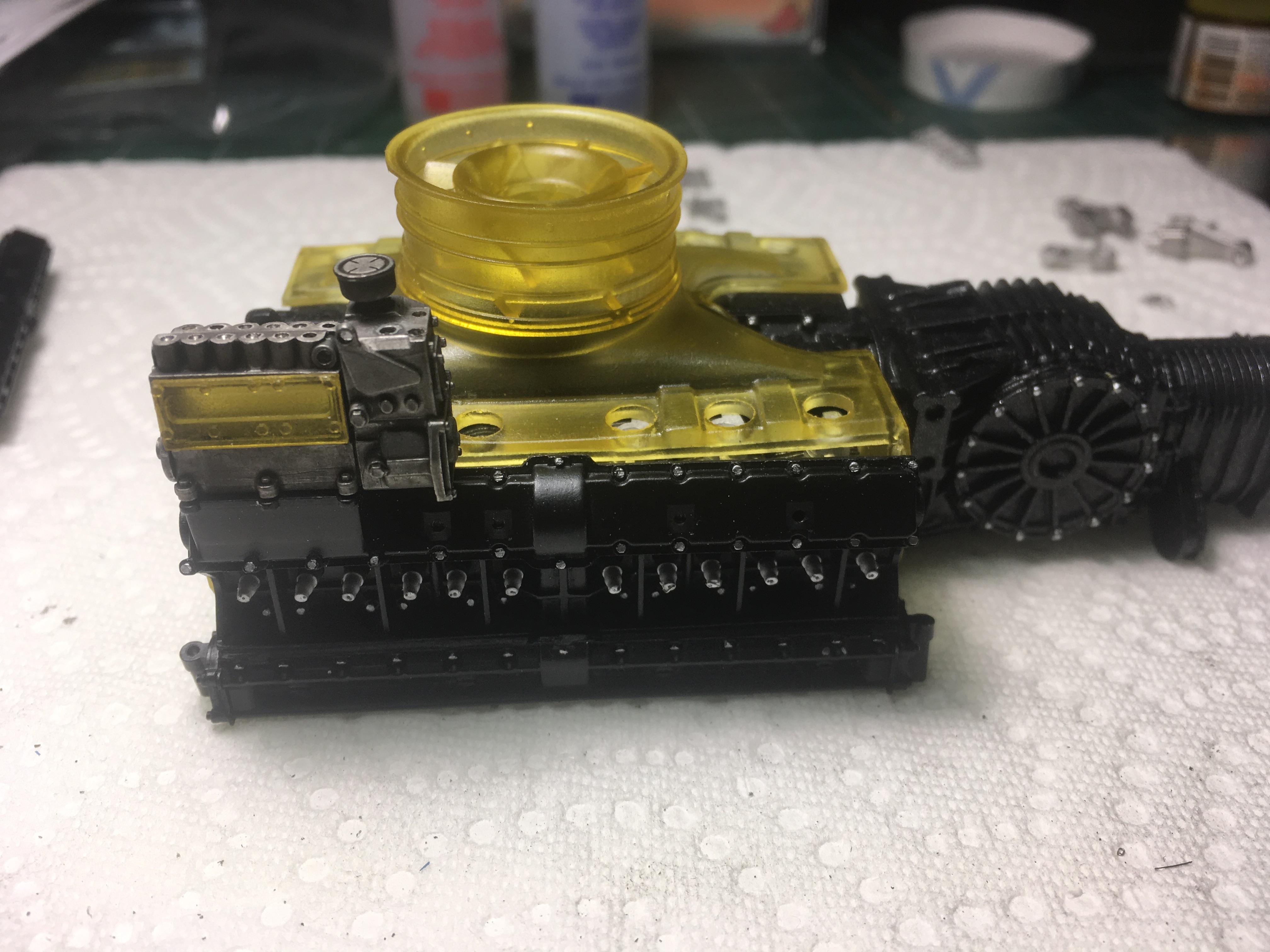

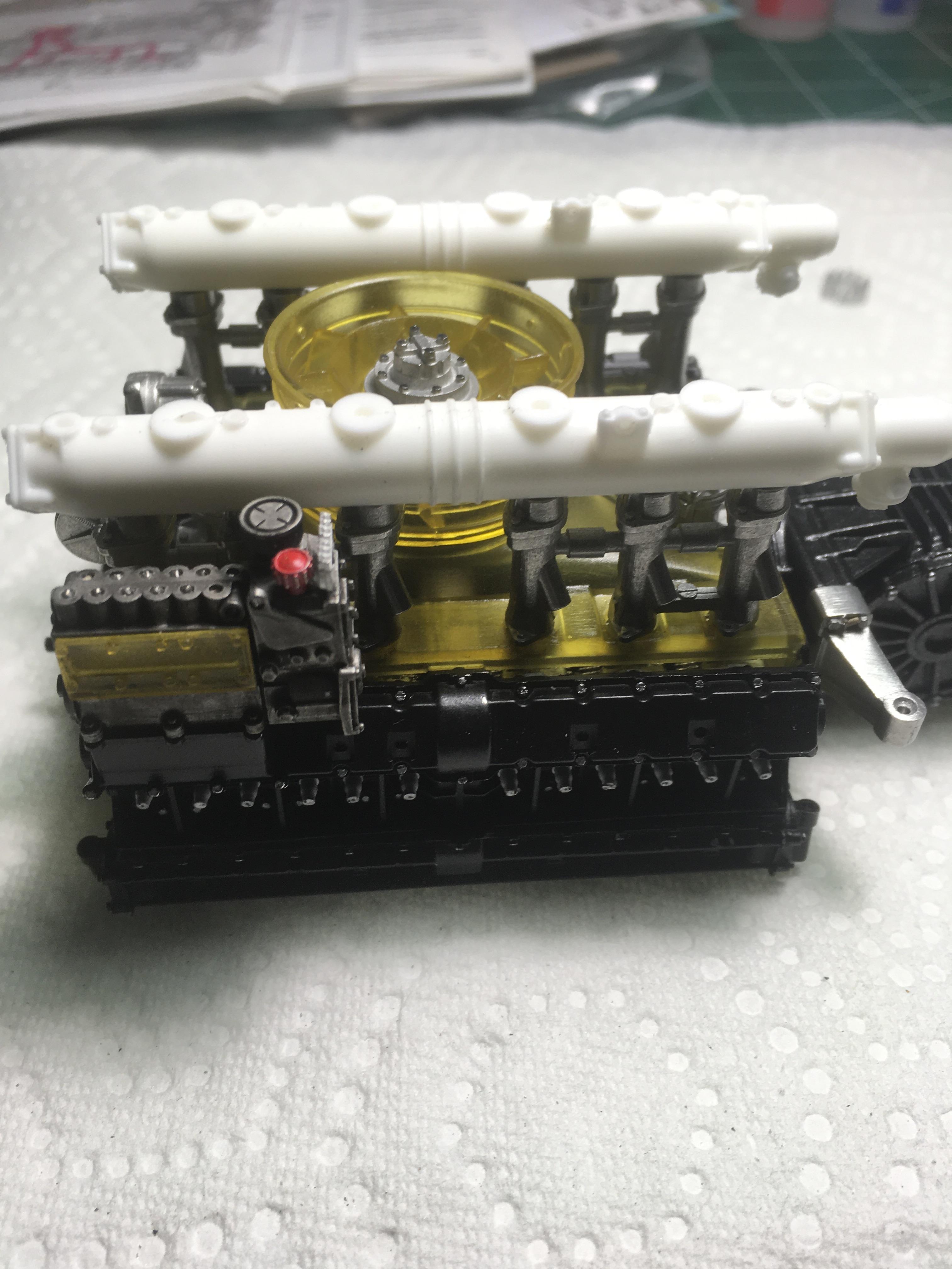

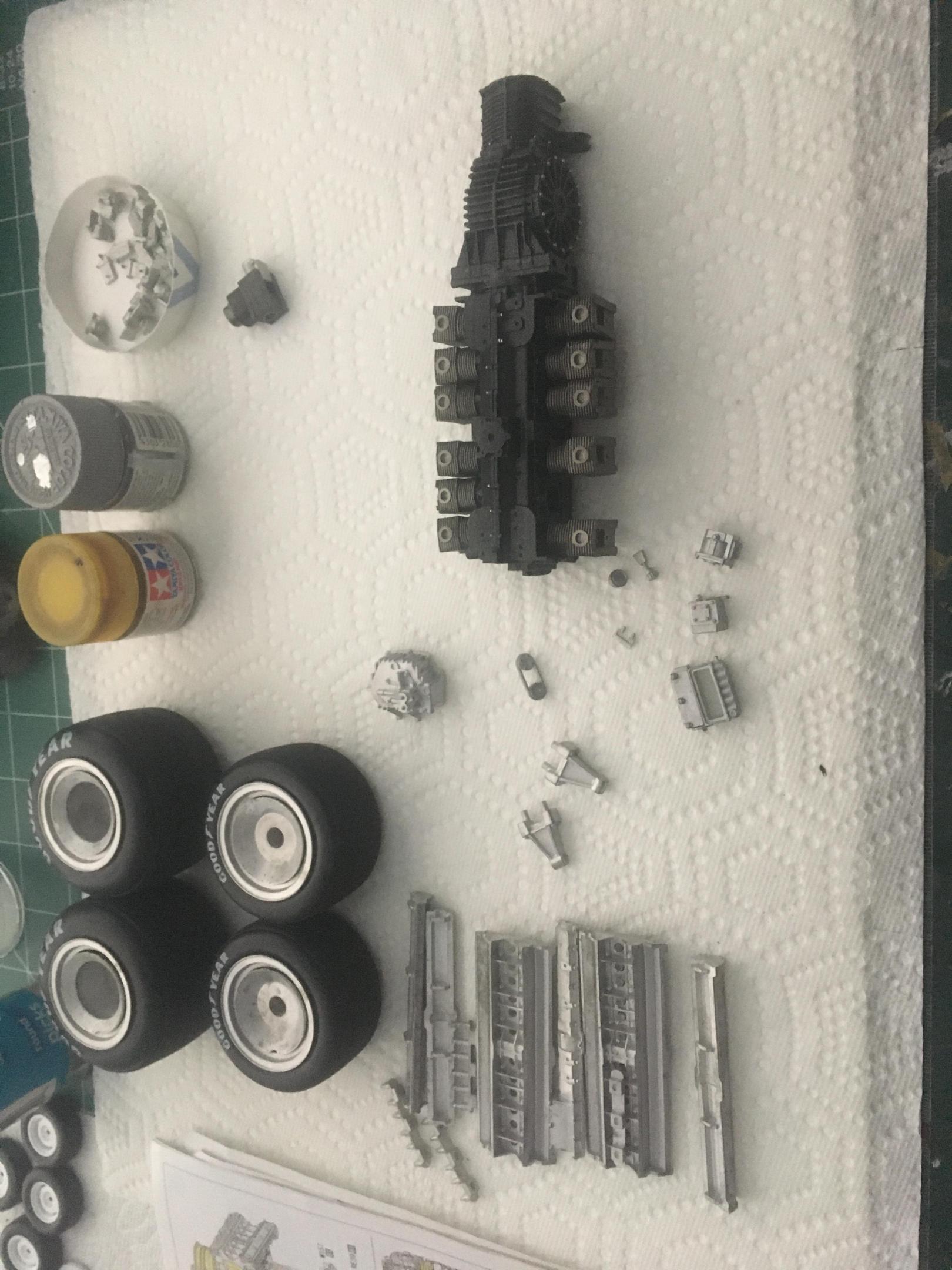

Brudda Posted August 17, 2020 Author Share Posted August 17, 2020 Starting on the motor. Not real fancy. The real motor was mostly black. Quote Link to comment Share on other sites More sharing options...

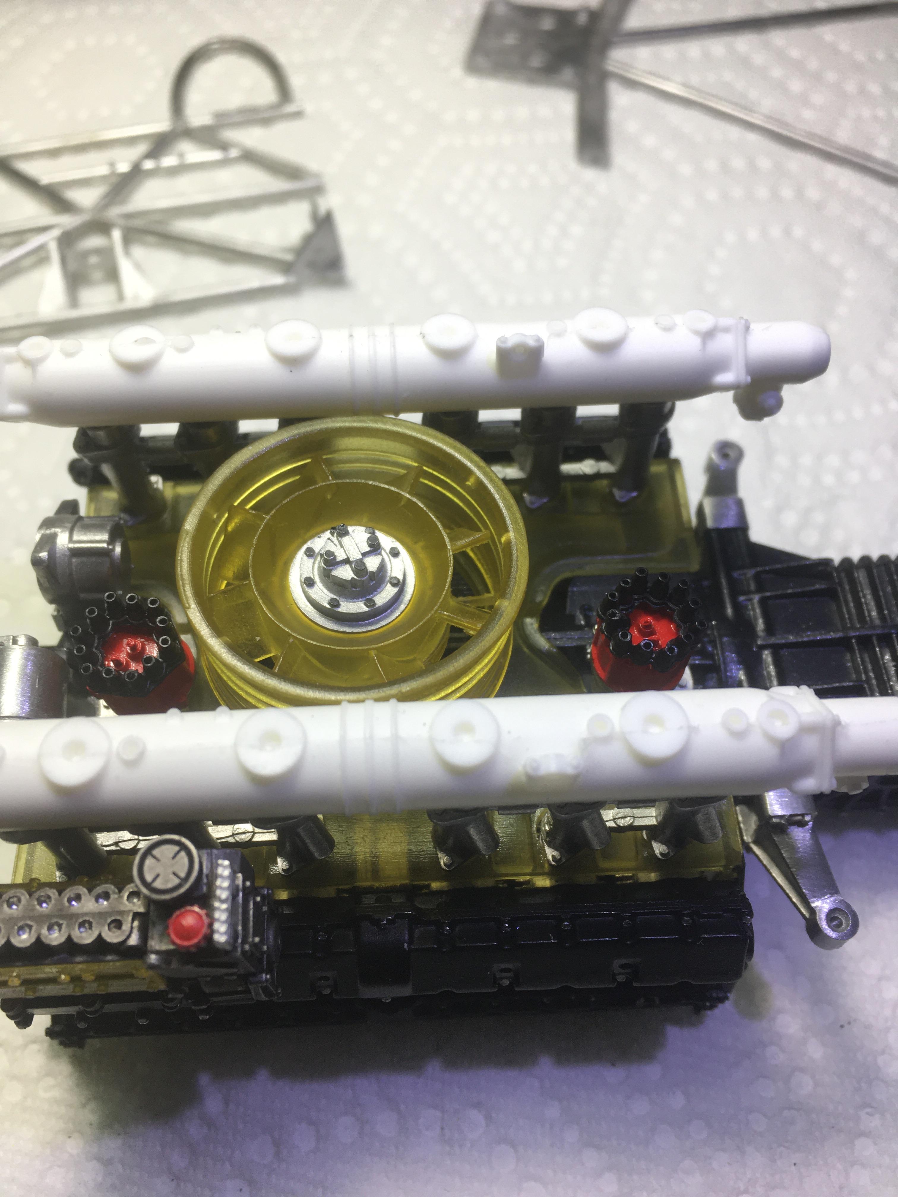

Brudda Posted August 22, 2020 Author Share Posted August 22, 2020 Mocking up some more parts. Just making sure things line up. Chris is right, you need to look at least 5 steps ahead on these kits. Quote Link to comment Share on other sites More sharing options...
