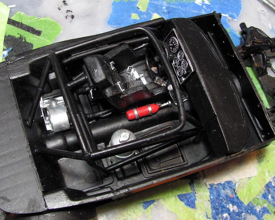

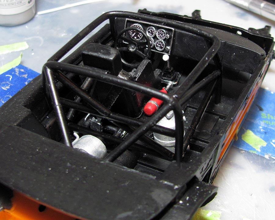

1 hour ago, Pierre Rivard said:
Superb interior detailing!

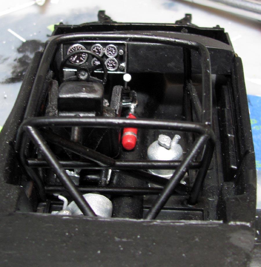

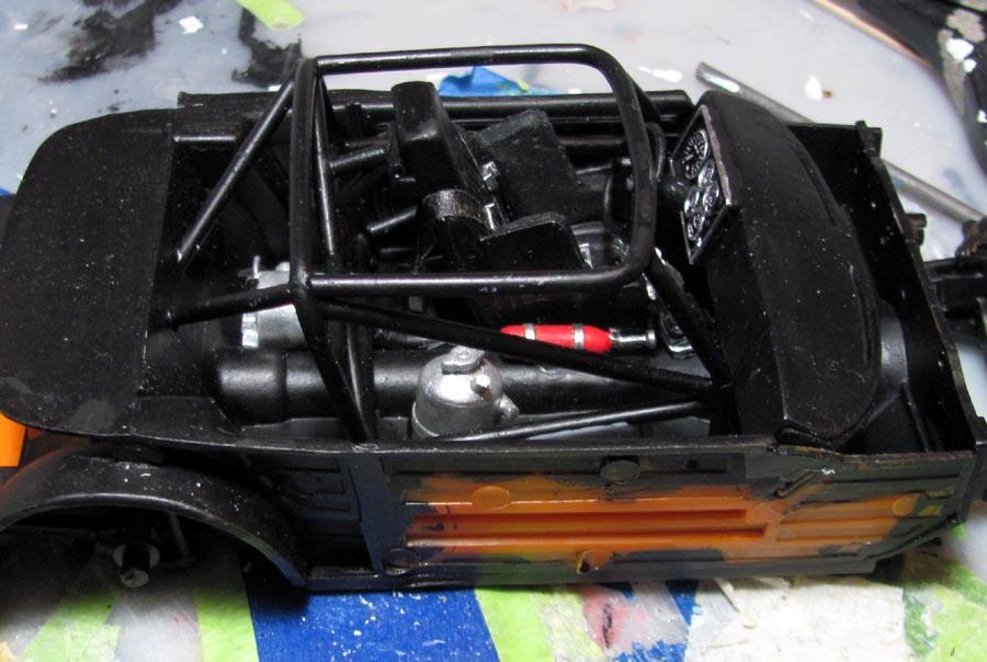

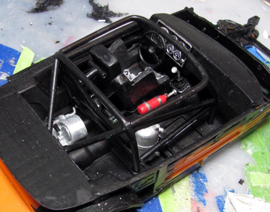

Thanks, Pierre. I know the cage looks funny but that's the way the real car was built. Go figure

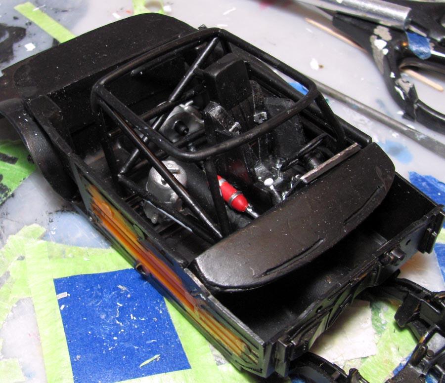

I'm finally at the put the model together stage, so no more wip pictures. the next picture you will see, will be a finished photo and a link to the rest of them.
Almost finished. Just have to finish the rear axle oil pump. Install the taillight lenses. Install the left front headlight pod. Install the grille. Install the front bumper and air dam. Install the rear bumper. install the back glass straps. Decal the model and then future the model.

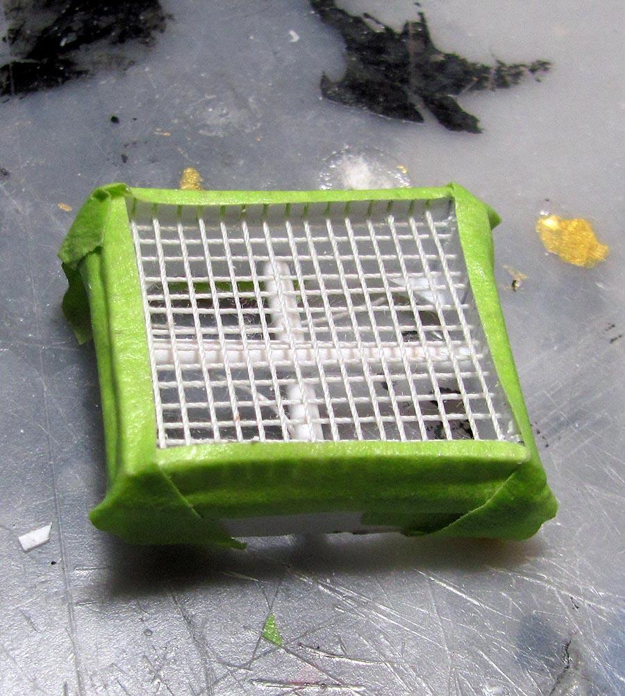

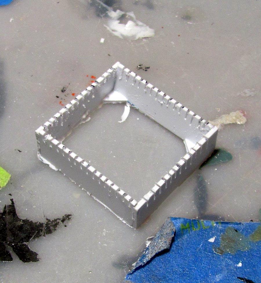

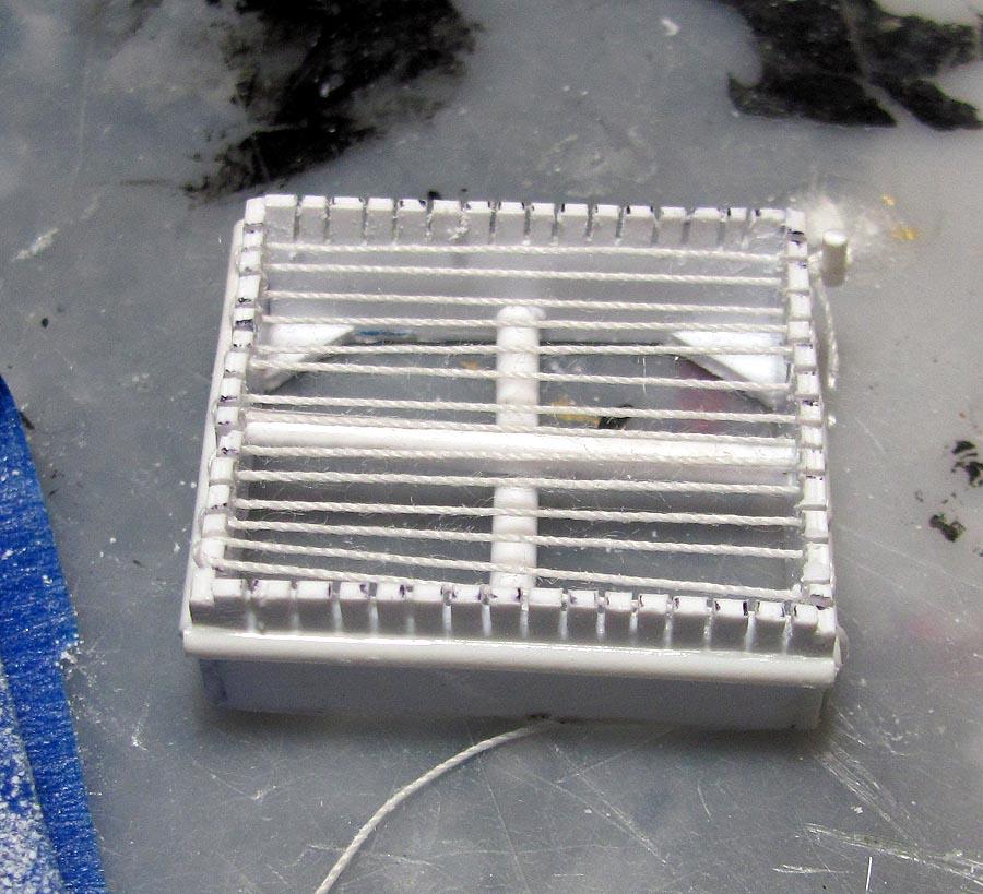

Thanks, Pierre. I thought I would be finished with the build part today, but I'm not pleased with the window net I made and will make a new jig to create another one. So hopefully tomorrow I can decal it.

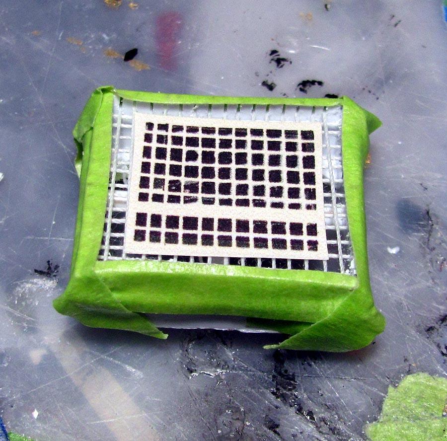

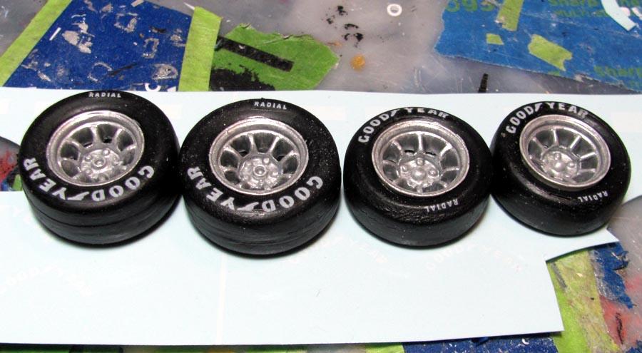

I know I said no more wip pictures, but I wanted to share the finished tire/wheel assemblies and the loom I made to make the window net. I borrowed Drew Hierwaters  creation from an article he wrote for Scale Auto Magazine. I added a few features to mine to stiffen it up.  This rope type net was used in the seventies.

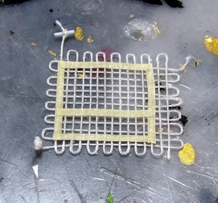

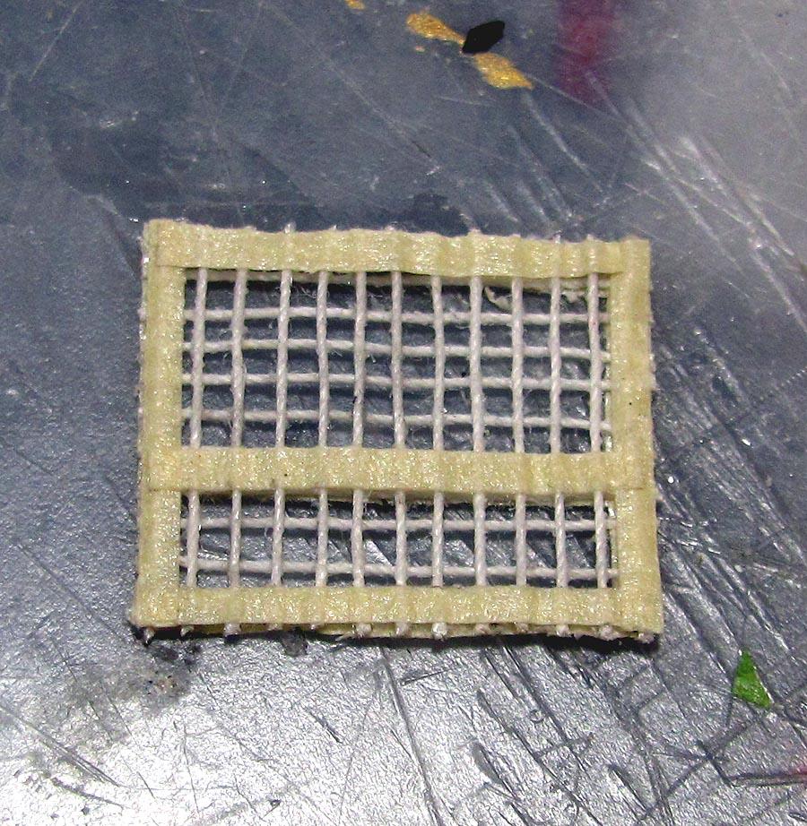

I should have explained, that is a printed-out paper version of the real size of the window net, scaled down from a photo of the real net in the car I am building. The loom is an inch tall and wide, and the scale size of the net is about 3/4 of an inch tall and wide. The borders are 1/16 an inch tape I will cut out from some tan masking tape and then paint with white vallejo acrylic primer and paint. I coated the net with elmers glue to get all the threads to adhere to each other. Makes the net stiff and flat but it would fall apart when I take it out of the loom if I didn't. I was thinking about weaving it so to speak using a needle, but the loom is so small that would be impossible for me. Maybe a young guy with an enormous amount of finger dexterity could get it done.
Wheels and tires plus the window net are impressive, Mark!  Are those the wheels you made? Been a long journey. Looking forward to the under glass pictures..

Thanks, Carl. Yes, those are the wheels I made. I couldn't find any minilites that looked like these in the aftermarket. Too bad P.P.P. doesn't offer them. I started on the decaling yesterday, so it shouldn't be too much longer.

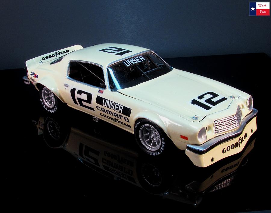

I can't believe it's finally finished. More pictures are at the under glass for other road racing here, under Bobby Unser and also at Randy Ayres Showroom
