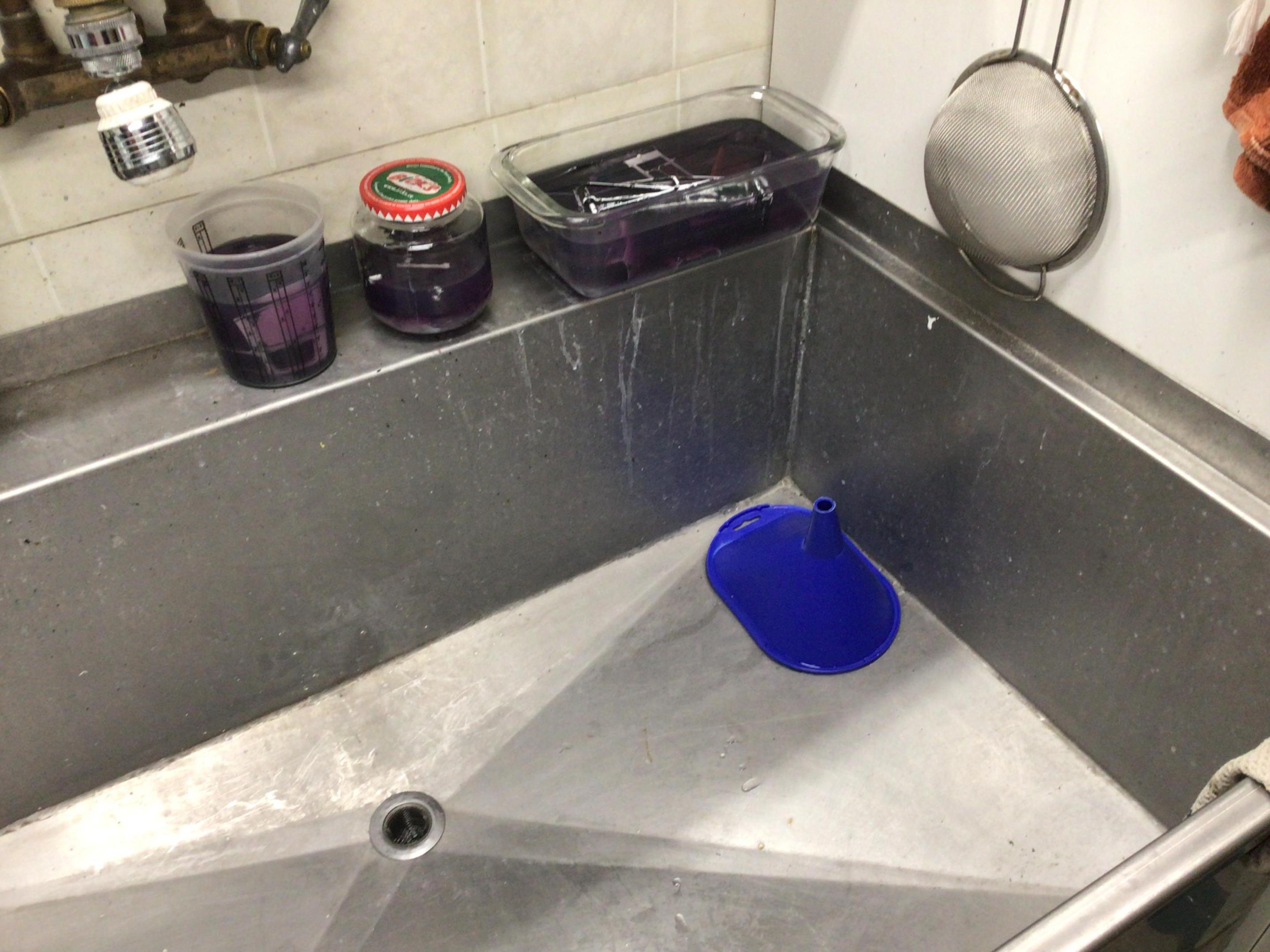

Thanks Andy. I’ve got that peril covered. Tiny loose parts go in the relish jar and when I figure it’s been long enough, it gets poured through the strainer and back into the jug. Large parts get fished out of the casserole dish when ready and scrubbed with a stiff brush. Liquid gets strained into the jug again just in case. There is a fine screen in the sink also that catches most of the paint and any small parts that might fall off while scrubbing.
Edited by NOBLNG
