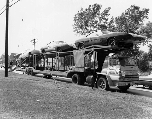

Bob,
Are you thinking a "working" vocational car hauler like this? With or without a car over the cab?
 See the source image
Or a single car, more recreational flat bed or ramp truck type hauler?
Edited by Muncie
Thanks for the suggestions. I’m thinking of a ramp type hauler. To get her a low as I’d like I think I’ll have to make some major wheel well modifications and also some body adjustments to accommodate the new wheel wells.
