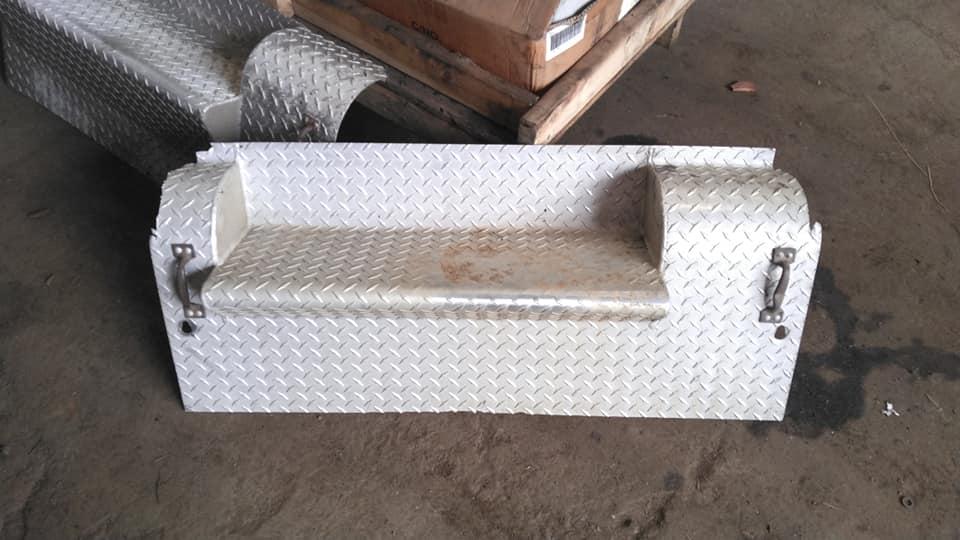

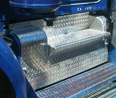

I would like to see these battery box/tool box covers with the off center steps for the W900, drivers side and passenger side are mirrored and both fits on either side so you can sometimes see the step more towards the front and some have it more towards the rear.
This to be able to do a correct replica of the Movin' On trucks from both seasons wich have these covers on all 4 trucks.
The battery/tool box covers available with a step are the ones from the Revell Germany W900 like the recently reissued W900 Dump Truck, the the step in those are slightly wider and centered.
1977-KENWORTH-W900A-Battery-Boxes-xZ4v6eN3NLWq_f.jpg.f80514a6d9807ad199572b66333074d9.jpg
1977-KENWORTH-W900A-Battery-Boxes-z4QJ5irHz7Lz_f.jpg.fc410fa8a3beae309e1e3282e6bda0d3.jpg
229724792_345626727109729_6324193313202211025_n.jpg.1855b3e9a184e5d2f287bfef60951eeb.jpg
230271457_345626777109724_2294894629501883506_n.jpg.1e09e9b7ab3ea26acc5d41dae02eb916.jpg
Does anyone have any dimensions of this box?  L, W H?

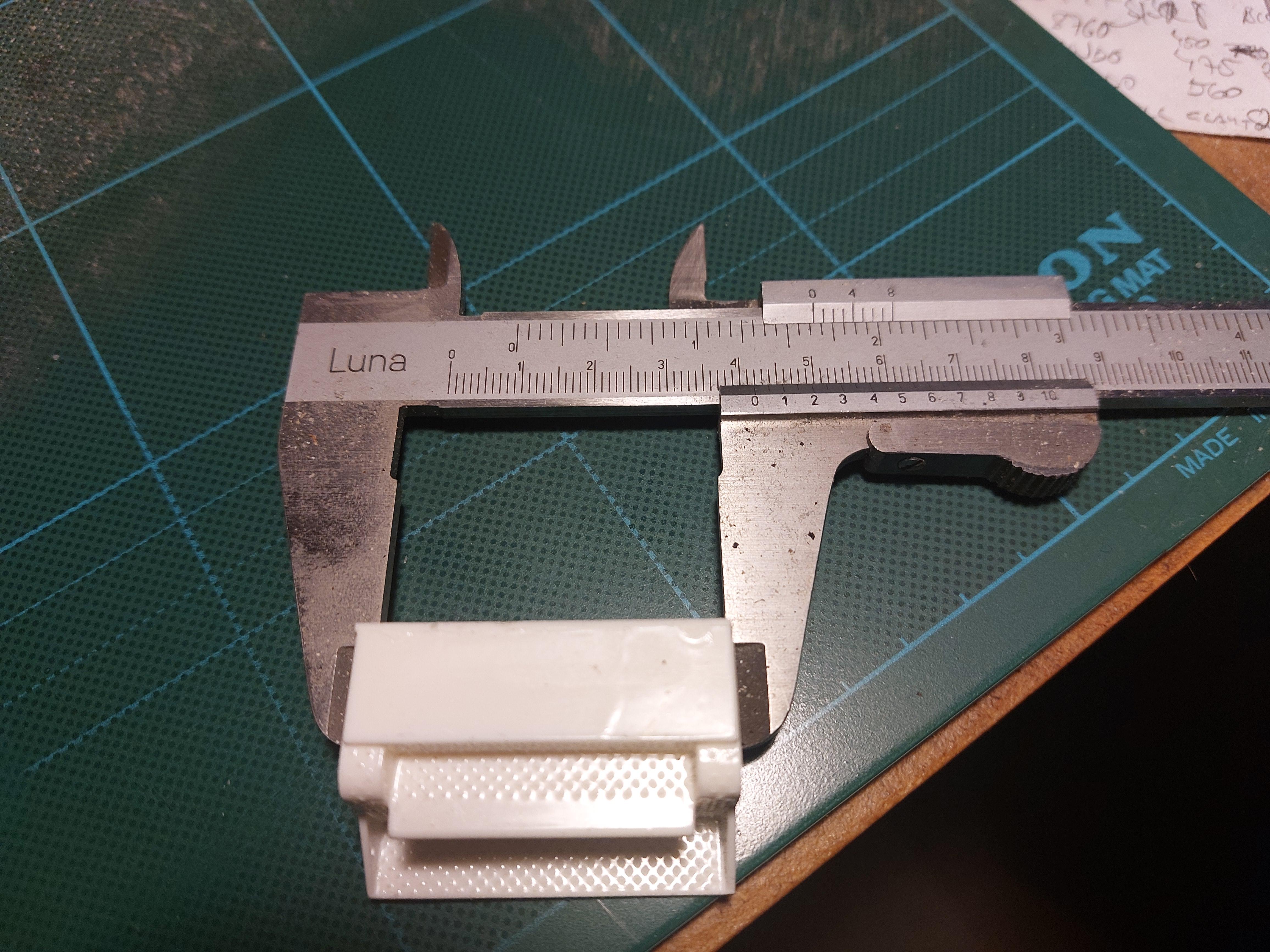

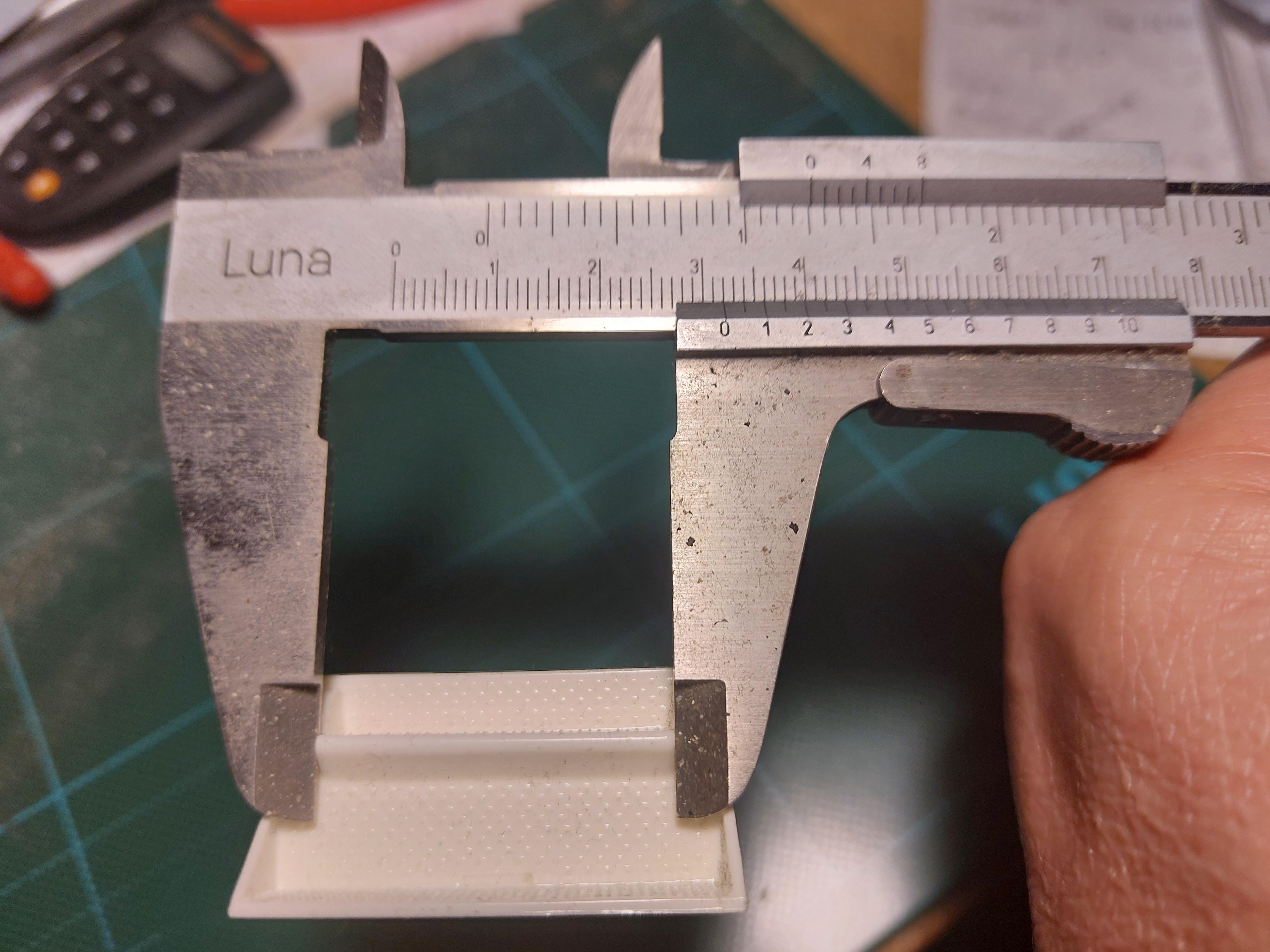

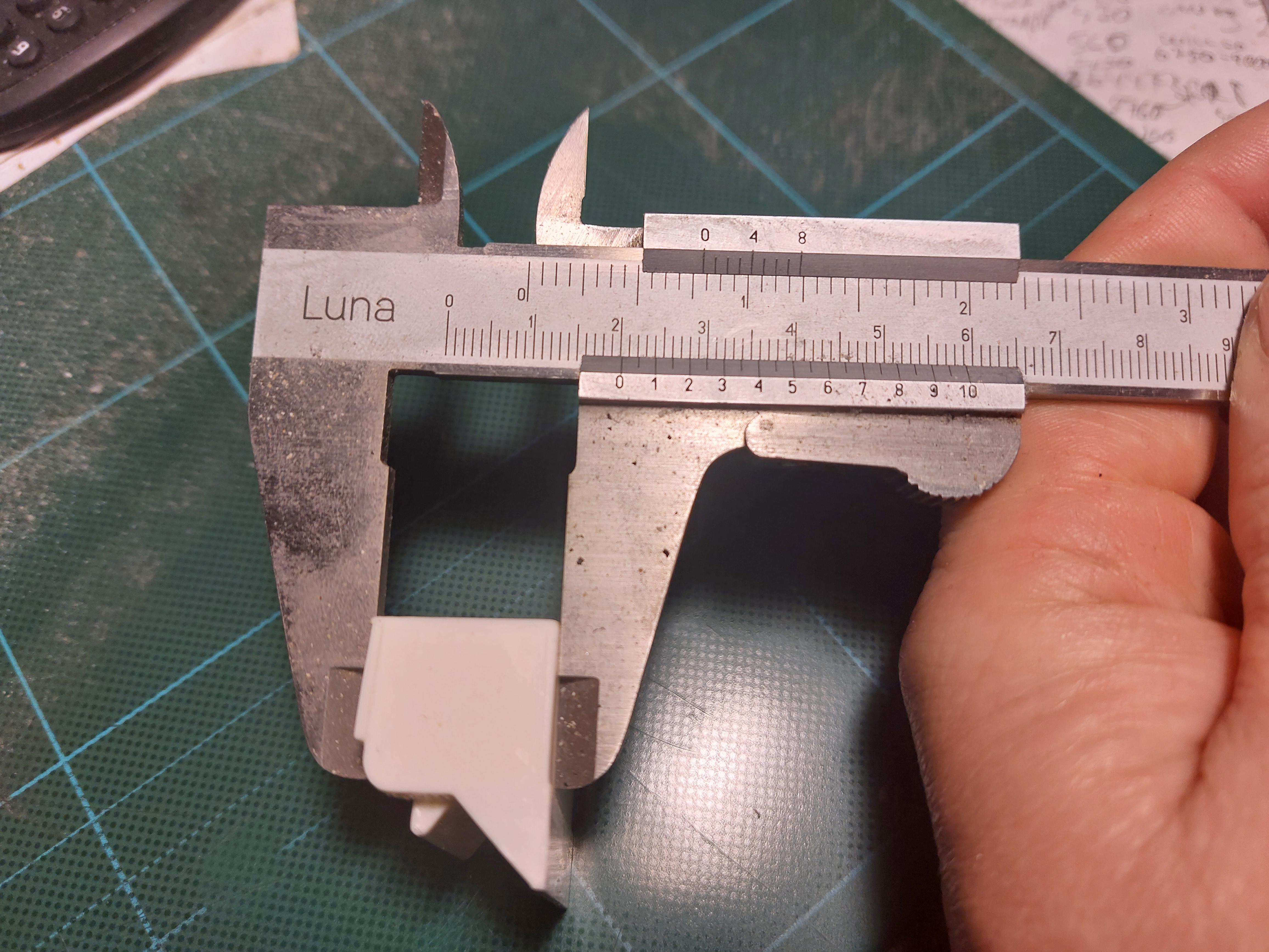

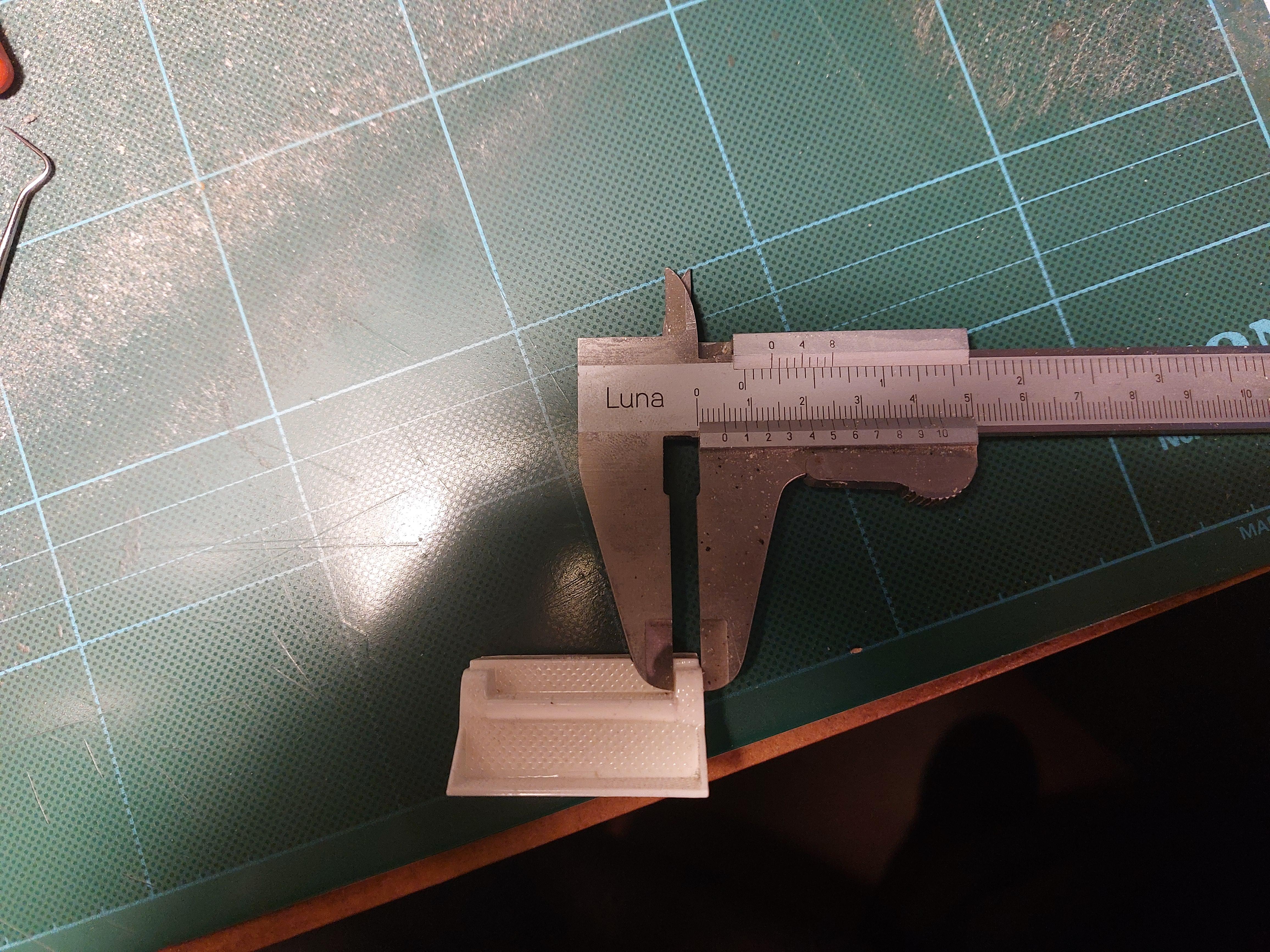

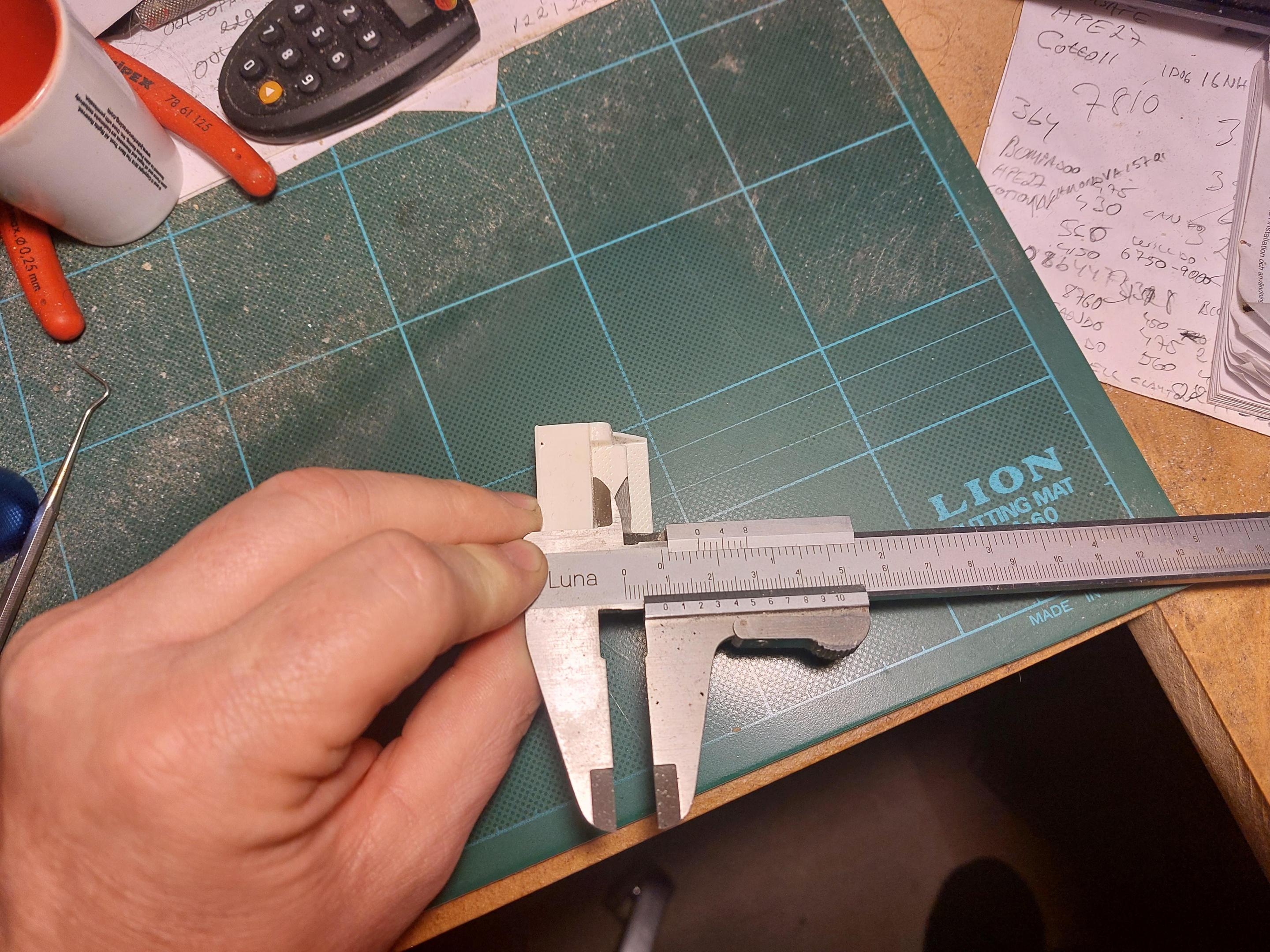

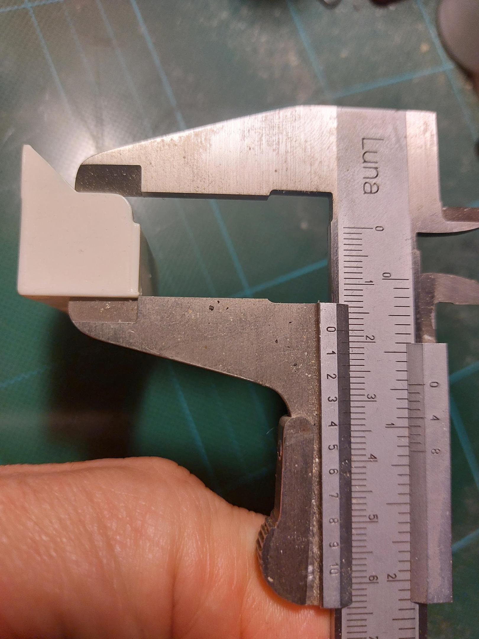

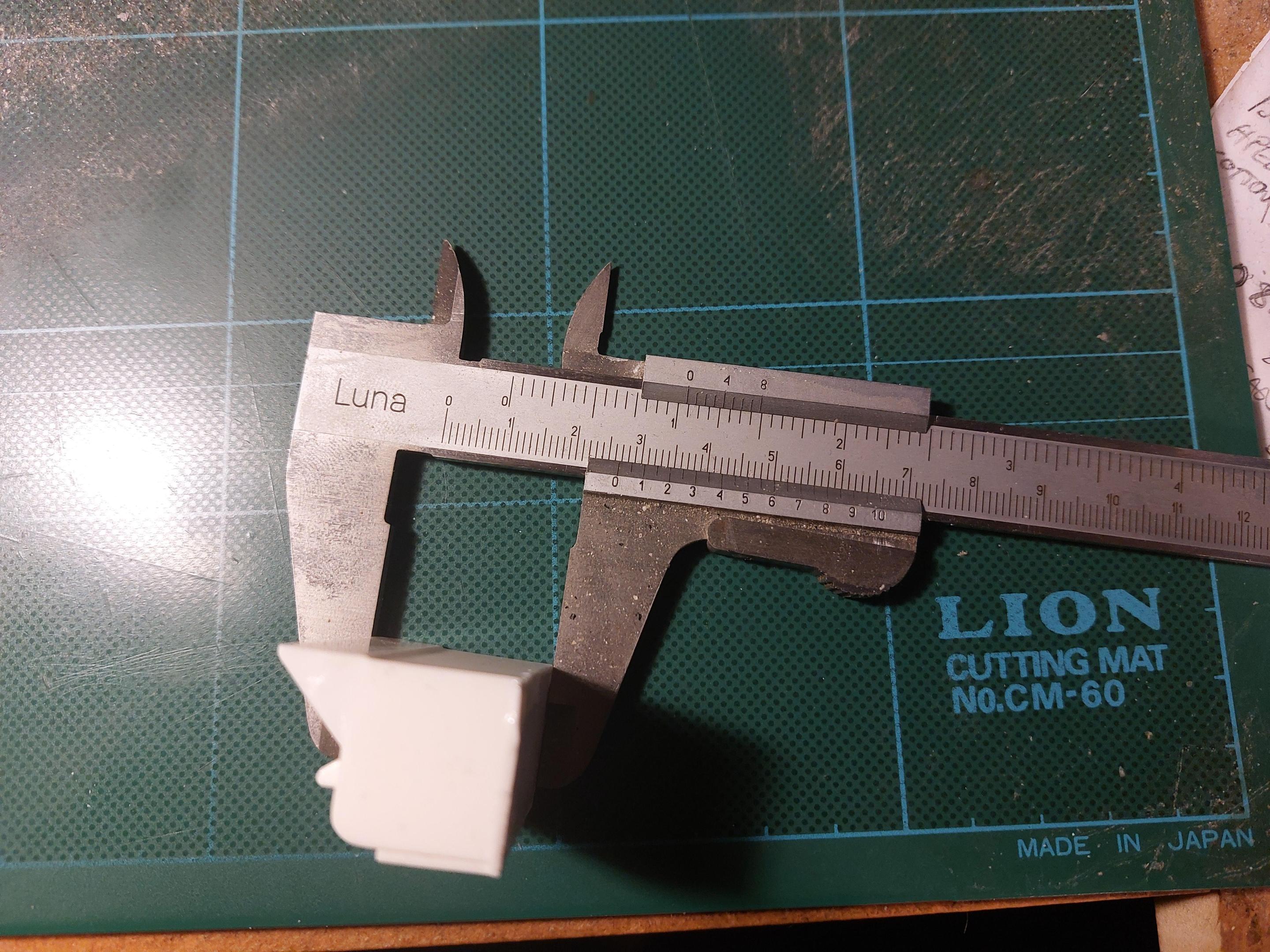

I don't have measures of a real box cover but I have a resin battery box that looks similar but not right as the step is longer and centered on this one and I took measures on that as it's the only thing I have.
On the real box cover I sent pictures on earlier the step a bit shorter and off center as you can see if you compare them.
Length:
Hight:
Width:
Steps:
The real one I sent picture of earlier the step is a bit shorter and off center so this is not right but I took measures of it anyway.
Depth:
This is for one side of the step on the box cover, the opposit side looks to be at least twice as wide or even more on the real box cover I sent pictures of earler and the step should be that much narrower.
So you need two boxes to do one truck, one for each side as they are mirrored, the wider bit is at the front and the narrow bit is at the rear on both boxes, or the other way around if one prefer to do it that way.
I hope this helps.
Edited by Force
Link to comment

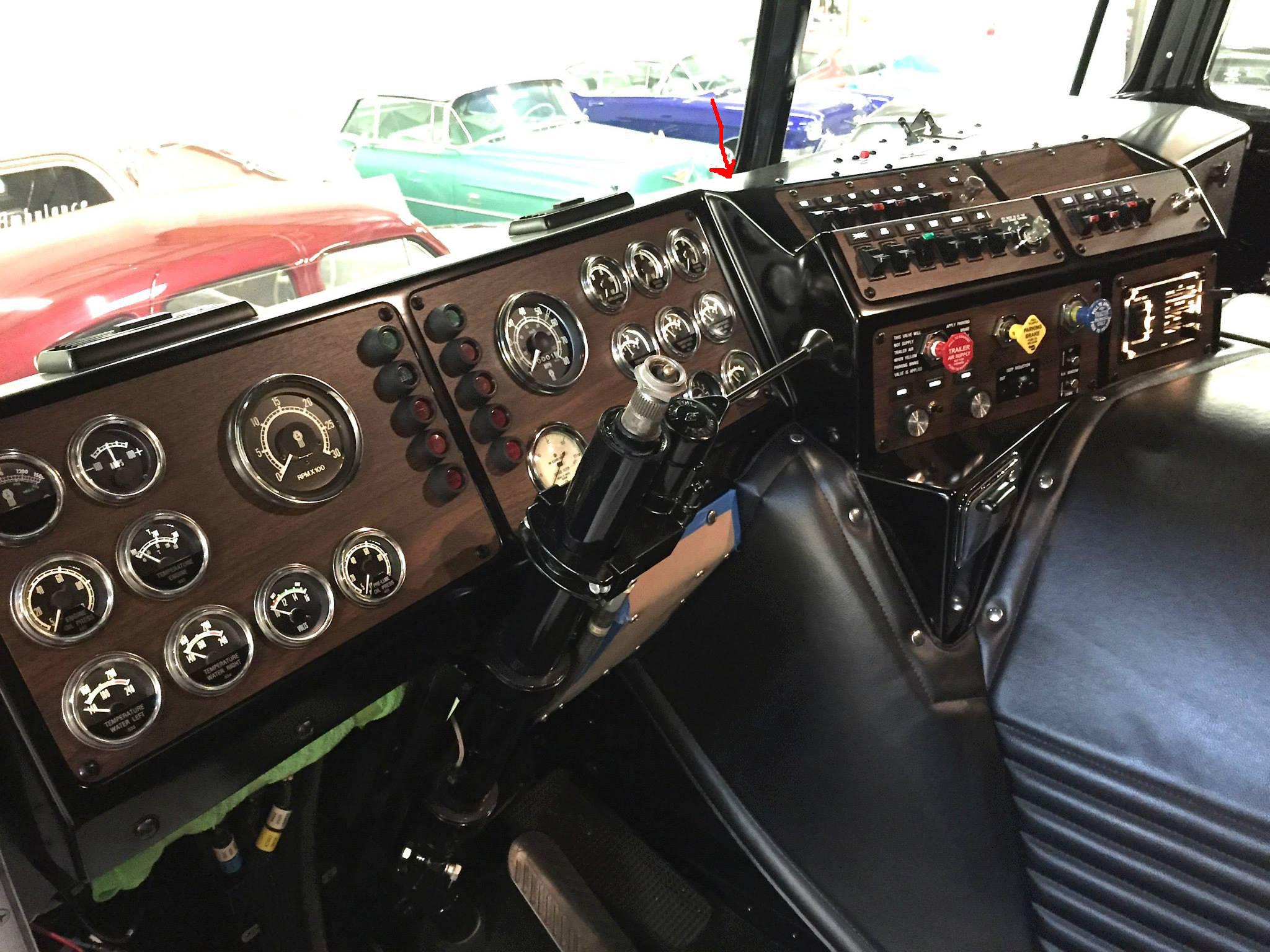

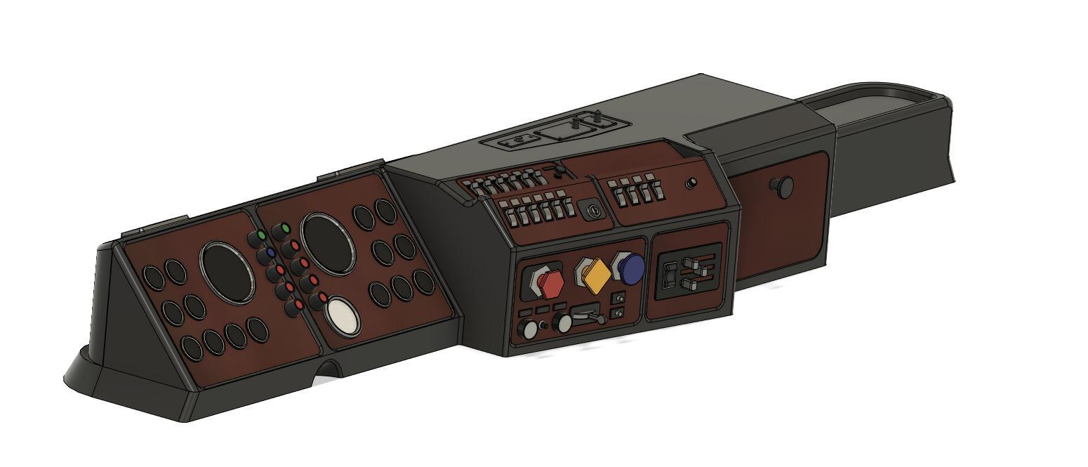

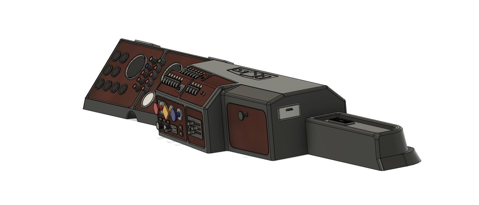

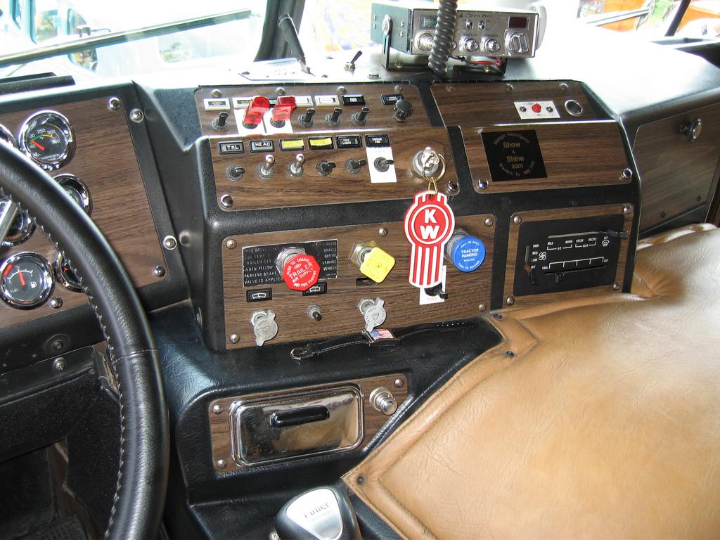

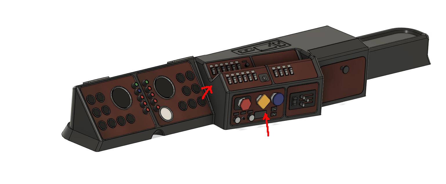

On 2/15/2023 at 3:07 AM, Oldmopars said:
Well, thank you for all the reference material. I can't begin to tell you how much it helped to make this. Take a look and see if it is close to what it needs to be. I have not forwarded it on and can still make updates to it.
You are welcone to them and I'll help out as much as I can as I have wished someone would do these dash panels for a long time, I don't know how to use a CAD program otherwise I would have done it myself.
This also looks very nice, maybe some little tweaks here and there to get it even better.
The step area at the left arrow looks to be a bit too deep and the angle of the upper panel are a bit too sharp as the upper and lower panels dont have the same angles, the base of the upper part should be closer to the upper edge of the lower part of these panels.
The brake valve knobs at the right arrow could also be a bit smaller.
 Here is a picture showing the different angles of the panels the upper panel is slightly flatter than the lower panel and the step portion is not that deep.
23409872_278861_439749036068389_1814494256_oK100Aerodyne.jpg.a89220cc499c33fb1ef3f4141f0070b6.jpg

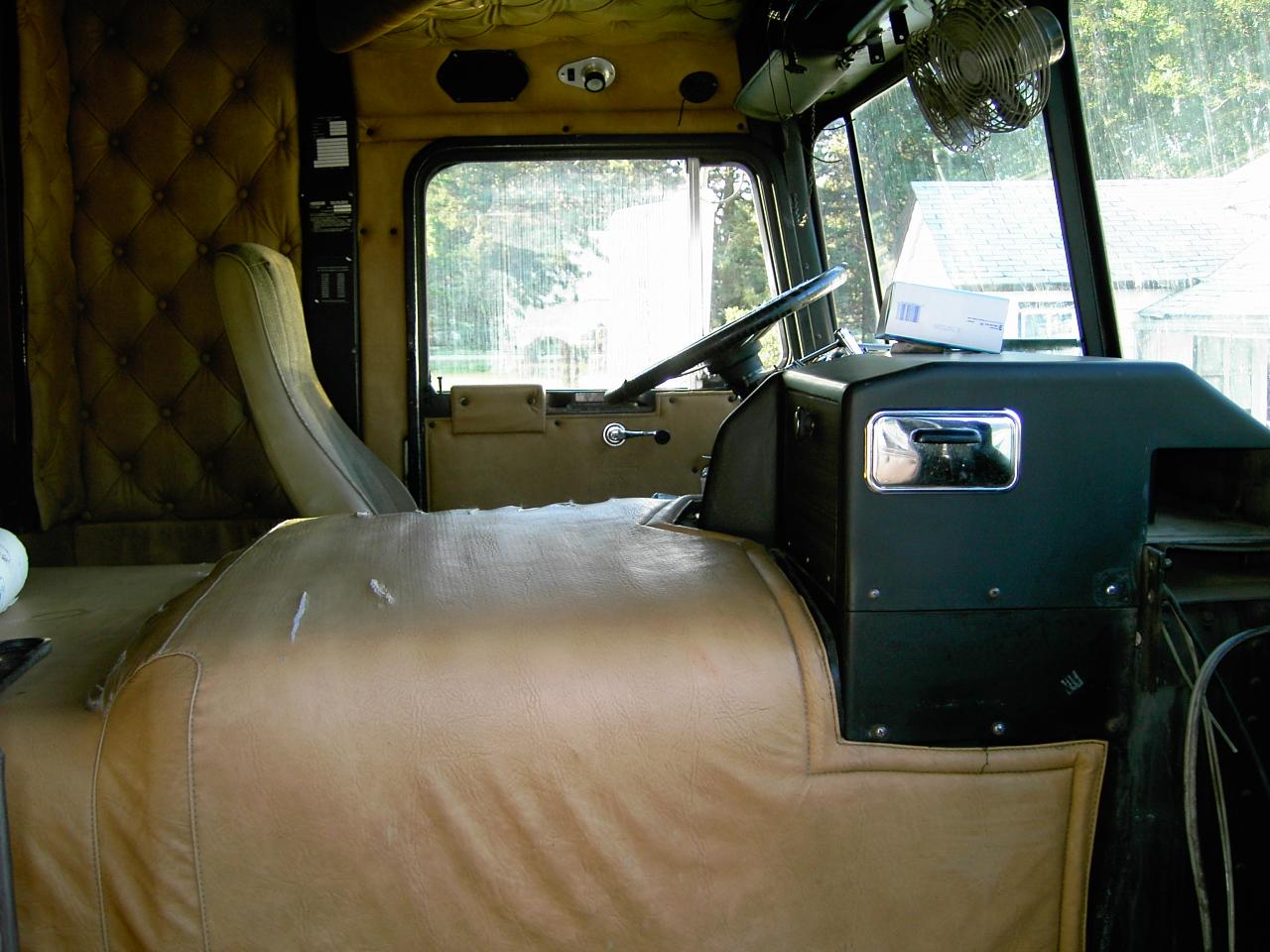

Also the left side on the upper part of the dash should be at an angle towards the panels with the gauges so the edge between the gauge panel and the side panels is straight, you can see it on the picture above but on the picture below it shows even better.
10477291_924296110947010_3264792342516601314_ob.jpg.4190f44270e870e2a05e7f0b1c385ba4.jpg
This shows the same thing on an older Aerodyne dash panel with toggle switches instead of the squareish plastic ones on the picture above.
1400256179_5132869140_80f4abb788_bKenworthK100AerodyneDash1978.jpg.273dde165cca4ec4e39da9efc2bdd3ed.jpg
There should also be an ash tray on the passenger side of the panel and there is one under the panel on the drivers side too, but these are not that hard to scratch build.
Edited by Force
Thank you, that is why I posted it, I had hoped you would see something I missed. I will work on those things this week.
Thanks again.
Link to comment
Ok, I have made the fixes, but my flight was leaving and I just got it done in time to save and close. I will post the updated pictures tonight.
I did add the ash tray on the right side of the dash, but the lower left ash tray is in the interior tray. This dash does not extend that far, the dash sits above that part.
I also reduced the size of the air brake valves.
Link to comment

The Updated Dash
On 2/18/2023 at 11:42 AM, Force said:
I'm eager to see the results.
I have saved a lot of references for the Aerodyne dash as I thought about scratchbuilding one and maybe have it replicated i resin, but with the 3D printing technique and CAD design it's probably less work and easier to rectify stuff, and I would have done it myself if I was able to work with CAD but I don't have a CAD program and don't know how to use it...I might have to get a course in CAD because I have lots and lots of ideas of things not available for both car and truck models.
If you do the dash we can maybe persuade CTM to do a photo etch detail kit for it with gauge details and stuff because their stuff is great, but if nothing is available they don't seem to be interested.
I will even provide references to them if they need them...all for the cause.
  • Like 1
Link to comment
17 hours ago, Oldmopars said:
The Updated Dash
Now we're talking.
It looks good, maybe the knobs for the brake valves could have been even a touch smaller but it's good enough and 200% better than the kit offerings, so good work...now to the printer. 😉😄
When it comes to the drivers side ash tray it's not a big deal as it's under the dash on the "dog house" and easy to scratch build if you want to.
As for the K100E, I would be interested in whatever you decide to do, a front clip for an excisting cab you graft on or a complete cab, AMT or Revell AG doesn't matter as I have several of both.
If you decide to do a complete cab the Revell AG kit it might be easier as the roof section on the Revell K100's is a separate piece so you can build either a flat top or Aerodyne depending on what kit you start with.
Link to comment

40 minutes ago, Force said:
Now we're talking.
I did reduce the size of the brake valves, but I hate to go any smaller. Because they stick out from the dash, and are not a feature of the das, if I go too much smaller, they may become an issue to print. Not that they can't be printed, but that they will be very fragile and just break off before you even get them painted.
As for the K100E, I think it would be a fun project. Charles has the Ford W1000 now and I am waiting to see how that goes getting it printed. Some tweaking is required. If we can successfully get those to print and they work good for him, I will be doing more. If not I may have to see if I can print one good one and send it to a resin caster as a master.  I have lots of time to draw/design, I have ZERO time to print or cast parts.
For the K100E, would a flat top or Aerodyne be more desirable? When I get to that point, having a Revell cab and interior would be helpful. I will have to keep my eyes open for one or borrow from somebody. I am thinking full cab at this point, but we shall see.
Link to comment
Don't worry about it, the dash looks really good and I like to see it printed...as I said, I have lots of kits who need this dash.
If you do a K100E I'm up for one.
Flat Top or Aerodyne, well it's depending on personal taste, I suggested the Revell kit because the basic kit is the same for both the Flat Top and Aerodyne with different separate roof sections on the same cab, the downside is the price they go for and that they are not in production right now.
But if you do something for the AMT kit you are pretty much locked on the Aerodyne as the only Flat Top they have is the K123 with a shorter and older style cab.
