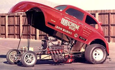

John Teresi Posted February 20, 2010 Author Share Posted February 20, 2010 Me too. Was that some sort of "innovation" back in the day? And if so, what's the idea behind it? Harry.....nice picture......I also made that version of the bug......I`ll post it soon......I really don`t know why they ran the blower hat backwards......but it was like that in the reference pictures I used......I also made the "Color Me Gone" charger f/c......it also ran with the blower hat backwards.......when I made these cars I had to take a second look to see if my eyes were playing tricks on me.......maybe someone knows the answer???? Quote Link to comment Share on other sites More sharing options...

jewellure Posted February 21, 2010 Share Posted February 21, 2010 Hey John, Great job. I think you did better that I did when I built this car. This is actually the second version with the 5 spoke front wheels. Most of the magazine shoots were of the first chassis and the original paint job. We cut the roof spoiler off and added the rear spoiler trying to get rid of some of the handling problems about half track. Not sure it helped but it looked cool. I don't think we ever ran the injector hat backwards but even I don't remember from 40 years ago! I'll look at some of my photos to check it out. Again a wonderful job. Build another and I'll provide more info and a handsome purchase price. Warren Gunter Quote Link to comment Share on other sites More sharing options...

Modelmartin Posted February 22, 2010 Share Posted February 22, 2010 ok, they tried running with the scoops backwards... but why??? The whole point is to ram as much air into the opening as possible, which is why you want the opening in the front! Turning it around so that the opening is in the back makes no sense whatsoever. I am not sure but it was just on supercharged cars which don't really need a ram effect. Maybe they were catching too many bugs. I did read that one dragster back then did catch a bird in his injector scoop! Ultimately it was just another thing that people tried but it didn't make any difference. John, I have articles on the Durachrome bug which I can scan and post if you want. Quote Link to comment Share on other sites More sharing options...
jewellure Posted February 23, 2010 Share Posted February 23, 2010 We did run the scoop backwards on the second car towards the end of the tour. The scoop was below the top of the hood. It seemed to make more sense to have the air go into the windshield opening and turn forward into the scoop. Otherwise if the scoop was facing forward the air had to go back forward and then turn again into the scoop. The engine was much lower on the second chassis than the first. I had a small gas pump on-board that primed the engine and I also controlled the on-board starter from inside. Most of the time it was just Steve Harris and me so we needed to simplify everything we could. Quote Link to comment Share on other sites More sharing options...
Harry P. Posted February 23, 2010 Share Posted February 23, 2010 We did run the scoop backwards on the second car towards the end of the tour. The scoop was below the top of the hood. It seemed to make more sense to have the air go into the windshield opening and turn forward into the scoop. Otherwise if the scoop was facing forward the air had to go back forward and then turn again into the scoop. The engine was much lower on the second chassis than the first. I had a small gas pump on-board that primed the engine and I also controlled the on-board starter from inside. Most of the time it was just Steve Harris and me so we needed to simplify everything we could. The air wasn't going to "turn" forward into the scoop. You should have cut an opening along the lower edge of the windshield to allow air into a forward-facing scoop, or raise the scoop opening high enough to clear the lower edge of the windshield. If backwards scoops actually worked, everybody would be using them! Quote Link to comment Share on other sites More sharing options...
Harry P. Posted February 23, 2010 Share Posted February 23, 2010 I am not sure but it was just on supercharged cars which don't really need a ram effect. The whole point of a supercharger is to force air into the combustion chambers at a level above normal air pressure... in other words, to mechanically "ram" the air into the cylinders via the screws inside the housing. Orienting the access hole for the supercharger's air intake to the rear is going to defeat the whole point of a supercharger, which needs to gulp as much air as possible in order for it to have the desired effect. Quote Link to comment Share on other sites More sharing options...
