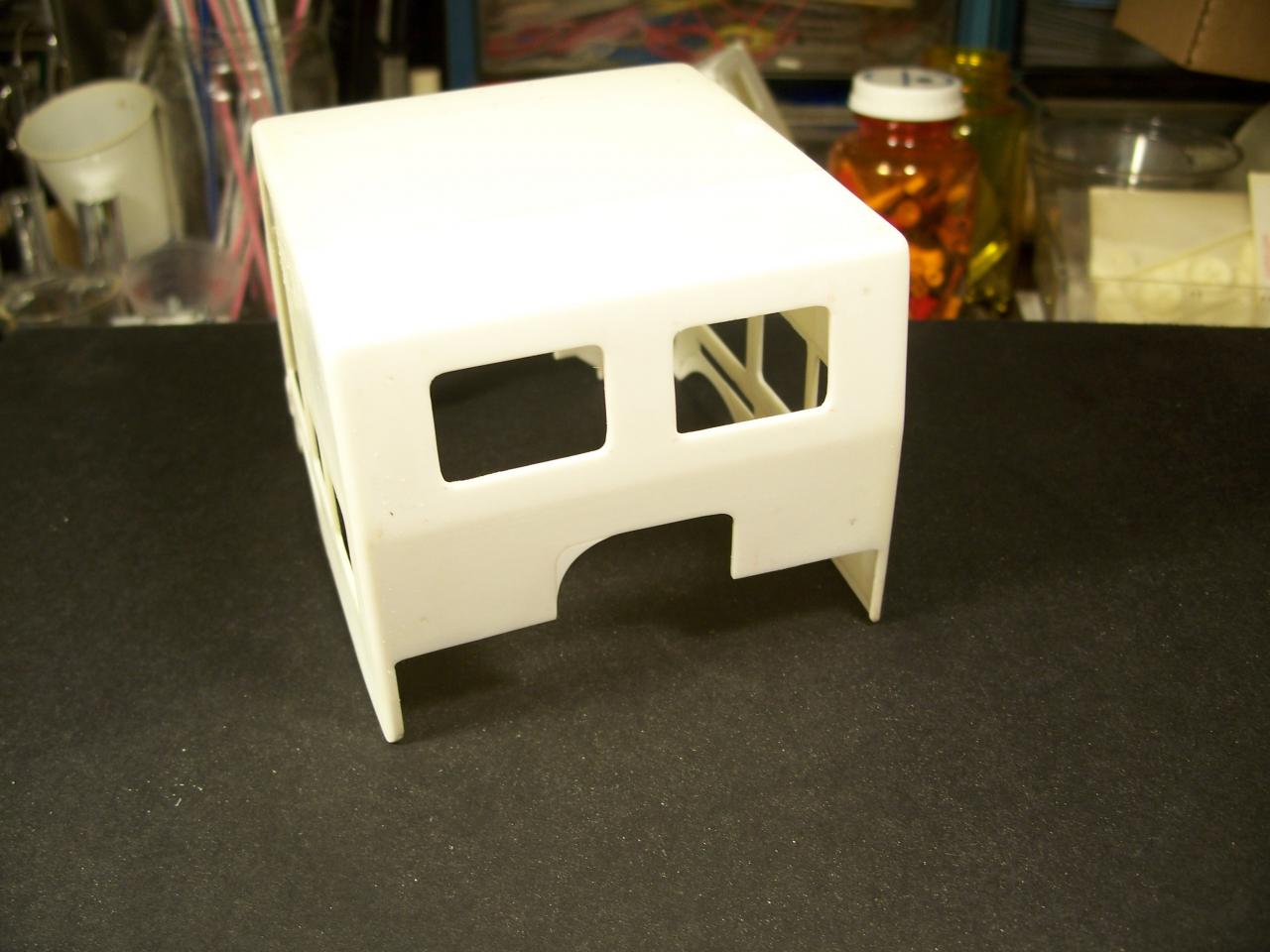

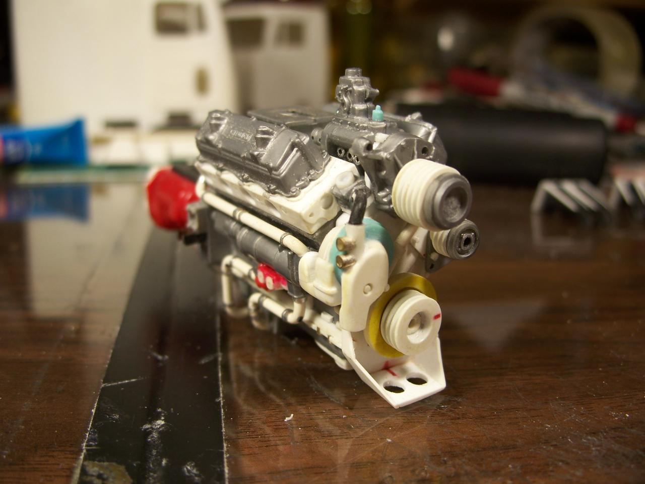

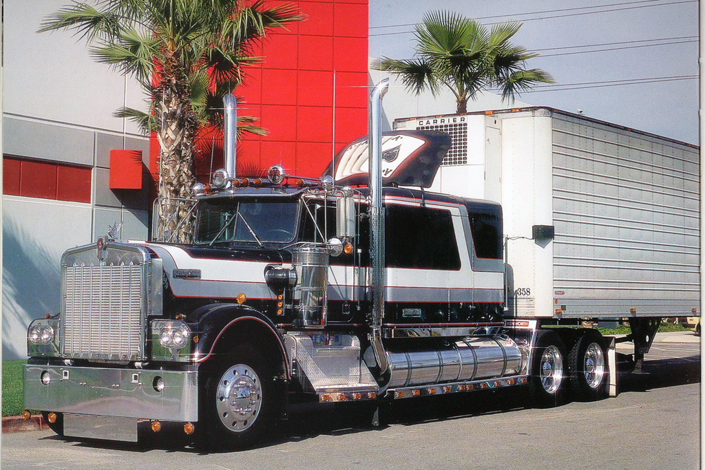

purepmd Posted January 8, 2014 Share Posted January 8, 2014 (edited) Hey Guys, I thought i would post some of my ongoing projects. First, the 352H is one of my all time favorite truck. I had the privilege of driving one many, many years ago. When i found this picture on the web, I was hooked. The first order of business was fixing the ROG 3408. I removed the molded in filters, filled the block, added a proper oil pan rail, corrected the water pump, timing cover, balancer and pulleys. Scratch built cylinder heads were easier than fixing the blobs in the kit. Two cabs were mated into one. With photo etched door hinges in hand, all the doors, driver access and storage, were removed. Thats when I discovered a oversight in the cab as it is from AMT. The storage doors are molded to low. The bottoms of the main doors and the storage doors should be at different heights. I cut them out, flipped them over, that way the floor of the cab can stay the same front to back. The extra ROG 359 frame from the Can-Do wrecker was smoothed and fitted for the cab. Hydraulic rams and brackets made fro the underside of the cab. It is hard to see in the oridginal picture, but the H had a different shift tower. A set of Jamie's Peterbilt resin wheels, and 150 gallon tanks, and some CMT Photo etch will follow. Thanks for checking out my post, comments and criticisms welcome. Mark. Edited April 15, 2014 by purepmd Quote Link to comment Share on other sites More sharing options...

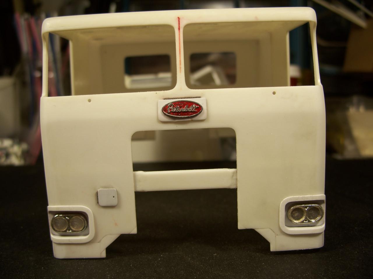

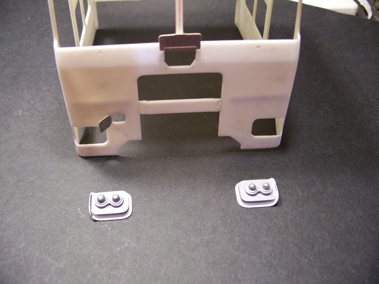

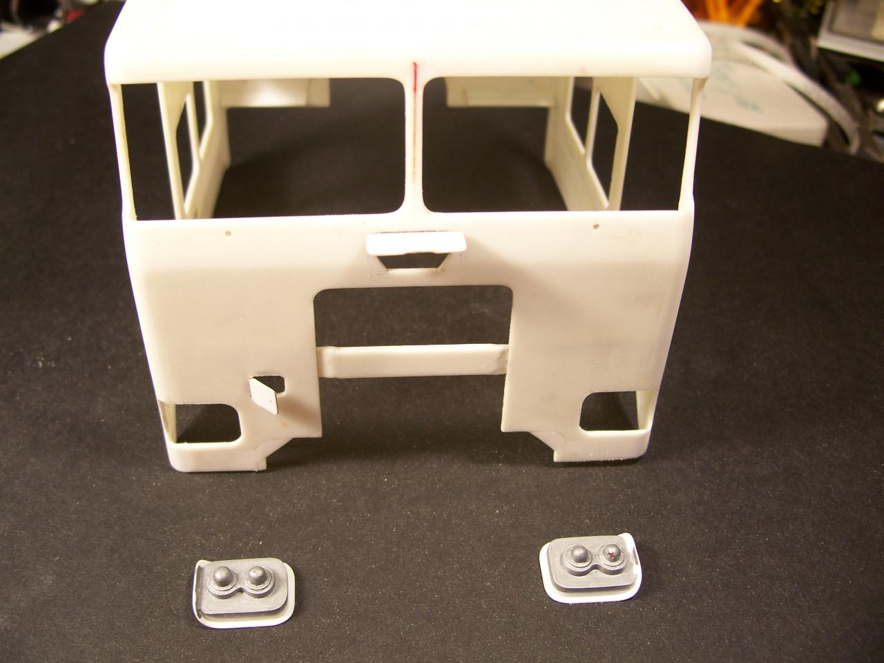

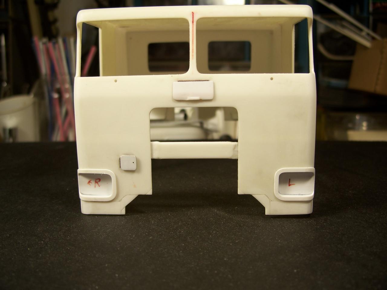

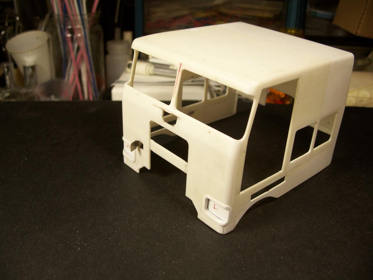

purepmd Posted January 25, 2014 Author Share Posted January 25, 2014 (edited) Thank you all for the kind words. I got in a little bench time lately, so update photos are in order.I started to add some of the details back onto the cab, and not one to keep to the K.I.S.S. methodology, I figured it would be a good idea to make the service access doors on the front work. I used The Model Car Garage small photo etched piano hinges, some extra photo etched sheet to give them strength and an .005 sheet of styrene to make them easier to shape. I constructed the headlight buckets and fitted then to the cab. Just for fun. I threw some junk box bezels and a 1/16th scale enblem, which I will strip clean and reuse, to make the larger emblem. Edited January 25, 2014 by purepmd Quote Link to comment Share on other sites More sharing options...
